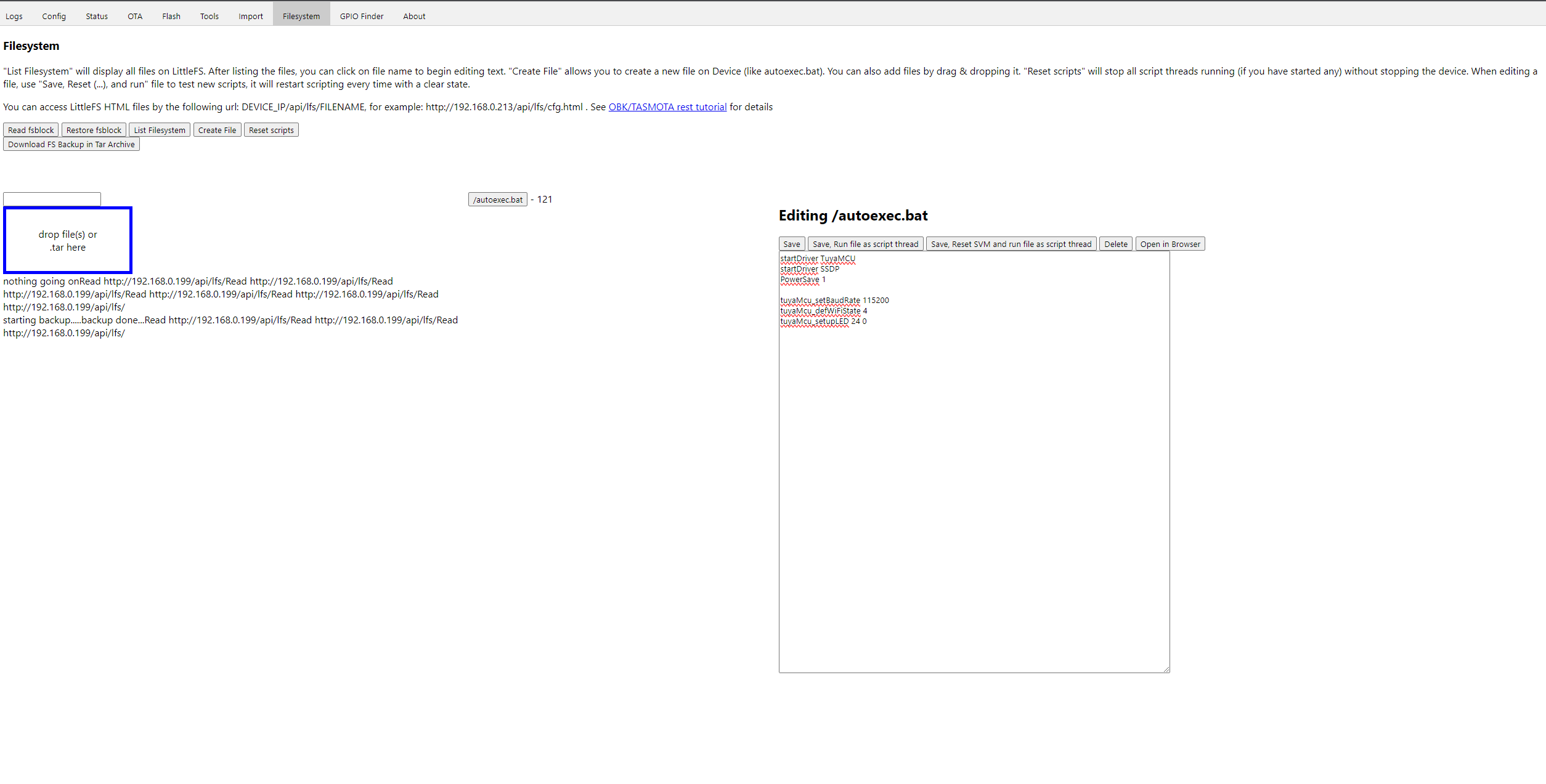

    I have now managed to flash one of my WT5s with OBK. Unfortunately, I can't get any further now.
    I have managed it :-) My autoexec.bat for the moment looks like this:
    startDriver TuyaMCU
    startDriver SSDP
    PowerSave 1
    tuyaMcu_setBaudRate 115200
    tuyaMcu_defWiFiState 4
    tuyaMcu_setupLED 24 0

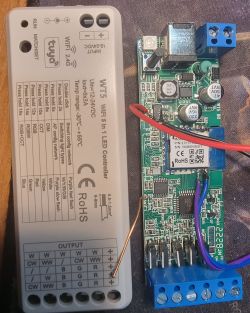

    I have the same drivers and I can't connect to them. I had no problems with other devices. RX-TX TX-RX connected, separate 3.3V power supply and BK7231 Easy Uart Flasher program. I cut off the connection to the transistor from TX to be sure (user @Kinsi55 drew this connection), the RX pin seems not to be connected anywhere. Shorting CEN to mass does not help either. Power is supplied, the converter is operational. Photo of the device, marking on the housing WT5, WB3S chip inside.
    Image of a device labeled WT5 with an internal WB3S chip.

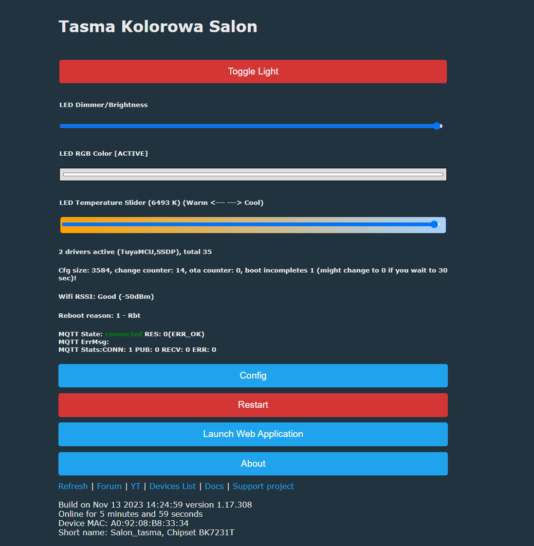

    Successfully programmed. It turned out that I had damaged the programmer when connecting it (initially I had connected RX and TX incorrectly). For programming, I used the ESP8266 Nodemcu board with connected EN-G pins - a lifesaver if someone did not have a separate programmer but had a free ESP board. We then use the RX and TX pins and the ESP system is turned off. Script by @atomphil loaded and successful.
    User interface for controlling an LED strip with options for adjusting brightness, RGB color, and temperature. Graphical user interface with a section for script file editing.

    Selecting or changing scenes via RF remote control is also not shown in the log.
    Is there an easy way to monitor the communication between BK and TuyaMCU before the WLAN connection is established? Perhaps something interesting is sent by the TuyaMCU at startup.
    But all this is only what would be nice.
    Firstly, it would help a lot if the WLAN module did not overwrite the TuyaMCU's start values after startup.
  • #48 20870701
    Posts: 14631
    Help: 655
    Rate: 12647
    Which of those dpIDs are not received correctly by OBK?
    Well, there is one method. Select quick connect flag in OBK flags, then go to the web app, then, on obk native panel, click "reboot", clear Web App log but keep it open, and after up to 5-10 seconds, when OBK reconnects, you should get whole log (since reboot) in the web App anyway. This is because OBK firmware has a buffer of a certain size that can store the log for some time and it will send it to the App once it reaches WiFi
  • #49 20872464
    atomphil
    Posts: 31
    Rate: 17
    The method only returns the log from wifi connect. Here is the log when the entire controller is started by switching the supply voltage:

    I don't know what WiFi module is sending to your TuyaMCU at startup. Maybe we should check what is being send first, and then try to fix the issue.
    If your logs are not complete due to the very early boot, then there is one very simple solution.
    Modify your autoexec.bat to contain:
    delay_s 20
    startDriver TuyaMCU
    [your remaining autoexec.bat here]
    This will add artificial 20 seconds delay after reboot and before TuyaMCU start.

    Okay, I have tried the following:
    I have disabled all MQTT and HA stuff and used the following autoexec.bat:
    delay_s 20
    startDriver TuyaMCU
    //startDriver SSDP
    //PowerSave 1
    //Set blue after 15s for testing
    delay_s 15
    tuyaMCU_sendColor 24 0 0 1 1
    I then set the light to red via the web interface and switched it on and off to save the value in the EEPROM. I then set the light to warm white via RF remote and switched off the controller using the mains switch.
    After deleting the log, I switched the controller on again using the mains switch. The light immediately came on in the right colour (warm white). After a while it changed to red (which the WLAN module had saved as the last colour) and after a further 15 seconds to my test command blue.
    I have recorded the following log:

    These two "Info:TuyaMCU:Colour is sent as 000003E800B4" commands are the troublemakers. It would be good if they were not sent.
    When switching on the controller, the TuyaMCU starts without delay with the last set values (regardless of whether these came from the RF or the Wifi module), it makes no sense in any constellation for the Wifi module to set these again after it has started.
  • #52 20873173
    DeDaMrAz
    Level 22  
    Posts: 605
    Help: 34
    Rate: 129
    Set the color with web interface to whatever you want, power cycle the device and DO NOT touch the RF remote.
    What is the color on startup??
  • #53 20873185
    Posts: 14631
    Help: 655
    Rate: 12647
    Just a quick idea - maybe remembering the color on OBK side can work for you? Set Flag for "Remember LED state" and try again.
  • #54 20873375
    atomphil
    Posts: 31
    Rate: 17
    The start colour is ALWAYS the last setting, regardless of how it was made. In this case, the last colour set via the web interface.
    When the Tuya driver is loaded, this is then overwritten by the colour stored in the EEPROM. This does not have to be the same colour, even if it is entered via the web interface (it does not seem to save every change immediately).
    As I said, overwriting the colour by the Wifi module at startup brings no advantage, only problems.
    The flag is already set. If I uncheck "Flag 12 - [LED] Remember LED driver state (RGBCW, enable, brightness, temperature) after reboot", the Wifi module sets the light colour to 100% brightness full cold white (brrrr) after starting the Tuya driver.
  • #55 20873403
    Posts: 14631
    Help: 655
    Rate: 12647
    We can disable sending color early, for example, before timer reaches 60 seconds uptime.
    Still, this would make a large desync between OBK WWW panel and true device color, because OBK would not know what color is currently set.
    Would that be an acceptable solution for you?
    The other option would be to read TuyaMCU color somehow but I can't see it's dpID being sent from MCU to BK,.
  • #56 20873477
    atomphil
    Posts: 31
    Rate: 17
    We can disable sending color early, for example, before the timer reaches 60 seconds uptime.
    Yes, that would be a practical workaround. 60 seconds is probably too long, only these first two autonomous "Colour is sent" commands need to be suppressed.
    Maybe you could set the waiting time in seconds via the config or a variable in the autoexec.bat. For example like:
    tuyaMcu_defStartupNoSend 12
    The other option would be to read TuyaMCU color somehow but I can't see its dpID being sent from MCU to BK,.
    Yes, that's a pity, but the desync between the state of the web interface and the actual light is the minor problem in the practical application, because the first function of the controller is the lighting and not the web interface. The web interface still works, it just shows the wrong values under certain circumstances without input.
  • #57 20873484
    Posts: 14631
    Help: 655
    Rate: 12647

    The status request can be done in OBK by using tuyaMcu_sendQueryState command. This will request all dpIDs. Have you tried executing this command?
    Still, you can make a capture on unflashed device with our tool:
    https://github.com/openshwprojects/TuyaMCUAnalyzer
    Of course, you need to know how to do that in safe manner. For example, when your device is using a non-isolated power supply, connecting it to your PC via UART may damage both PC and device. I think that @DeDaMrAz even had one time some kind of similiar accident.
    On the other hand, if the device is powered via an isolated 12V DC power supply, then you can do a safe capture without any extra optoisolation...
  • #60 20873896
