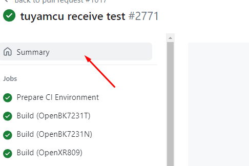

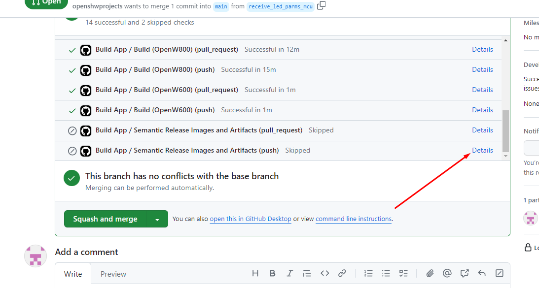

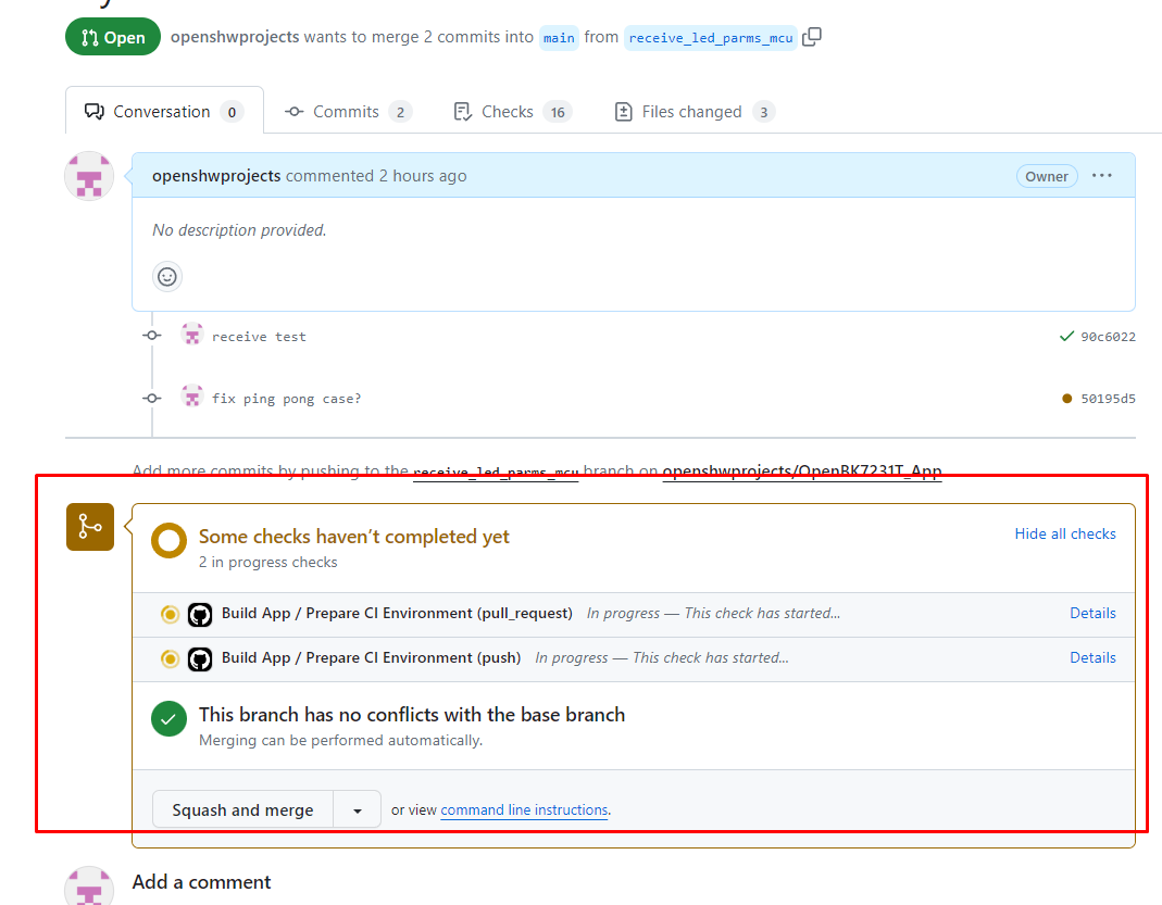

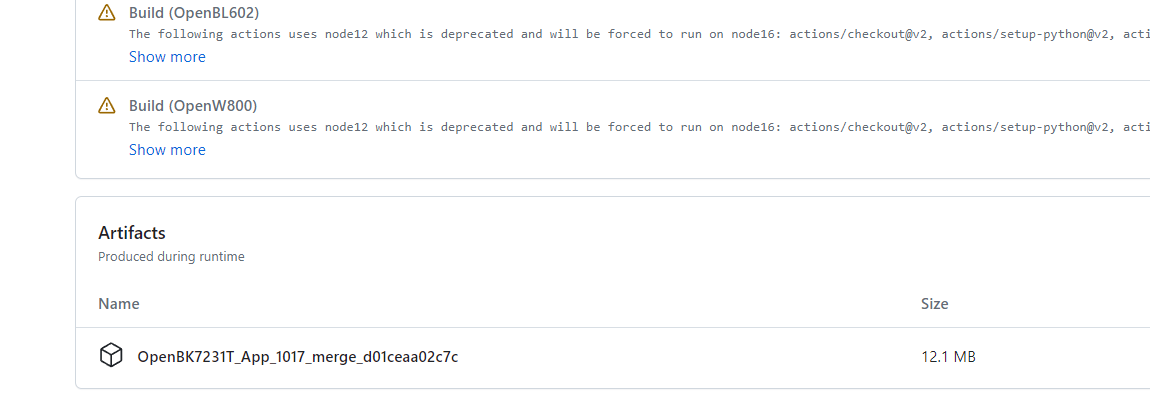

    So, I will just try to add the feature you requested and we will see if it helps

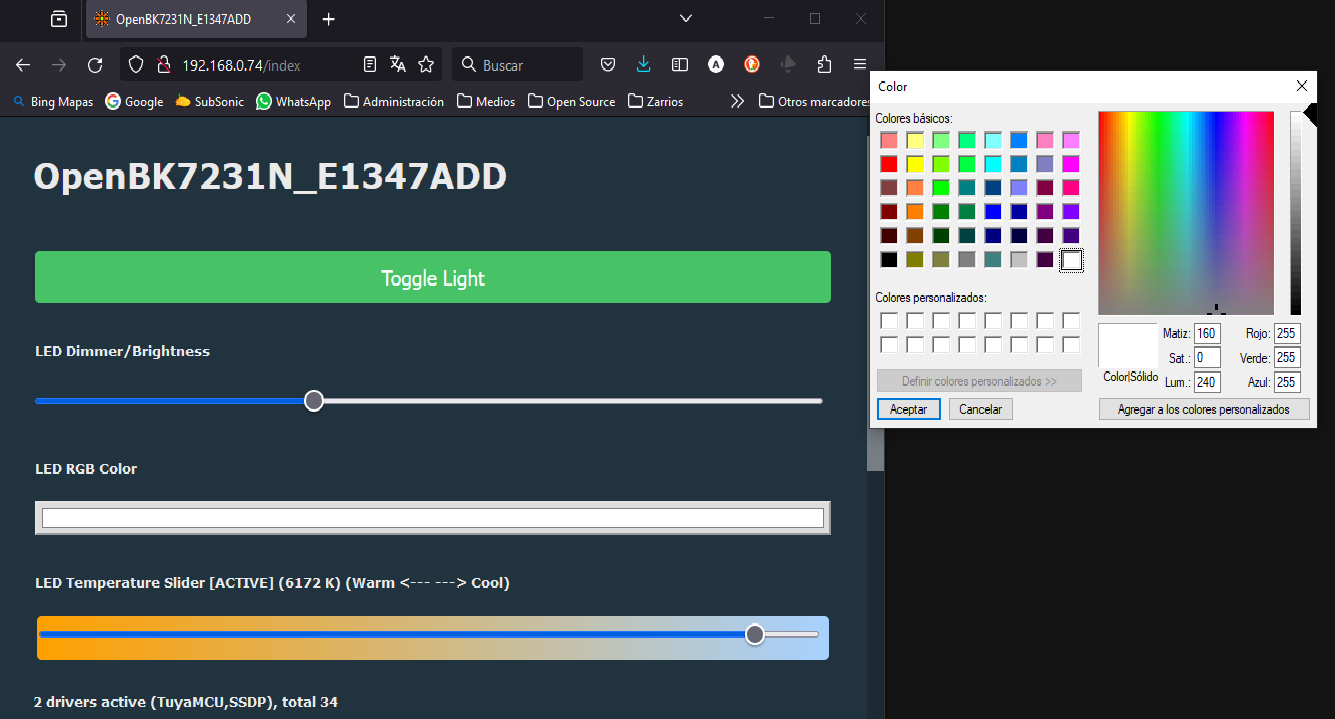

  • #66 20884460
    alvaroconsuegra
    Posts: 12
    Nice.
    I have successfully installed openbk and configured the connection to my wifi AP.
    I can't see where to write the autoexec.bat...
    OK, found it.
    I have to create a new file and copy the content.
    Added after 24 [minutes]:
    Screenshot of OpenBK7231N control panel with LED settings.
    OK, as in esphome, CCT part is working, but RGB part has no effect.
    I think that it has to do with DP 21, which should allow to select from CCT or Color.
    BTW, in the web app, under led tools, I can turn on 100% R, G, B, WW, and CW, so it looks like CB3S can send all necessary DP to MCU[/img]
    Added after 6 [minutes]:
    Oops, it looks like RGB is working. The problem was that once the color dialog is open, only the first selection is applied.
  • #67 20884645
    Posts: 14631
    Help: 655
    Rate: 12647
    So, everything works as expected in OBK? Well, I am happy to hear that, considering that it's a handcrafted software, made mostly by me. Please double check if everything is okay and whether you are happy with the results, if not, I can try to help/improve the driver if it's required.
    PS: The color picker is kinda out of our control so I am not sure if we can improve that, maybe we could just create our own custom picker.

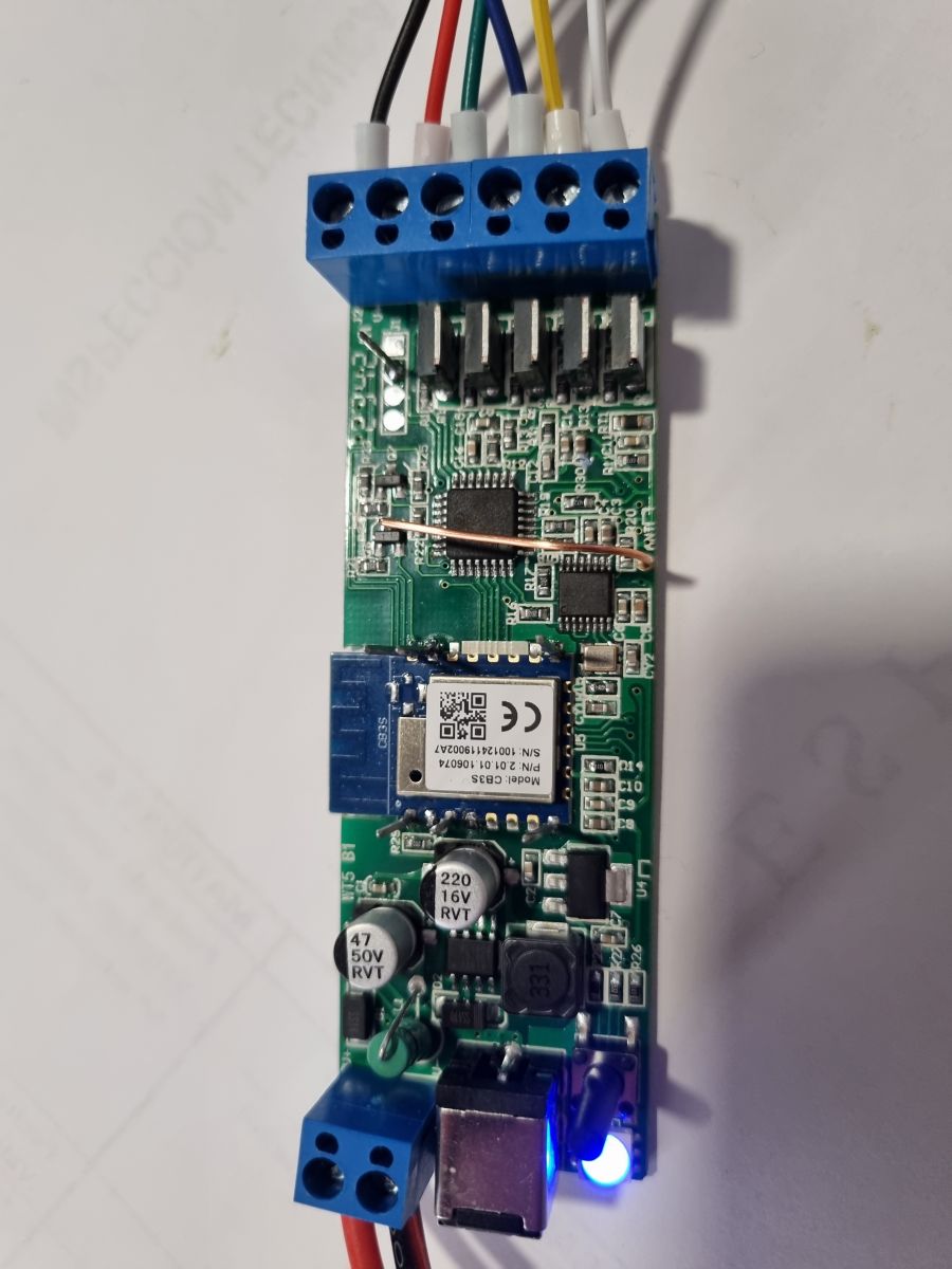

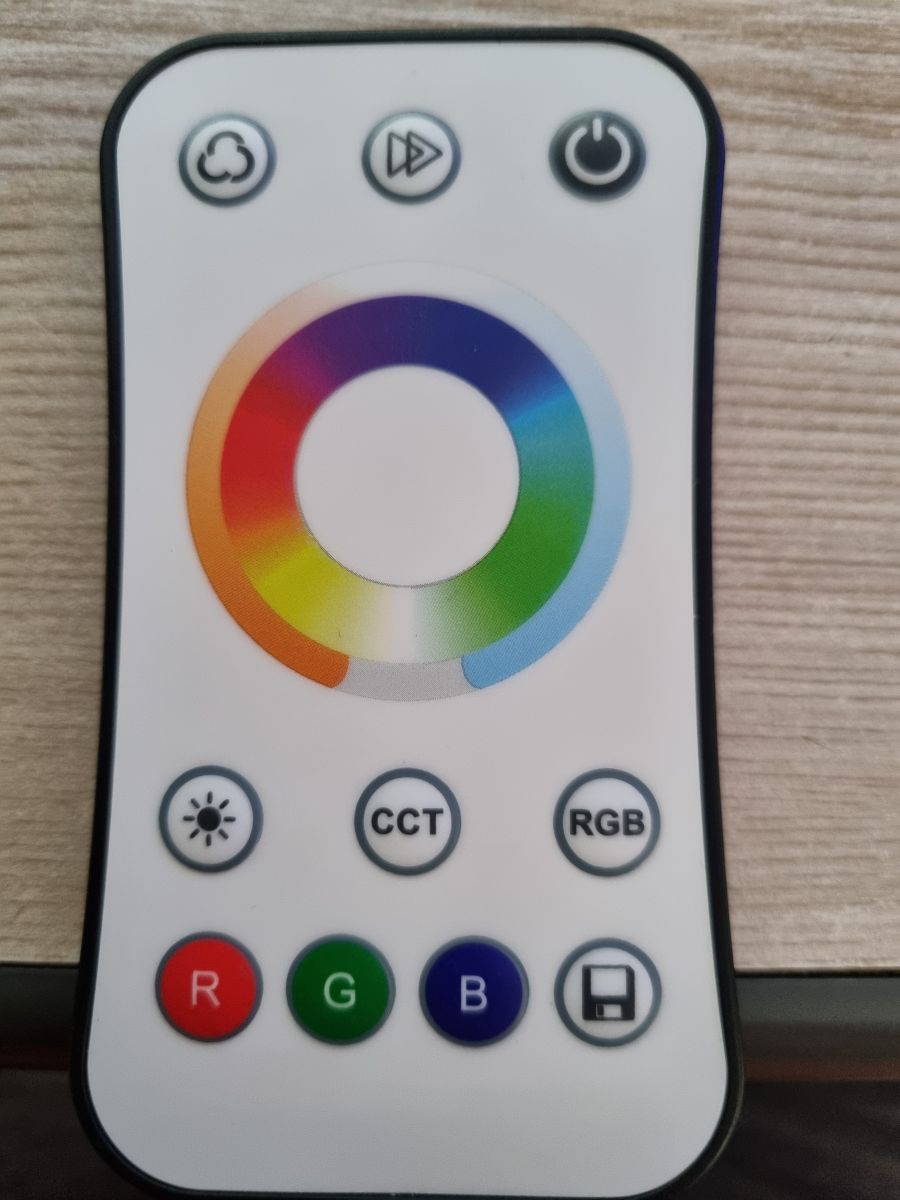

    #70 20885149
    alvaroconsuegra
    Posts: 12
    OK, 1st a picture of the board and remote:
    Electronic board with connected wires and Tuya module.
    Remote control with a color ring for light adjustment and function buttons.
    Now for the logs:
    Push on and imediately off on RF remote:
    Info:TuyaMCU:TUYAMCU received: 55 AA 03 03 00 00 05
    Info:TuyaMCU:TuyaMCU_ProcessIncoming[ver=3]: processing command 3 (WiFiState) with 7 bytes
    Info:TuyaMCU:TUYAMCU received: 55 AA 03 00 00 01 01 04
    Info:TuyaMCU:TuyaMCU_ProcessIncoming[ver=3]: processing command 0 (Hearbeat) with 8 bytes
    Info:TuyaMCU:TUYAMCU received: 55 AA 03 07 00 05 14 01 00 01 01 25
    Info:TuyaMCU:TuyaMCU_ProcessIncoming[ver=3]: processing command 7 (State) with 12 bytes
    Info:TuyaMCU:TuyaMCU_ParseStateMessage: processing dpId 20, dataType 1-bool and 1 data bytes
    Info:TuyaMCU:TuyaMCU_ParseStateMessage: raw data 1 byte: 1
    Info:TuyaMCU:Color is sent as 0000000003E8
    Info:TuyaMCU:TUYAMCU received: 55 AA 03 07 00 10 18 03 00 0C 30 30 30 30 30 30 30 30 30 33 45 38 A0
    Info:TuyaMCU:TuyaMCU_ProcessIncoming[ver=3]: processing command 7 (State) with 23 bytes
    Info:TuyaMCU:TuyaMCU_ParseStateMessage: processing dpId 24, dataType 3-str and 12 data bytes
    Info:TuyaMCU:TUYAMCU received: 55 AA 03 07 00 05 14 01 00 01 00 24
    Info:TuyaMCU:TuyaMCU_ParseStateMessage: raw data 1 byte: 0
    With light on, Press CCT on remote an then color:
    Info:TuyaMCU:TUYAMCU received: 55 AA 03 07 00 08 17 02 00 04 00 00 01 86 B5
    Info:TuyaMCU:TuyaMCU_ProcessIncoming[ver=3]: processing command 7 (State) with 15 bytes
    Info:TuyaMCU:TuyaMCU_ParseStateMessage: processing dpId 23, dataType 2-val and 4 data bytes
    Info:TuyaMCU:TuyaMCU_ParseStateMessage: raw data 4 int: 390
    Type bright button on remote an then swipe in CW the CCT/RGB weel:

    Pushing R, G or B button has no efect on log
    In CCT mode, swipe CW the weel:

    In CCT mode, and brigt, swipe CW

    Added after 3 [minutes]:
    The buttons from the upper row (cloud and >>) dos not produce any log
    R, G and B in the last row does not produce any log, but changes the light color.

    Thank you, so I added a receive for dpIDs 22 and 23.
    However, I have not tested it, especially for the "send back" case.
    Can you download "build artifacts" zip here:
    https://github.com/openshwprojects/OpenBK7231T_App/pull/1017
    Update your device and test the new feature?
    Please note that it may not work good at the first try, so I need your help with testing it several times, maybe I will have to improve that.
  • #72 20886051
    alvaroconsuegra
    Posts: 12
    Hi, here I am again.
    I am not familiar with GitHub.
    The link looks like a differences file for the source code.
    I assume I have to download sources, apply the differences, and compile?
    I don't know how to do it...
    If you can give me some instructions, I will do it.
    Thanks
  • #73 20886054
    Posts: 14631
    Help: 655
    Rate: 12647
    Click details here:
    Overview of build results in the GitHub Actions panel with the Details button highlighted.
    It opens a page like that:
    https://github.com/openshwprojects/OpenBK7231...tions/runs/7376088134/job/20068590834?pr=1017
    Then click summary:
    Screenshot showing GitHub interface with Summary button selected.
    Then scroll down and you see:
    Screenshot of GitHub Actions showing the build section and artifacts for OpenBK7231T_App.
    And you can download a package:
    https://github.com/openshwprojects/OpenBK7231.../actions/runs/7376088134/artifacts/1141679109
    Please check this build, especially for "ping pong" edge case where TuyaMCU sends change to WIFI module and WiFI module sends it back to the MCU and MCU sends it again.. .etc etc. Maybe backup your config first, if you are in doubt.

    Thanks for the detailed instructions.
    I have updated by OTA in web application:
    IoT device information with MAC address and software version.
    It still restore the values left in the web UI.
    Attached log is selecting only tuya MCU.
    With the brigtness bar at full, in the remote i select brigtness, reduce the value and toogle off an then on.
    The stripe when i toogle off whas on with low bright, and when i tooble back on, it is full bright, with values from web UI.

  • #77 20886213
    Posts: 14631
    Help: 655
    Rate: 12647
    It's the ping-pong case I was worried about. That's why we test.
    Okay, so I pushed update, can you check now?
    Now, OBK will not reply to MCU, only it will update the state.
    Please open the link, and scroll down to the bottom, and get the new binaries as I explained two posts ago...
    Then recheck, and tell me if it works better, just please try to be precise, I need to know how it works.
    Build should be ready in two minutes, it's building right now:
    Screenshot of a GitHub page showing an open pull request for the openshwprojects project with two incomplete checks.

    In these logs, I push RGB in the remote and select a red color in the color wheel:
    Info:MAIN:Time 607, idle 149715/s, free 71632, MQTT 1(1), bWifi 1, secondsWithNoPing 536, socks 3/38 POWERSAVE
    Info:MAIN:Time 608, idle 73443/s, free 71632, MQTT 1(1), bWifi 1, secondsWithNoPing 537, socks 3/38 POWERSAVE
    Info:MAIN:Time 609, idle 68418/s, free 71632, MQTT 1(1), bWifi 1, secondsWithNoPing 538, socks 3/38 POWERSAVE
    Info:TuyaMCU:TuyaMCU_ProcessIncoming[ver=3]: processing command 0 (Heartbeat) with 8 bytes
    Info:MAIN:Time 610, idle 138694/s, free 71632, MQTT 1(1), bWifi 1, secondsWithNoPing 539, socks 3/38 POWERSAVE
    Info:GEN:dhcp=0 ip=192.168.0.74 gate=192.168.0.2 mask=255.255.255.0 mac=c4:82:e1:34:7a:dd
    Info:GEN:sta: 1, softap: 0, b/g/n
    Info:GEN:sta:rssi=-42,ssid=acopen,bssid=50:c7:bf:8b:39:de,channel=13,cipher_type:CCMP
    Info:MAIN:Time 611, idle 67903/s, free 71632, MQTT 1(1), bWifi 1, secondsWithNoPing 540, socks 3/38 POWERSAVE
    Info:MAIN:Time 612, idle 68853/s, free 71632, MQTT 1(1), bWifi 1, secondsWithNoPing 541, socks 3/38 POWERSAVE
    Info:MAIN:Time 613, idle 71830/s, free 71632, MQTT 1(1), bWifi 1, secondsWithNoPing 542, socks 3/38 POWERSAVE

    Of course, you can double check, and maybe you can also do experiment, execute this command with Web App log open:
    tuyaMcu_sendQueryState
    and show me the log of all data received...
  • #80 20886395

  • #81 20886579
    Posts: 14631
    Help: 655
    Rate: 12647
    Can you set the strip into the RGB mode and retry sending query command?
  • #82 20886598
