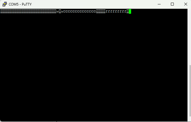

  • #97 21407597
    c0m4r
    Posts: 40

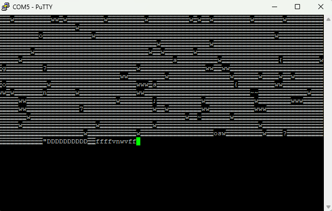

    I have tried both filling in the OBK settings in the flasher so that it immediately connects to wifi and leaving it unfilled so that the AP appears to connect. Each time without success. Neither connects to my wifi nor puts out an AP.
    I have checked the read "read only OBK settings" and the data about my wifi stored in the chip is ok.
    I tried to connect with the putty to the TX2 pin (from the RX programmer to the TX2 pin, without the other lines) the power supply I have applied normal to the whole device but some bushes are
    Screenshot from PuTTY showing garbled characters in the terminal.

    From TX2 collect the log at baud 115200. In flasher you can still do a restore RF partition.
  • #101 21407812

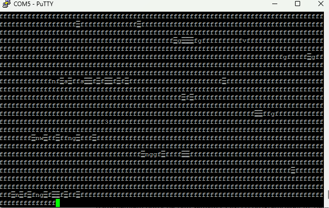

    I did the RF restore, checked the Read OBK config again, log below, looks all ok.
    As I connect from the 3.3V/GND converter and from RX to TX2 (11pin) in CB3S, I run putty on the same COM as I programmed, baud 115200 and nothing happens, empty terminal.
    If I leave only the RX to TX2 line connected and supply the controller with 12V there is one line in the terminal
    PuTTY terminal with unreadable characters displayed on a black background. .
    When I still connect the TX lines from the converter to RX2 from CB3S it flies very quickly fffff itself
    Screenshot of PuTTY program with unreadable characters in the terminal.

    Maybe you have removed the bootloader for yourself? Enable "overwrite bootloader" in flasher.
    Erase All doesn't need to be done at all, or maybe you did it so now flashing OBK leaves an empty space after the bootloader, so you have to re-upload it....

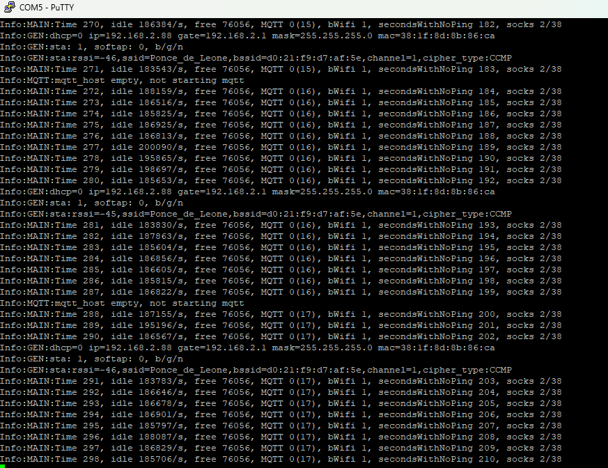

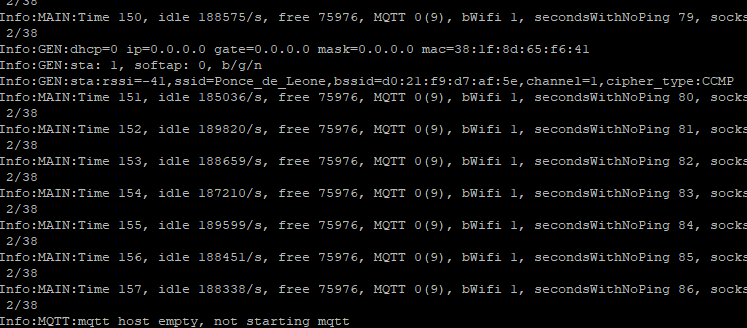

    The logs came up, the device logged into the Wi-Fi, but unfortunately the webpanel does not open.
    First I tried with DHCP, on the router it got the address 192.168.2.88, then I made a reservation for this address and in BK config I made a static IP with the same address. Unfortunately the webpanel does not report :( .
    Screenshot of a terminal showing device connection logs to a Wi-Fi network. .

    What do you mean with webpane? The basic web panel should work. The Web App, on the other hand, only works if you have internet access because the Web App is a script from the open Github repository downloaded from the web (with the option to host this at home);.
  • #105 21407977
    c0m4r
    Posts: 40
    I am referring to the basic web panel - the page is not loading. I understand that it works on standard port 80? Is there anything in the logs to check if the panel is okay?

    You may have messed up the RF partition with this Erase All. Perform Restore RF partition in flasher. Is the device responding to the ping? The site should work normally on port 80.

    I think I know what the problem is. There's a bug in either the firmware or the flasher that doesn't set dhcp=1 correctly when you edit the static IP address. I removed the network settings in flasher and set all addresses to just 0 so that there was dhcp, uploaded the flash, RF and bootloader again and the module issued its AP. I have configured my WiFi, the module has connected to the network, but the dhcp still has the 0 flag, which means it can't/won't set itself the IP address the router has assigned it, so even though I go to the address the router has assigned, the module can't see the address - you can see this well in the logs
    Console logs showing DHCP and MQTT issues.
    EDIT:
    I couldn't get a deal with DHCP, only setting a static IP address + reservation on the router sorted it out and the web panel works. Thanks for helping me get it up and running, now I'll be connecting and fighting with the LEDs ;) .
