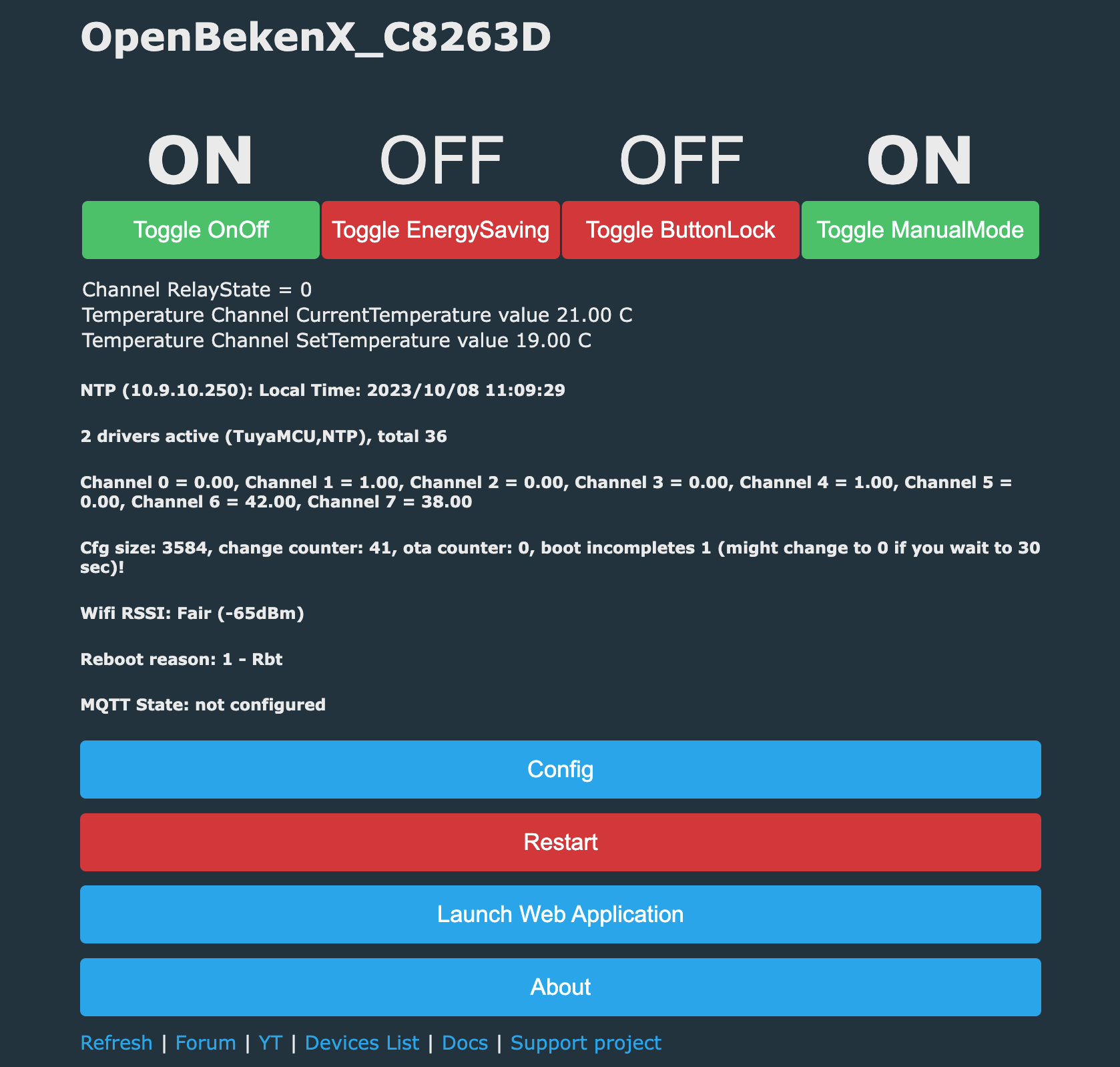

    I experimented a bit and added the relay status, current temperature and expected temperature in the GUI.
    OpenBekenX application interface with control buttons and temperature information.
    // Start NTP Driver
    startDriver NTP
    // Set NTP Server
    ntp_setServer 10.9.10.250
    // Set timezone
    ntp_timeZoneOfs +2:00
    startDriver TuyaMCU
    tuyaMcu_defWiFiState 4
    waitFor NTPState 1
    echo "NTP is ready"
    setChannelType 1 toggle
    setChannelLabel 1 OnOff
    setChannelType 2 toggle
    setChannelLabel 2 EnergySaving
    setChannelType 3 toggle
    setChannelLabel 3 ButtonLock
    setChannelType 4 toggle
    setChannelLabel 4 ManualMode
    setChannelType 5 ReadOnly
    setChannelLabel 5 RelayState
    setChannelType 6 Temperature_div2
    setChannelLabel 6 CurrentTemperature
    setChannelType 7 Temperature_div2
    setChannelLabel 7 SetTemperature
    // linkTuyaMCUOutputToChannel dpId verType tgChannel
    linkTuyaMCUOutputToChannel 5 bool 2
    linkTuyaMCUOutputToChannel 6 bool 3
    linkTuyaMCUOutputToChannel 4 enum 4
    linkTuyaMCUOutputToChannel 3 val 6
    linkTuyaMCUOutputToChannel 2 val 7
    // Start NTP Driver
    startDriver NTP
    // Set NTP Server
    // Set timezone
    startDriver TuyaMCU
    waitFor NTPState 1
    echo "NTP is ready"

  • Need to invert relay MQTT payloads and use a settable temperature channel
    #50 20769709
    tomik67
    Posts: 111
    Rate: 11
    I added the thermostat to HA, the temperature surprisingly shows correctly divided in half, but I have two problems:
    1. Inverted relay state.: (RelayState, Channel 5)
      "dev": {
        "ids": [
          "OpenBK7231N_799F00054"
        "name": "obkN_799F00054",
        "sw": "1.17.273",
        "mf": "Beken Corporation",
        "mdl": "BK7231N",
        "cu": "http://192.168.110.43/index"
      "name": "RelayState",
      "~": "BHT_B_gabinet",
      "avty_t": "~/connected",
      "pl_on": "0",
      "pl_off": "1",
      "uniq_id": "OpenBK7231N_799F00054_binary_sensor_5",
      "qos": 1,
      "stat_t": "~/5/get"
    On the configuration page of the thermostat the state shows correctly, in HA it is reversed, it should be on: 1, off: 0, where can I modify this config?.

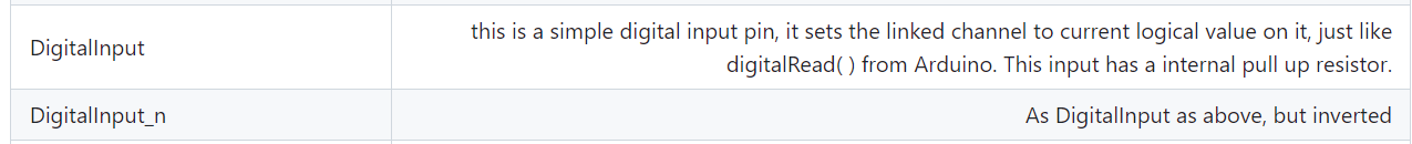

  • Use dInput_n or Toggle_inv for inverted logic
    #56 20770609
    Posts: 14797
    Rate: 12954
    I don't think we understand each other.
    If you want to invert at the read stage (because you're polling the relay state with the input, right?) then you have a choice:
    - dInput
    - dInput_n
    See:
    Table showing digital input options and their descriptions.
    Analogously, if you want to swap payload_on and payload_off, then you choose the "inverted" channel type, e.g.:
    - Toggle
    - Toggle_inv
