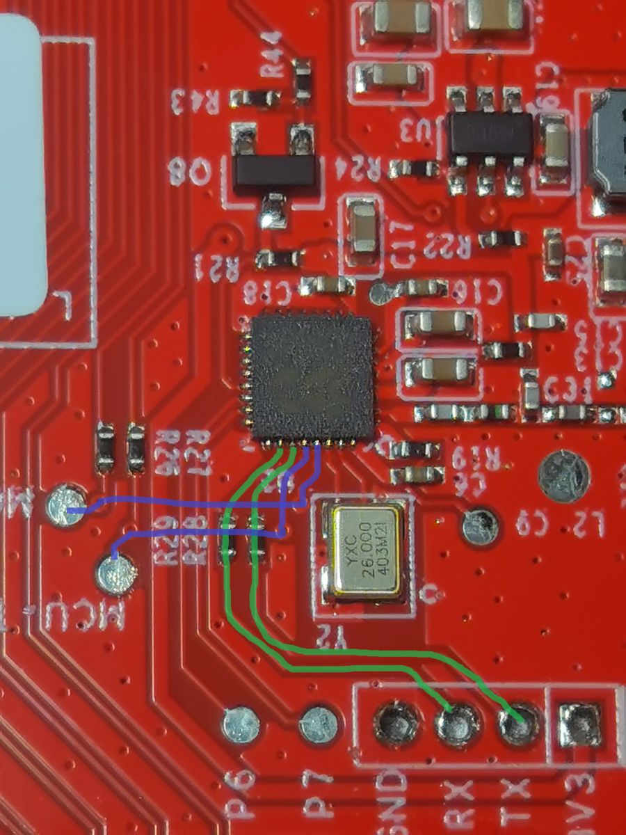

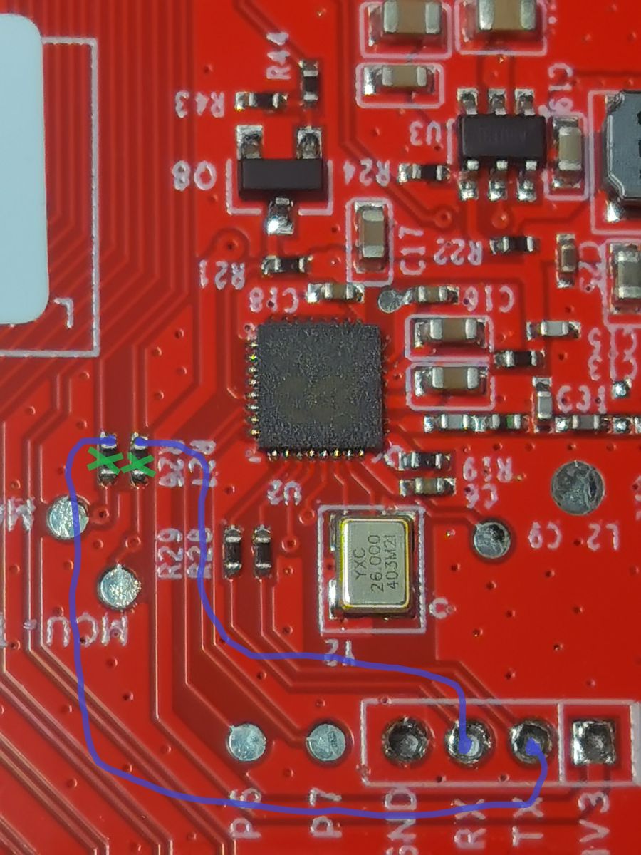

    Are you really sure that your device uses UART 2 for TuyaMCU?
    I also attached a photo of the device
    Image of a section of a red printed circuit board with visible traces and electronic components. Green and blue lines indicate UART1 and UART2 connections.
    UART1 Green lanes
    Blue UART2
    Have you tried to do Tuya config extraction to check the baud rate of the UART?

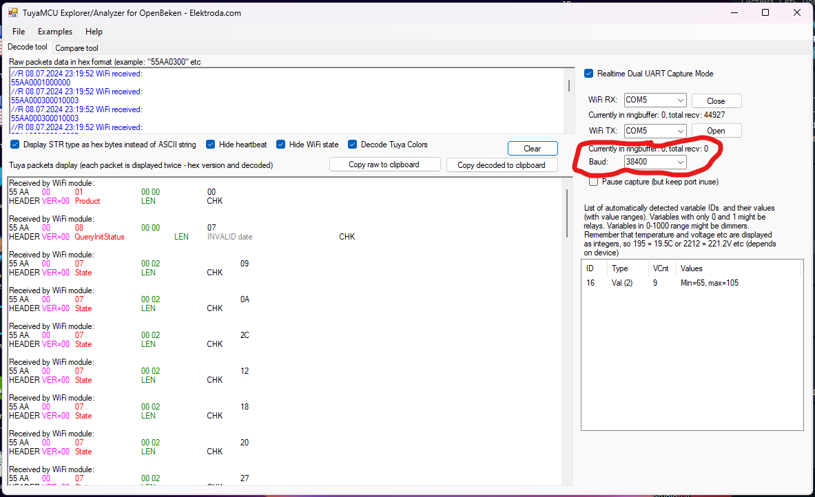

    Ok how do you power this device? Can you try to capture UART2 movement at 9600 and at 115200 bauds?
  • 34800 baud and Tuya MCU packet log
    #93 21147810
    hard3d
    Posts: 19
    Hi. I calculated the exchange rate using the selection method. 34800 baud
    That's what the module sends to the MCU:
    Enabling adding to the app:

    Wait a second, are you sure? Please double check. 34800 baud? That's not a standard one. So far we've only seen 9600 and 115200 bauds on TuyaMCU devices.
  • Failed key extraction from BK7231N config file

  • Backlight control via DP 106 still unknown
    #103 21254483
    hard3d
    Posts: 19
    I removed the specified resistors and connected the MCU to UART1
    PCB with removed resistors and MCU connected to UART1 with a blue outline.
    And with this autoexec.bat configuration, the module started receiving messages from the MCU

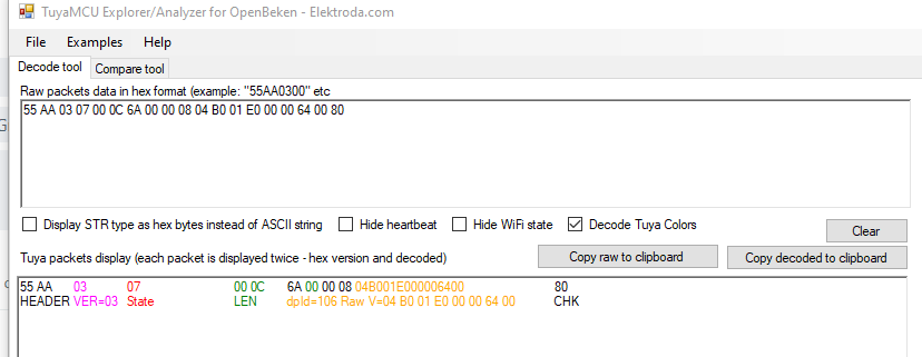

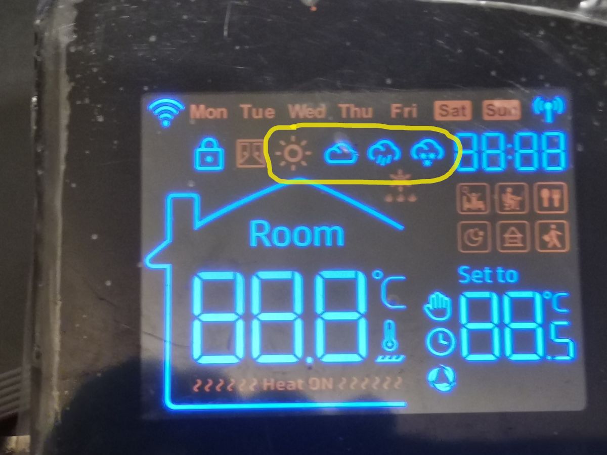

    I have a list of DP IDs. I managed to manage some of them. And the part I don't understand is how to send a command.
    D PID 106 must turn on the backlight.
    Thermostat...07_05.xlsx (12.5 kB)You must be logged in to download this attachment.

  • Use tuyaMcu_sendCmd for checksum-safe commands
    #104 21254908
    Posts: 14797
    Rate: 12954
    You can use tuyaMcu_sendState command. You should also try using tuyaMcu_sendCmd instead lf Uart send, so it calculates checksum on it's own.
    Sample usage:
    // tuyaMcu_sendCmd 0x30 000000
    // This will send 55 AA 00 30 00 03 00 00 00 32

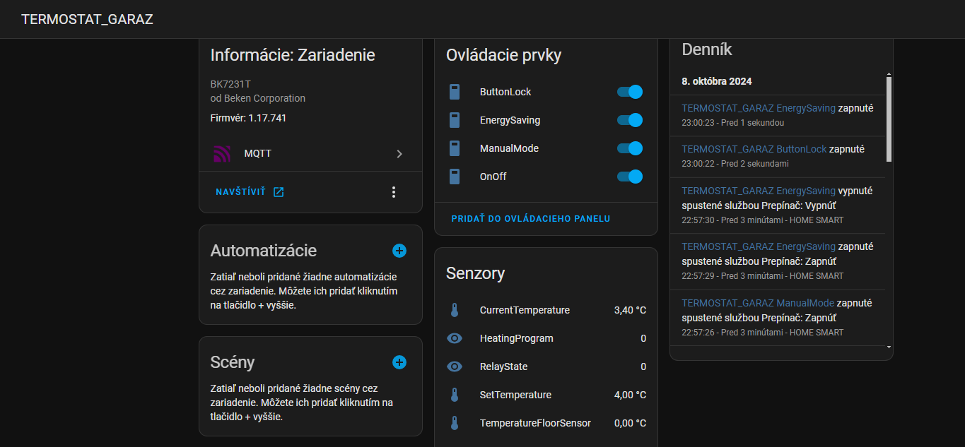

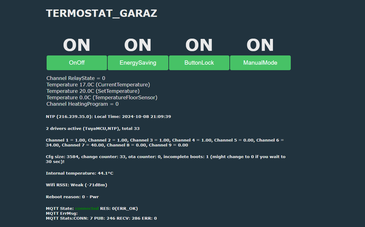

  • Home Assistant temperature scaling and control issue
    #105 21255785
    Janco245
    Posts: 6
    Hello everyone,
    I have 12 Moes BHT-002 thermostats at home, which originally used WB3S chips. I replaced these with ESP12 and uploaded the thermostat-v1.22-fas.bin.gz firmware. It works great, but the thermostats occasionally freeze, and I have to disconnect and reconnect the power to get them running again. I decided to revert back to the WB3S chips and try using the OpenBK firmware. However, I read that Tomik67 is also having freezing issues with this firmware.
    I am trying to use the code that Tomik67 wrote. The communication through the web interface works well, but I’m struggling to add the thermostat to Home Assistant (HA). It adds automatically, but the temperature is displayed incorrectly— the value of 17 is shown as 17x2/10=3.4. Additionally, there is no option to change the temperature.
    Is there a way to modify the code in OpenBK so that HA recognizes the thermostat correctly? Or is the only option to add it directly through YAML? I’ve tried to add the thermostat to the configuration.yaml following Tomik67 instructions, but I haven’t been successful so far. I don’t have much programming knowledge, so I would greatly appreciate any help.
    Thank you very much for any assistance!

    I'm still working on my thermostat. And there are 2 questions.
    1) There is DPIP 106 "Backlight Setting". 55 AA 03 07 00 0C 6A 00 00 08 04 B0 01 E0 00 00 64 00 80
    Which indicates the operating time of the backlight, brightness and status. Is it possible to somehow decompose blocks into variables and manage them from the main interface of the module? And how can HEX be sent from MQTT to TuyaMCU to manage this DPID?
    2) The thermostat has 4 icons of the current weather.
    Digital thermostat display with weather icons and temperature information.
    I know how to turn them on. Are there any developments on the request of the current weather by the module and the execution of any actions?

    1. it looks like a raw data packet:
    TuyaMCU Explorer software with data analyzer in hex format.
    Value seems to be 04 B0 01 E0 00 00 64 00, it should be possible to guess the meaning of each bytes but we would need to have separate captures with noted settings, like "this packet set 90% brightness" and then you look for value 90 (as hex), then the same for date, etc, etc. I don't think I can guess that without such sample data captures.
    2. I don't understand the question. Can you be more specific?
    How do you turn those icons on?
    You can request TuyaMCU data points via tuyaMcu_sendQueryState command, if that's what you're asking for?
    Or do you want OpenBeken to request weather from web?

    1) I have an explanation for each byte from the seller.
    Byte0 - Byte1: 完全关闭背光的起始时间,距离00:00的分钟数
    Byte2 - Byte3:完全关闭背光的结束时间,距离00:00的分钟数
    Byte4 - Byte5:屏幕熄灭到夜模式生效前的时间,单位秒
    Byte6:屏幕熄灭到夜模式生效前的背光亮度,1-100
    Byte7:夜模式是否使能
    2) Here is the HEX of enabling three icons.
    // The Sun
    55AA0034000A010200030201510301019C
    // Cloudy
    55AA0034000A01020012020146030102A1
    // Rain
    55AA0034000A010200030201500301039D
    As far as I understand, the original firmware determines the location of the device and the current weather by IP and includes the desired icon.
