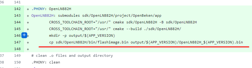

    I think we need to add a copy here for OTA file:
    A section of a build script in a Makefile with highlighted lines adding resources to the release.
    and it seems that final releases table is not updated yet, but it is trivial

    Updated PR: added OTA file to assets, added changes to release table (but I didn't figure out how to start automatic publication of a release in my fork to check the change).
    By the way, would you know how to build Simulator exe (Windows build) on Github Actions as well? I can provide necessary details if required. Simulator also has a self-test system, which would be a nice addition if it were automated.
    I don't have much experience with GitHub workflows, but quite a lot of experience with Linux. You can show me what you want to collect, and I will tell you if I can help with it.
    __
    Note: I have not yet tested the resulting images on real hardware. (I have the module, will read the instructions and try this weekend)

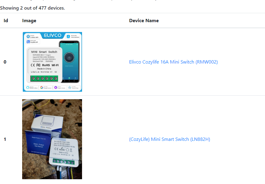

    I confirm that the LN882H gets very hot. A device with the relay turned off consumes approximately 0.6W connected to WiFi.
    I uploaded today`s OpenBK build, version 1.17.419. However, I had to reduce the writing speed because there was an error:
    LN882H_CMD_Tool.exe COMx download flash 115200 0x0 flashimage.bin
    I am posting the configuration of my switch, there is no point in creating a separate topic for it.
      "vendor": "CozyLife",
      "bDetailed": "0",
      "name": "CozyLife Mini Smart Switch LN882H",
      "model": "LN882H",
      "chip": "LN882H",
      "board": "LN-02",
      "flags": "1024",
      "keywords": [
        "TODO",
        "TODO",
        "TODO"
      "pins": {
        "0": "TglChanOnTgl;0",
        "1": "Rel;0",
        "19": "LED_n;0",
        "24": "Btn;0"
      "command": "PowerSave 1",
      "image": "https://obrazki.elektroda.pl/8132417200_1705759867.jpg",
      "wiki": "https://www.elektroda.pl/rtvforum/viewtopic.php?p=20919279#20919279"
    Pinout:
    A0 - S2 output (pulled up to 3.3V by a resistor)
    A1 - relay
    B3 - LED
    B8 - button
    Close-up of the CozyLife LN882H smart switch with visible user manual and packaging.

    Just confirming I have happily flashed OpenLN882H_1.17.421.bin to the 16A mini switch and then OTA updated to the same version successfully
    Added after 9 [minutes]:
    >>20919279
    What is the significance of the A0 setting? I omitted it on the Elivco posting
    The image shows two devices: Elivco Cozylife 16A Mini Switch (RMW002) and CozyLife Mini Smart Switch (LN882H) with product names and images.
Discussion focused on flashing OpenBeken on ELIVCO LSPA9 smart switch modules using the WL2S board with a Lightning LN882HK/LN882H chip. Initial UART bootlog capture was difficult, but later logs showed the chip uses a Tuya-based firmware and that the correct boot/debug output appears on TXD1 at 921600 baud. The community determined that BK7231/OpenBK binaries do not work on this platform and that LN882H requires its own SDK, flashing tools, and boot/download procedure. Progress included compiling and flashing SDK examples via KEIL/GCC, identifying J-Link SWD as a reliable way to erase/flash, and later confirming UART flashing is possible by grounding GPIOA9 and using LN882H_CMD_Tool with the correct baud rate. A Python flash dumper was created to back up flash and OTP, and the original firmware was successfully dumped and restored. OpenBeken was then ported far enough to boot, drive GPIO, create an AP, and later add STA support, with remaining work centered on OTA and further HAL integration.
