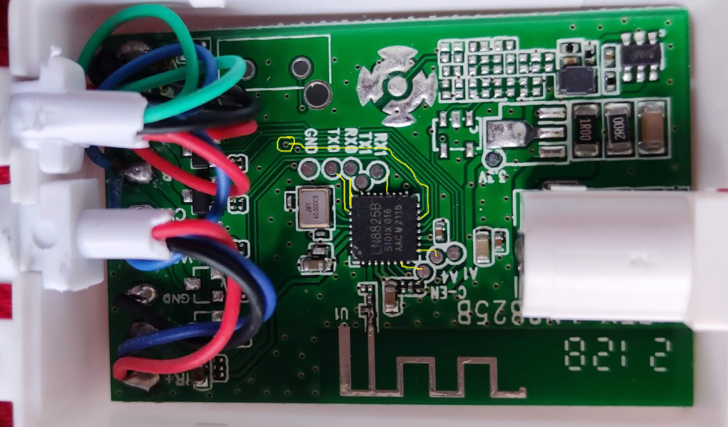

    I have a couple of unadulterated LN8825s at home. I will check them after work.

    @sweetlilmre is there a uart output of any kind when A9 is pulled low on boot to indicate the chip is in uart download mode?
  • A9 low boot gives no UART output

    I keep A9 pulled low throughout the flash dumping process (I've wired a jumper to GND and another to A9 and connect them before plugging in the USB UART).
    I assume you're getting failures of some kind when trying the script?
    Sorry for the late response, we've been deep in porting code.
    Also, I don't know if the ln8825 is compatible with the download tool?
  • A9 pad likely missing; flasher cannot enter download mode

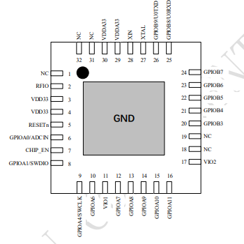

    me neither on whether it's compatible. I kinda hoped LN882X covered all variations, including LN8825B. I see now in the boot that ln882x is mentioned on this LN8825B device https://www.elektroda.com/rtvforum/topic4023264.html#20898850
    The trouble is this PCB doesn't have an obvious A9 pad. I *think* I've continuity (my multimeter probes are a bit fat) from what appears to be A9 pin on the chip and the hole circled yellow next to GND. Using this IC pinout diagram as a reference, the RX0/TX0/CEN/A4 all seem to match the LN882H pinout I found here http://www.scanway-tech.com/product/detail/47.html
    Close-up of a PCB with an LN8825B chip and wires.
    Diagram of the LN882H integrated circuit with labeled pins.
    I just get the standard boot output when it's grounded and this when trying flasher script
    LN882H flash dump tool v1.0
    Loading RAMCode...
    Error: Fail. Could not go in download mode.

    Your pinout and via connection look correct.
    This could be many things, incompatible software, different I/O used for boot mode, etc. I'm not sure. I guess we'll have to wait until some more info surfaces.

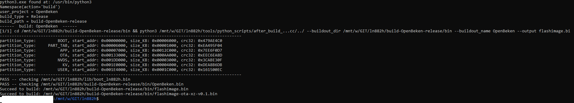

    #73 20899251
    Posts: 14770
    Rate: 12913
    OBK compiles on my side, with Main_Init and Main_OnEverySecond included. Of course, it doesn't mean that it works, but we'll see about that soon. I am unable to test yet as I don't have hardware but we will test with @sweetlilmre
    Console with the build process of the OpenBeken project on the LN882H platform.
    Added after 6 [hours] 14 [minutes]:
    We've got a first signs of life, OBK boot log on LN882H:
    ------  wifi_mcu_basic_example  ------
    TCP/IP initialized.
    LN882H SDK Ver: 2.1_rc1 [build time:Jan  9 2024 10:41:43][0x02010001]
    psk value :
    00000000:  22 8E A8 71 2B 82 E2 01  5A F7 3E F7 5C 90 A4 7E  "..q+...Z.>.\..~
    00000010:  89 AA C7 D5 6D 05 2A C1  29 EC 34 1E BB F4 A8 FF  ....m.*.).4.....
    00000020:  E3 E5 0A B8 BD 9E 97 F7                           ........
    [WLIB_I]LN882H WiFi Lib Ver: 1.3.0 [build time:Aug  7 2023 17:32:24][0x010300ff]
    [WLIB_I]SoftAP_Startup.
    SoftAP startup!
    +--------------- net device info ------------+
    |netif hostname: ln_softap                   |
    |netif ip      = 192.168.4.1                 |
    |netif mask    = 255.255.255.0               |
    |netif gateway = 192.168.4.1                 |
    |netif mac     : [00:50:C2:5E:88:99]         |
    [WLIB_E]HwEr:UKI:0
    [WLIB_I]Channel scanning not needed
    [WLIB_I]User Preferred channel idx 0-0
    [WLIB_I]Selecting 20MHz ch from One of ... 0
    [WLIB_I]Selected Channel Tbl Idx 0-0
    [WLIB_I]AP: Starting network in 0-0
    [WLIB_I]Connected.
    [WLIB_I]sta_conn_step_set: CONNECTED
    [WLIB_I]Status: Start Successful. Entering Enable State.
    [WLIB_I]Disconnected.
    [WLIB_I]User Preferred channel idx 5-0
    [WLIB_I]Selecting 20MHz ch from One of ... 0 1 2 3 4 5
    [WLIB_I]Selected Channel Tbl Idx 5-0
    [WLIB_I]AP: Starting network in 5-0
    [WLIB_I]Connected.
    Entering initLog()...
    Commands registered!
    initLog() done!
    Main_Init_Before_Delay done
    Main_Init_Delay
    Main_Init_Delay done
    Warn:CFG:CFG_InitAndLoad: Config crc or ident mismatch. Default config will be loaded.
    Info:CFG:CFG_SetDefaultLEDCorrectionTable: setting defaults
    Info:MAIN:Main_Init_Delay
    Info:MAIN:Using SSID []
    Info:MAIN:Using Pass []
    Info:MQTT:MQTT_RegisterCallback called for bT ln882h00000000/ subT ln882h00000000/+/set
    Info:MQTT:MQTT_RegisterCallback called for bT obks/ subT obks/+/set
    Info:MQTT:MQTT_RegisterCallback called for bT cmnd/ln882h00000000/ subT cmnd/ln882h00000000/+
    Info:MQTT:MQTT_RegisterCallback called for bT cmnd/obks/ subT cmnd/obks/+
    Info:MQTT:MQTT_RegisterCallback called for bT ln882h00000000/ subT ln882h00000000/+/get
    Error:CMD:cmd startScript NOT found (args autoexec.bat)
    Info:MAIN:Time 1, idle 0/s, free 106160, MQTT 0(0), bWifi 0, secondsWithNoPing -1, socks 0/0
    Info:MAIN:Time 2, idle 0/s, free 106160, MQTT 0(0), bWifi 0, secondsWithNoPing -1, socks 0/0
    Who can help with testing?

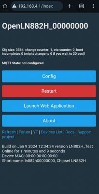

  • #76 20899787
    sweetlilmre
    Posts: 29
    First test image.
    Unzip it and flash with the download tool:
    LN882H_CMD_Tool.exe COM6 download flash 2000000 0x0 flashimage.bin
    (obv. replacing with your comport)
    Once the chip is reset you should see an AP:
    ssid: "LN_AP_8899"
    pwd: "12345678"
    You can connect and get to the OBK webpage on the default IP: 192.168.4.1
    Still a long way to go.
    -(e)
    • flashimage.zip (348.82 KB) You must be logged in to download this attachment.
  • #77 20900346
    Posts: 14770
    Rate: 12913
    I still don't have device to test it, but results are very promising. Who can help testing?
    Here is a screenshot from @sweetlilmre
    Screenshot of the OpenLN882H user interface with options for configuration and restart.

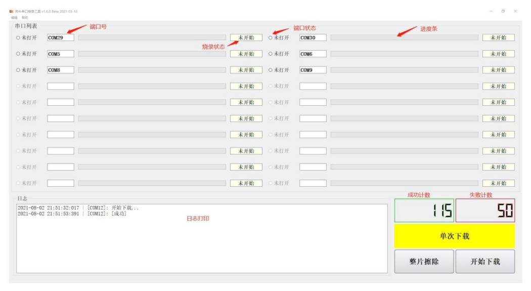

  • #80 20901738
    sithyoda
    Posts: 37

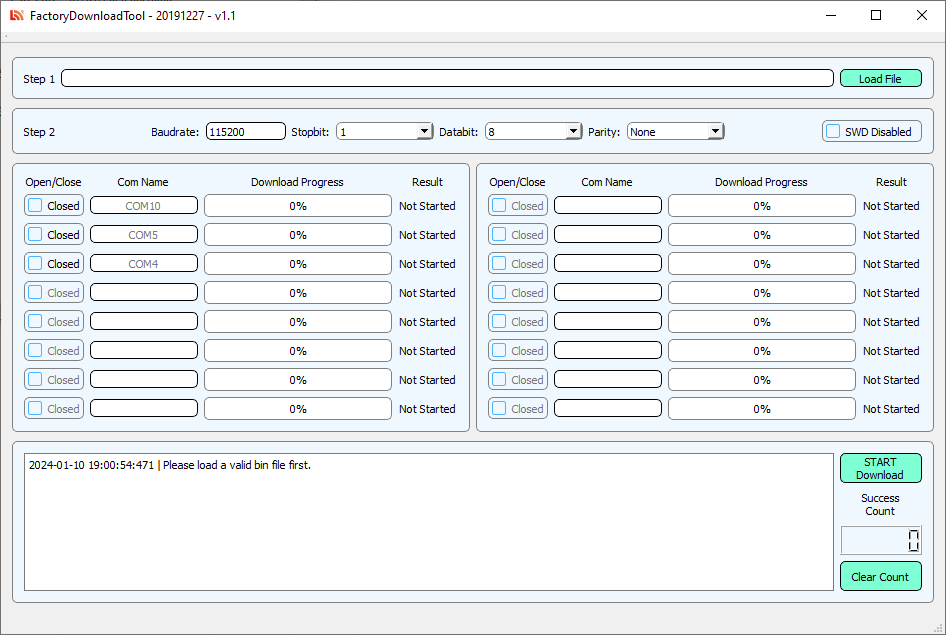

    Still struggling with uploading binary via UART mode to my WL2S module.
    I connected 3.3V, GND, RX, and TX to USB-TTL converter, GPIO A9 to GND (during start). But I get "Fail. Could not go in download mode" all the time.
    Can I simply flash this binary with J-Flash as well?
  • Different burning tool and GPIO config noted
    #81 20901870
    sweetlilmre
    Posts: 29
    divadiow wrote:
    sweetlilmre wrote:
    but there also seems to be a different tool
    thank you. Where in this doc are you seeing reference to a different tool? I've trawled through the LN882X areas looking for an exe but there only seems to be mkimage.exe, which appears to be for something else.
    I had a look couldn't remember and then found this doc. This looks like it may be the other burning tool found in the gitee repos posted about above: ln882h-document-collection
    Burning mode GPIO configuration is definitely different.
    Also, having a look, this is definitely a different chip, smaller flash size etc, so I'm not sure how far you'll get with the LN882H firmware, but it will be interesting to see. Definitely see if you can get the flash back up first!
    -(e)
    • Liangniu Serial Port Burning Tool Instructions for Use V0.01.pdf (459.37 KB) You must be logged in to download this attachment.

    #82 20901873
    sweetlilmre
    Posts: 29
    I connected 3v3, GND, RX and TX to USB-TTL converter, GPIO A9 to GND (during start). But I get "Fail. Could not go in download mode" all the time.
    You should be able to flash with SWD no problem. AFAIK you need to keep A9 connected to GND the whole time (before connecting UART and during the process, this is why I have soldered connectable jumpers to A9 and GND).
    Just to be sure, you are connecting RX0 and TX0, not RX1 and TX1?

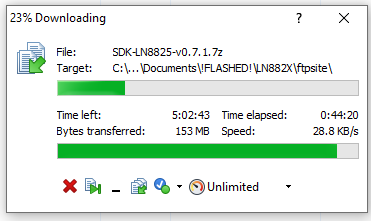

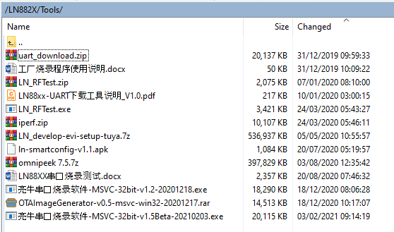

  • Lightning LN882HK PDFs and FTP source links
    #83 20902158
    Posts: 5220
    Help: 449
    Rate: 918
    >>20901870
    Thank you.
    I'll have a go at it. I'm just downloading everything from that FTP site also, but maybe it's the same as Gitee.
    ftp://sh.lightningsemi.cn:8621
    LN_Customer02
    111111

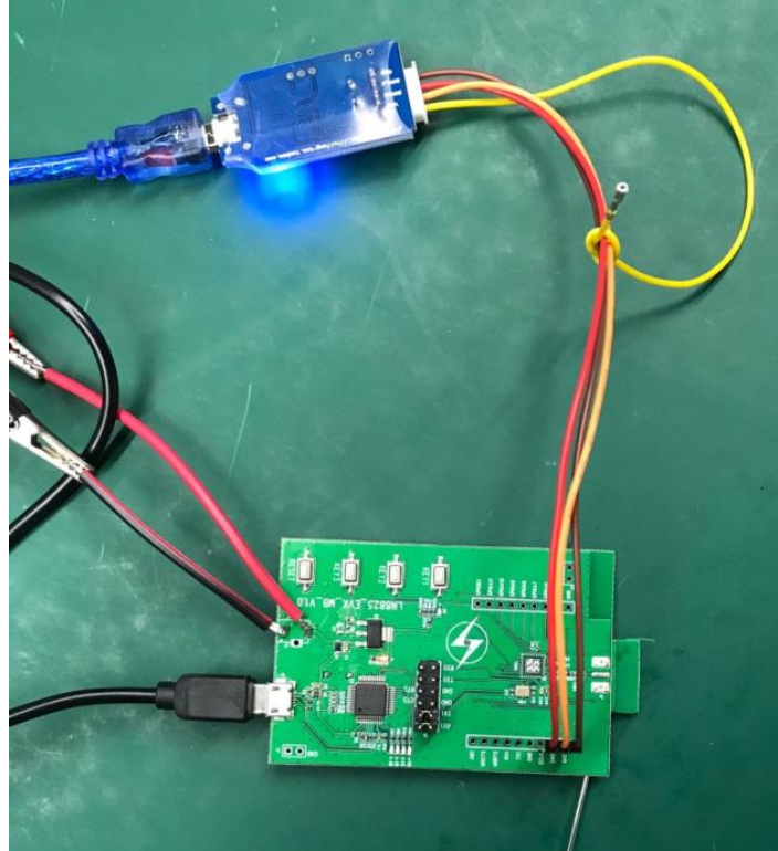

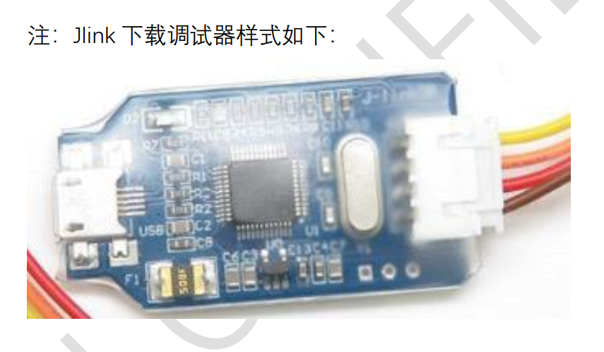

    I don't have any J-Link stuff, but I notice this device is shown in a couple of the PDFs
    Circuit board with connected cables and a blue USB module.
    Image of an electronic device with a microcontroller and cable connector.
    It looks suspiciously like https://www.aliexpress.com/item/1005005773672204.html

    I don't have a device to test this yet, but the results are very promising. Who can help with testing?
    I have an aftermarket switch on this chip, to be exact:
    Close-up of a circuit board with visible electronic components. With programming this I won't help, but once you have something ready I can upload and test it.
  • Different chip and flash size may limit LN882H firmware

    sweetlilmre wrote:
    Are you managing to download off of that FTP server?
    It keeps dropping the connection for me.
    If you can grab them, please PM me a link?
    No stopping yet but very slow. Will make available if I get it all
    Screenshot of a download progress window for a file named SDK-LN8825-v0.7.1.7z, downloaded to a location on a computer. The download is at 23% with a speed of 28.8 KB/s.
    Added after 27 [minutes]:
    the LN8825A looks to have 1mb but the LN8825B is 2mb. this would be OK?
    Comparison table of two chipsets, LN8825A and LN8825B, with different SIP Flash storage capacities. Memory map of LN8825A showing ROM, FLASH, and SRAM. Memory map of LN8825B showing sections like ROM, FLASH memory, SRAM, and others.

    interesting. there's another FTP and it has this tool
    Screenshot of the LN882X tools folder with files. Screenshot of FactoryDownloadTool - 20191227 - v1.1 with a list of COM ports and download status

    I'm looking for this flasher Screenshot of a flashing program showing COM ports and status indicators.

    >>20902394
    lol. It's here https://gitee.com/lightningsemi/pc-tool-release/tree/master
