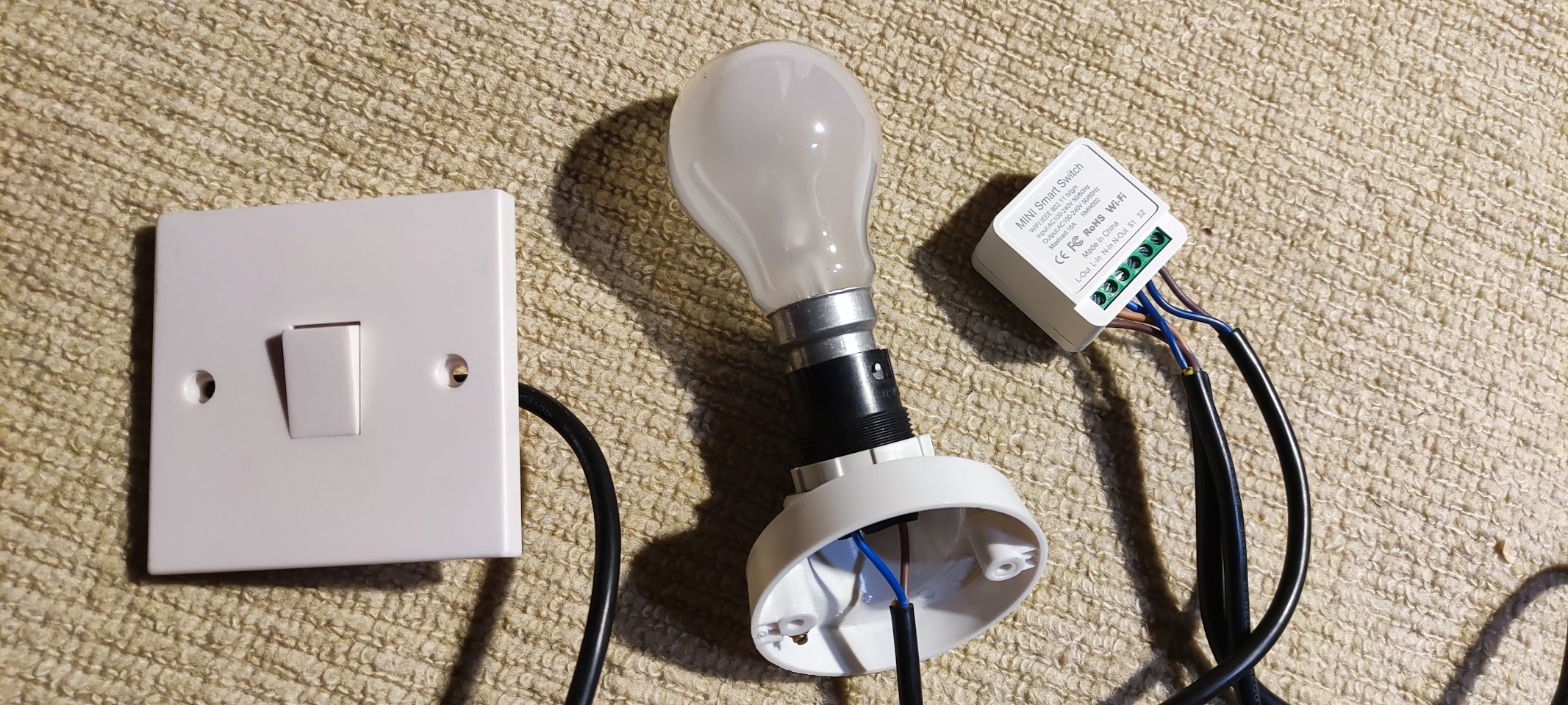

    >>20911994
    template updated to add TglChanOnTgl;0
    tested. same unit as GUTEK. please update device in list

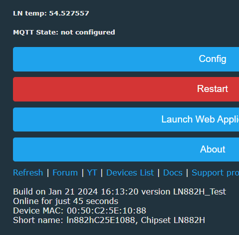

  • #158 20923632
    Posts: 5220
    Help: 449
    Rate: 918
    >>20921637
    Thanks. What is the significance of BLE /NO BLE?
    Power and temperature measurements for OTA builds
    #159 20923666
    @GUTEK@
    Posts: 1563
    Help: 163
    Rate: 386
    >>20921637
    I tested these builds by uploading via OTA. This is more indicative because I measured it with a wattmeter plugged into the socket. More accurate measurements would mean I would have to desolder the system again and connect it to the power supply. I can only do this on the weekend.
    So the measurements look like this:
    NO_BLE_NO_POWERSAVE - 0.6W; LN temp: 50.984253
    NO_BLE_MIN_POWERSAVE - 0.4/0.3W; LN temp: 41.141731
    NO_BLE_MAX_POWERSAVE - 0.4/0.3W; LN temp: 39.960632
    NO_POWERSAVE - 0.6W; LN temp: 56.102364
    MIN_POWERSAVE - 0.4W; LN temp: 43.503937
    MAX_POWERSAVE - 0.4W; LN temp: 42.322834
    Where it is 0.4/0.3W, the wattmeter simply showed such values alternately. The temperatures are also approximate because you would have to leave the system for a few minutes to stabilize.

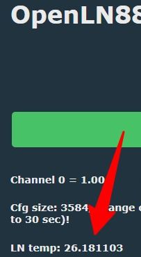

    ksichu
    Hello everyone, if I may join the discussion:
    I have a Cozylife Wifi Smart Switch based on LN882H
    https://pl.aliexpress.com/item/1005006088242391.html
    [in the pick3&save promotion it was for $2 ;) ]
    I loaded the MAX_POWERSAVE firmware from https://litter.catbox.moe/y9s2le.zip
    My measurements [of the desoldered system] look like this:
    firmware; MAX_POWERSAVE
    I-min...I-max: 55--95mA;
    temp [max]: 28*C
    voltage: 3.3V
    power min-max: 0.1815--0.3135W
    So the maximum power consumption during operation is 0.3W at a temperature of about 27*C
    Charged from an hour simultaneously by [ping -t] and toggle every 1 second.
    Pretty good.
    Therefore, it seems that the system itself works stably and does not heat up.
    Maybe it`s a relay or a poor power supply that is responsible for the heating of the whole thing?

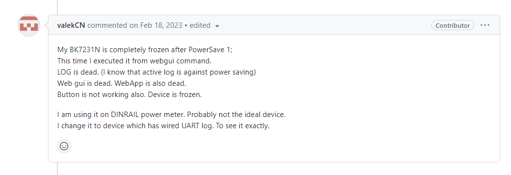

    #164 20926814
    Posts: 14770
    Rate: 12913
    tarwirdur wrote:
    Why powersave=1 is not default option for OpenBK7231T_App?
    There have been up to 3 powersave-related issues reported so far:
    - BL0937 power metering sockets lose their precision on powersave devices because BL0937 works by BK counting pulses on CF/CF1 pins
    - IR send/receive is said to work worse on BL0937 for the similiar reasons
    - there have been also some kind of early report that PowerSave broke something for one particular user but I don't know much about it
    Related issue:
    https://github.com/openshwprojects/OpenBK7231T_App/issues/678
    Screenshot of a comment by user valekCN on GitHub reporting an issue with the BK7231N device freezing after activating power saving mode.
  • #165 20929675
    ksichu
    @tarwirdur
    The given temperature is read from the firmware.
    Screenshot of OpenLN88 interface displaying a temperature of 26.181103°C.
    I also tried contact measurement on the chip itself using ds18b20.
    It comes out a bit more [max 28.5°C].
    [Battery powered + AMS1117 LDO 3.3V]
    After assembly and power supply from 230V, the temperature quickly reaches 45°C.
    The difference is clear, the conclusions are quite obvious ;)

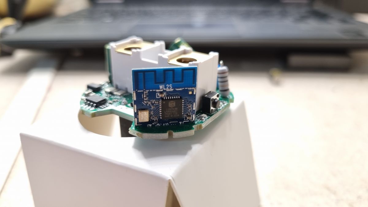

    I have this device now too. Shall I make a new post with opening and flashing experience @p.kaczmarek2 or just post OBK template here when I have flashed it? I like adding to the device list, especially new LN882 😀
    Added after 13 [minutes]:
    Well, similar, mine is labelled BSD34 not LSPA9, but it does have WL2S.

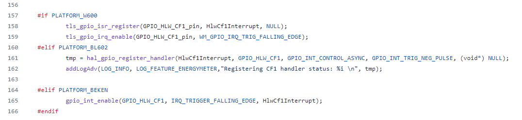

    Posts: 14770
    Rate: 12913
    Of course we can completly disable BLE, we are not using it currently. Why it was even on in the first place?
    We also need to add missing interrupts counter for BL0937 support, here:
    https://github.com/openshwprojects/OpenBK7231T_App/blob/main/src/driver/drv_bl0937.c
    Here is the snippet that must be extended:
    C program code with GPIO interrupt handling for different platforms.
    I think I've found an enumeration for that:
    Code: C / C++
    It seems like we could use this code to support BL0937:
    Code: C / C++

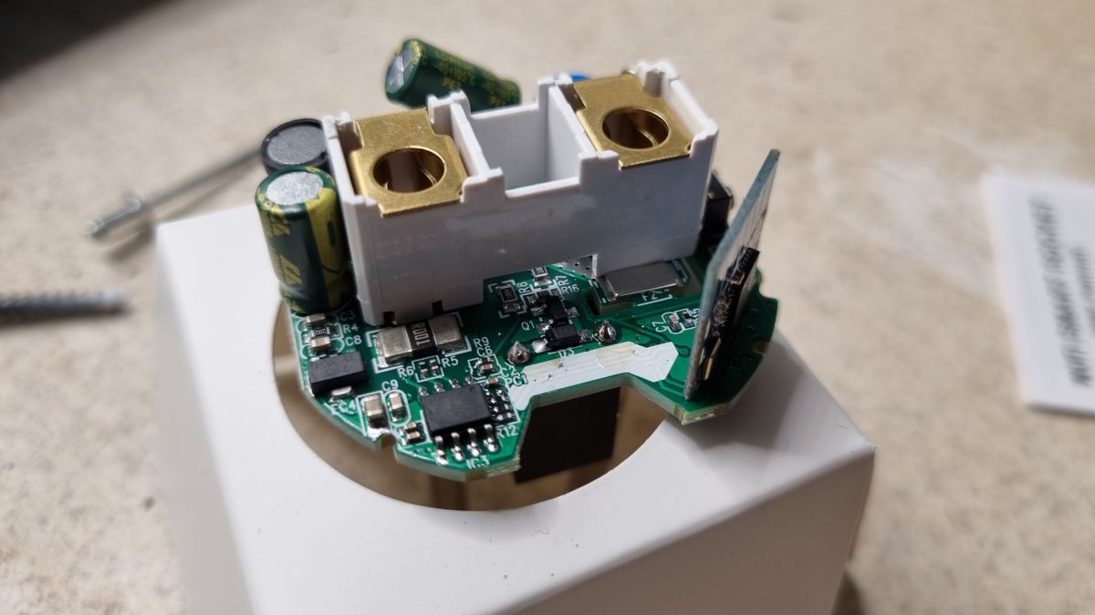

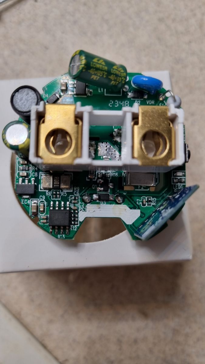

    I too have come across a socket with an LN882HKI chip on a WL2S module.
    Elivco brand socket supposedly 20A and relay only 16A WL2S module on a circuit board with LN882HKI chip PCB board of Elivco socket with LN882HKI chip Close-up of an electronic module with PCB and relay. .
    I uploaded the firmware with the Chinese GUI software at a speed of 115200.
    The configuration is almost good (about that below):
    The problem with the configuration is the Relay setting.
    In the REL setting, on relay on mode the red LED does not light, and on REL_n mode, the red LED lights up with the relay on but the status in OpenBeken is OFF (a status swap would be needed).
  • #177 21168472
    Posts: 14770
    Rate: 12913
    Or is it simply enough to replace the LED with LED_n?

    Dark Man
    Posts: 74
    Rate: 20
    You're right, stupid me didn't realise I had a separate LED channel here for relay status information, because 99% of the sockets I had only had one LED channel, and the eventual LED was connected to the relay.
    A propo. Have you perhaps solved the situation of one LED simply, for WiFi status info and at the same time for relay status as it is on the Tasmota?
