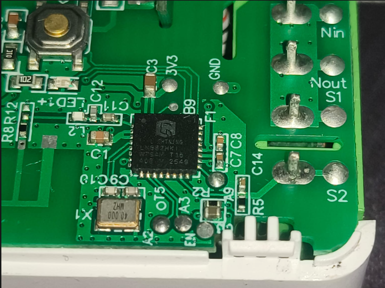

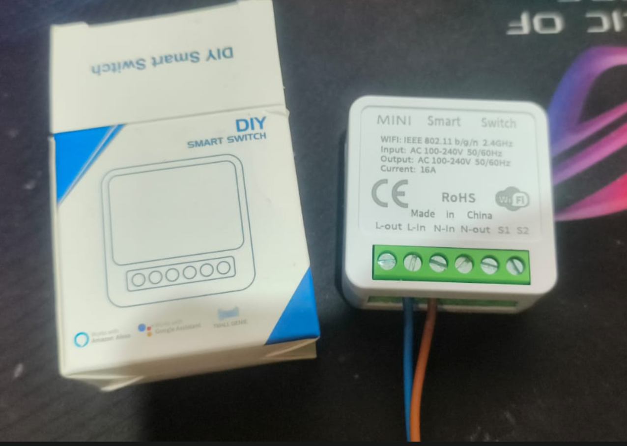

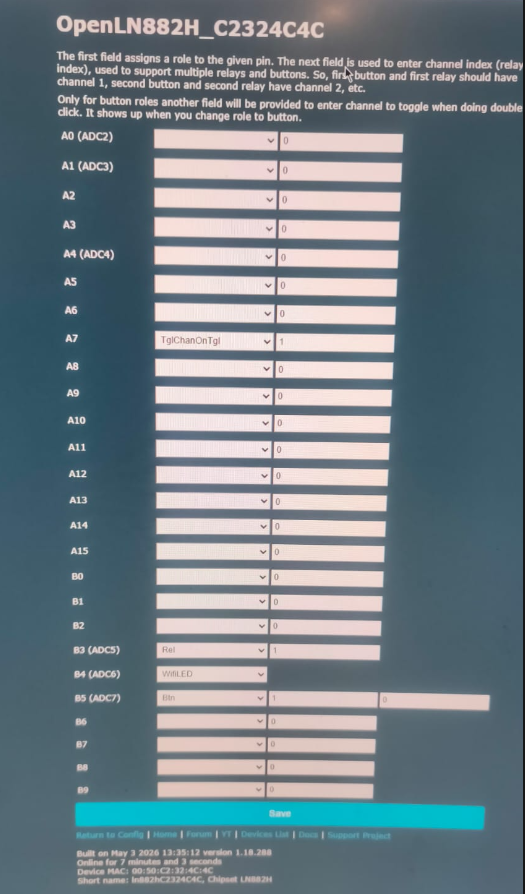

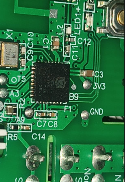

  • Disassembled module and shared LN882H pinout
    #183 21907068
    dsulv
    >>20914959
    Helo There, just dissemble mine
    detail packaging, internal board and working pin configuration attached :
    json pin configuration :
    Flashing OpenBeken Firmware on WL2S Module with Lightning LN882HK Chip for ELIVCO LSPA9
    hope these helps
    thanks.
