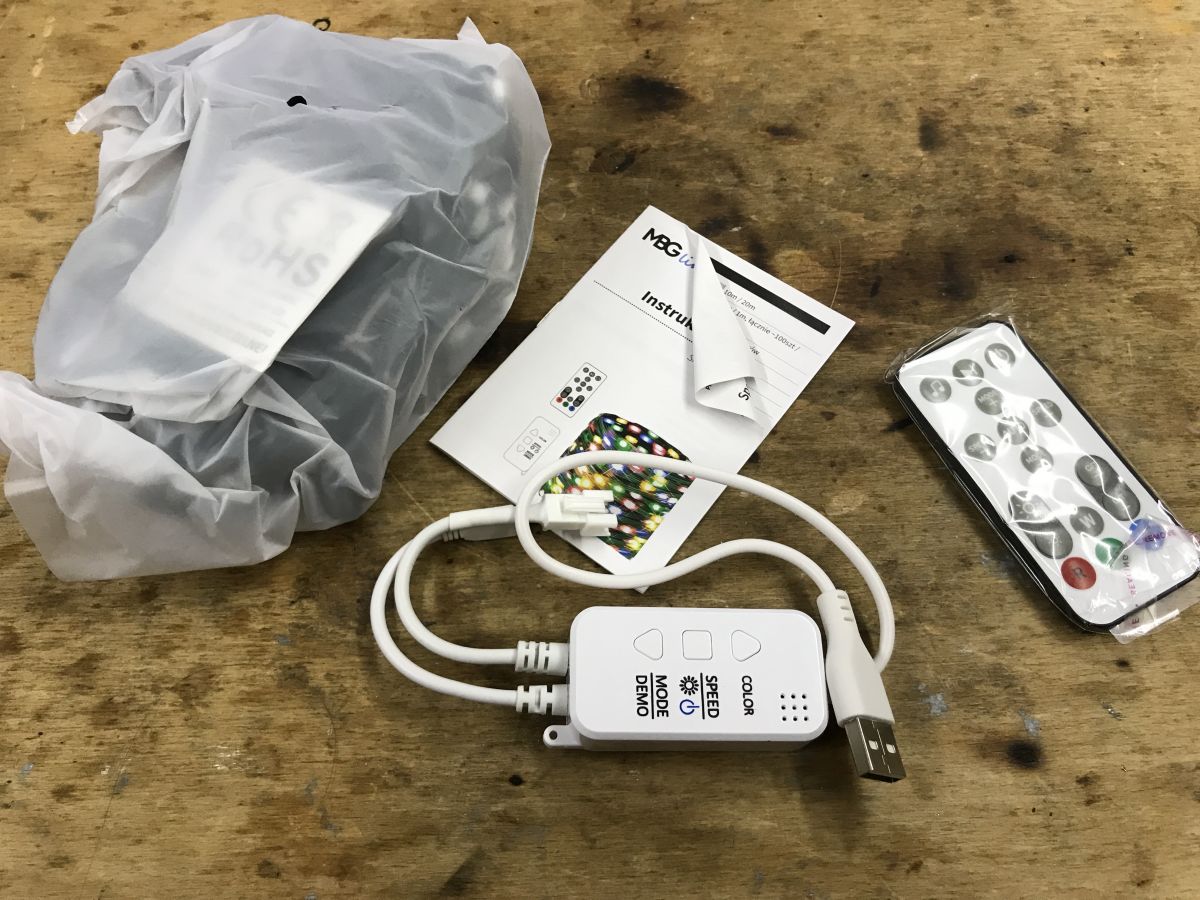

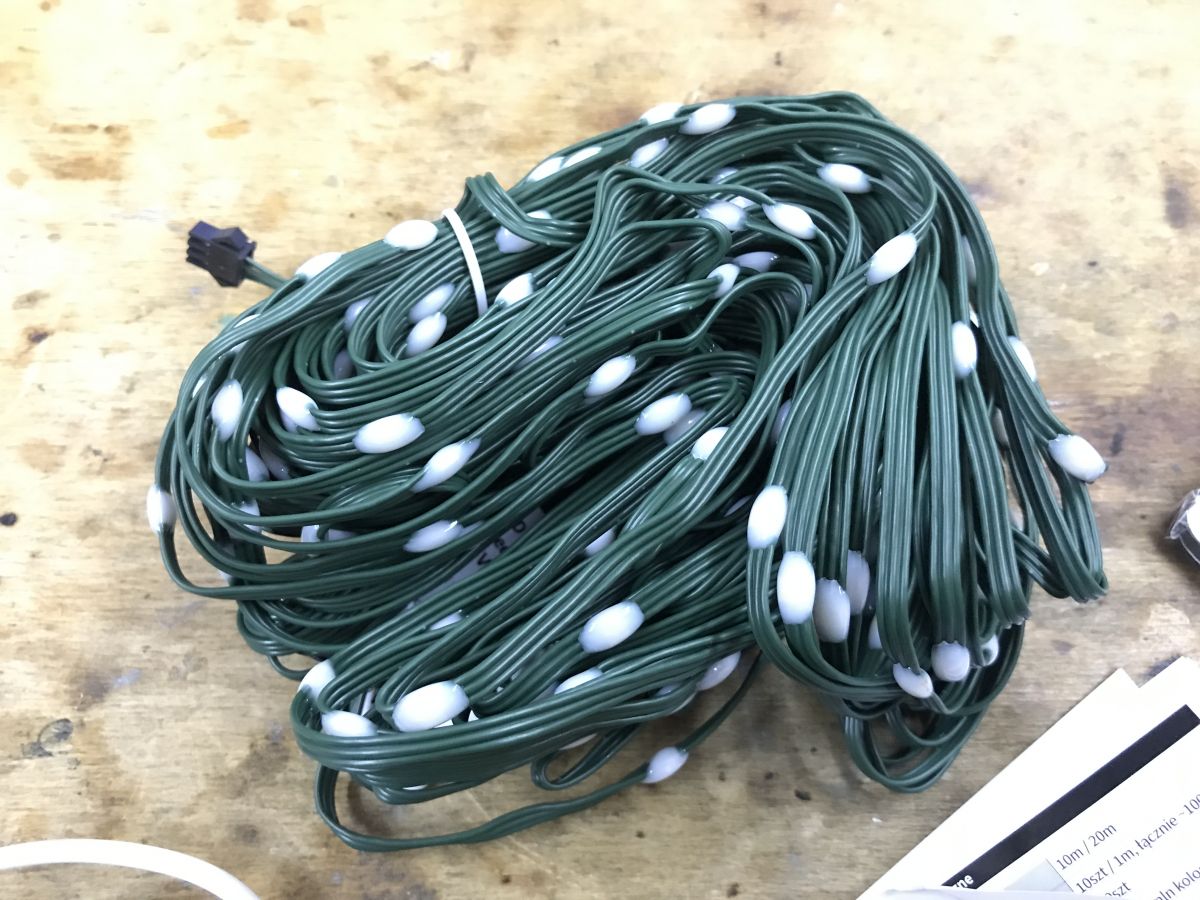

    A friend slipped me a rich festive set of individually addressable, colourful WS2812 LEDs for the Christmas tree. All controlled via WiFi, remote control and via buttons on the casing. Initially the friend wanted to use it with the Tuya app, but found that the app locks up on mode selection, so he gave me the task of reworking the whole thing to work with OpenBeken .
    The kit already includes LEDs (20 metres, 200 pieces) and was bought for PLN150. The LEDs are IP67 rated.
    Let's start with the packaging:
    Packaging of 20-meter RGB WiFi LED lights by MGB line. Packaging of the Christmas LED lights set MBG line CTree-001 .
    Model: CTree-001, MGB line LED lights CTree-001,20m.
    Contents as expected:
    CTree-001 LED light set with remote and instructions .
    Set of green Christmas tree LED lights with white diodes. .

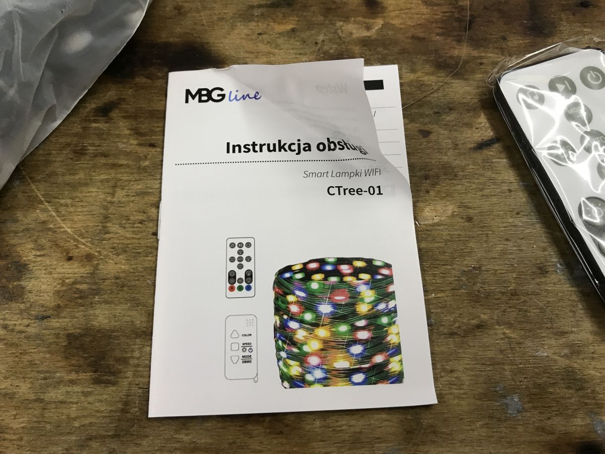

    Instructions:
    User manual for Smart WiFi Lights CTree-01 on a wooden surface. User manual of the Christmas LED set WS2812 CTree-001. Instruction manual showing the construction and connection of the LED set. Instruction manual for an LED set with buttons and QR codes. Instruction manual for an LED set with buttons and QR codes. .

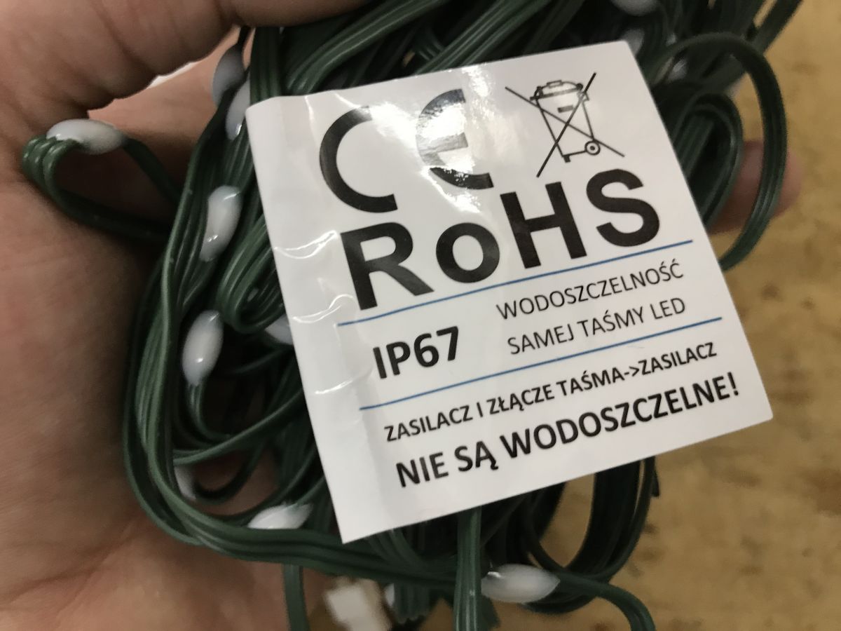

    The LEDs are IP67 waterproof:
    Close-up of a label indicating IP67 waterproof rating for LEDs .
    ... but the controller is not.

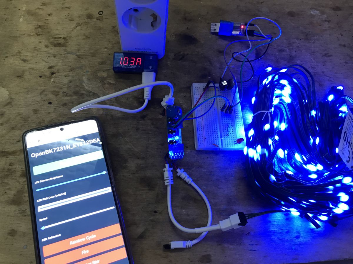

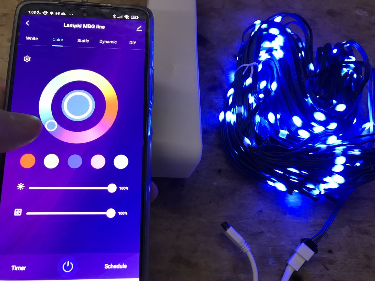

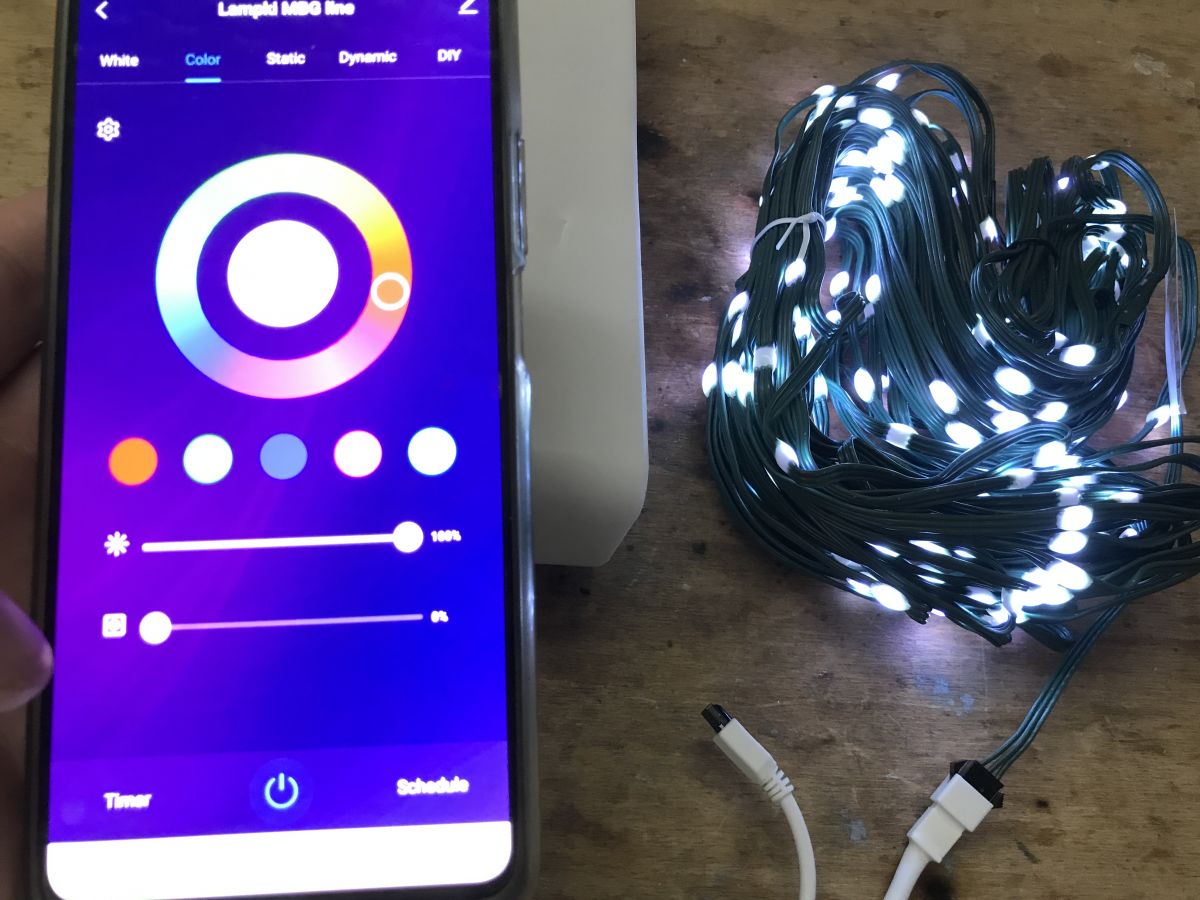

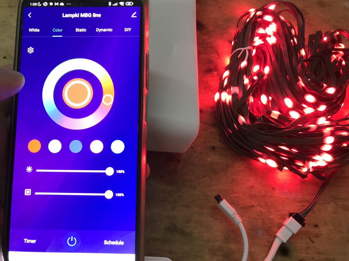

    Test with the Tuya app .
    The test with the Tuya app is to see if the problem reported by the reader occurs. I paired according to the instructions. Apparently the colour selection works:
    Smartphone app and blue glowing LED lights Phone with LED control app and red glowing WS2812 lights App with color selection screen and white LED lights on a table .

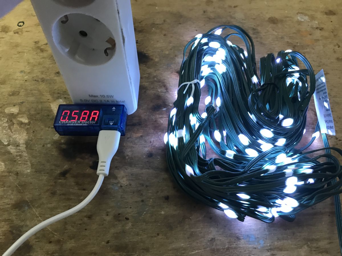

    In full white mode the strip does not even draw much current:
    Christmas LED lights turned on, with a power meter showing 0.58A. .

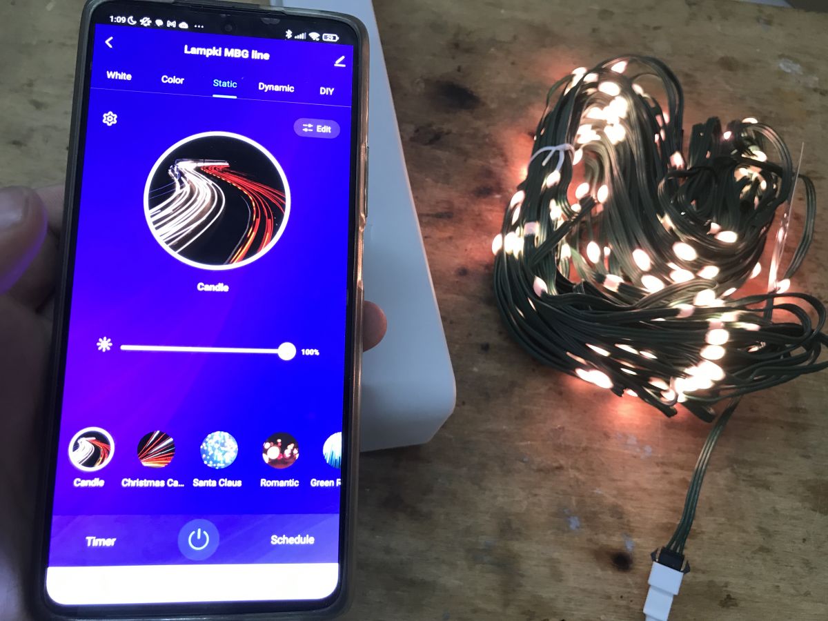

    I was also able to switch to static animation (from what I understand, this is a single colour animation):
    Smartphone with LED light control app next to Christmas lights on a wooden table. .
    Playing with the colours in the video:
    Then I wanted to switch to Dynamic/DIY, well that's where the app got stuck:
    So the reader was right. It is not possible to enable animation from within the app. Here you even have to change the firmware.

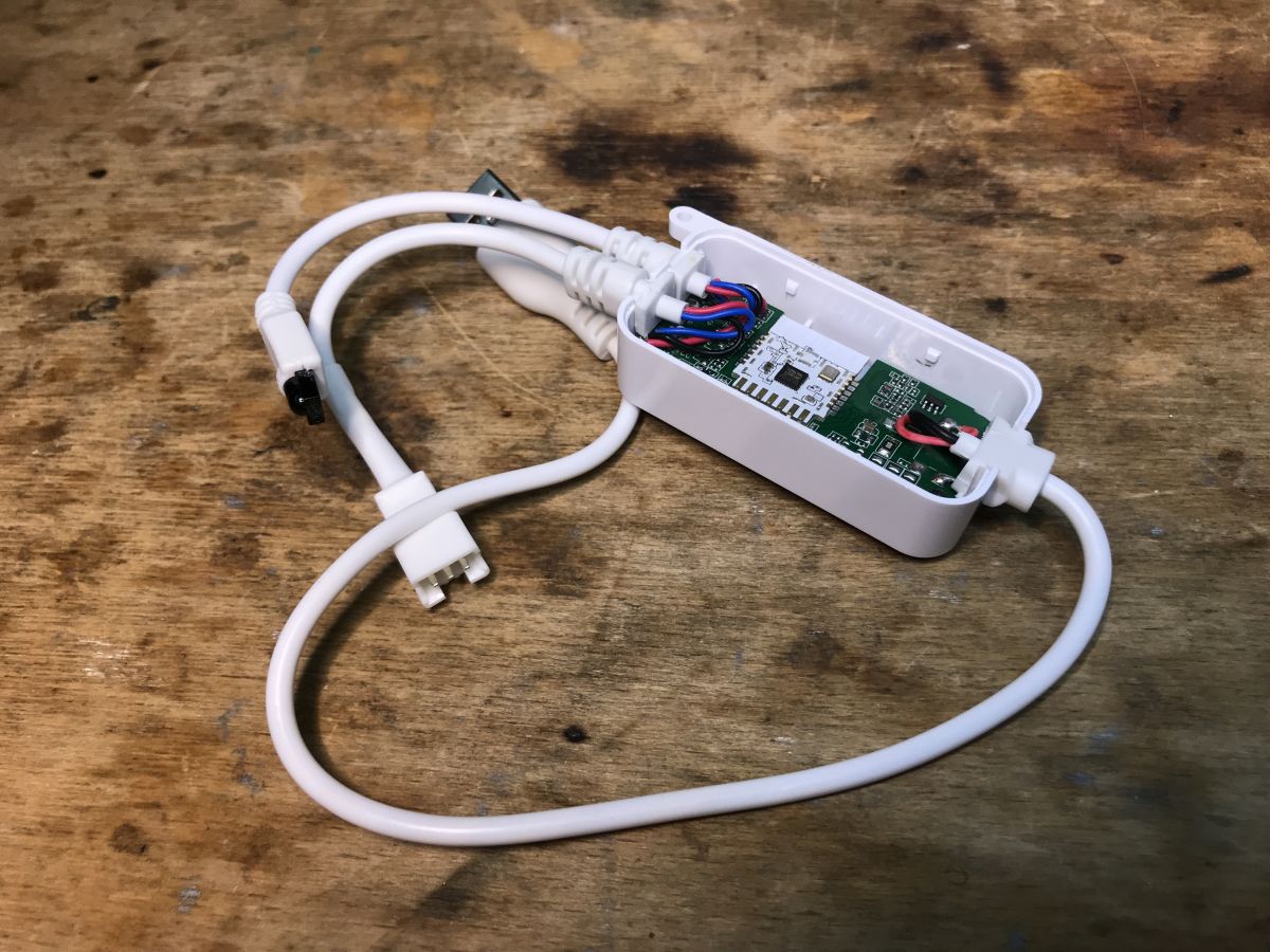

    Interior of CT001 .
    Lift the cover:
    Open LED controller casing with visible electronics and wires. .

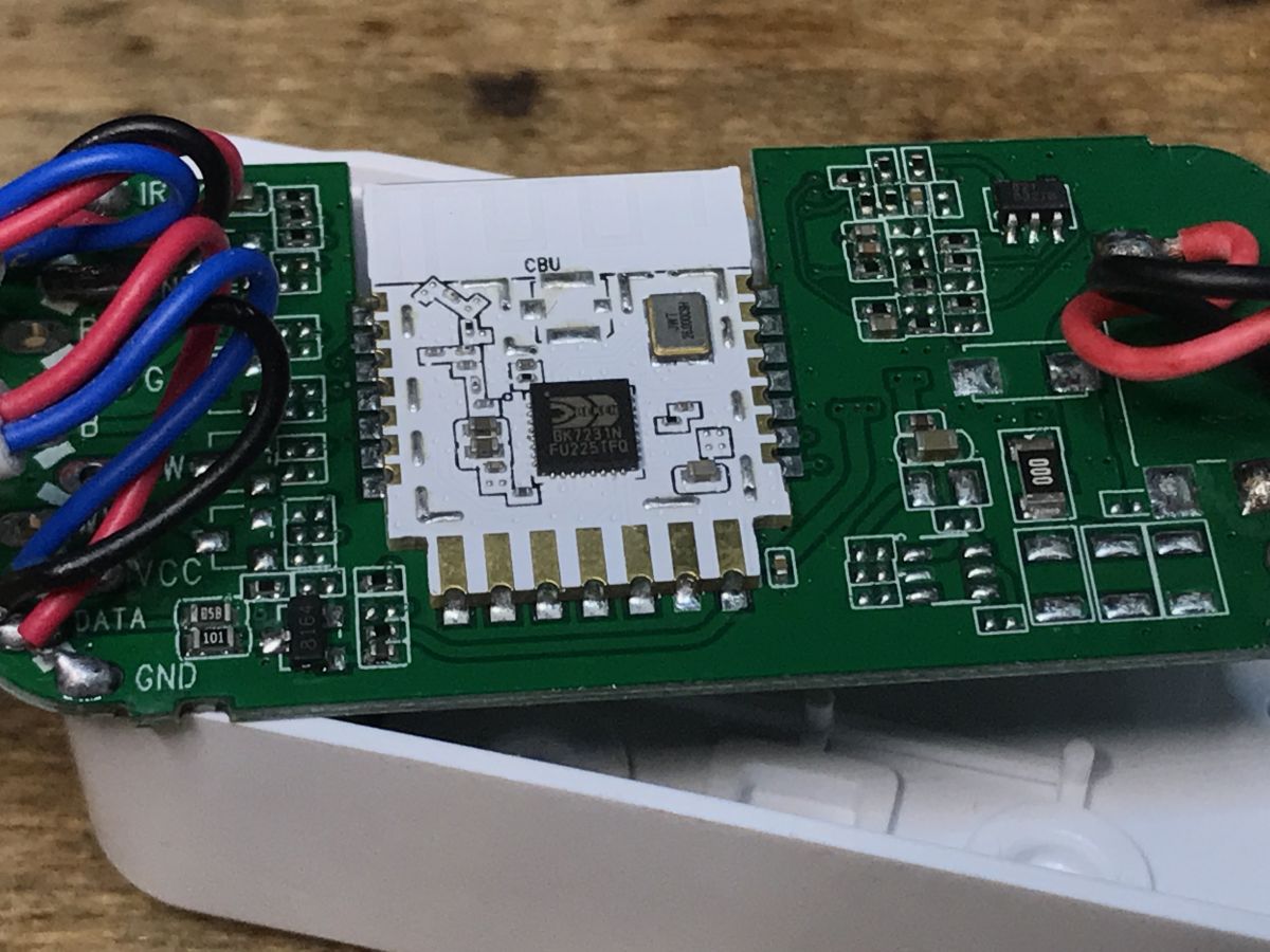

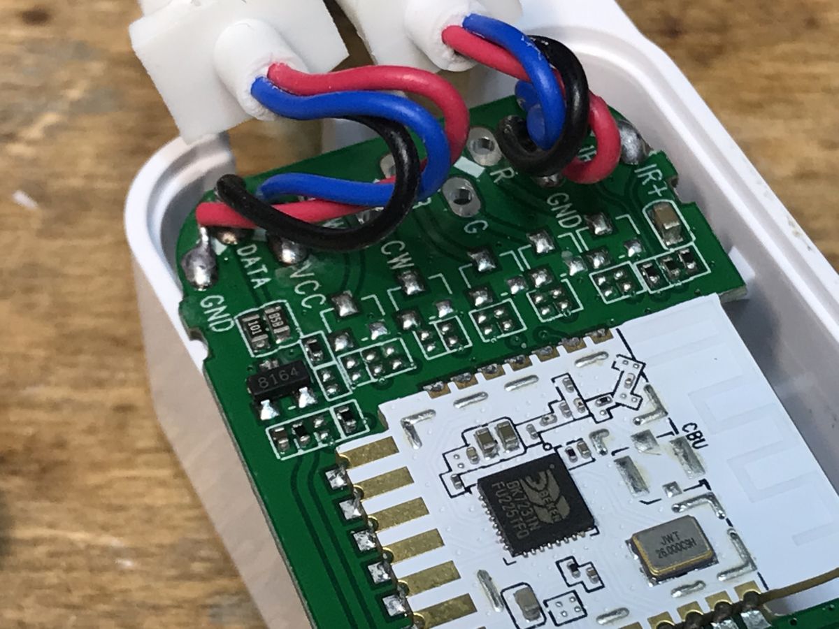

    Inside is the CBU module, or BK7231N. You can upload OpenBeken .
    Close-up of a circuit board with a CBU module and BK7231N chip. .

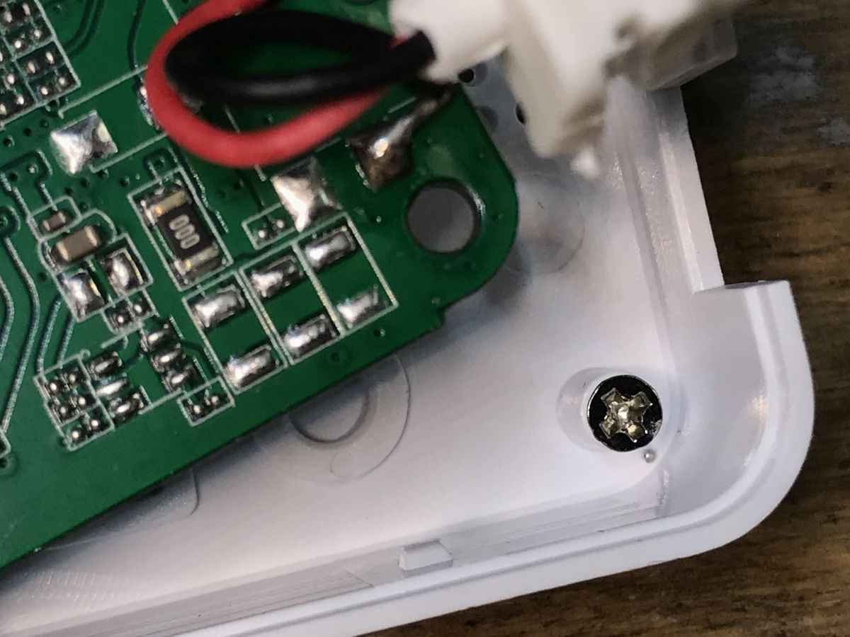

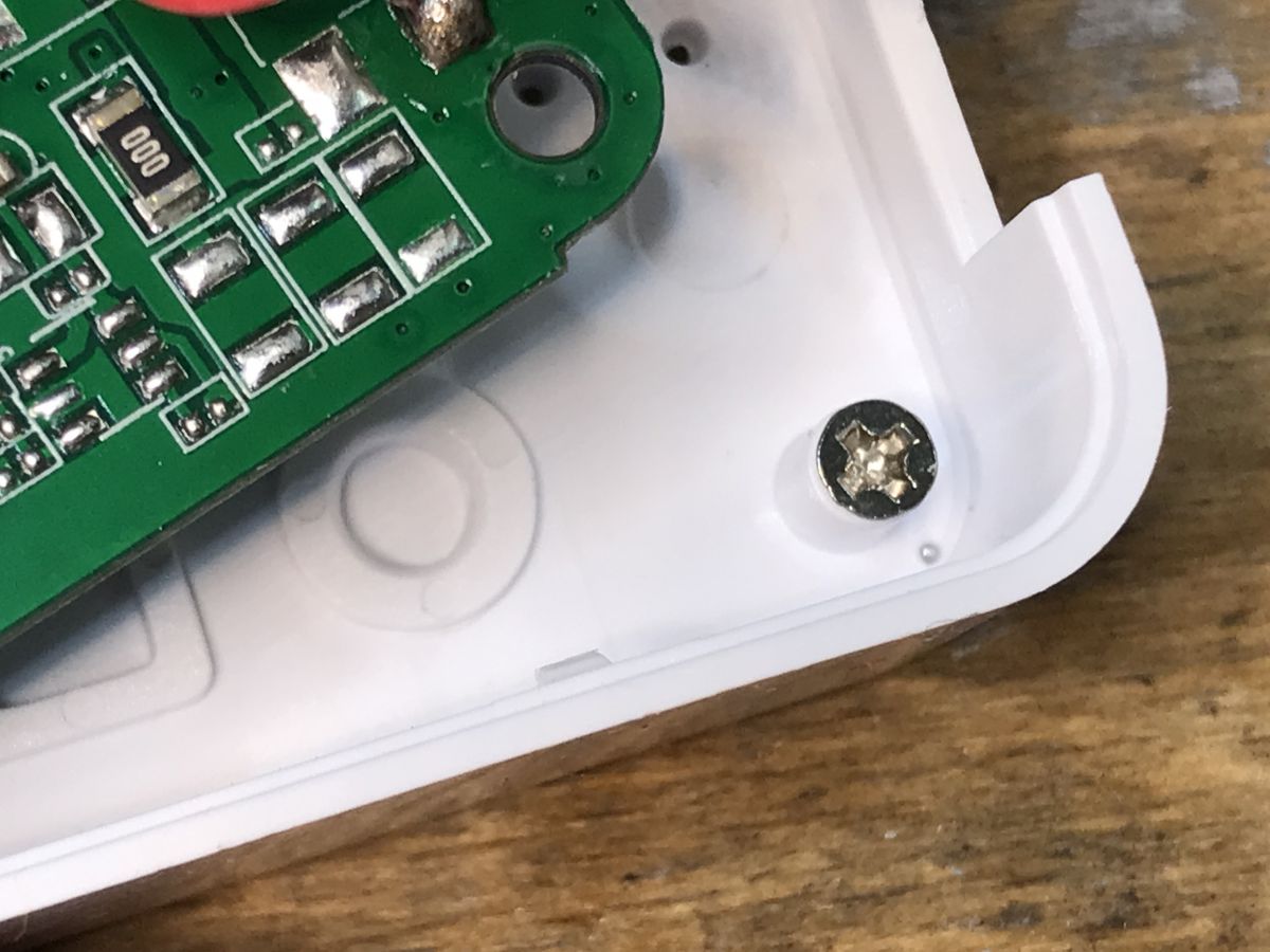

    I was also curious about the plate assembly - the screw is.... under the plate:
    Close-up of a circuit board with visible components and mounting screw Electronic board with screw in casing .
    And right next to it you can see a small ball of binder. With finer circuits, such balls like to make an unexpected short circuit.

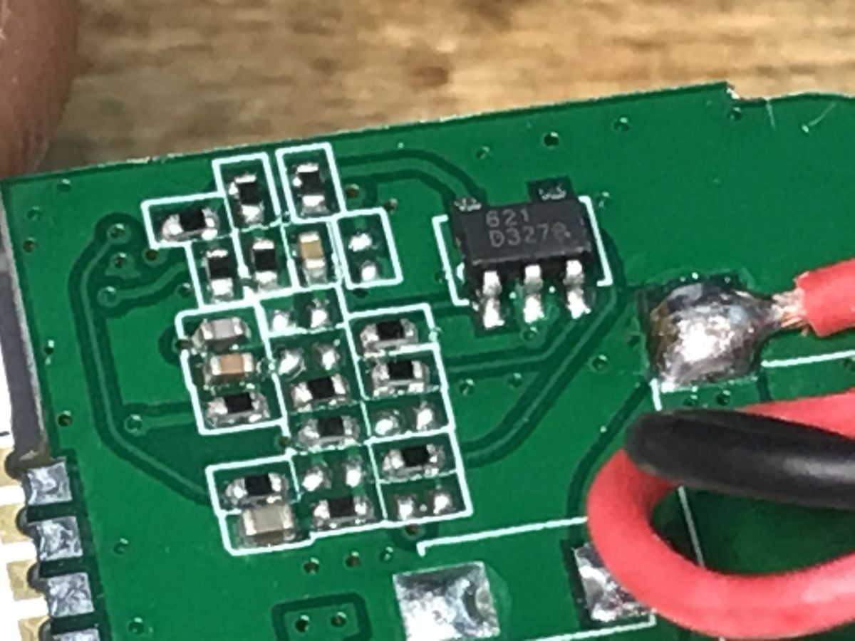

    Close-up of BK7231N chip on a circuit board Close-up of a printed circuit board with a 621 D3278 chip and soldered wires. .
    The circuit marked 621 D3278 is probably some sort of amplifier from a microphone, can anyone find its note?
    There's a place for transistors on the board, meaning this board is also for PWM-based strips, probably for five-channel (RGBCW):

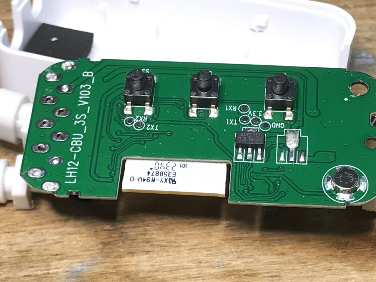

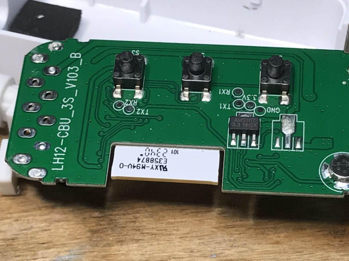

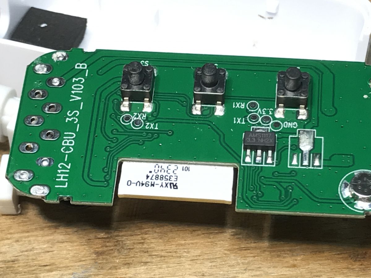

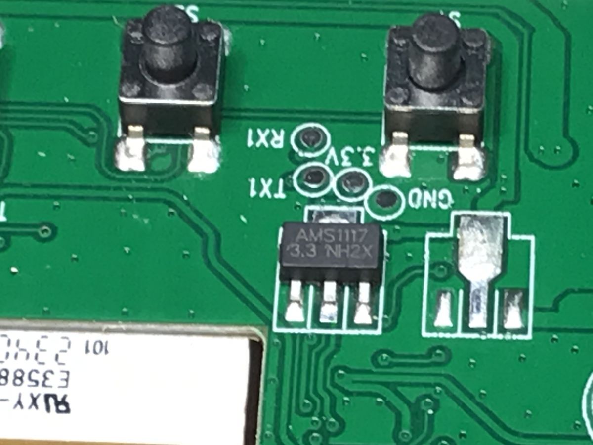

    On the other side there are buttons, there is a 3.3V LDO, programming pads and a microphone:
    Interior of LED controller with buttons on the circuit board Close-up of a PCB with two buttons and an AMS1117 chip. Printed circuit board with buttons and electronic components. Close-up of a circuit board with buttons and labels. Close-up of a circuit board with buttons and labels. .
    Changing CT001 firmware .
    As per our flasher's instructions:

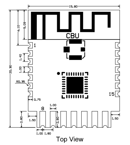

    CBU pinout:
    CBU module schematic with dimensions. .
    . . 12.
    Pin number . Symbol I/O type Function
    1 P14 I/O Common GPIO, which can be reused as SPI_SCK (Correspond to Pin 11 of the IC)
    2 P16 I/O Common GPIO, which can be reused as SPI_MOSI (Correspond to Pin 12 of the IC)
    3 P20 I/O Common GPIO (Correspond to Pin 20 of the IC)
    4 P22 I/O Common GPIO (Correspond to Pin 18 of the IC)
    5 ADC I/O ADC, which corresponds to P23 on the internal IC (Correspond to Pin 17 of the IC)
    6 RX2 I/O UART_RX2, which corresponds to P1 on the internal IC. (Correspond to Pin 28 of the IC)
    7 TX2 I/O UART_TX2, which is used for outputting logs and corresponds to P0 of the internal IC (Correspond to Pin 29 of the IC)
    8 P8 I/O Support hardware PWM (Correspond to Pin 24 of the IC)
    9 P7 P7 I/O Support hardware PWM (Correspond to Pin 23 of the IC)
    10 P6 I/O Support hardware PWM (Correspond to Pin 22 of the IC)
    11 P26 I/O Support hardware PWM (Correspond to Pin 15 of the IC)
    12 P24 I/O Support hardware PWM (Correspond to Pin 16 of the IC)
    13 GND P Power supply reference ground
    14 3V3 P P Power supply 3V3
    15 TX1 I/O UART_TX1, which is used for transmitting user data and corresponds to Pin 27 of the IC. For the MCU solution, please refer to CBx Module.
    16 RX1 I/O UART_RX1, which is used for receiving user data and corresponds to Pin 26 of the IC. For the MCU solution, please refer to CBx Module.
    17 . P28 I/O Common GPIO (Correspond to Pin 10 of the IC)
    18 CEN I/O Reset pin, low active (internally pulled high), compatible with other modules (Correspond to Pin 21 of the IC)
    19 >Reset pin, low active (internally pulled high). 19 P9 I/O Common GPIO (Correspond to Pin 25 of the IC)
    20 P17 I/O Common GPIO, which can be reused as SPI_MISO (Correspond to Pin 14 of the IC)
    21 P15 I/O Common GPIO, which can be reused as SPI_CS (Correspond to Pin 13 of the IC)

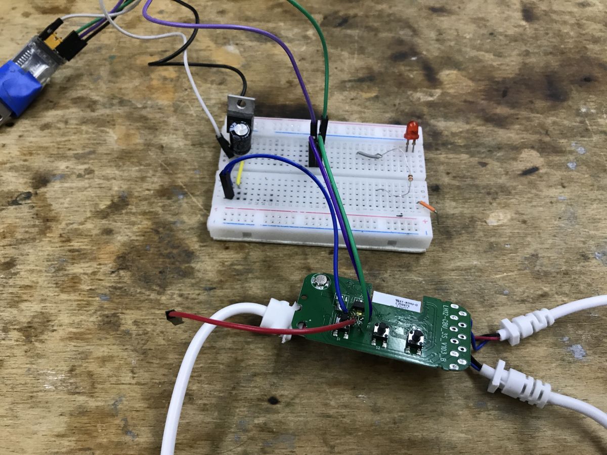

    Test point point CSN I/O Mode selection pin. If it is connected to the ground before being powered on, enter the firmware test mode. If it is not connected or connected to VCC before being powered on, enter the firmware application mode. Correspond to Pin 19 on the internal IC.
    But I haven't even used it here, because there are pads after all....
    Electronic assembly kit on a breadboard.
    Flashing went smoothly, OpenBeken created its access point, where I entered my WiFi details .
    Discovery of GPIO roles, buttons .
    The WS2812 is definitely connected at P16 - this is the BK7231's hardware SPI output, which is used to control just these types of LEDs via DMA.
    The microphone is on an ADC, or P23. This is the only ADC on the BK7231.

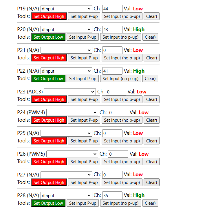

    What remains is the location of the buttons. This is where GPIO Doctor can be used:
    GPIODoctor in OpenBeken - a convenient way to learn about GPIO roles in an IoT device .
    Results:
    Screenshot of GPIO configuration in OpenBeken interface .
    The question of the IR receiver remains. Here I used an ohmmeter. There was a resistance of 100 ohms from the IR to the corresponding pin.

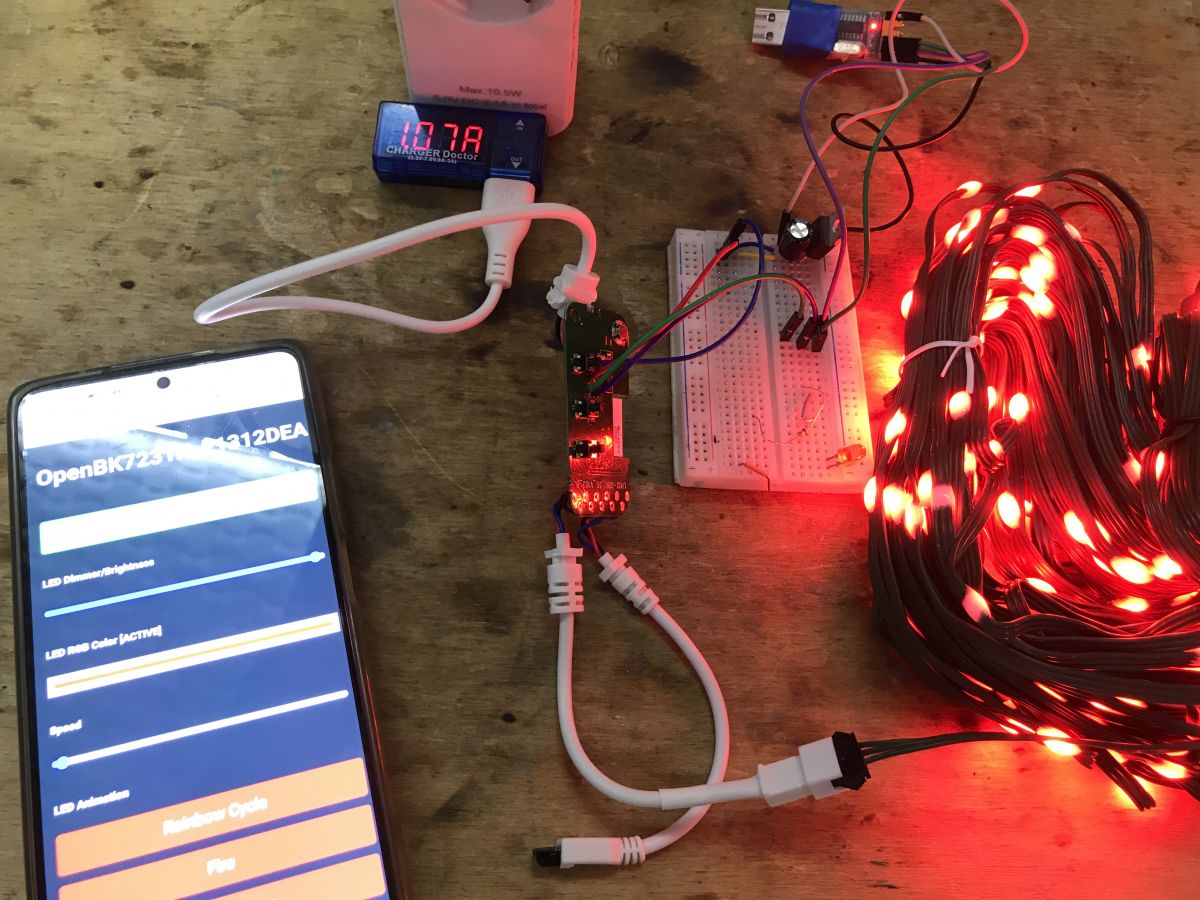

    This will provide us with a basic colour and animation system, but for now without buttons or remote control....
    Here I only had to specify the colour format - GRB. Used autoexec.bat:
    startDriver SM16703P
    SM16703P_Init 200 GRB
    startDriver PixelAnim

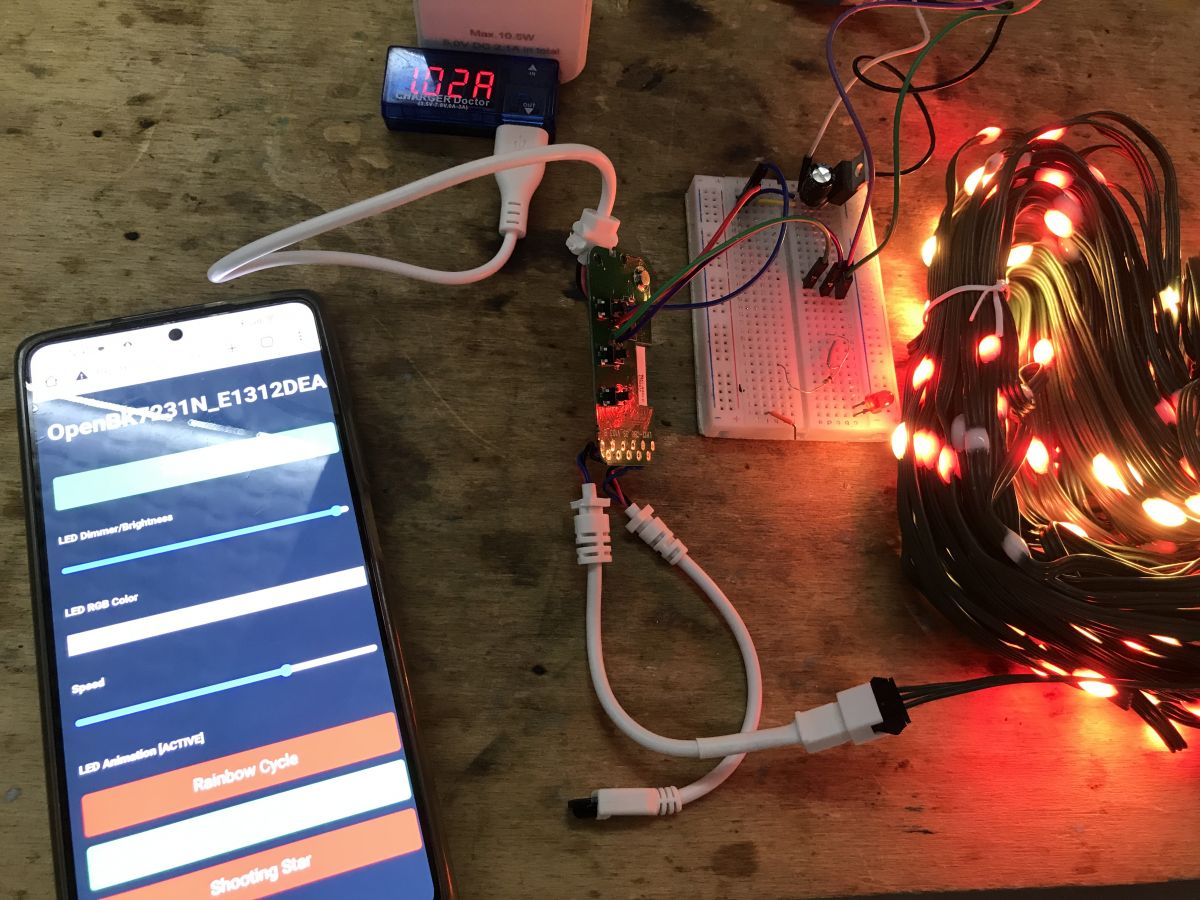

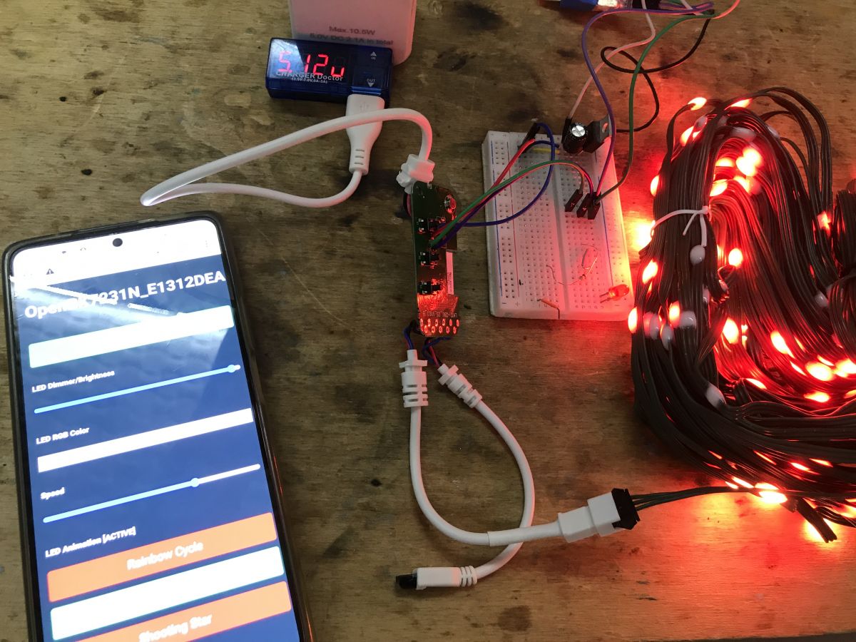

    A brief demonstration of the operation:

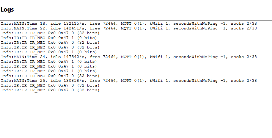

    OpenBeken includes an IRRemote port, so it can support different remotes. You just need to know the correct codes. The received IR codes will appear in the Web app Log when you select the IRRecv pin role in the GPIO configuration and fully reboot:
    Log recording IR codes from the WS2812 LED light controller. .
    This is what it looks like live - I have the Web App log open and look at what codes are being received:

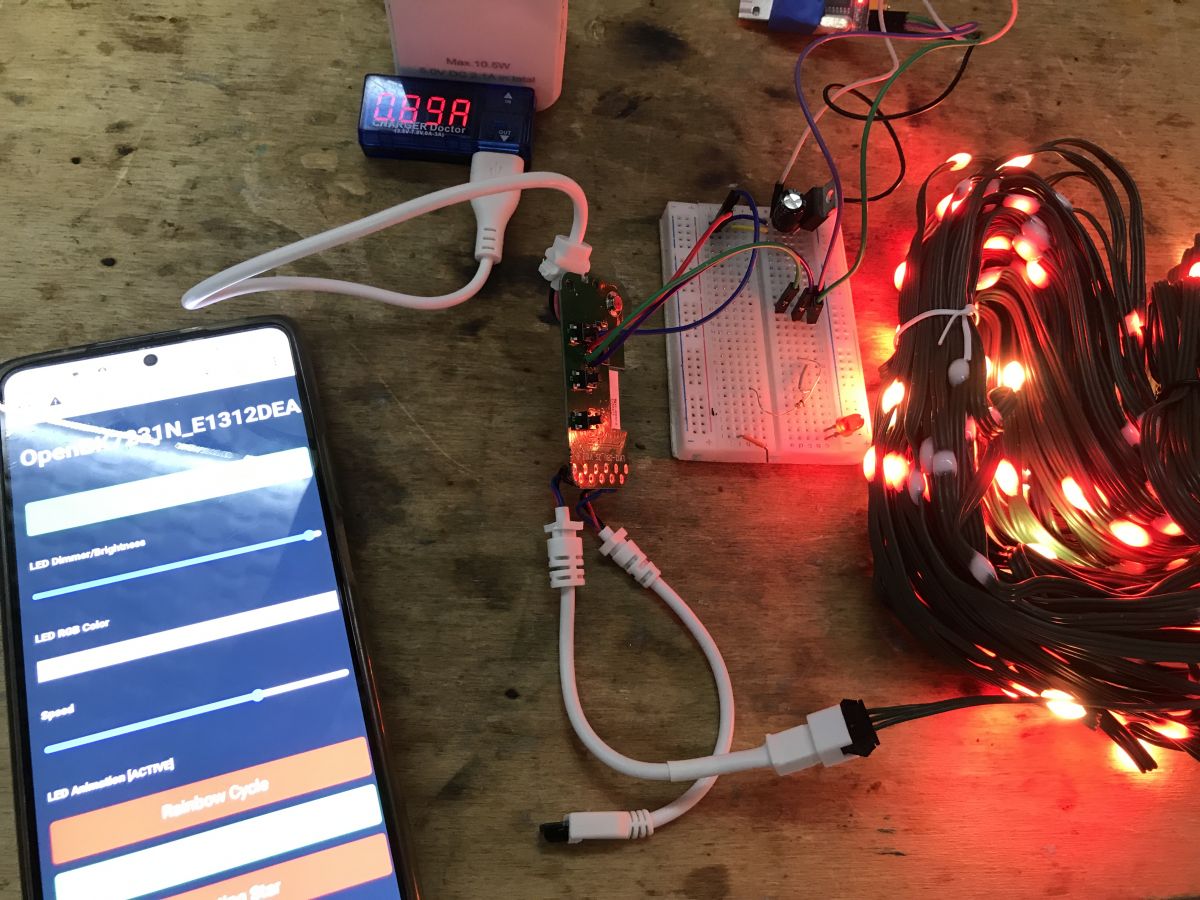

    The remote control works (even at a rather awkward angle):

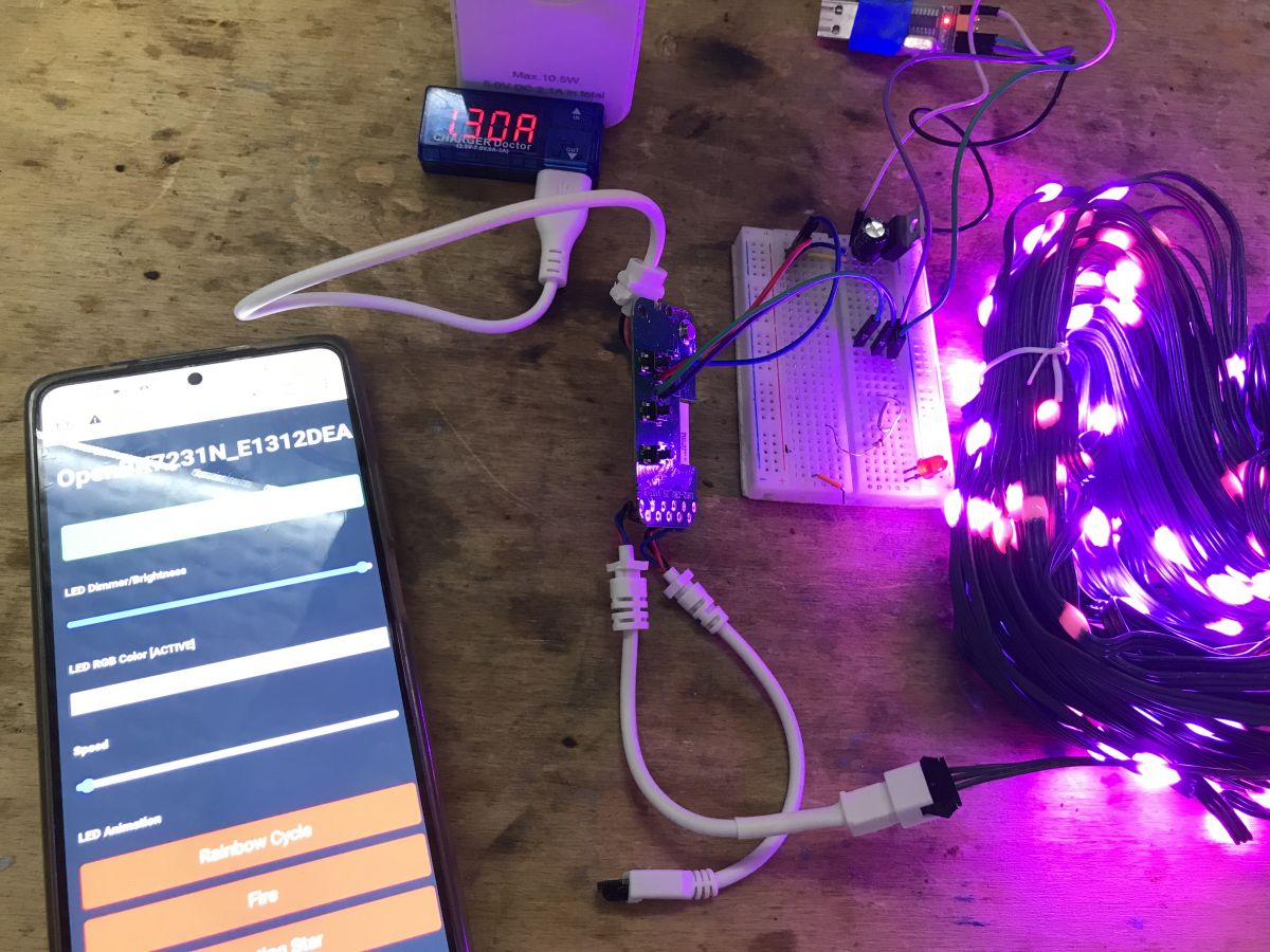

    It appears that a 1.5A power supply is sufficient for this product:
    LED set with bright blue lights, smartphone, and a power meter Controlling WS2812 LEDs with OpenBeken app. WS2812 LED set connected to a controller with a display, next to a smartphone with a control app. WS2812 LED set with OpenBeken controller and smartphone. Connected WS2812 LED set with OpenBeken controller and visible smartphone app. Smartphone with control app and glowing red WS2812 LEDs on a table. LED controller setup with a smartphone and Christmas LED lights LED controller setup with a smartphone and Christmas LED lights
    Summary .
    The reader was right, the Tuya app crashes and you can't enter "dynamic" animations, but the firmware change was successful and now you can animate LEDs locally, without the cloud. The bar can also be freely configured and scripted, and you can even add a DHT11 sensor to it, for example, but about that another time.
