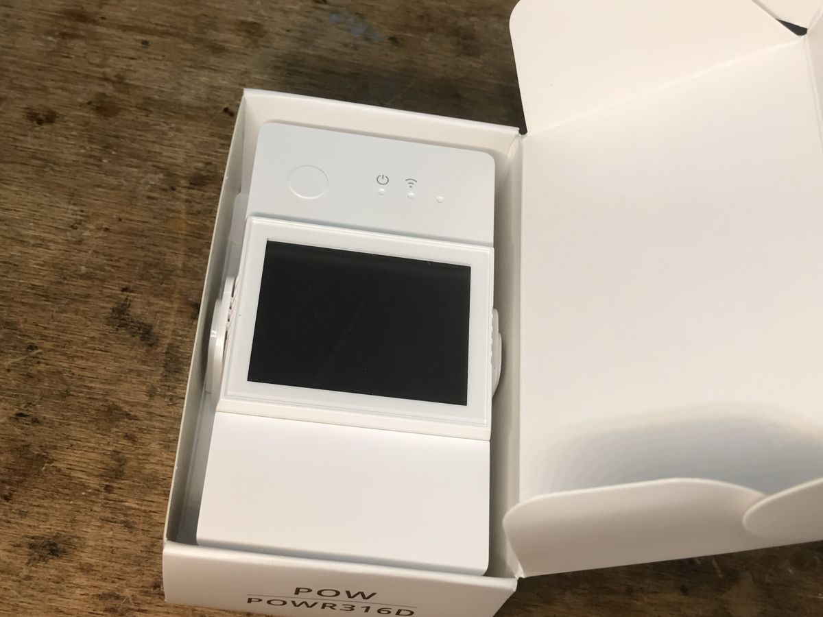

    Let's see what we get in practice:

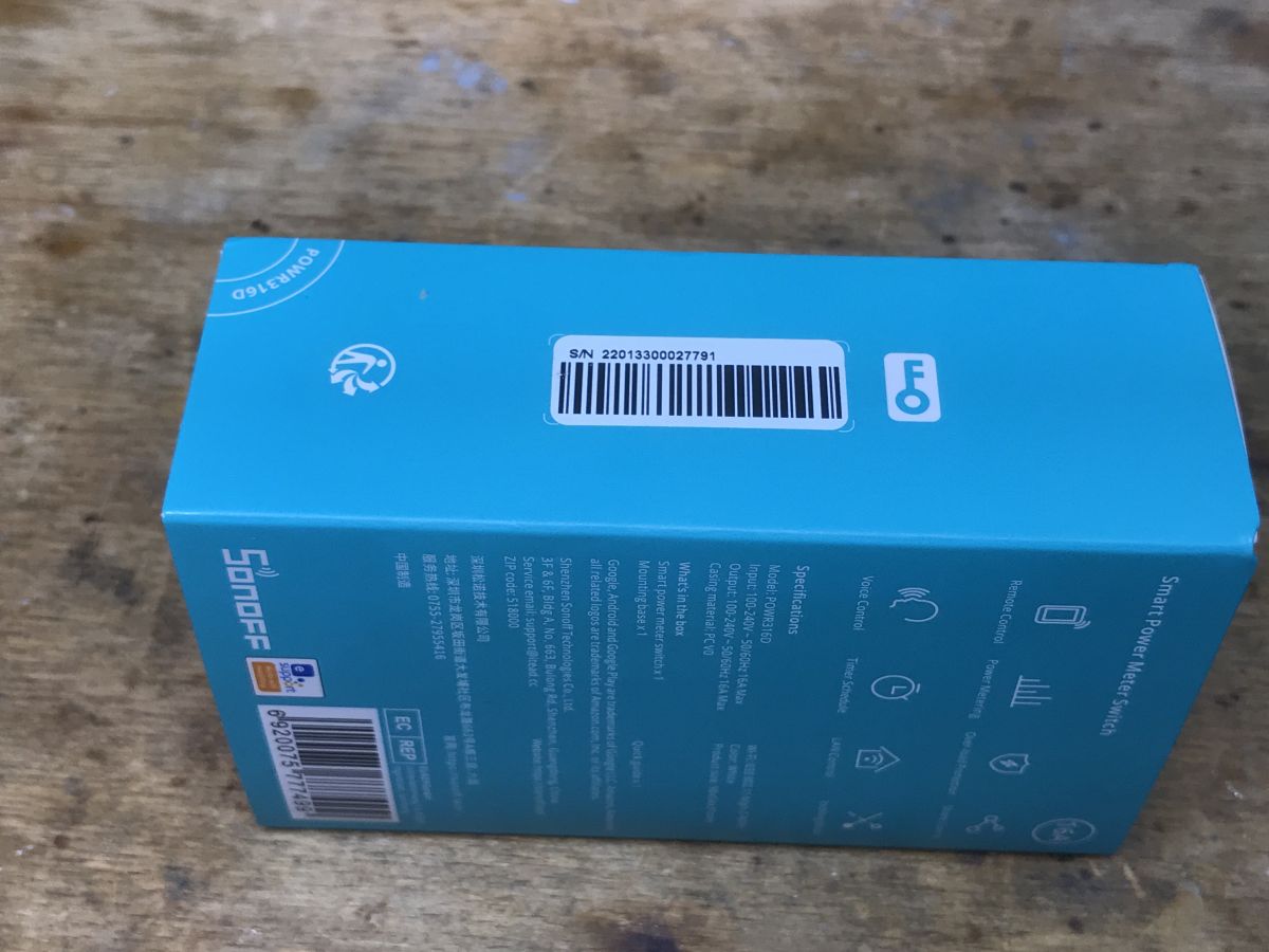

    Sonoff POWR316D box on a wooden table Sonoff POWR316D energy meter packaging on a wooden surface. Side of Sonoff box with QR code and eWeLink app information. Blue packaging of Sonoff POWR316D energy meter on a wooden surface. Sonoff POWR316D Elite16A boxes on a wooden surface.

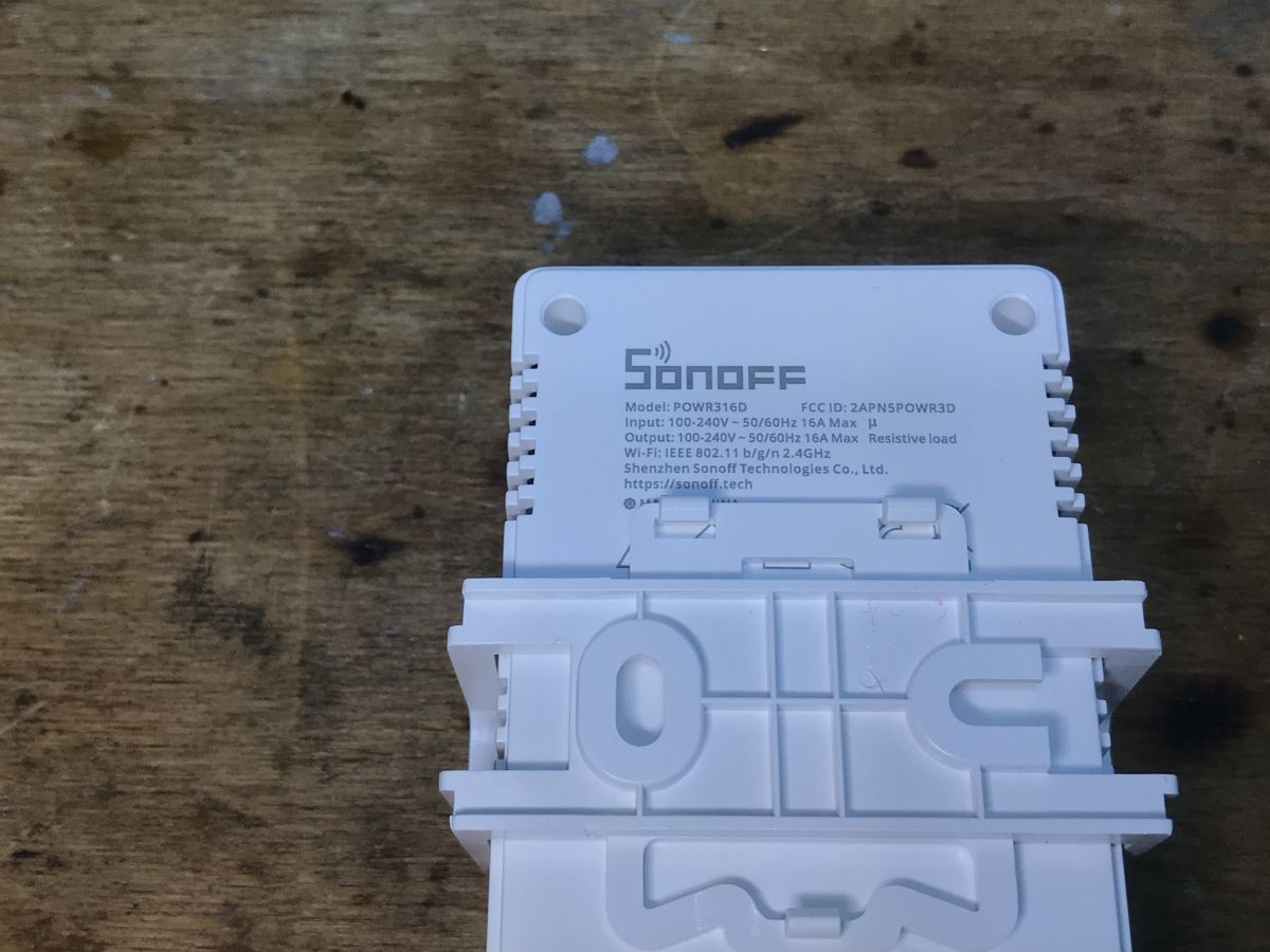

    The set does not include screws, but includes the module itself and a plastic hook/mounting mat:
    Back of Sonoff POWR316D module with technical details on a wooden background. Sonoff POWR316D with LCD display in packaging

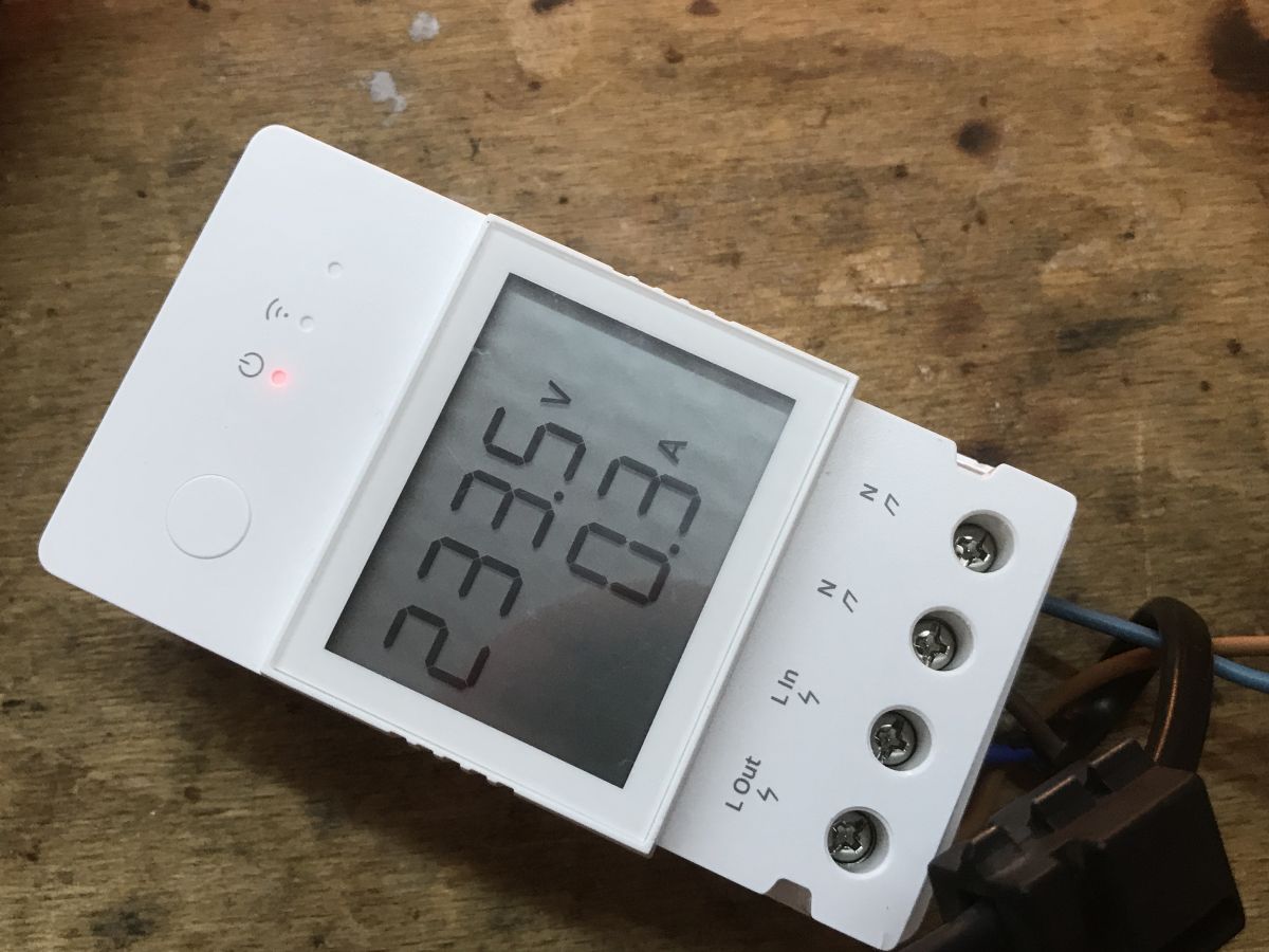

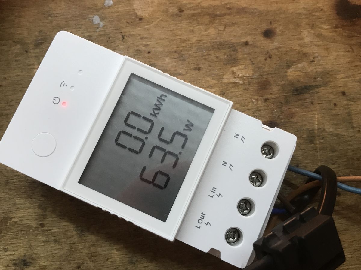

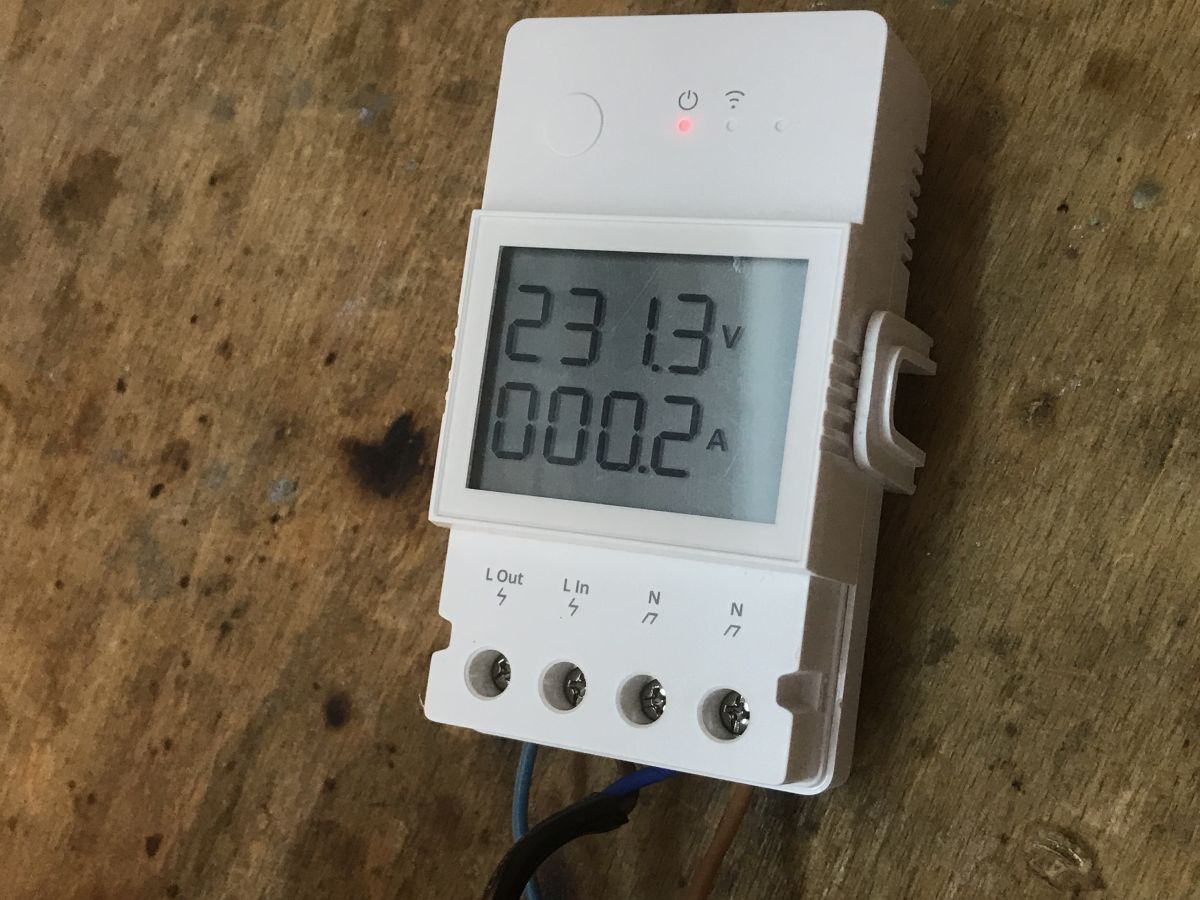

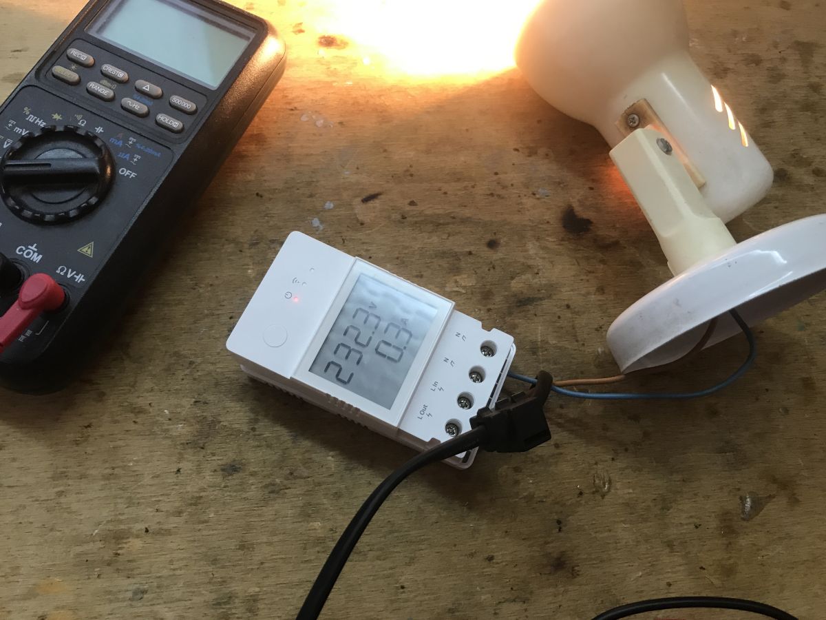

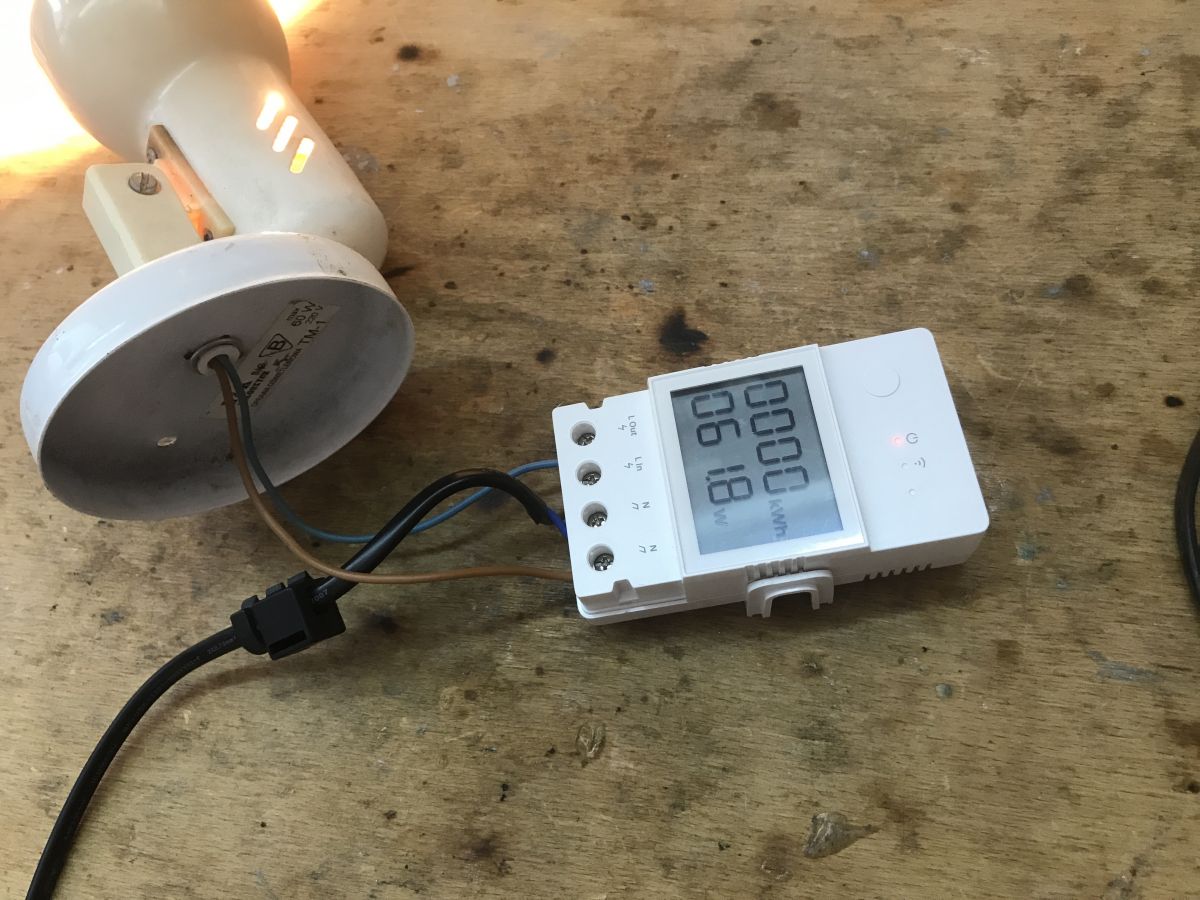

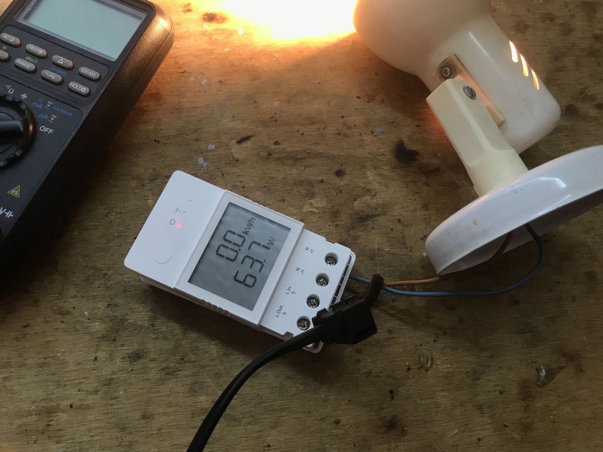

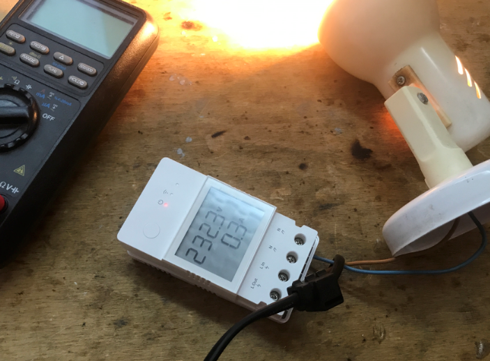

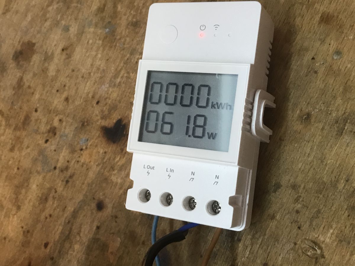

    A short test without changing the firmware
    To test, I connected an old lamp:
    Sonoff POWR316D energy meter connected to a lamp Sonoff POWR316D energy meter with LCD display. Sonoff POWR316D with an LCD display showing energy consumption.
    The display is not very readable, but it does its job. It alternately shows voltage, power, current and also the sum of consumed electricity, the counter of which can be reset in the application. Quite comfortable!

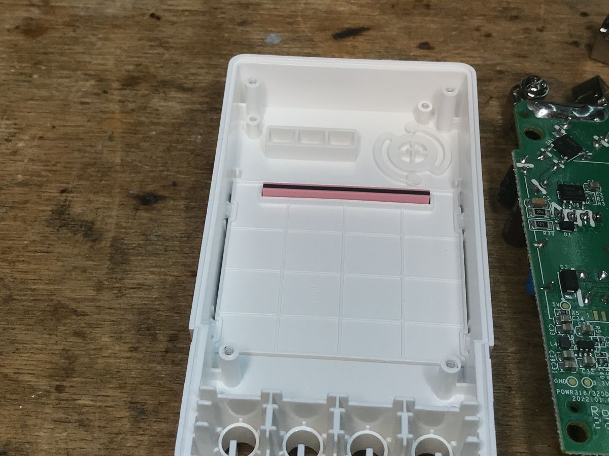

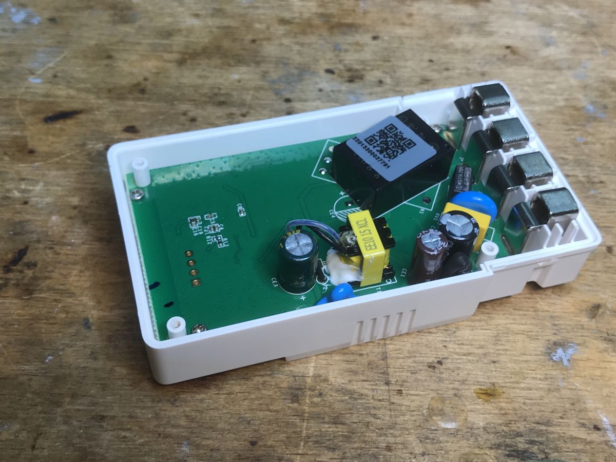

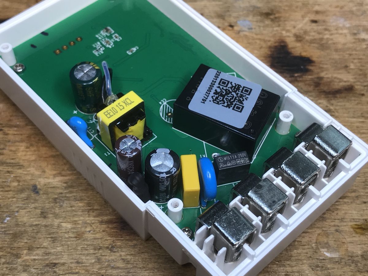

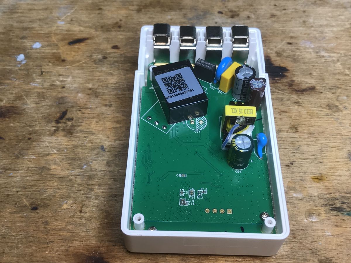

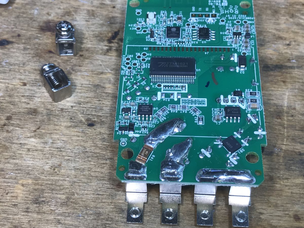

    We look inside
    Let's unscrew the screws. You can already see the transformer inside, there is probably a small impulse converter there, as well as some poor filters at the power input, this time there is probably even a varistor and a capacitor:
    View of the interior of the Sonoff POWR316D module with electronic components on the PCB. Interior of the Sonoff POWR316D module showing electronic components. Interior of Sonoff energy meter with visible PCB and electronic components.
    After unscrewing the screws, you can remove the board:
    Interior of Sonoff POWR316D enclosure and PCB. Sonoff POWR316D circuit board with visible electronic components.

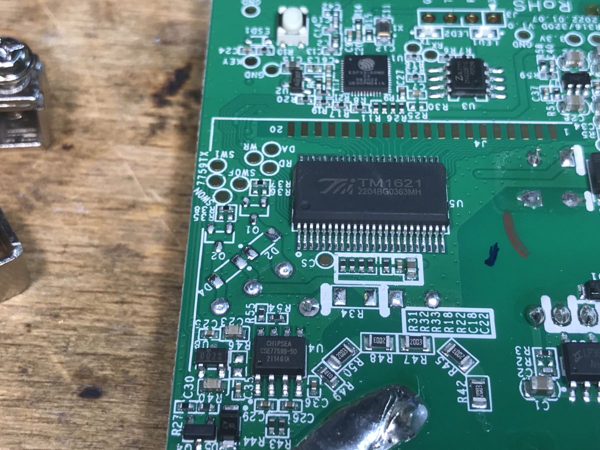

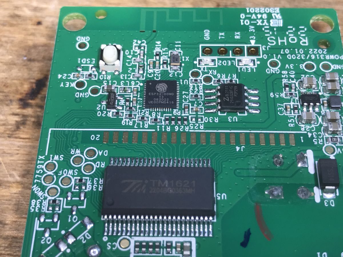

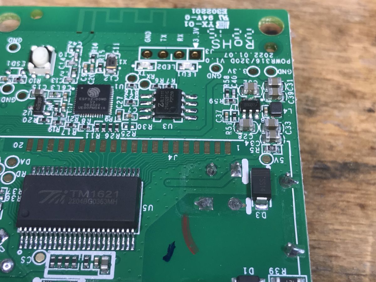

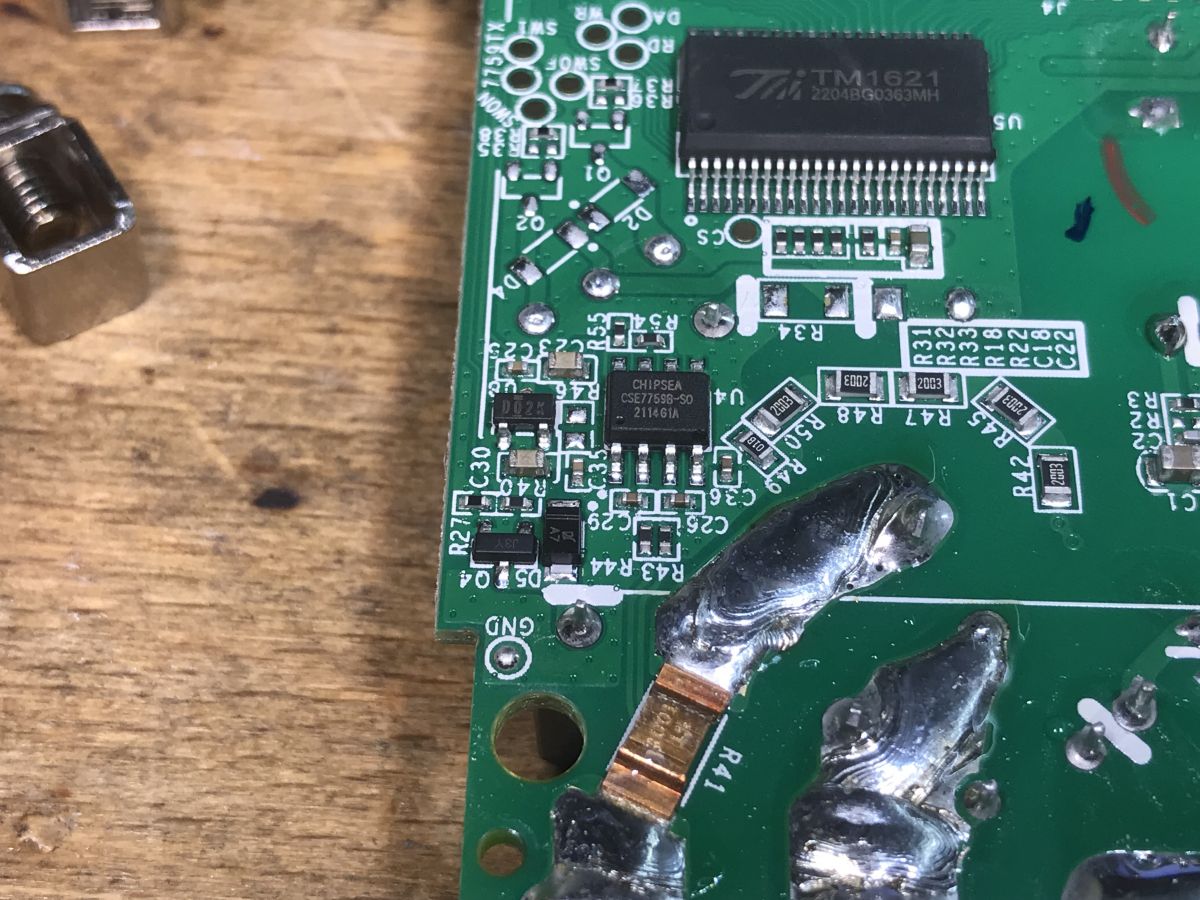

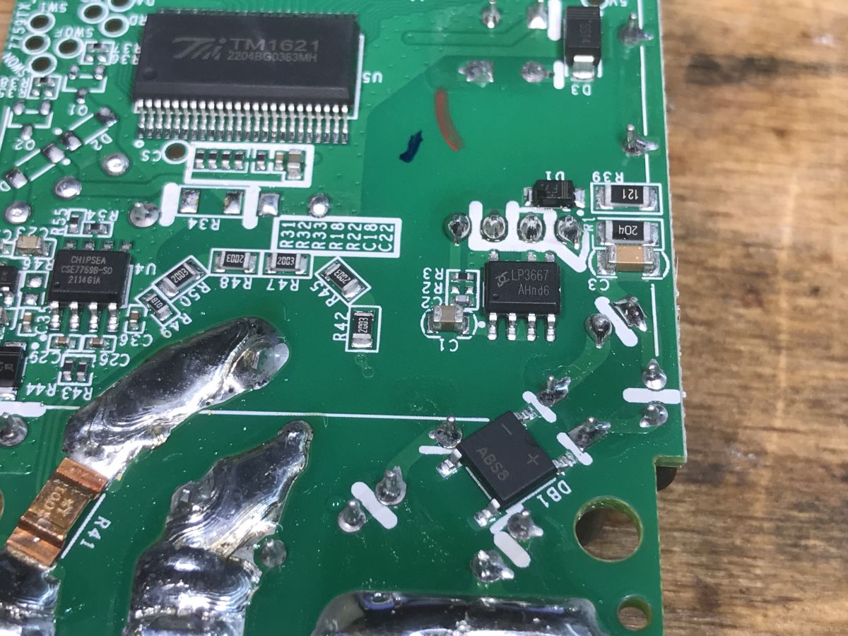

    The display is controlled by TM1621:
    Close-up of a circuit board with integrated circuits and TM1621 marking.
    The heart of the device is ESP32, on the PCB right next to it you can also see SPI Flash memory with the program and a programming connector with RX and TX, I will mention IO0 later.
    Close-up of the Sonoff POWR316D PCB with visible electronic components.
    The integrated circuit at L4 looks like a step down converter to me, it probably provides 3.3V for ESP:
    Close-up of the Sonoff POWR316D circuit board with visible components.
    The CSE7759B is responsible for energy measurement:
    Close-up of a circuit board with electronic components.
    The main power supply is based on LP3667:
    Circuit board inside Sonoff meter with visible electronic components

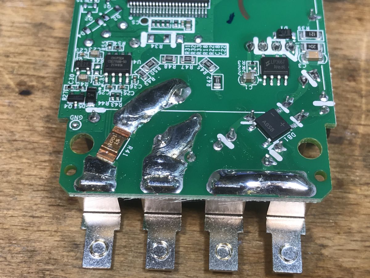

    The high-current paths are additionally tinned, the photo also shows a resistor with a tolerance of 1% - shunt:

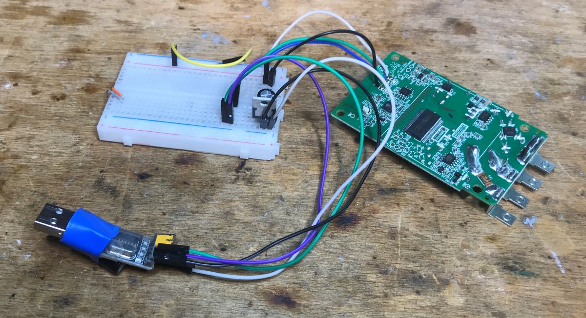

    This time we solder four wires, power supply (3.3V), ground, RX and TX:
    Sonoff PCB board with connected wiring and a breadboard.
    IO0 is output to the button, so to enter the bootloader mode we must first press this button and then connect the power supply (3.3V power supply)
    Of course, we perform all flashing operations away from the 230V network, everything must be completely disconnected, but this is rather obvious, as always.

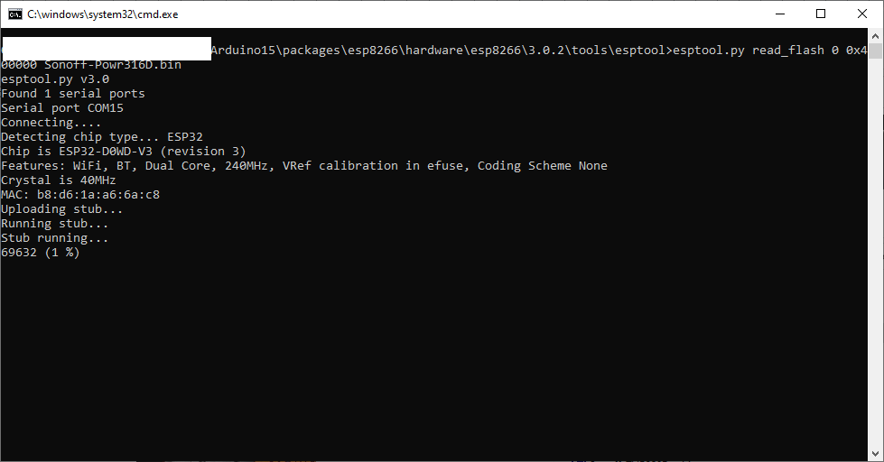

    I decided to use esptool.py because I always backup the firmware:
    Screenshot of CMD program during the flashing of Sonoff POWR316D.

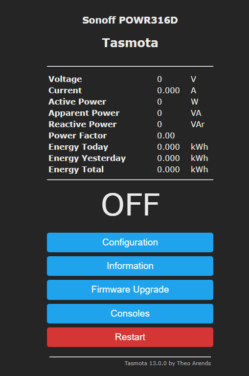

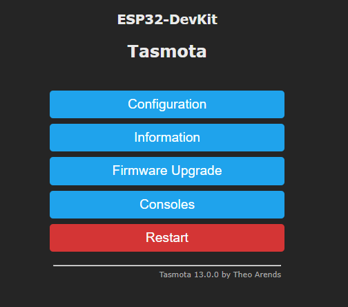

    Then I loaded Tasmota:
    Tasmota interface on ESP32-DevKit with configuration buttons

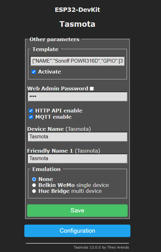

    I found the template ready on the Blakadder website:
    {"NAME":"Sonoff POWR316D","GPIO":[32,0,0,0,0,576,0,0,0,224,9280,0,3104,0,320,0,0,0,0,0,0,9184,9248,9216,0,0,0,0,0,0,0,0,0,0,0,0],"FLAG":0,"BASE":1}
    Uploading:
    Tasmota configuration interface on ESP32-DevKit.

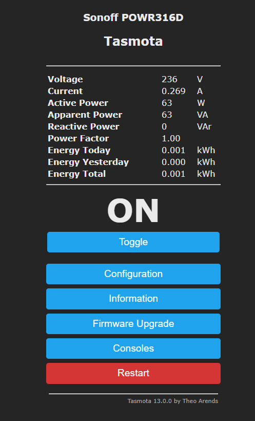

    After activation:
    Sonoff POWR316D user interface with Tasmota User interface of Sonoff POWR316D with Tasmota firmware showing energy consumption data.
