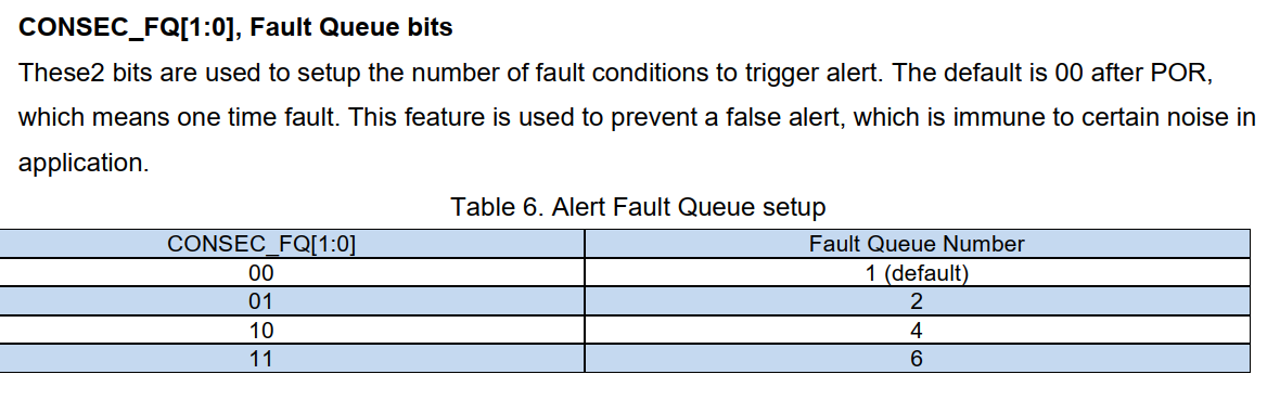

  • #67 21050429
    crispybeken
    >>20876365
    @artin961 The problem with periodic wakeup from DeepSleep is we could miss changes in temperature and/or humidity if we sleep too long and waste battery by waking up even when nothing has changed.
    However, both CHT8310 and CHT8305 feature an ALERT mode, which can be used to wake up the BK7231N from DeepSleep when reaching temperature and/or humidity limitation programmed by setting temperature and/or high/low-limit registers of the sensor.
    All we need to do is set new limits based on last read value before activating Deep Sleep, for example at 22° set lower limit to 21.5° and upper limit to 22.5°. The BK7231N would stay asleep as long as the temperature stays between these values but immediately wake up when the limit is reached.
    The ALERT pin of CHT8310 is connected to P7 with a 10kΩ resistor in between. The I²C commands necessary are already shown to work in this arduino library: CHT8305.
    If we could add a setAltert([temp_high, temp_low, hum_high, hum_low]) function to OpenBeken it would greatly reduce power usage and make the readings more accurate, since we would get any change in temperature and/or humidity when they occur.

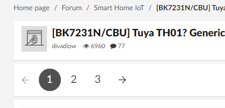

    Changed name to TH01:
    Screenshot of an online forum discussing the Tuya TH01 device, displaying views and replies statistics.
    You can update template if you want.

    how to use it correctly?!
    https://github.com/openshwprojects/OpenBK7231...dec39d5c7794ba4/src/driver/drv_cht8305.c#L273
    Added after 14 [minutes]:
    @insmod @p.kaczmarek2 is description correct here? https://github.com/openshwprojects/OpenBK7231T_App/pull/1301
    Added after 5 [minutes]:
    I didn't actually know what the fault queue was
    Table showing alert fault queue setup for CONSEC_FQ[1:0] bits.
  • #89 21182369
    insmod
    Posts: 1353
    Help: 160
    Rate: 425
    >>21182153 Looks accurate enough. Though you have to edit the source file, not .md one. Will add humidity on the weekends if I don't forget.
