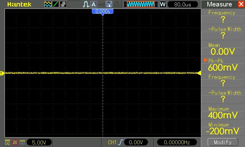

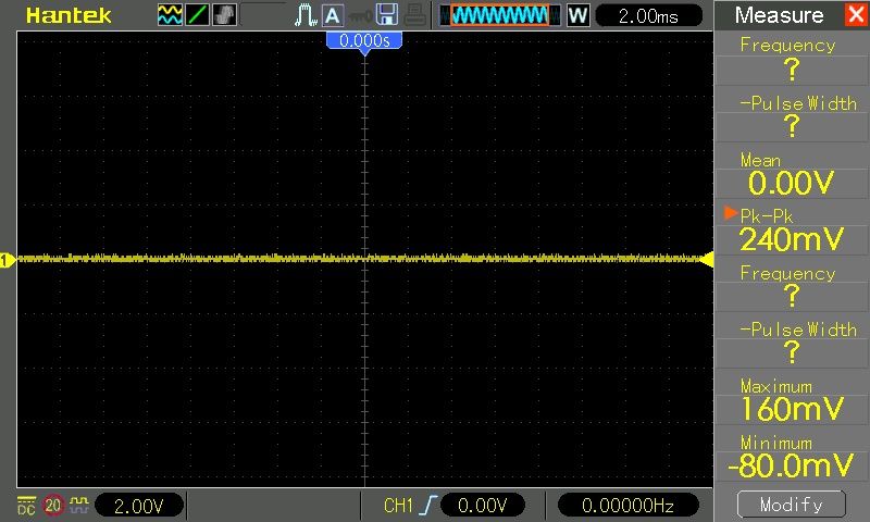

    The culprit is the oscilloscope.
    It seems that the measurements are made from what he "sees" on the screen. And since the base is quite thick (noise?), it is included in the measurement. The peak value is different for different voltage ranges per division. This is what it looks like for the 5V and 2V range per plot. Best when measuring with a cursor. To sum up, it`s probably a problem with budget equipment (DSO5102BM)...
    It does not matter whether the probe is connected, shorted to ground or disconnected.
    5V range:
    Oscilloscope screen displaying signal waveform with annotated voltage values.
    2V range:
    Oscilloscope showing waveform with Pk-Pk value of 240 mV.
    cursor measurement. 500mV range:
    Oscilloscope screen showing voltage waveforms.

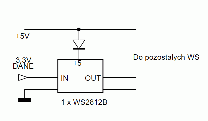

    Returning to the topic of WS2812B. The waveforms (amplitude) on the GPIO controlling the WS are identical with and without the tape connected. So nothing works retroactively with WS here. At least 5V. So ESP is safe in my opinion.
    And I must admit that the system I propose works at the border of the WS specification. With a 3.3 -> 5V driver, the system will certainly be reliable. I found an interesting patent on the Internet using a single WS2812. There is not always a driver at hand.
    Diagram showing the connection of a WS2812B LED with data and power.
    The only thing is that the WS +1 addresses need to be renumbered in the software

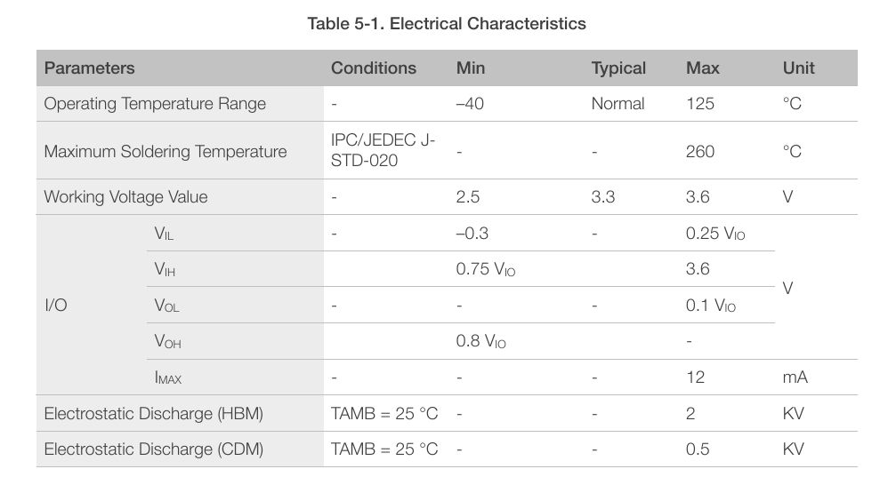

    khoam wrote:
    Are you sure this information comes from the manufacturer`s documentation?
    All I know is that "All digital IO pins are protected from over-voltage". I assumed (maybe too optimistically) that it was done like in other UPs according to drawing. However, I may be wrong, as the documentation does not mention the method of security.
    Added after 1 [hour] 50 [minutes]:
    I found a very interesting website Link The author claims that the inputs can be easily connected to 5V. What`s even more interesting - the output can also work in 5V logic with an open drain configuration. I`m curious about your opinions on this matter. Anyway, I was wrong about the "Clamping diode" protection.

    I am familiar with the article. Actually, the manufacturer himself does not know or does not want to reveal the 5V resistance of the ESP inputs. It will be more convenient to maintain that it is not. Let me just say from my experience that it is quite a resistant MCU. I once powered it directly from a Li-ion battery (4.2V). It is true that the system was put to sleep and woken up every minute. He worked like this for several months. It was sending data via ESP-NOW. The disadvantage of this solution was the relatively high power consumption during Deep Sleep. About 1mA at 4.2V, which dropped with the battery discharge to the order of microamps.

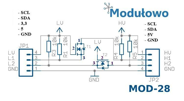

    I delved deeper into the topic of WS2812B. How are the settings of individual LEDs on the strip read? There is no physical feedback from WS to the MCU here.
    After assigning RGB or HSV values to the selected LED, they are written to and read from the CRGB table.
    Moreover, proof that physical reverse information does not exist is the use of a 3.3 -> 5V converter.
    Such a converter is unidirectional. Personally, I have not encountered a bidirectional converter for WS control.

    I used this library https://github.com/adafruit/Adafruit_NeoPixel, there are two instructions whose names would indicate that they give feedback "getPixelColor()" and "getBrightness()".
    I admit, I haven`t tested them and I don`t know how they work.
    As for the converter, I don`t know which one you use, I use this one https://abc-rc.pl/pl/products/konwerter-level...-4-kanaly-stanow-logicznych-spi-uart-arduino- 6191.html?query_id=1 and I assure you that it is bidirectional.
    I quickly found this diagram:
    Circuit diagram of a logic level converter with connection labels.
