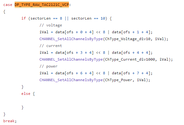

    I apologize for the delay, we are currently working on new platform support, namely LN882H.
    Regarding the parsing, would you like to get a flexible, scriptable parse system, or just a custom dpType that will fit your device?
    The custom hardcoded dpType will be way faster. Here is an example of already existing custom dpType for TAC2121C:
    C code snippet for parsing data of type DP_TYPE_RAW_TAC2121C_VCP.
    How good is your C knowledge? Maybe we could add a required parser for you together?

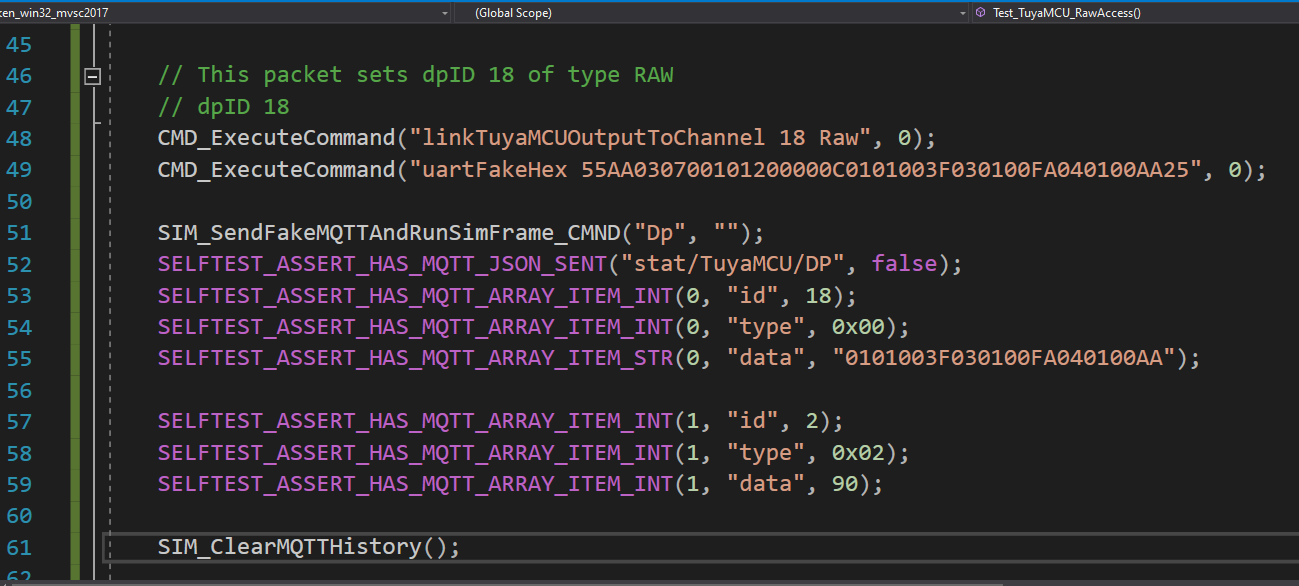

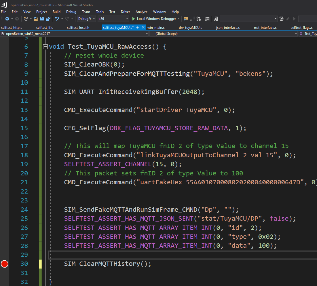

    @morgan_flint Don't do it. It is again parsing problem:
    I was able to set DpID 17 via raw sent command
    uartSendHex 55AA00060008110000040401002047 -> this will set DpId to protection on and 32mA leakage current.
    EDIT:
    The same is valid for DpID 18:
    uartSendHex 55AA000600101200000C0101003F030100FA040100AA21 -> all protections on 63A 250V 170V
    uartSendHex 55AA000600101200000C0100003203000104040000B426 -> all protections off 50A 260V 180V
    You can try it if you want and check settings in the device, but it works :)

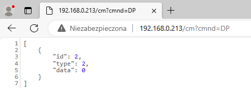

    @p.kaczmarek2 Is there any way to capture the output from tuyaMcu_sendQueryState via url?
    I mean send command via IP/cm?cmnd=tuyaMcu_sendQueryState and to capture the whole output

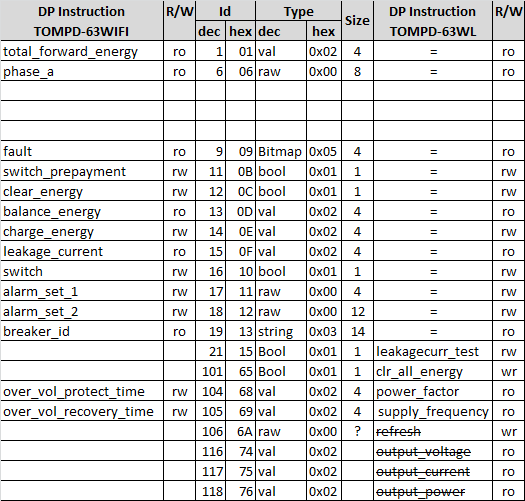

  • Comparison of TOMPD-63 and TOMPD-63LW DpIDs
    #43 20921587
    morgan_flint
    Posts: 251
    Rate: 63
    Angel0fDeath wrote:
    In the other device DpID's are the same or not? I'm speakin for DpID 17 and 18. Currently I'm using a constant string for these 2 DpID's to set. Changing only the bytes necessary. If DpID's are different should think for somethin else...
    Yes, DpID 17 and 18 are the same.
    This is a comparative table for both devices' DpIDs:
    Comparison table of DpID identifiers for two devices TOMPD-63WIFI and TOMPD-63WL.
    Until DpID 19 all DpIDs are the same, with a slight difference in DpID 12: on the other device it only clears the prepayment counter, while on this one it clears both energy counters (prepayment and total). Also, DpID 19 is 14 bytes long in this one and just 4 in the other one (content is 45 54 55 39 2D 49 4F 54 2D 57 49 46 49 00, translated to ASCII, "ETU9-IOT-WIFI " for this one and 31 32 33 34 "1234" for the other one). We could try to change these with uartSendHex to see what happens, although, supposedly, it's read-only.
    DpID 21 and 101 only exist in the other device; the first one simulates a leakage current test (trips switch for the scheduled time, not very useful in my opinion as it doesn't really provoke a real leakage current, as the test in "hardware" RCDs) and the second one clears the main energy counter.
    DpID 104 and 105 are completely different; in this device they set the parameters of overvoltage protection and in the other one they are for power factor and frequency, respectively.
    DpID 106 doesn't appear in OBK's logs; in Tuya's logs it appeared occasionally with "app client" as source and "appName:Tuya Smart,ios-packageName:com.tuya.smart,android-packageName:com.tuya.smart,model:2201116SG,os_system:13,app_version:5.7.0. App uid: eu16778378437609KUvs" as content. Not very sure what it represents but not useful for us, I think
    Finally, DpIDs 116 to 118 don't appear in any log, but were defined in one of the archives downloaded from Tuya developers page (like the one in the first post of this thread, for DpID descriptions). Probably something that wasn't finally implemented as is redundant with DpID 6 (or maybe not so redundant, as "output" could indicate "export" in this case, because the other device is capable of detecting reverse power in the display, but doesn't report it on DpID 6; in any case, it is not implemented)

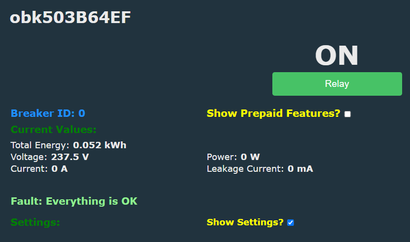

  • DpID 9 payload length change may break alarms
    #47 20922375
    morgan_flint
    Posts: 251
    Rate: 63
    Done. I hadn't considered that because I had the autoexec.bat you posted some time ago, so I thought we had the same channel settings.
    Now it detects correctly leakage, but not the other two alarms. Furthermore, if I provoke the three alarms and then retire leakage, channel 10 stays at 8 and leakage alarm is detected.
    I'm afraid it's due to OBK not treating well DpID 9 when its payload changes from one to two bytes, something similar to DpID 17 vs. DpID 18
    I see also "Breaker ID" shows as 0:
    User interface showing power device information, displaying ON status, breaker ID, and current energy and current values.
    I have this for DpID 19 in autoexec.bat:
    // Settings 2 - Dpid 19 "breaker_id" - channel 19
    linkTuyaMCUOutputToChannel 19 03 19
    setChannelType 19 textfield
    setChannelLabel 19 "Breaker Id (19)"
    And also tried:
    linkTuyaMCUOutputToChannel 19 val 19
    setChannelType 19 ReadOnly
    With the same results. This channel shows 0 in both cases, and I can't see its mapping in the script

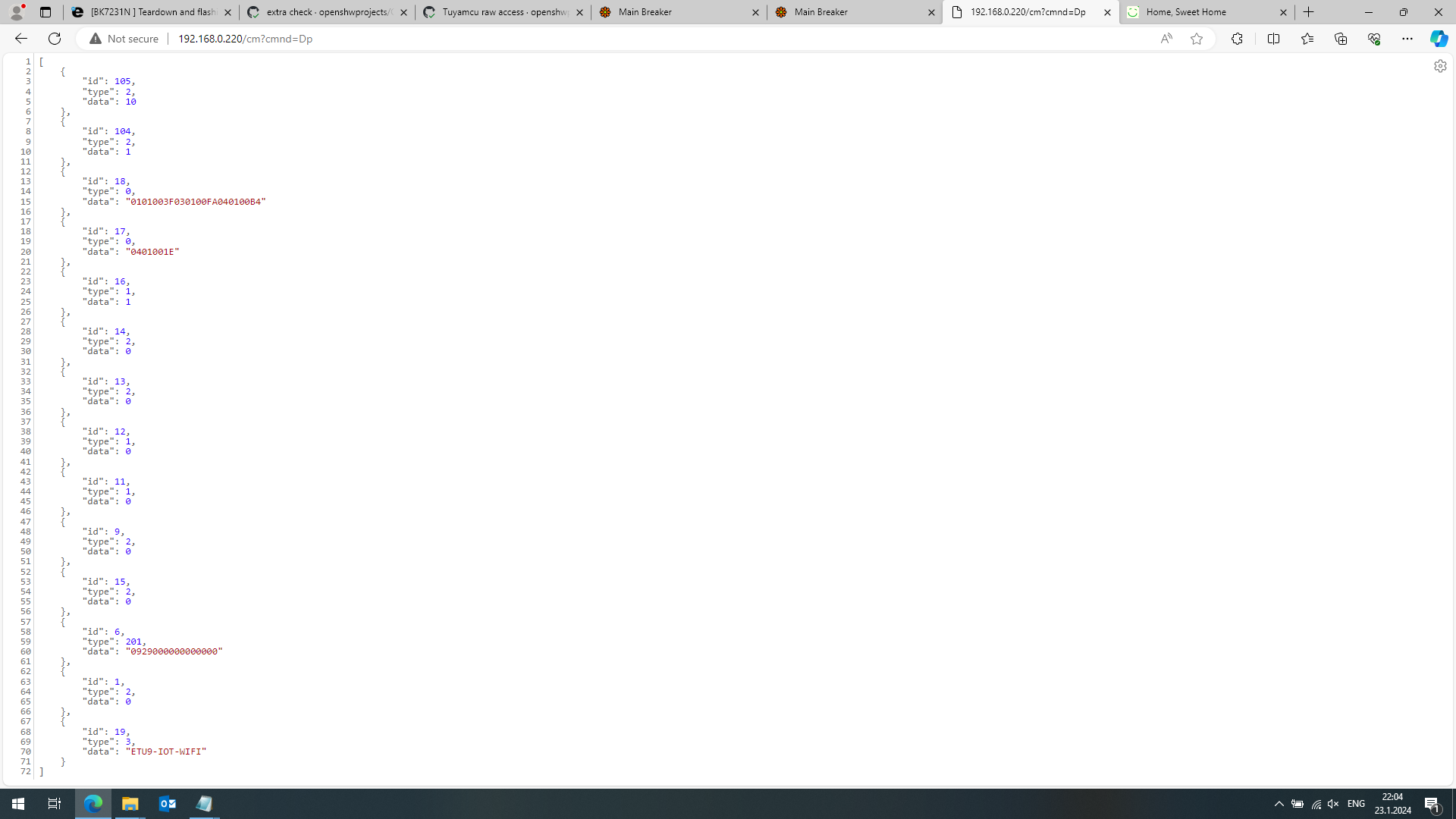

  • HTTP and MQTT JSON output preview
    #51 20924258
    Posts: 14770
    Rate: 12913
    Here is a self test of this feature:
    Visual Studio console displaying test code for the TuyaMCU function.
    I think you can already infer the JSON structure from it. It will work both through HTTP and MQTT.
    Added after 1 [hours] 12 [minutes]:
    Raw type will be shown as hex string:
    Screenshot of a code snippet from a test function sending MQTT packets.
    Added after 2 [hours] 45 [minutes]:
    @Angel0fDeath here is a preview, can you check?
    https://github.com/openshwprojects/OpenBK7231T_App/pull/1048
    You need to enable a flag first.
    Then, try executing "Dp" command via HTTP to get JSON

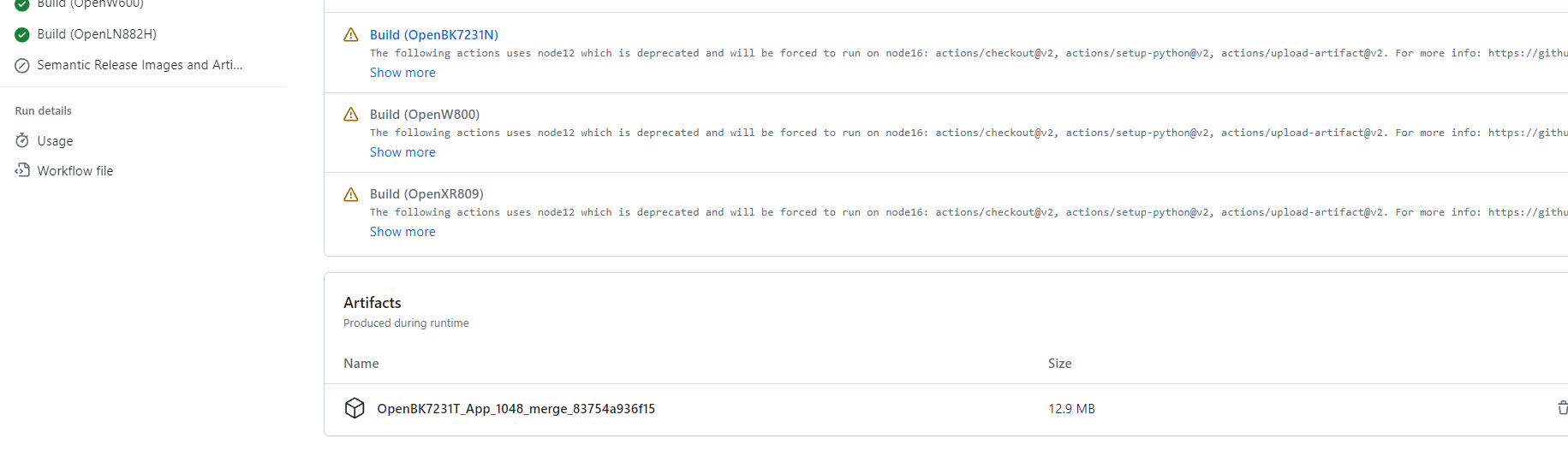

  • #52 20924987
    Angel0fDeath
    Posts: 118

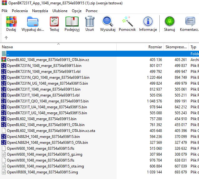

    Rate: 33
    @p.kaczmarek2 I don't see the build on provided link

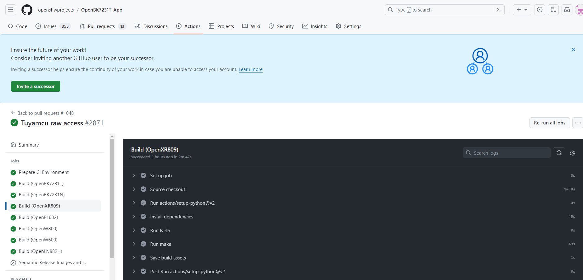

  • Finding firmware builds in GitHub Actions artifacts
    #53 20924998
    Posts: 14770
    Rate: 12913

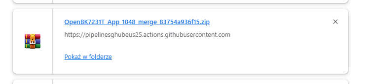

    You need to click on one green ticks, to get build details, a page like this:
    https://github.com/openshwprojects/OpenBK7231...tions/runs/7627074885/job/20775034317?pr=1048
    Screenshot showing GitHub Actions page for the OpenBK7231T_App project, displaying build details.
    Then you need to click "Summary" and scroll down:
    Screenshot from GitHub Actions showing build run details with a list of built versions and an Artifacts section.
    Then you will get a zip file:
    Screenshot showing download info for OpenBK7231T App zip file.
    With all the builds:
    Screenshot of a ZIP archive with several binary files and their size information.
    Added after 47 [seconds]:
    PS: I will add more self tests for this functionality soon

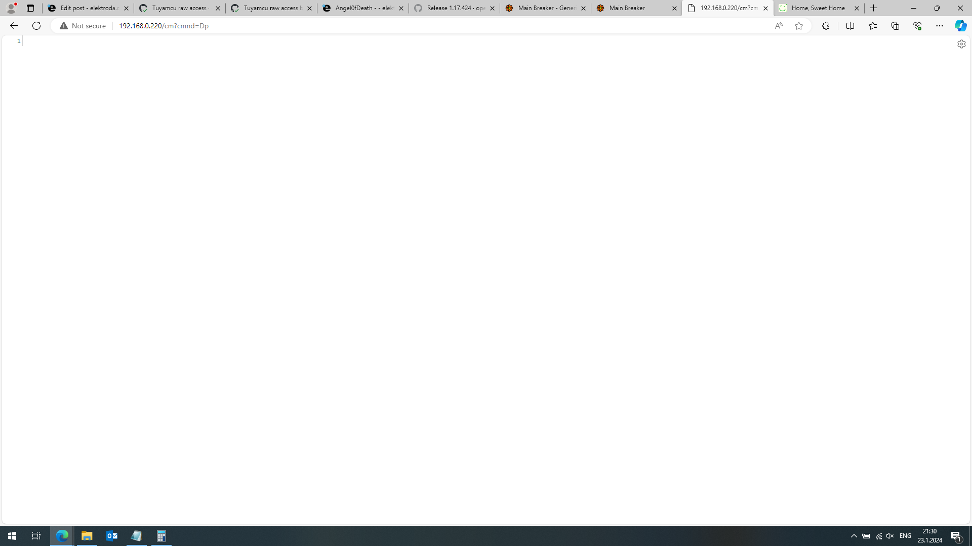

  • Flag 46 bug leaves Dp command unknown
    #54 20925150
    Angel0fDeath
    Posts: 118
    Rate: 33
    Aha... Thanks. Downloaded it.
    @p.kaczmarek2 Hmm. Something wrong. Flag 46 -> enabled
    command:
    IP/cm?cmnd=Dp -> nothing happens
    Web app -> Logs Dp
    Info:CMD:[WebApp Cmd 'Dp' Result] Unknown command
    MQTT - not tested, since obviously will not get result.
    I tried it with my autoexec.bat and with empty autoexec.bat. Same results.

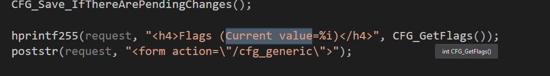

    However I noticed even Flag 46 is enabled, in the beginning of flag config page always states;
    Flags (Current value=0)
    I don't know if this is the reason nothing to happen, but in general this is a bug. It seems you don't set corresponding bit in flags :)
    ... or you set it but you have overflow...

    Hmmm
    Screenshot showing JSON data in a browser.
  • #56 20925228
    Angel0fDeath
    Posts: 118
    Rate: 33
    Screenshot showing a blank webpage with an address bar containing an IP address. Yep, work with mappings. It will be easier. Web browser screenshot showing a blank page.
  • #57 20925230
    Posts: 14770
    Rate: 12913
    The current flags display seems to be misleading, it reads only first 32 bits:
    Screenshot of programming code showing a function displaying flag values.
    That's a thing to fix
  • #58 20925243
    Angel0fDeath
    Posts: 118
    Rate: 33
    Well thats definitelly longint overflow. But I don't know how you keep them...
  • #59 20925259
    Posts: 14770
    Rate: 12913

  • Questions MQTT access and flag display format
    #60 20925322
    Angel0fDeath
    Posts: 118
    Rate: 33
    Now everything seems ok :)
    Screenshot of a web browser displaying a JSON page with variables.
    Even string dpID 19 shown correct
    I can read everything with javascript.
    How it is supposed to obtain the same with MQTT?
    EDIT: About flags - I don't think printing in web page some longint or 2 longints for flags status brings some important information even for you :), unless you are able to perform bitwise operations without pc or calculator. Probably more suitable will be just to print
    Current active (or enabled) flags - 1, 21, ..... (for instance)
    No one uses all flags and this number in web page speaks nothing, while flag numbers (if printed) give more info and more understandable info.
