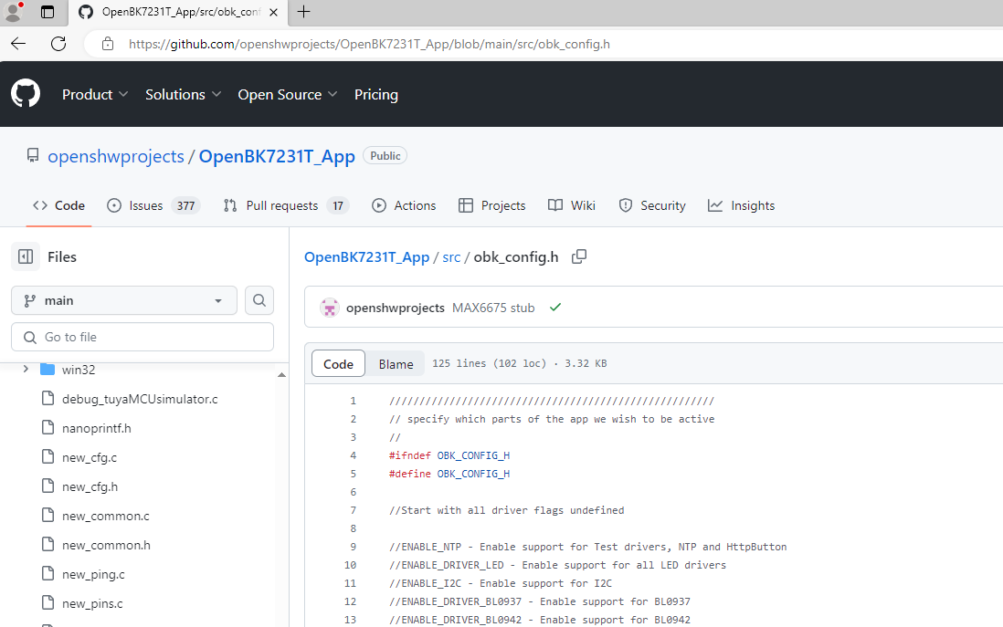

    Yes... I know you are alone and this device has only 2M flash... Will try to help as much as I can, but this remainds me something - have you ever considered modular building - for this device we need only tuyamcu driver, ok some device from the same type probably will need ntp driver as well. Why we need the rest 29 drivers in this device? Everybody likes full builds, but when you have only 2M flash probably this should be reconsidered. I have ir blaster with CB2S chip. On this device I use only ir driver. I dont need the rest 30 drivers. Instead of them I preffer larger IR library... But the last comment is another story and probably another topic... Sorry
    Could a TASMOTA style compile time options be a solution to build only the required libraries?
  • Compile-time driver flags already exist in obk_config.h

    Posts: 14770
    Rate: 12913
    @jkwim but there already is a TASMOTA style compile time options system:
    https://github.com/openshwprojects/OpenBK7231T_App/blob/main/src/obk_config.h
    Code: C / C++
    It's just that all public builds are done with the same config.

  • #99 20975909
    Posts: 14770
    Rate: 12913
    You are missing ".h". This link works for me:
    Screenshot of a GitHub repository displaying the obk_config.h file of the OpenBK7231T_App project.

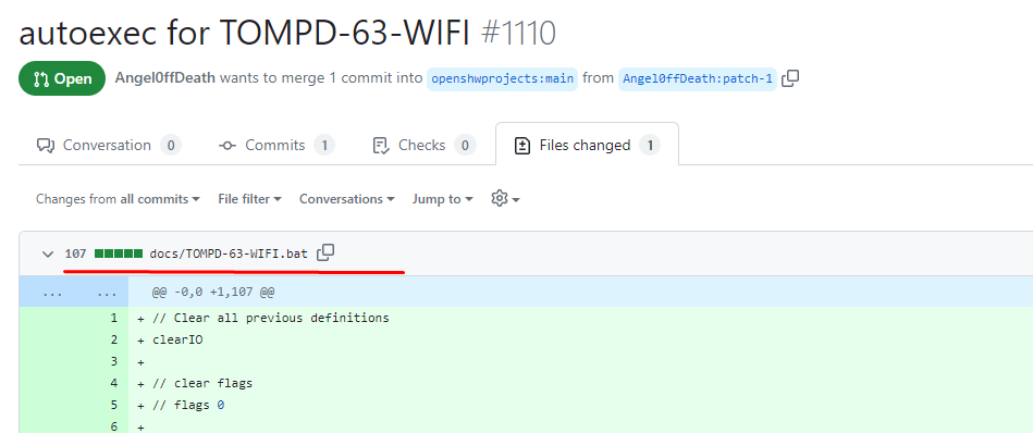

  • Autoexec.bat submitted as GitHub PR

    Angel0fDeath
    Posts: 118
    Rate: 33
    I think a separate topic in Smart Home Tutorials with basic info how to setup it and and how it looks like (screenshots) would be also very useful. Good job.
    @p.kaczmarek2 Done. You can find it here:
    https://www.elektroda.com/rtvforum/topic4040354.html
    Added after 2 [hours] 40 [minutes]:
    @p.kaczmarek2 Autoexec.bat for this device submitted on GH repository as PR. The folder is docs/autoexecs.
    https://github.com/openshwprojects/OpenBK7231T_App/pull/1110
    Can't find in which folder to make PR for html file. There is a folder docs/scripts but I find only .bat files there... Can you advise, please?
  • Update autoexec JSON source and separate docs dir
    #106 20990046
    Posts: 14770
    Rate: 12913
    You are supposed to update the JSON source:
    https://github.com/openshwprojects/OpenBK7231T_App/blob/main/docs/json/autoexecExamples.json
    Then the MD files will be built when I run node scripts/getcommands.js in the repository.
    Added after 46 [seconds]:
    PS: and autoexec sample should be in separate dir, not in the "docs", but here:
    https://github.com/openshwprojects/OpenBK7231T_App/tree/main/docs/autoexecs
  • #107 20990058

  • #108 20990066
    Posts: 14770
    Rate: 12913
    The linked PR adds autoexec.bat to the docs directory itself, and not to the "autoexecs" dir:
    Screenshot from GitHub showing a merge request for the autoexec.bat file for the TOMPD-63-WIFI project.

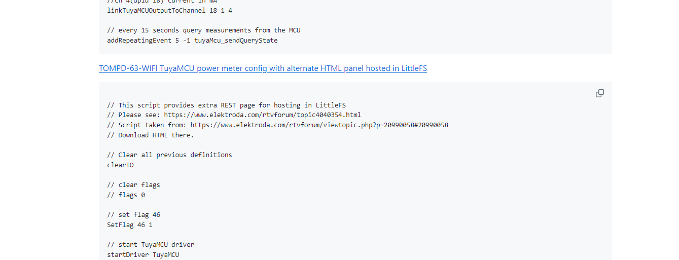

  • Docs and script credit added to BK7231N teardown
    #110 20990090
    Posts: 14770
    Rate: 12913
    Sure, let me add that for you.
    Here's first commit:
    https://github.com/openshwprojects/OpenBK7231...mmit/99c9d2a009c347a574e24a1be17802fe7da5a34d
    And now here is docs build:
    https://github.com/openshwprojects/OpenBK7231...mmit/7e59270362367a95e41796f069c6e1ef3436b0d9
    I think it looks good! Can I also add something like "script by Angel0fDeath"? Your work deserves a credit.

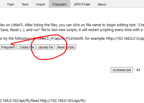

    I'd like to report that I successfully flashed two TOMPD-63-WIFI smart breakers using the below command:
    uartprogram OpenBK7231N_QIO_1.17.769.bin  -d /dev/ttyACM0 -w --unprotect -s 0x0
    Both my breakers has the CB3S module instead of WB3S. They also have the backlight mounted under the display but it's disabled (the part with the LED connection to the board is filed down).
    The autoexec.bat from the https://www.elektroda.com/rtvforum/topic4040354.html thread works OK. But I have a trouble coping the TOMPD-63-WIFI_rev7.html:
    Error:LFS:No more free space 12

  • #118 21310404
    Posts: 14770
    Rate: 12913
    leśny_ziutek wrote:
    . Can an alternate way (select a file from disk) be added do the WebApp?
    Sure, added:
    Screenshot of a user interface with the Upload file button circled on a file management options page.
  • LiteFS upload button simplifies flashing on Linux and Android
