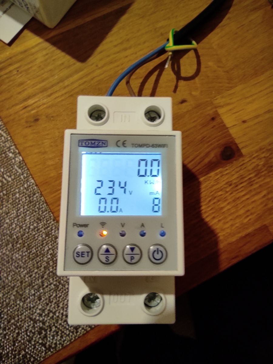

[BK7231N ] Teardown and flashing of Tomzn TOMPD-63 WIFI (not to be confounded with TOMPD-63LW)
morgan_flint 28878 153
  • Teardown and OBK flashing of the Tomzn TOMPD-63 WIFI smart circuit breaker, distinguished from the TOMPD-63LW model that also cuts neutral.
  • Inside, it uses two PCBs: a latching relay board with BL0942 metering and power supply, plus an LCD/Tuya MCU/WB3S board.
  • Tuya DpID extraction identified 13 IDs, including total forward energy, switch, leakage current, breaker id, and over-voltage protect/recovery timers.
  • OBK flashed through RX, TX, and GND without cutting traces, then autoexec.bat started the TuyaMCU driver, mapped channels, and enabled MQTT/Home Assistant discovery.
  • Some UI fields remain unclear, including the extra "t" setting, and "Alarm set 2" does not display well.
  • Combined energy dpid must precede relay channels

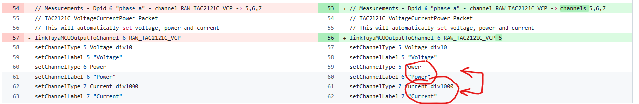

  • Voltage channel index now defines current and power mapping
    #122 21363688
    Posts: 14770
    Rate: 12913
    RAW_TAC2121C_VCP has been recently updated and maybe I need to improve backwards compatibility, but the suggested usage is as in self test:
    Code: C / C++
    I will fix the default behaviour now, but the preferred usage is to specify the Voltage channel index and it will then assume that after voltage comes current and then power.

  • VCP channel order required when adding first channel number
    #125 21367632
    morgan_flint
    Posts: 251
    Rate: 63
    >>21363758 There's an error in your PR; because of the fixes made to RAW_TAC2121C_VCP, if you add the first channel number at the end of "linkTuyaMCUOutputToChannel 6 RAW_TAC2121C_VCP X", then you have to respect the order Voltage, Current, and Power (VCP) in the following channel type definitions:
    Comparison of two code versions with highlighted changes in parameter order.
    If you don't specify the first channel number after RAW_TAC2121C_VCP, then you can change (at least) the order of C and P, as in the original autoexec, and still get good results, so we have good backward compatibility. The first channel number is necessary for multi-phase meters but can be skipped in single-phase devices.
    More detailed info here and also in the previous posts
  • #126 21369339
    mr_crabs
    >>21363782 Hi thank you! Updated firmware recently and checked - autoexec.bat without channel for VCP works as expected 👍
    PS. I'm still struggling with file uploads. Seems that device reboots when it receives a payload larger than 20000 or something. But will get back to it after I finish with mime types things. They seem not to be working as well 🥲

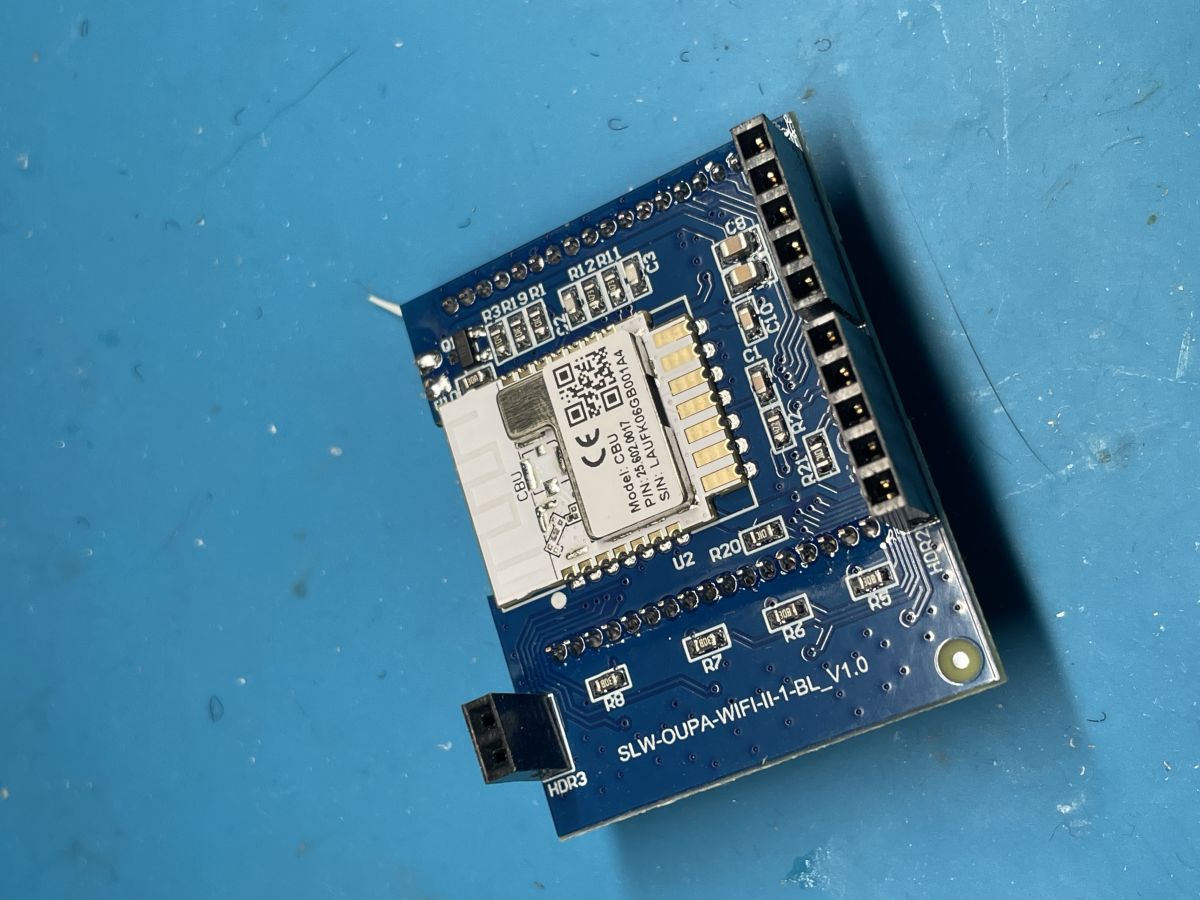

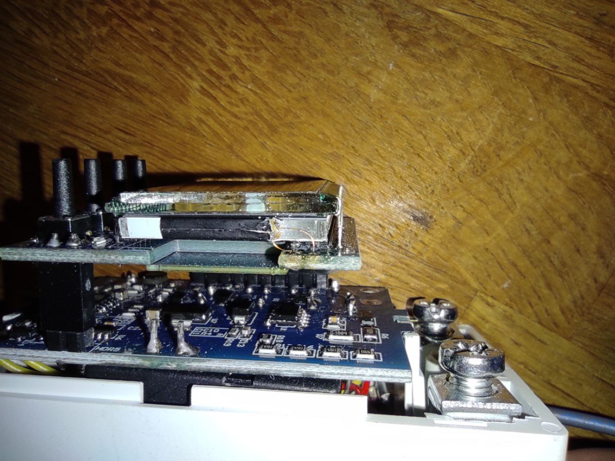

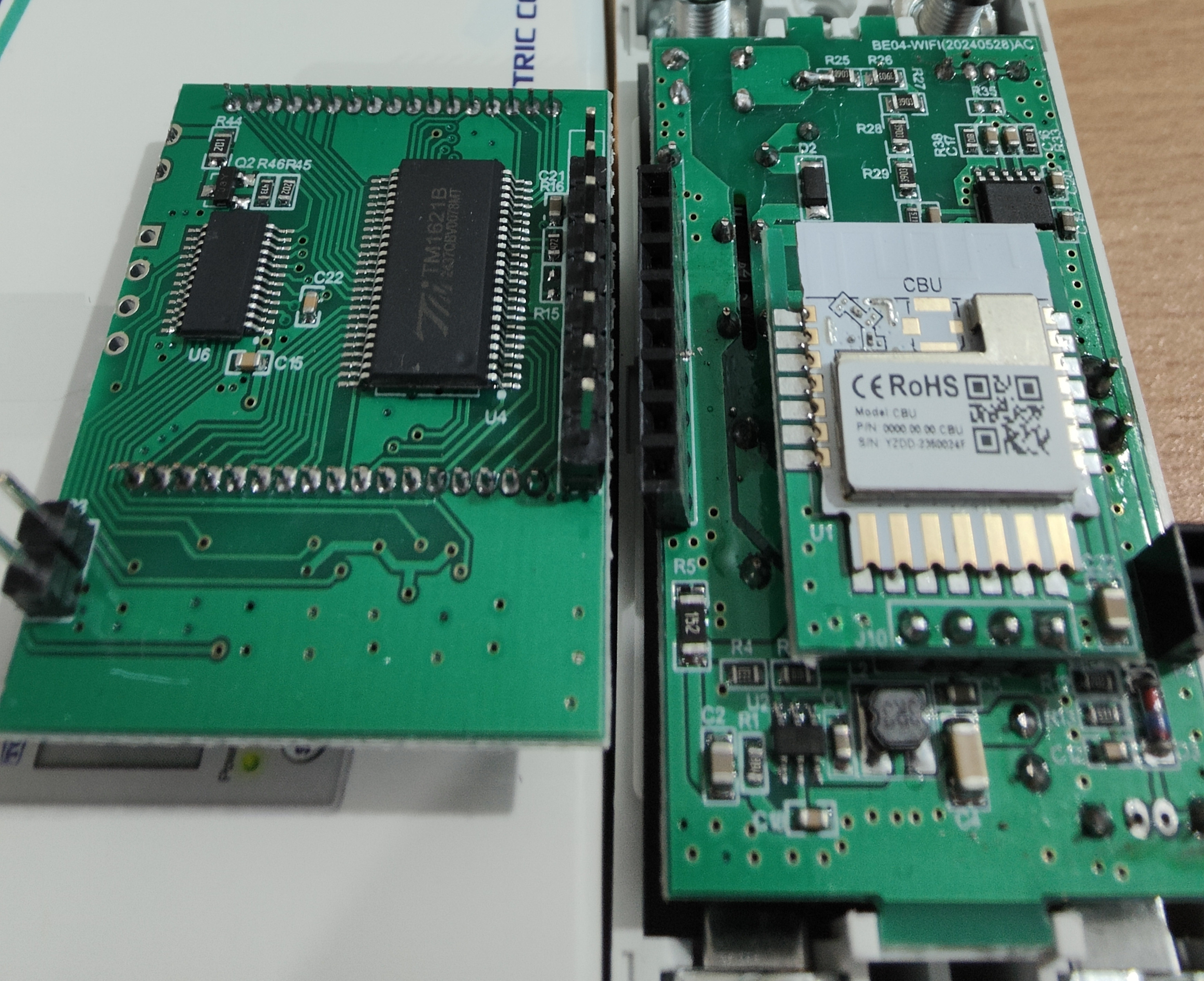

  • #127 21407056
    quantum8
    After successfully flashing one of these devices, I ordered a second one but it appears they've changed the PCB layout again.
    This version has the wifi module mounted on the main board via a soldered in riser.
    I haven't attempted flashing it yet but will report back afterwards.

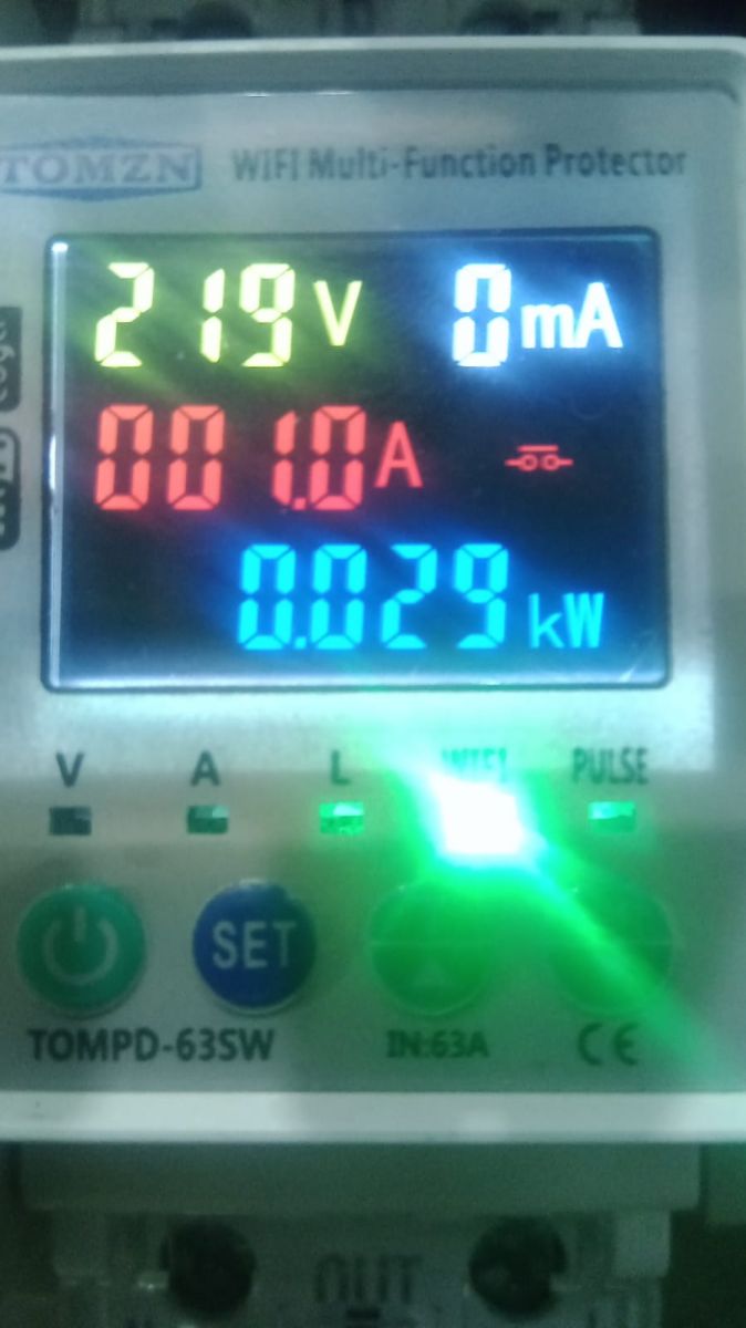

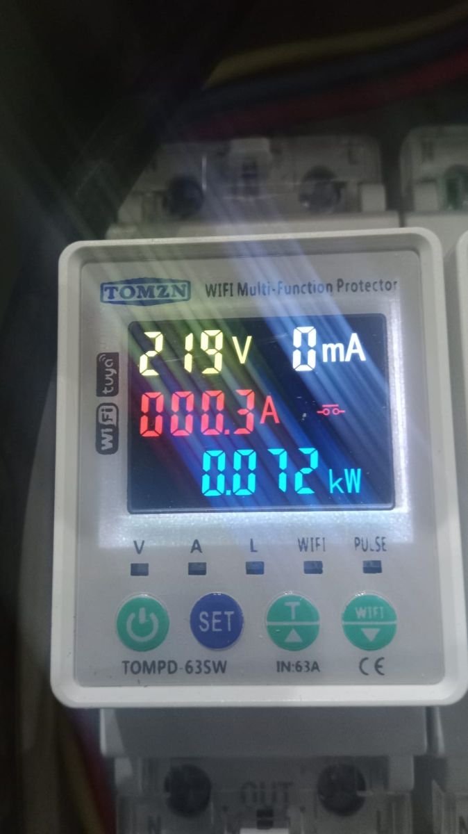

    #129 21412055
    koshov
    Hi everyone, I'm currently using 3 of these devices on each phase of my 3Ph+N grid supply as a means of protecting against abnormal voltage. I haven't yet torn down and re-flashed them, however I recently added them to Home Assistant using the Tuya Local integration and noticed that the power meter on the device reports much lower values than other metered relays.
    I have several DIN rail "Tongou" Tuya smart relays connected to single large loads that report values in line with what I'd expect for e.g. a heat pump, however the power usage on the 3 main phases reported by these Tomzn devices never exceeds ~100W and subsequently the metered values are a fraction of what I know is used "downstream" of them.
    It's worth mentioning that all loads on the 3 phases are connected to a common Earth/Neutral rail, thus I had to disable the leakage protection of the Tomzn - could that be the source of the issue?
    I wanted to check if folks here have similar experience and these devices just aren't suitable for metering before I go down the teardown and flashing rabbit hole. Cheers!

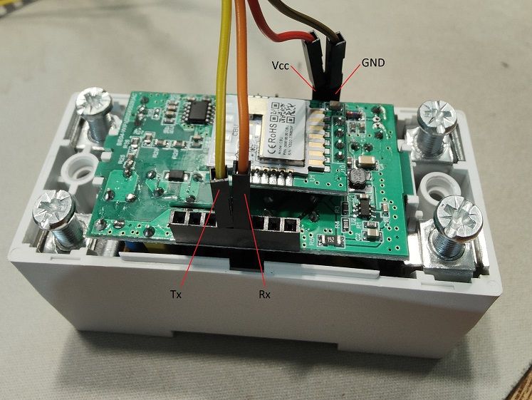

  • #134 21453780
    quantum8
    A quick update on the board I have as I finally had a little time this evening;
    It appears you don't need to solder anything to flash this device as all the pins are accessible via the headers now.
    Electronic board with cables connected to headers for Vcc, GND, Tx, and Rx.

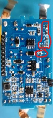

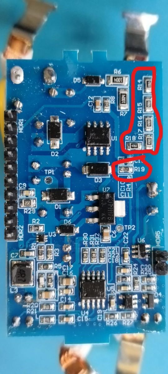

  • #135 21487634
    leśny_ziutek
    Posts: 52
    Rate: 9
    As the VoltageSet, CurrentSet, PowerSet commands doesn't work with this device (see >>21487463) is there any way to calibrate it? May ones require voltage calibration (3-4 V error).
  • Hardware voltage-divider adjustment for BL0942 calibration
    #136 21487791
    morgan_flint
    Posts: 251
    Rate: 63
    >>21487634
    Unfortunately, I don't think there's a simple way to calibrate it. As @p.kaczmarek2 says in the post you linked, in this case, the communication between the measuring IC (BL0942) is handled by the
    TuyaMCU, which serves the elaborated measurements info to the WiFi module, so any calibration should be done in the Tuya MCU's firmware, not accessible for us.
    In other similar TuyaMCU devices, I've seen calibration parameters in the settings menu and/or in the DPIds that could adjust for errors directly in the Tuya MCU but, apparently, that's not the case in this one, at least in the version installed in my device.
    If the error only affects voltage measurements, you could try a hardware approach by adjusting one of the resistors (R14-18 or R19) in the voltage divider connected to pin 4 of the BL0942, (see schematic at this post).
    Blue printed circuit board with various electronic components, including resistors marked in red.

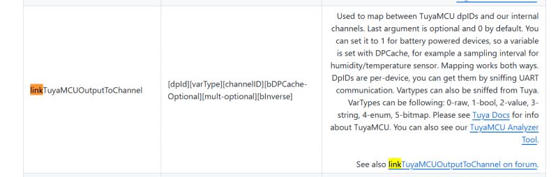

    Posts: 14770
    Rate: 12913
    @leśny_ziutek maybe add here argument - delta?
    Screenshot of documentation related to TuyaMCU, showing a table with links and parameters.

    Posts: 14770
    Rate: 12913
    leśny_ziutek wrote:
    @p.kaczmarek2 I didn't found anything about "delta" param. Is it an offset or a scale?
    It was an idea. A suggestion. I said that I can add something like that if you think that it would be useful.

    Posts: 14770
    Rate: 12913
    @leśny_ziutek I added delta now.
    https://github.com/openshwprojects/OpenBK7231...mmit/b80fff5d409947ae9120712865df6af3fc469f28
    @morgan_flint there is already scale...

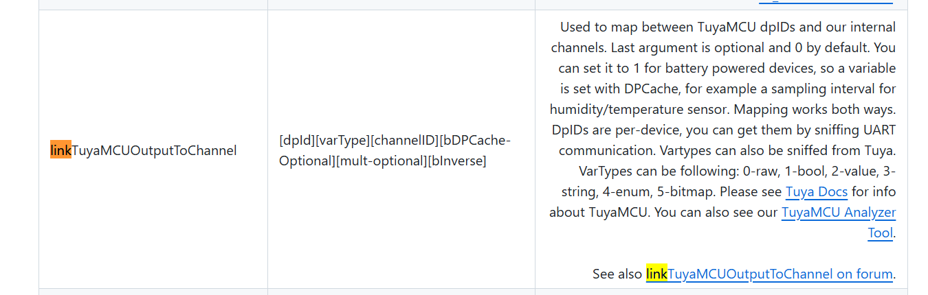

    linkTuyaMCUOutputToChannel [dpId] [varType] [channelID] [bDPCache] [mult] [inv] [delta]
    This is per dpID. Not for VCP yet.
    For VCP, we might use our WIP berry integration... but it depends on what do you need.
    Futhermore... well, @leśny_ziutek , we can only calibrate data sent to HA and shownin OBK. We can't calibrate data on screen, because it's sent directly from MCU to screen. OBK can't access that

    pexicele
    Level 4  
    Posts: 7
    Hi, I have Tompd 63 SW - wifi (color display) - flashed (OpenBK7231N_1.18.72) - i need an working autoexec.bat, I had tried many versions - none of them works ok, I even flashed my device with old firmware versions - no succes. I'm not able to update .html files - (it shows size 0 after upload.) There is something else updated since 1-2 years ago ? (i see posts with perfectly working devices..)
    Thanks for your help.
    LE : this seems to works ok :
    setChannelType 5 Voltage_div10
    setChannelLabel 5 "Voltage"
    setChannelType 7 Current_div1000
    setChannelLabel 7 "Current"
    setChannelType 6 Power
    setChannelLabel 6 "Power"
    this not (return wrong value for current) :
    and another thing: the device that "seems to work" has a non linear error for currrent (smaller current = bigger error) , I've attached pictures for a not-flashed and flashed devices.
    Display of TOMZN TOMP 63SW device with voltage, current, and power meters.
    Color display of the TOMPD 63SW device showing electrical measurements.
    Ok, sorry for spam, it seems that now there is not enough memory for autoexec + html file, don't know the reason. I was forced to slim down the autoexec file and remove comments and also the "Prepaid" part since I have no interest in this. Now is working.
    • autoexec_minimal.zip (619 Bytes) You must be logged in to download this attachment.
