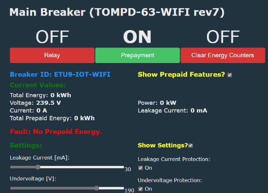

    If you open device's web page you will land into something like this:
    Screenshot of the TOMPD-63-WIFI automatic breaker interface showing settings.
    From the screenshot above one can conclude everything is ok. Toggles are responding and the device performs expected functions. If we take a closer look we will discover that not everything is ok. In this case protection reaction time, protection recovery time and purchased energy are shown correct and you can change them. But what should mean channel Fault = 65536, BreakerID = 0, Leakage current protection = 67174430. Undervoltage, overvoltage and max. current - you cannot even set them (in this example I intentionally set this dpID as read only, because in general you really cannot set it from this interface).
    Now checking Fault channel and knowing the representation of the Fault we will discover everything is ok, since 65536 corresponds to 2^16, i.e. 16th bit is high and this should say 'Not enough purchased energy'. So everything is ok.
    The same is valid for leakage current protection - 67174430 dec = 04 01 001E (hex); 01 - protection is ON; 001E = 30 mA leakage current is allowed. You can even change that - enter 67108896 (04 00 00 20 - protection is OFF and 32 mA leakage current is allowed). You can check settings in the device and you will see everything is ok.

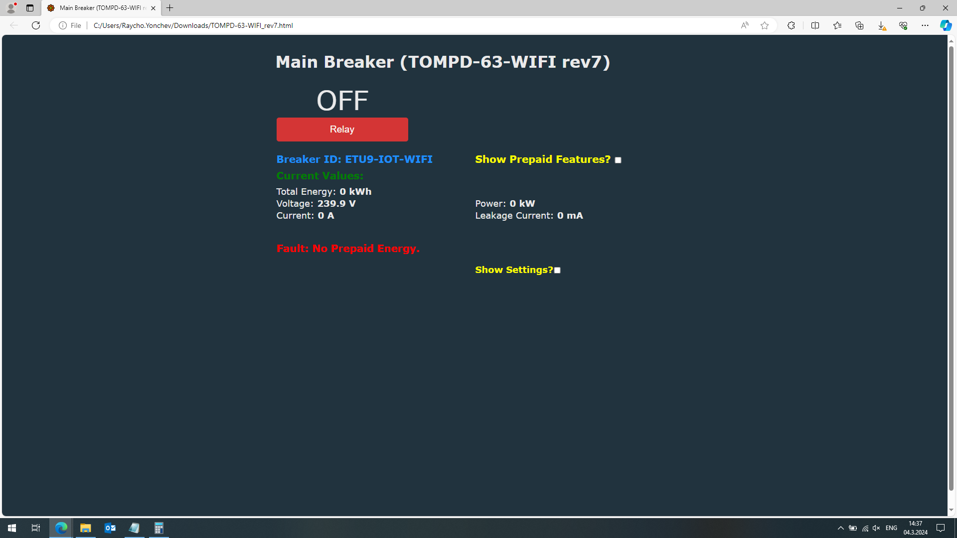

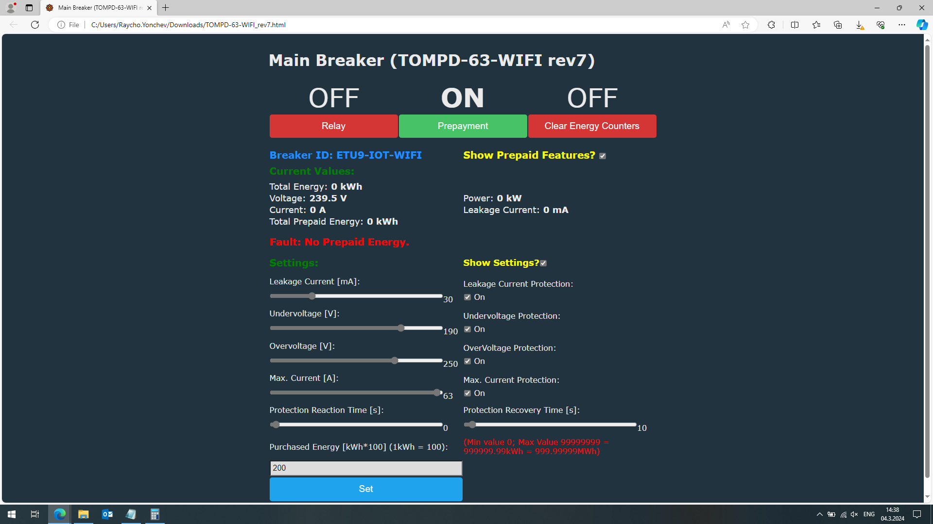

    In this case, I created alternative web page to control this TOMPD-63-WIFI device. Initial purpose was quickly to access device's settings without writing additional modules for integration in my HA server (I'm using FHEM, which is written in Perl and definitely additional module was necessary). Now, I realise you can use this alternative page as an example to create your own module in whatever programming language your HA server understands.
    To use this alternative page you need:
    1. You successfully flashed your device
    2. You have configured it correctly via autoexec.bat. I recommend to use the attached by me autoexec.bat. EDIT: If you are not using my autoexec.bat be sure to SET flag 46 in order Dp command to work!!!
    3. To use the script, first open it with text editor (I would recommend Notepad++) from your PC and find baseURL= . Type the IP address of your device. Save, close and double click on the html file. It should open in your default web browser. You can test all functions. Once you have done everything correct, in your browser you should have something like this:
    Screenshot of the TOMPD-63-WIFI device interface displaying energy values and a fault error for no prepaid energy.
    Screenshot of the TOMPD-63-WIFI control interface showing settings and parameters.

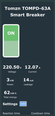

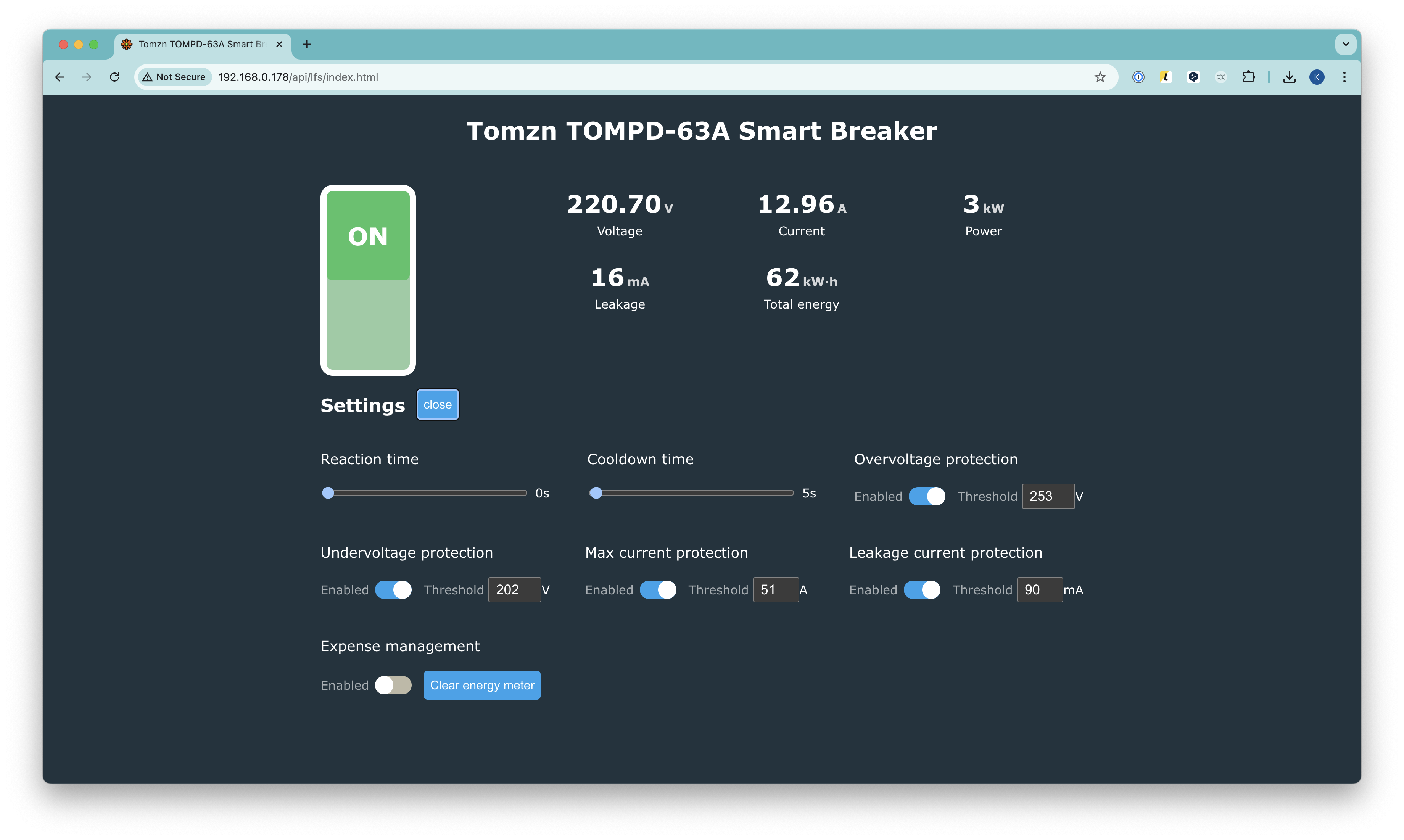

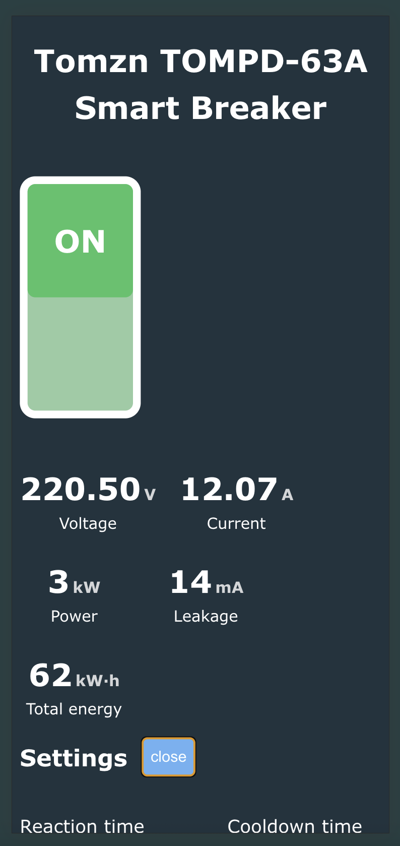

    Hi everyone!
    I know it's been a while since the last post here and the device has been already discontinued, but for those still using TOMPD-63, I've created a modernized version of the web interface.
    What's new:
    - Complete rewrite in TypeScript with Vite build system
    - Component-based architecture for better maintainability
    - Build size: ~19KB
    Tomzn TOMP-63A breaker control interface with voltage and protection settings visible Control panel of Tomzn TOMPD-63A breaker showing voltage, current, and power stats
    Features:
    All functionality from the original version is preserved:
    - Real-time monitoring (voltage, current, power, leakage current)
    - Protection settings (overcurrent, voltage, leakage current)
    - Prepayment mode control
    The project can be found there: https://github.com/klevytskyi/tompd63-web-ui Simply download the TAR archive from GitHub Releases and drop in LittleFS
    Thanks for the inspiration from this thread - the original HTML version was invaluable!
