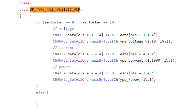

    At the moment, we do it as simply as possible, i.e. we simply add a special enumerator value via PR and in it:
    Program code showing the parsing of raw data in DP_TYPE_RAW_TAC2121C_VCP format.

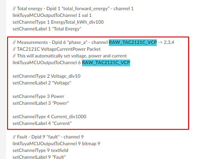

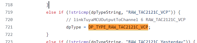

    Wait a minute, doesn`t the above type of package from the screenshot match what you have? Voltage (times 10, as a total), current (times 1000, as a total), and power?
    I guess that`s it. Even the dpID from the comment is correct - dpID 6. Add to autoexec.bat:
    Screenshot of a code snippet with the expression DP_TYPE_RAW_TAC2121C_VCP highlighted.
    Set the type channels ChType_Voltage_div10 ChType_Current_div1000 ChType_Power and OBK itself will parse it in the current firmware version.
    PS: I know it would be better to have some more scriptable format parsing raw but as you can see, at least the VCP (Voltage/Current/Power) frame is repeated between devices and its format from TAC2121C also fits your device.

  • RAW_TAC2121C_VCP auto-maps voltage, current, and power
    #37 20943257
    Posts: 14771
    Rate: 12914
    If you use this line:
    linkTuyaMCUOutputToChannel 6 RAW_TAC2121C_VCP
    It will automatically set channels of the following types:
    - Voltage_div10
    - Current_div1000
    -Power
    on the values from this package. Channel types maintain the integer convention to maintain compatibility with TuyaMCU.
    Look:
    https://www.elektroda.com/rtvforum/find.php?q=RAW_TAC2121C_VCP
    Screenshot from the search engine:
    Screenshot of TuyaMCU configuration code with settings for voltage, current, and power measurements.

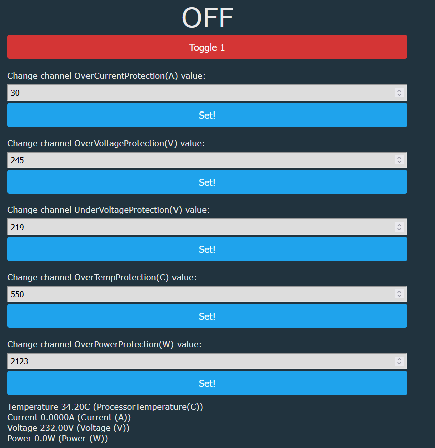

    Hurray, managed to get some energy readings. The current autoexec looks like this:
    startDriver TuyaMCU
    tuyaMcu_setBaudRate 115200
    tuyaMcu_defWiFiState 4
    setChannelType 1 toggle
    setChannelType 2 TextField
    setChannelType 3 TextField
    setChannelType 4 TextField
    setChannelType 5 TextField
    setChannelType 6 TextField
    setChannelType 7 temperature_div10
    setChannelType 8 Current_div1000
    setChannelType 9 Voltage_div10
    setChannelType 10 Power
    setChannelLabel 2 "OverCurrentProtection (A)"
    setChannelLabel 3 "OverVoltageProtection (V)"
    setChannelLabel 4 "UnderVoltageProtection (V)"
    setChannelLabel 5 "OverTempProtection (C)"
    setChannelLabel 6 "OverPowerProtection (W)"
    setChannelLabel 7 "ProcessorTemperature (C)"
    setChannelLabel 8 "Current (A)"
    setChannelLabel 9 "Voltage (V)"
    setChannelLabel 10 "Power (W)"
    linkTuyaMCUOutputToChannel 16 bool 1
    linkTuyaMCUOutputToChannel 114 2 2
    linkTuyaMCUOutputToChannel 115 2 3
    linkTuyaMCUOutputToChannel 116 2 4
    linkTuyaMCUOutputToChannel 118 2 5
    linkTuyaMCUOutputToChannel 119 2 6
    linkTuyaMCUOutputToChannel 131 2 7
    tuyaMcu_sendQueryState
    The other things you might want to figure out are:
    Times after which the device should respond to OverVoltage/Power/Current/Temp etc.
    What events should it respond to and how, e.g. ALARM, TRIP, OFF
    Total power consumption (what`s on the display - probably dpID 137 but I`m still verifying it.
    Turning off the display - it seems that dpID 141 in the true (1) state turns off the display and this is important because This saves almost 0.6W during operation which is not much in the short term, but over time this value begins to add up quickly.
    I will keep you updated on the progress of the work and inform you so that someone in the future can easily modify the entire device so that it is compact and ready for operation without unnecessary games and combinations.
    As for the LOG buffer, I think I would leave it enlarged because in the future there will certainly be other devices that will have such a large number of dpIDs and this LOG size ensures that all available dpIDs will be displayed. The whole thing in the control panel currently looks like this:
    Energy consumption monitoring device control panel with protection configuration options.
    If anyone sees channels that may be responsible for the above-mentioned functionalities, feel free to write to me, it will make my task easier.

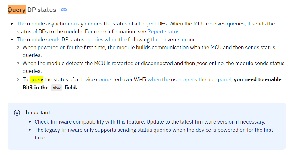

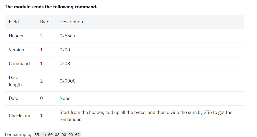

    Selfdrivers wrote:
    Personally, what I would add is to the command tuyaMcu_sendQueryState gave the opportunity to provide parameters (e.g. to update id = 6 and not everything possible), of course I don`t know if this is possible when it comes to hardware and software (communication interface), but if there was such an option, it would certainly enable more efficient updating data.
    I`m afraid this is not possible, according to the documentation:
    Screenshot of documentation about querying DP status in a module.
    Table describing the structure of the command sent by the module.
    but documentation is documentation, if you want, you can send the command 0x08 with one payload byte being dpID and see what happens.
