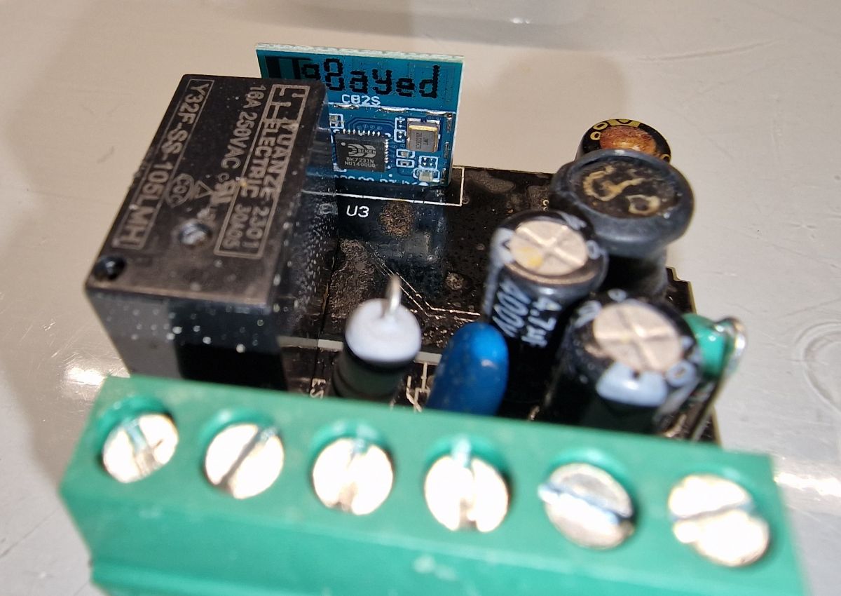

  • Hi,

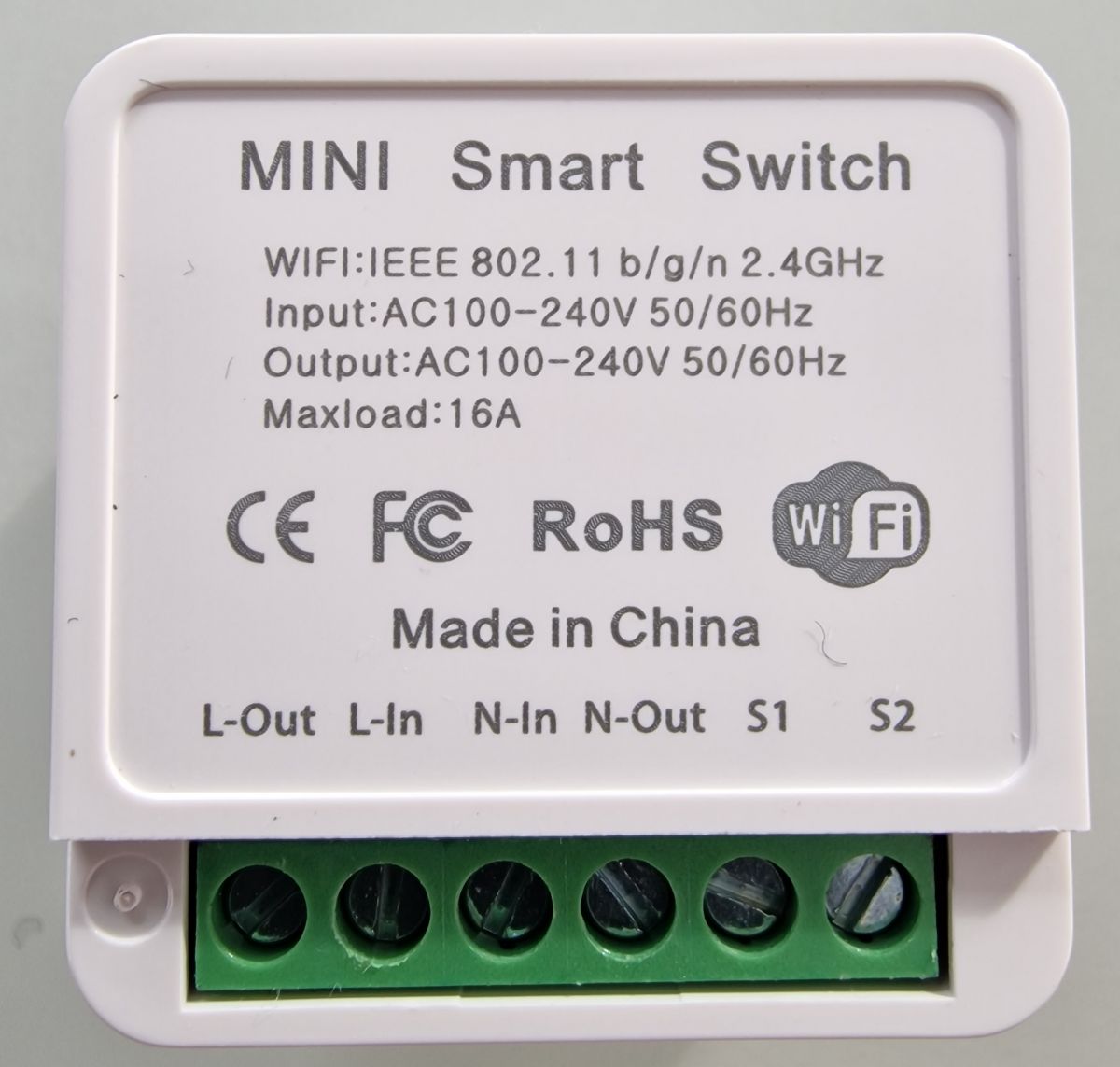

    I have a new entry for the IoT device teardowns list for a 16A WIFI Mini Smart Switch.
    There are already several entries for similar devices like this one which can be bought at a very low price e.g. at https://de.aliexpress.com/item/1005005302988558.html
    However this one, which is distributed by vendor SHUNSHUN in Germany has a different layout, which makes it pretty easy to flash OpenBeken on it.

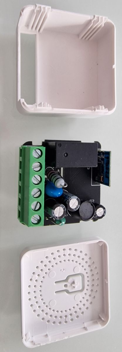

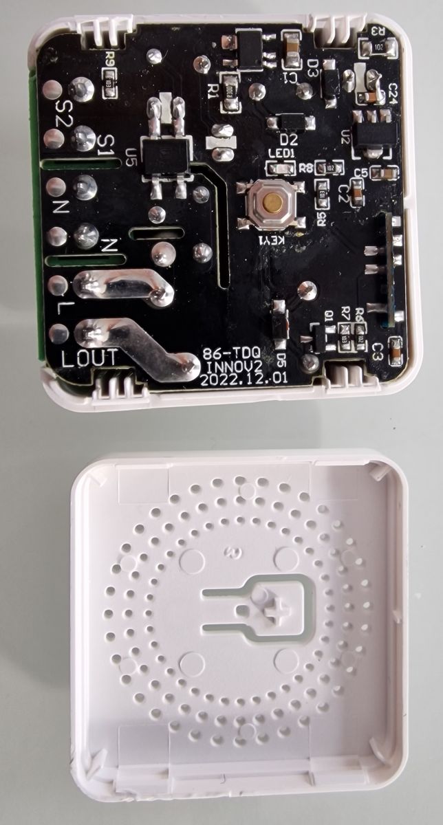

    Teardown:
    Mini Smart Switch with technical information and connection inputs. Image of the interior of a Mini Smart Switch 16A WIFI showing its electronic components. View of a disassembled Mini Smart Switch 16A WIFI, showing internal components and its casing. Close-up of a smart switch interior with a CB2S module and various electronic components. Close-up of the PCB inside a Mini Smart Switch 16A WIFI with visible UART connection pins.

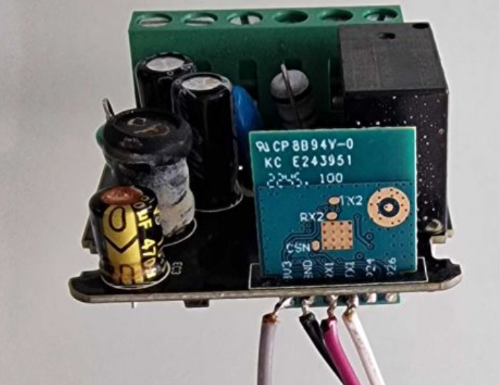

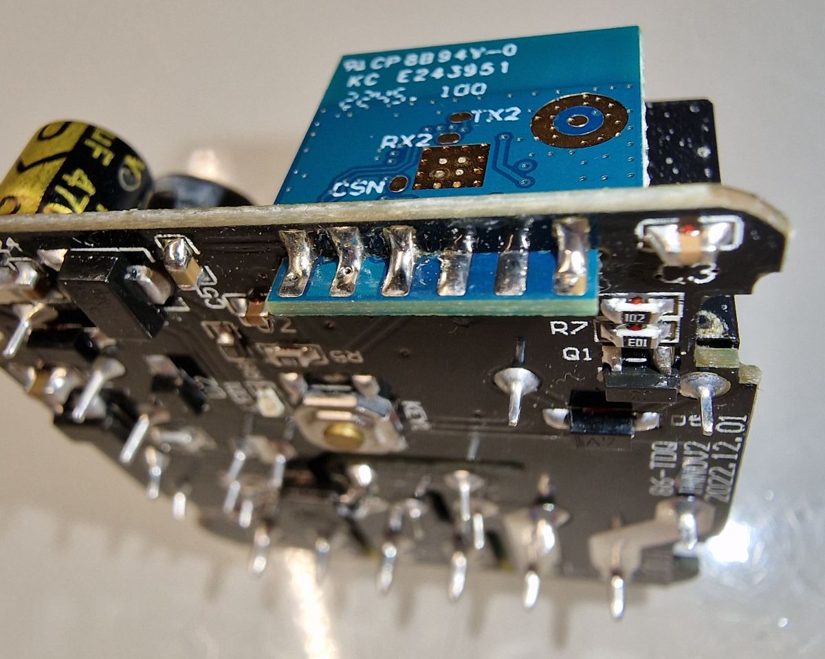

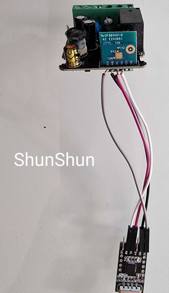

    As shown on the uploaded image, we just need to connect 4 wires to an UART controller:
    Mini Smart Switch board with wires connected to a UART controller.
    TX1 -> UART RX
    RX1 -> UART TX
    GND -> UART GND
    3v3 -> UART 3V
    Reset for Flash Mode: Disconnect 3V shortly from UART and reconnect afterwards.
    Chip type: BK7231N
    Baud rate: 115200
    Connect WIFI to OpenBK Access Point and access for initial configuration:
    http://192.168.4.1/index
    Extracted device template (anonymized):
    JSON format:
    Text description:
    - Pair/Toggle All Button on P10
    - WiFi LED on P7
    - TglChannelToggle (channel 1) on P26
    - Relay (channel 1) on P8
    Device seems to be using CB2S module, which is using BK7231N.
    In OpenBeken, type PowerSave 1 in Startup Command to activate low power mode after every reboot.

    And here is OBK template:
