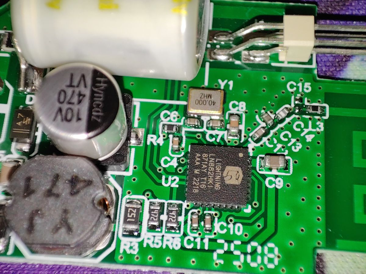

You need to configure the BP5758 LED driver, not just hunt random GPIOs: the module is an LN882H + BP5758 combo, so first identify which LN882H pins go to the BP5758 SCL/SDA (same as CLK/DAT) with a multimeter rather than guessing [#20970790] The thread later confirmed on this board that A0 is connected to SCL and A1 to SDA [#20971840] Once the driver support was enabled, the working LED mapping was `LED_Map 3 4 2 0 1` [#21010588] For brightness/current, the BP5758 current command was also used to tame heat; `BP5758D_Current 2 2` was reported stable for 2 hours at about 80°C, and `BP5758D_Current 1 1` was said to keep one unit around 73°C [#21011100] [#21650555]

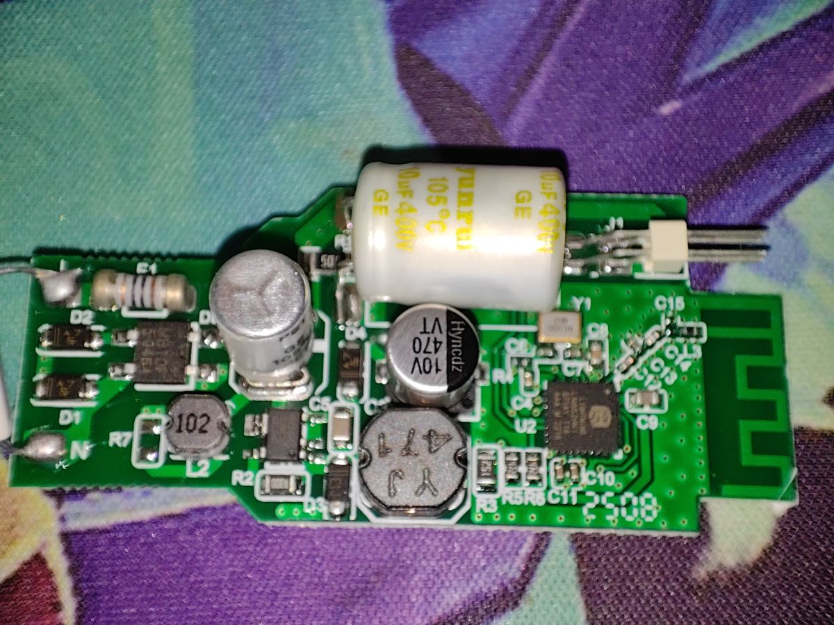

  • Reversed UART pins and flash dump retry notes

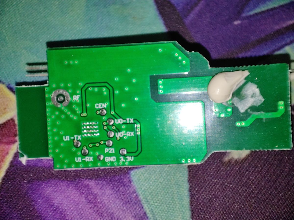

    #64 21554929
    spleefer90
    Posts: 17
    I have a board very similar to https://www.elektroda.com/rtvforum/topic4037269-30.html#21264807, but this version is marked as 20W (there was also an 18W version, AliExpress) - unsure how truthful those numbers are.
    I unfortunately bent the coil(?) and only later realized I can probably poke it out through the two holes on the inside... how do you otherwise remove that without damaging it, it seems very fragile? I ended up rescrewing it by force which sort of re-threaded it.
    Contacts points are the same as per https://www.elektroda.com/rtvforum/topic4076095.html#21228879
    Note the REVERSED TX/RX:
    U0-TX -> RX
    U0-RX -> TX
    GND -> GND
    3V3 -> 3V3
    P21 -> GND(during boot, to enter flash mode, safe to keep it throughout)
    Taking a backup ran for a short amount of time then crashed:
    python LN882H_Flash_Dumper.py COM3 backup 0x0200000
    LN882H flash dump tool v1.0
    Loading RAMCode...
    Flash RAMCode loaded OK.
    Dumping flash OTP to backup_otp.bin:
    complete.
    Dumping flash (size: 0x200000) to backup_flash.bin:
    ...................................................................................................................................................Error: Fail. Command execution error.
    The OG Python script does not handle errors, I have forked it and gave it some resiliency, now one can actually see progress and it retries on errors -
    https://github.com/C0rn3j/LN822H_dump_tool
    It still crashed at the very end overwriting the FW it had until then, yet to fix that one:
    .............Traceback (most recent call last):
    File "C:\Users\SadCyclops\Downloads\LN882H_CMD_TOOL\LN882H_Flash_Dumper.py", line 81, in <module>
    read_flash(flash_file, arg_port, flash_size)
    File "C:\Users\SadCyclops\Downloads\LN882H_CMD_TOOL\LN882H_Flash_Dumper.py", line 26, in read_flash
    bin = bytearray.fromhex(flash_hex)
    ValueError: non-hexadecimal number found in fromhex() arg at position 23
    Eventually I got the FW dumped and flashed OpenBeken, re-assembled it, configured Wi-Fi, configured the pinouts and startup command to swap red and blue as per the existing 9W device entry.

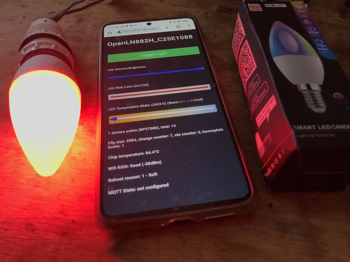

    I think I need to limit brightness maximum because, I don't know about you, but the CPU temp did hit 100 degrees C on mine and the chip hung.
    I've flashed mine today and got the same problem.
    A red-glowing LED bulb next to a smartphone displaying a Wi-Fi control interface for device OpenLN882H.
    Same I2C chip, same LED map. Hit 100C with bulb on quickly.
    @divadiow on which current value did you settle?
  • #66 21650550
    Posts: 5212
    Help: 446
    Rate: 914

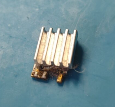

    oh! I'll dig it out. I even bought little heatsinks to see if I could make it stable. I think I stopped trying.
    Will report back.
  • #67 21650555
    Posts: 14755
    Rate: 12880

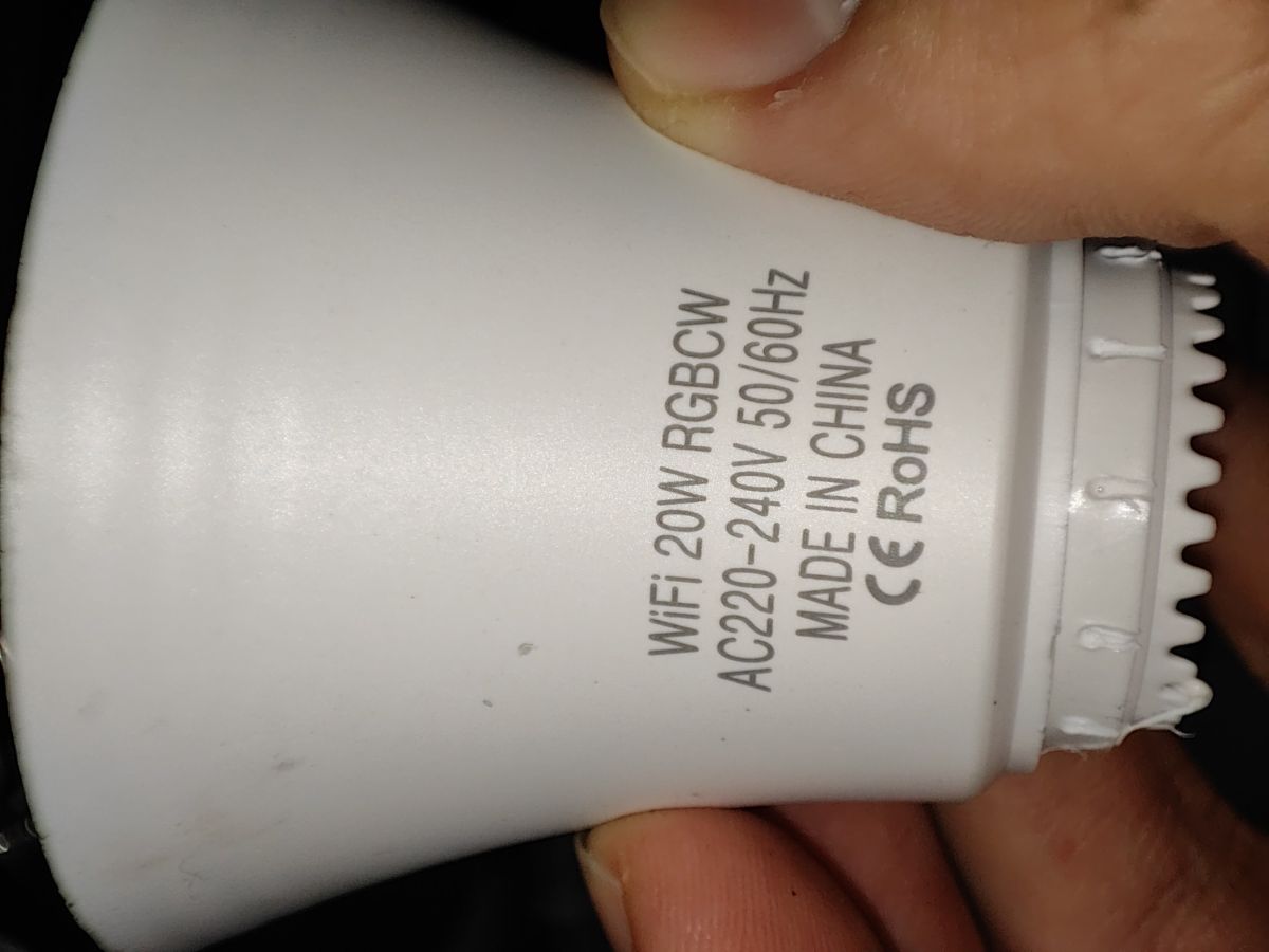

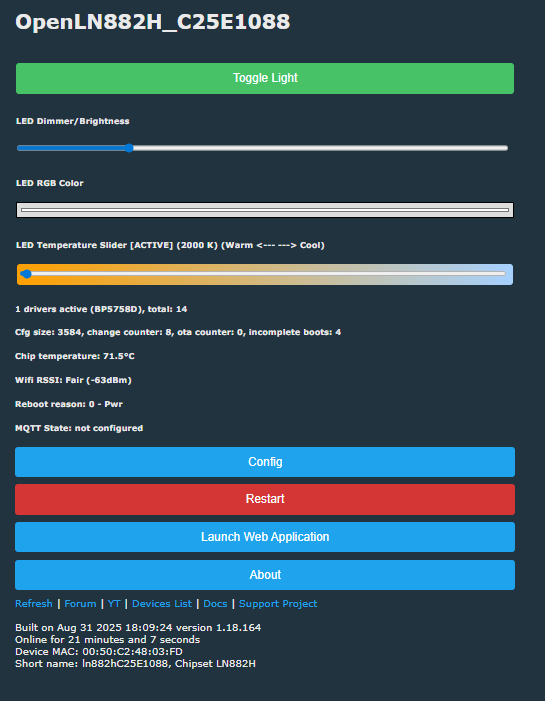

    It is stable with lower brightness and dome removed:
    Screenshot of the LED controller OpenLN882H_C25E1088 web interface with brightness, color, and temperature controls plus diagnostic data.
    I am testing lowest current:
    BP5758D_Current 1 1
    Another thing is that we always interfere with cooling structure by removing glue...

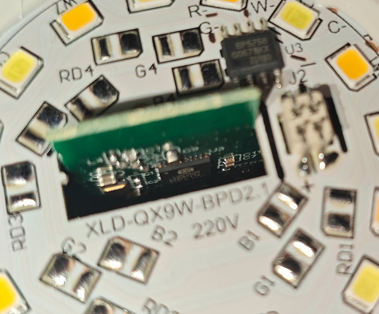

  • LN882H module loose with no factory cooling
    #68 21650558
    Posts: 5212
    Help: 446
    Rate: 914

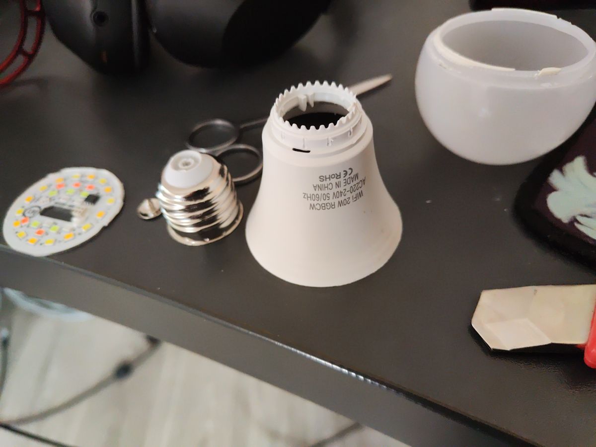

    hmm. nope it got harvested for the BP5758. LN882H module is loose in module box
    Small electronic module with an aluminum heatsink on a blue work surface.
    Added after 44 [seconds]:
    true that

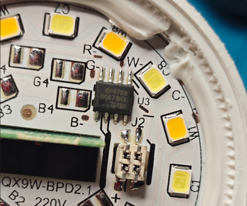

    Added after 6 [minutes]:

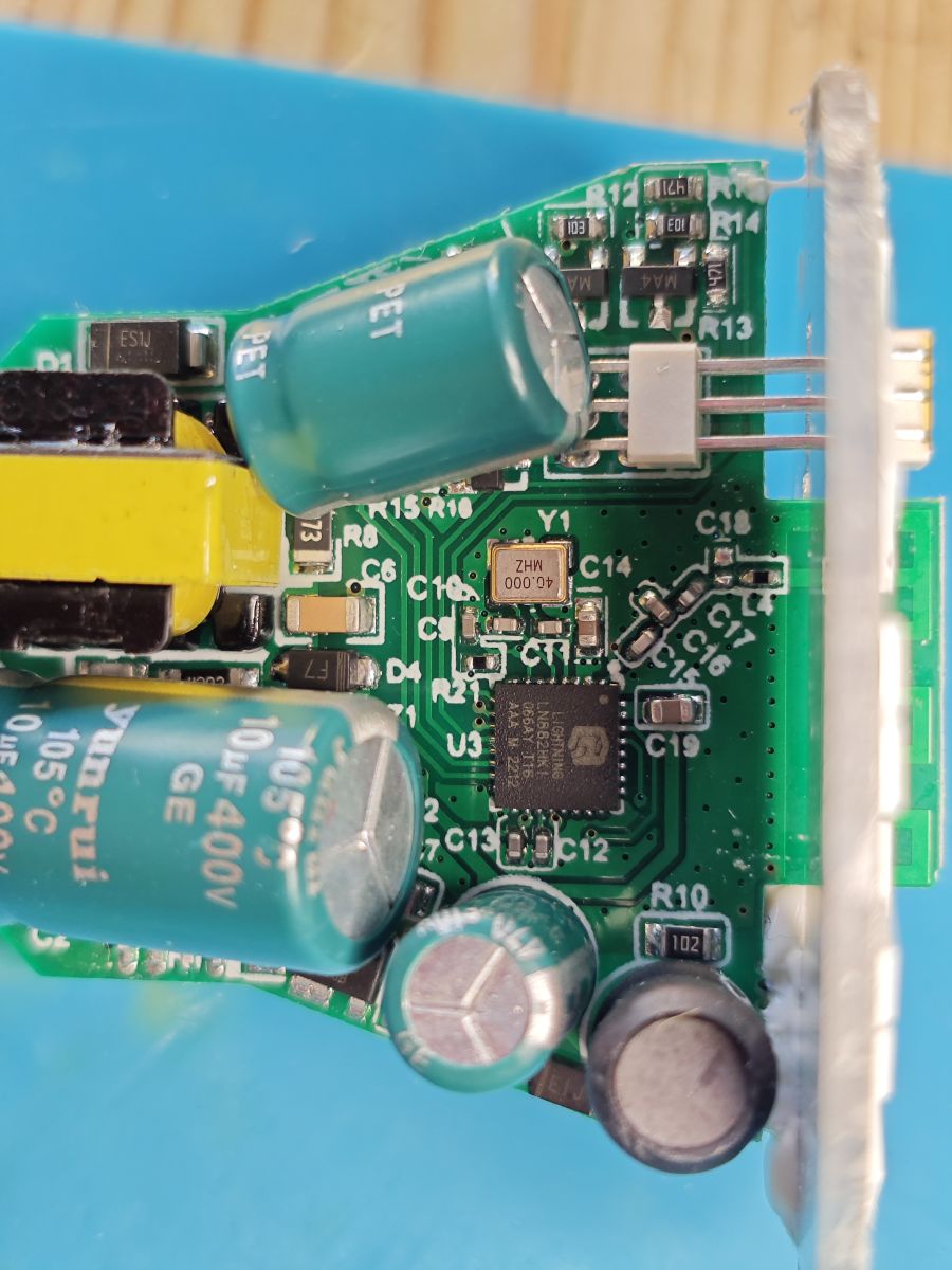

    actually. I have one of these, https://www.elektroda.com/rtvforum/topic4076095.html#21228879
    no factory heat dissipation measures
    Close-up of a PCB with electrolytic capacitors, resistors, an inductor, and an integrated circuit.

    For me it seems stable at 73 degrees with:
    BP5758D_Current 1 1
    Still, this is lower brigthness than in factory firmware. I will try higher current.,

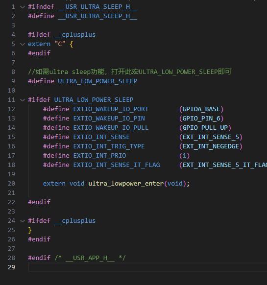

  • Tuya ln_pm.h power-save comparison with OpenLN882H
    #70 21650568
    Posts: 5212
    Help: 446
    Rate: 914

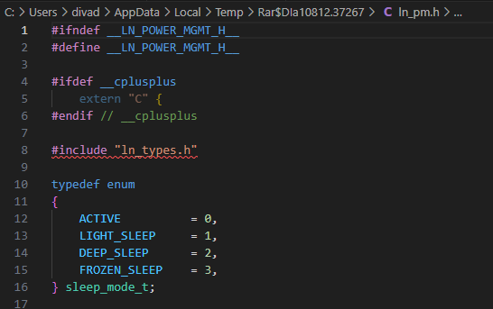

    makes you wonder though, what's different with powersave in factory fw to make it run cooler, assuming it does
    something special to Tuya SDK? dunno
    Screenshot of a C header file showing definitions for ultra low power sleep mode in an embedded system.
    Added after 3 [minutes]:
    Tuya ln_pm.h
    Screenshot of C header file code named ln_pm.h with sleep mode definitions.
    but also seen in https://github.com/openshwprojects/OpenLN882H/blob/master/components/utils/power_mgmt/ln_pm.h

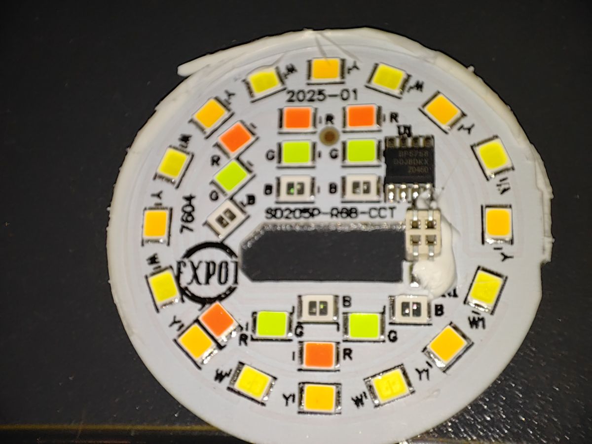

    BP5758 LN882H CozyLife just arrived with as-yet unknown PCB (maybe). Maybe this one can be tamed
    Smart B22 LED bulb box with product and distributor label Close-up of BP5758 chip and LEDs on a PCB module Close-up of a circular LED PCB with SMD diodes and electronic components
  • #74 21653821
    Posts: 14755
    Rate: 12880
    Hm interesting, looks like LN882H is directly on the main board, with no extra module. Let's hope that pads for flashing are routed out.
    I somewhat remember flashing similar device, I didn't have to remove the screw in this case. It should be described in one of my teardowns.

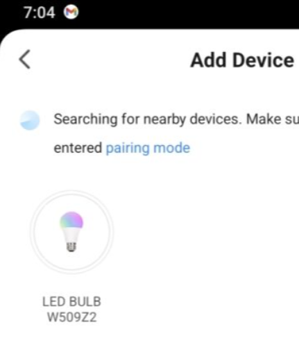

  • W509Z2 rgb cct bulb identification question
    #76 21712707
    srisawatsurasak
    >>21280147
    I used model W509Z2 rgb cct bulb.
    How can I see that the model is W509Z2 ?
  • #77 21712731
    Posts: 5212
    Help: 446
    Rate: 914
    It would be labelled as this when pairing with Tuya app. If you have factory flash backup I can flash and confirm for you
  • #78 21712745
    srisawatsurasak
    >>21712731
    Yes, I have original factory backup.
  • #79 21712747
    Posts: 5212
    Help: 446
    Rate: 914
    it is indeed a W509Z2
    App screen showing LED BULB W509Z2 being searched for in pairing mode
