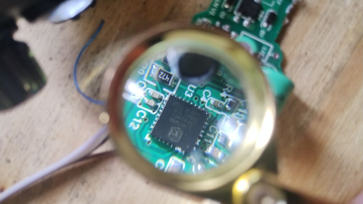

[LN882HKI] Tuya Smart Light disassembly and seek some help to set it up
gregmarfaing 12441 79
How do I configure this LN882HKI Tuya RGB light in OpenBK after flashing it, especially with the BP5758 LED driver?

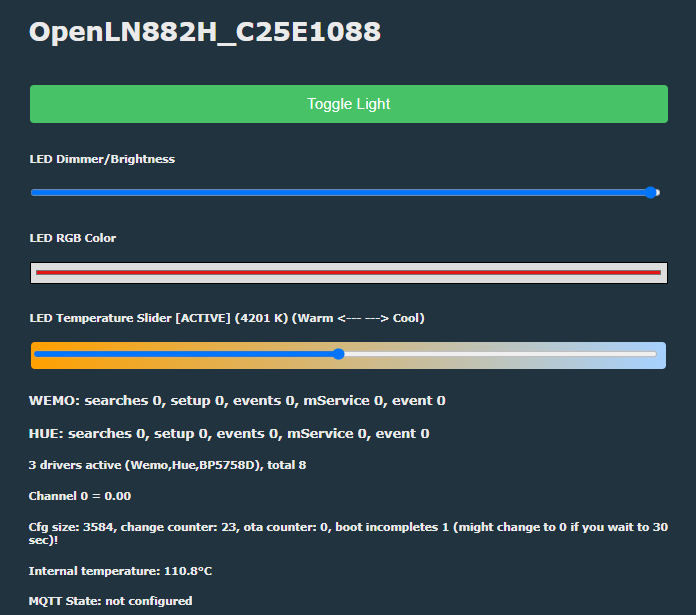

    thanks. WEMO and Hue seem OK starting though not yet tested.
    Screenshot of an LED light control interface with sliders for brightness, RGB color, and temperature, along with diagnostic data.
    build failed though, some GH rate limit?

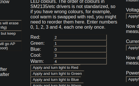

    Thank you so much for this update!
    I bought another bulb and was able to get the good mapping with this "LED_Map 3 4 2 0 1"
  • #33 21010611
    Posts: 5038
    Help: 438
    Rate: 891
    gregmarfaing wrote:
    "LED_Map 3 4 2 0 1"
    ah yes, well done. that's it.
    I think I need to limit brightness maximum because, I don't know about you, but the CPU temp did hit 100 degrees C on mine and the chip hung.
    Added after 13 [minutes]:
    also. Other BP5758Ds I've seen have seem to mention the mA used by each channel, so maybe Tuya OS limits to certain brightness.
    eg the Eveready GU10 in here https://www.elektroda.com/rtvforum/topic4040714.html is

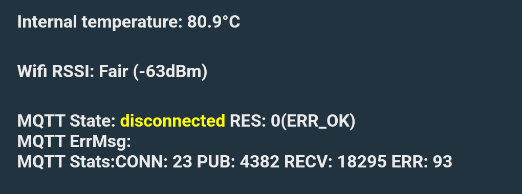

    with some time and temp/stability measurements I can say that with [code:1:29b21b0196]BP5758D_Current 2 2 [/code:29b21b0196] I get 80°C and no reboot/freeze (even after 2h turned on ) , except with mqtt with frequent disconnection when the devices is used with something heavier than just switching it on/off , in my case it's a rgb loop from HA .
    It could be a temperature issue as the device seems to be pretty responsive when it's off

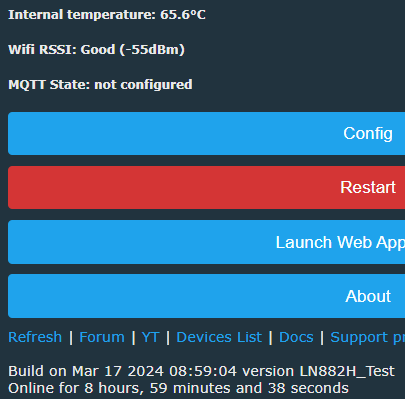

    divadiow wrote:
    Yes. Seem to be. I have an RMW002 on all night tonight measuring powersave 0 so will check up-time in the morning.
    I could setup 3 or 4 LN-02/RMW002s for a few days to see if they stay up
    OK so far
    Interface displaying internal temperature, WiFi status, and configuration options.

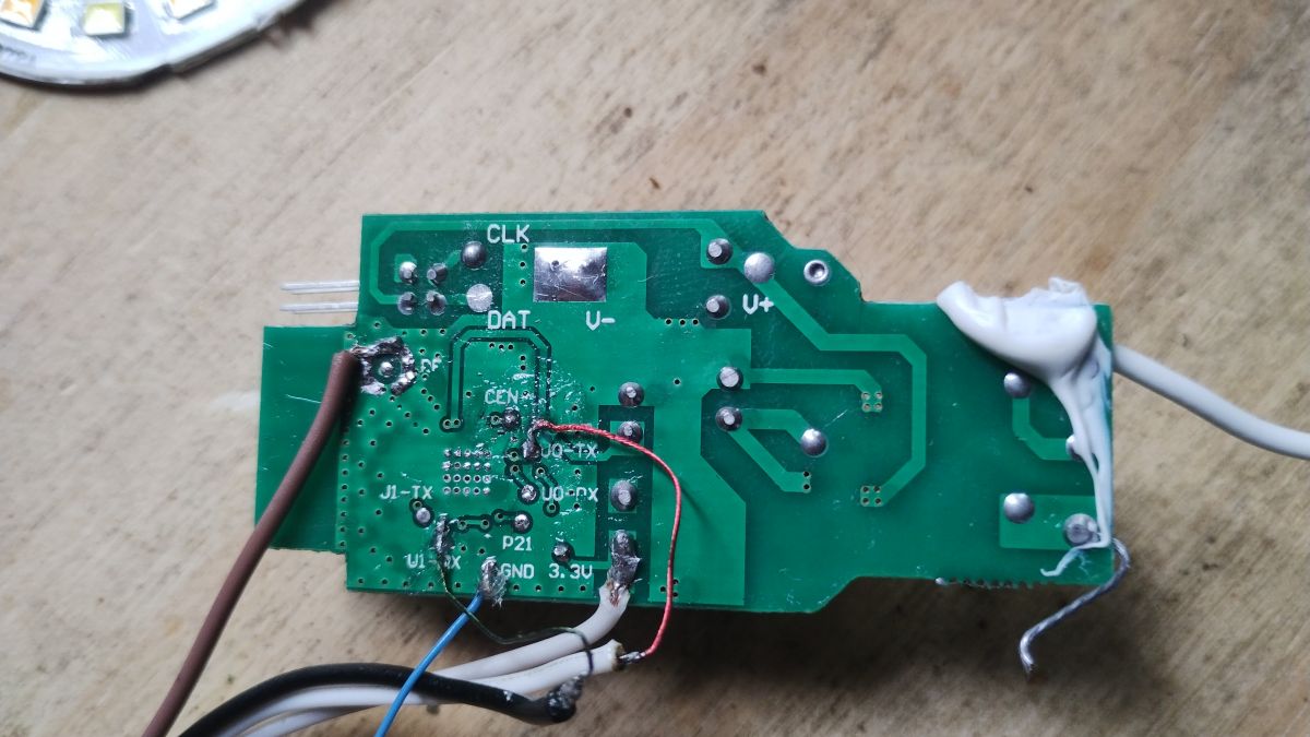

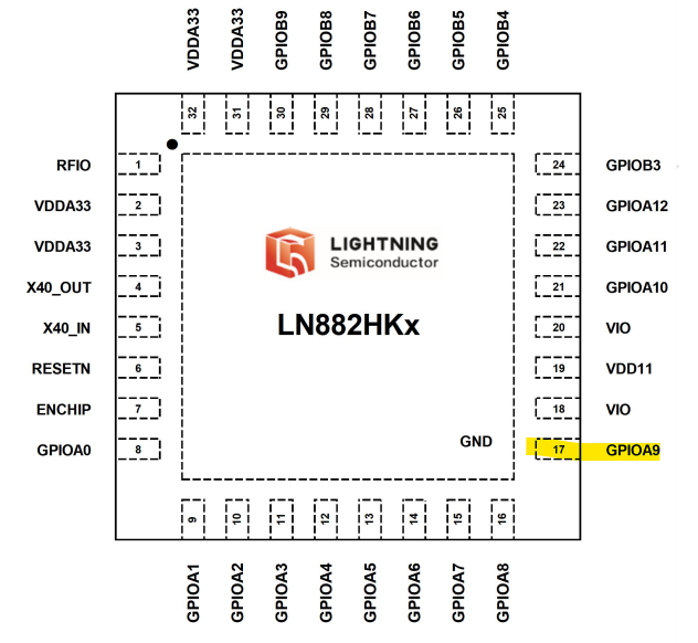

  • #45 21264807
    davidezborges
    Posts: 13
    hi everyone, i leave here the boot log from my device. im trying to dump the firmware but i wasnt able to run properly the tool.
    any leads will be accepted. tried both windows and linux but the tool refused to run and i rather have a backup in case something breaks.
    i can sbmit some pictures if needed.

    >>21266005 thanks for the help, I've been able to find the folder and file that uses the dump tool. Windows 10 refuses to open the serial port. Windows 7 can open the serial port and load RAM data. Anyways it says: fail. could not go in download mode.
    I'll keep trying, maybe it's a wiring problem. P21 should be shorted to ground, right?
    Maybe later (when I finish some work) I will upload some pictures of the board
  • #52 21266733
    Posts: 5038
    Help: 438
    Rate: 891
    davidezborges wrote:
    p21 should be shorted to ground, right?
    BOOT/GPIOA9 is pin 17 on LN882HKx.
    Pin diagram of LN882HKx IC with GPIOA9 marked at pin 17.
    which device/module do you have exactly, is it the candle bulb that is the main subject of this thread? and where are you seeing p21?
  • #53 21266912
    davidezborges
    Posts: 13
    >>21266733
    here we go, these are pictures from module and led controller.
    I'll try to find the post where I read that p21 was same as boot(the microcontroller actually doesn't boot when p21 is shorted to ground)
    it's not a candle bulb but the overall hardware is the same.
    #Edit
    made some continuity tests, p21 it's actually A9!
    Printed circuit board with visible traces, components, and connected wires. Image of a circuit board with various electronic components and wires connected. Printed circuit board with colorful LEDs and an integrated circuit. Close-up of a round circuit board with LEDs in various colors. Image of a circuit board viewed through a magnifying glass.
  • #55 21266966
    davidezborges
    Posts: 13
    >>21266943 the short answer is yes, the long answer is I just soldered another thin insulated copper line to U0-RX and will try to read the flash memory again.
    crossing fingers...
    #edit
    tried using U0-RX but no luck.
    I'll try to find where U1-RX comes from (that's the pin where I got bootlogs) maybe they changed default rx/tx pins?
    #edit 2
    used U1-TX but no luck either pins are B9 and B8 for TX and RX (LN882H side) respectively.
    I don't want to give up but this Chinese crap is taking longer than I expected to play nice.
    later I will use a dedicated power supply for this and try again. thanks again for every response.
    Added after 48 [minutes]:
    >>21266943 that really helped a lot, the LED controller is not the same but the wiring was.
    THANKS!! it is reading the memory dump right now

    @davidezborges what BP5758D map are you using on your W509Z2 E27? Is it "BP5758D_Map 2 1 0 3 4"?
  • #60 21281700
    davidezborges
    Posts: 13
    >>21280965 Screenshot of LED settings showing number configuration for colors: red, green, blue, cool, warm.
    2 1 0 3 4 is the final configuration I've been using.
    let me know if you need anything else.

10. What is GPIOA9 on the LN882H, and why is it used as the BOOT pin for entering download or flash mode?
GPIOA9 is the LN882H BOOT pin used to force download mode for flashing or dumping firmware. The thread later clarified that BOOT/GPIOA9 is pin 17 on LN882HKx modules, and one user verified that their board label P21 was actually continuity-linked to A9. Pulling that BOOT line low during startup was the key step for entering flash mode when backup tools reported that the chip could not enter download mode. [#21266733]
