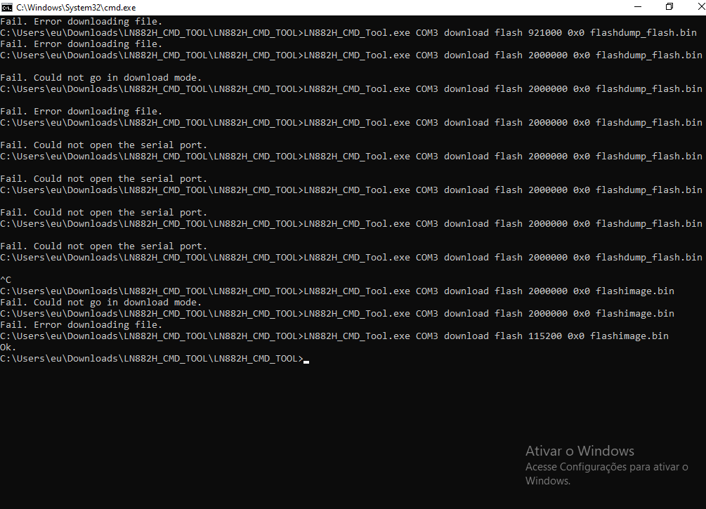

    Hi, Having same issue here.
    tried the following:
    1. disabled antivirus
    2. ran cmd as admin
    3. tried from E drive
    4. tried different baud rates
    5. tried short cables
    6. ch340 adapter
    getting "Fail. Error downloading file."
    dump was successful I think.
    Anything else I should try?
  • #64 20996330
    yoker77
    Level 4  
    Have you changed the baud rate in the command line?
    Should look like this: LN882H_CMD_Tool.exe COM7 download flash 115200 0x0 flashimage.bin
  • Changing baud rate to 115200 fixed flashing
    #65 20996463
    Advian1
    Posts: 41
    That's baud rate? of course it didn't work for me before, My adapter doesn't even support 2M baud rate.
    Setting it to 115200 immediately worked.
    Thanks a ton!

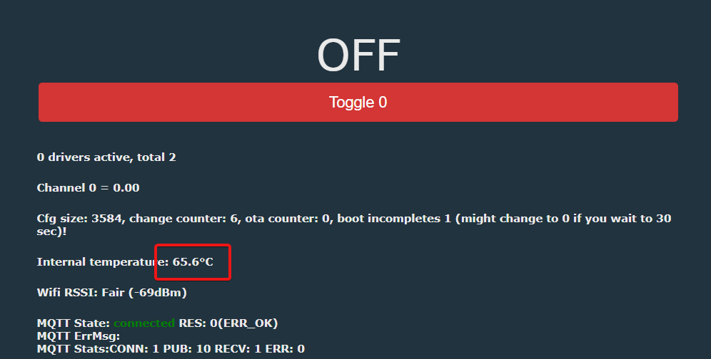

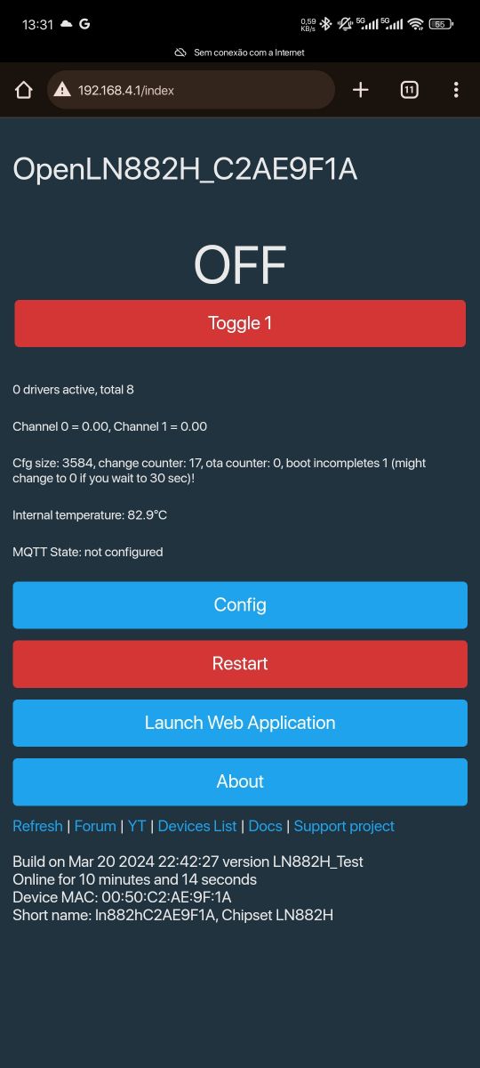

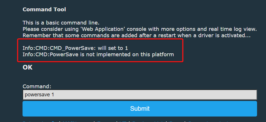

    Hi, Device is getting too hot.
    Screenshot of an IoT device interface showing an OFF state with a red Toggle 0 command and internal temperature of 65.6°C.
    Powersave is not available?
    Screenshot of a command line tool with information about power saving.

    @Advian1 I can try to add powersave command tomorrow

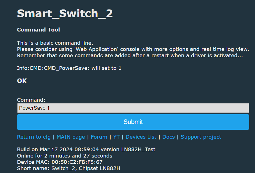

    I've added powersave command, usage:
    PowerSave 1
    in short startup command will enable powersave, and similiarly:
    PowerSave 0
    will disable it.
    Keep in mind to execute PowerSave in startup command so it is enabled on every boot.
    Can anyone check if its working correctly?
  • #71 21007589
    Advian1
    Posts: 41
    Thanks a lot. ❤️
    I'll test.
    Added after 1 [hours] 10 [minutes]:
    >>21007524
    not sure if it worked very well.
    power consumption of the device from the wall is 0.6W while off and 1.1W when On. (220v)
    Same after enabling PowerSave.
    Temparature is vey high as well 74C at on state, no load connected.
    Interface of the Smart_Switch_2 tool showing a command panel with the PowerSave 1 command selected.

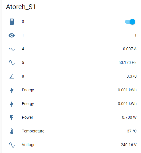

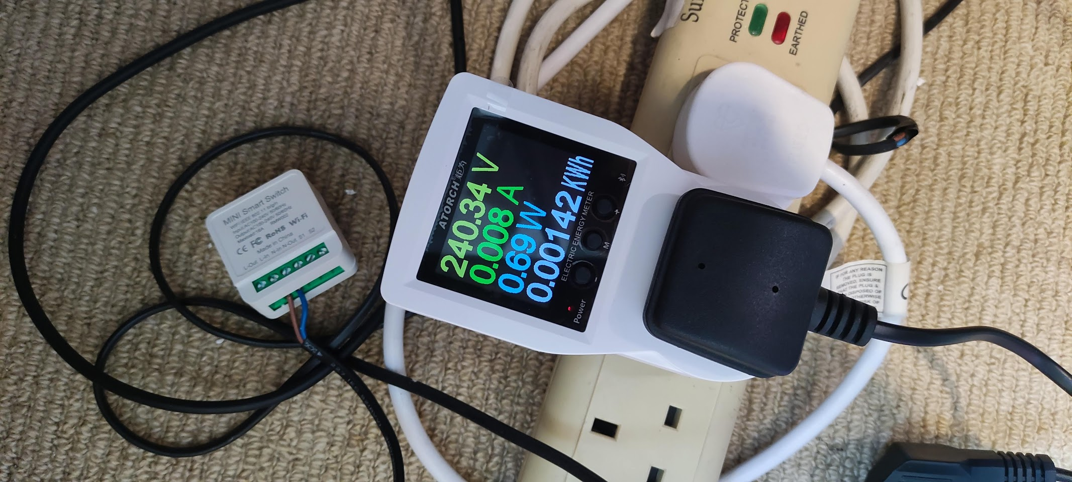

  • Atorch S1 measurements of LN882H standby power
    #72 21007792
    Posts: 5212
    Help: 446
    Rate: 914
    I'm using the Atorch S1 to measure an LN882H RMW002 mini switch, no load attached. Starting with 1 hour of powersave 0 then will do powersave 1. Will post HA history after. Hopefully the value factors are all correct
    Screenshot of measurement data from the Atorch S1 device, showing current, frequency, voltage, and temperature values.
    Atorch S1 meter display showing various electrical measurements.
    Hopefully the S1 is sensitive enough to give meaningful results

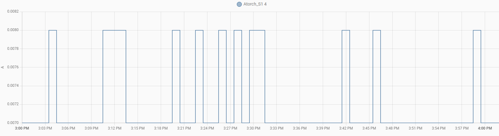

  • MQTT broadcast interval set to 10 seconds
    #74 21007837
    Posts: 5212
    Help: 446
    Rate: 914
    Yes. Set in autoexec and mqtt broadcast to every 10s

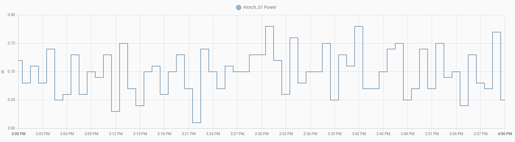

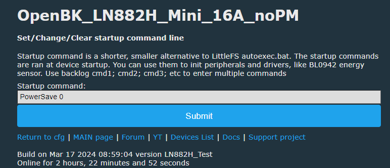

    Added after 1 [hours] 3 [minutes]:
    which measurements are of most interest? just noticed kwh has not come through for the last hour.
    This is powersave 0 for 1 hour
    WATTS
    Line chart showing power changes over time from 3:00 PM to 4:00 PM.
    AMPS
    Graph showing current measurement in amperes, with regular fluctuations on the timeline from 3:00 PM to 4:00 PM.
    Added after 43 [minutes]:
    I of course didn't mean autoexec because there's no LFS in LN. but yes start-up command
    Screenshot of the OpenBK_LN882H_Mini_16A_noPM interface with a startup command field.
    The Atorch has mqtt_broadcastInterval 10

    115200 baud works for LN882H backup
    #77 21013678

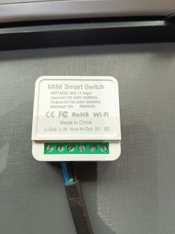

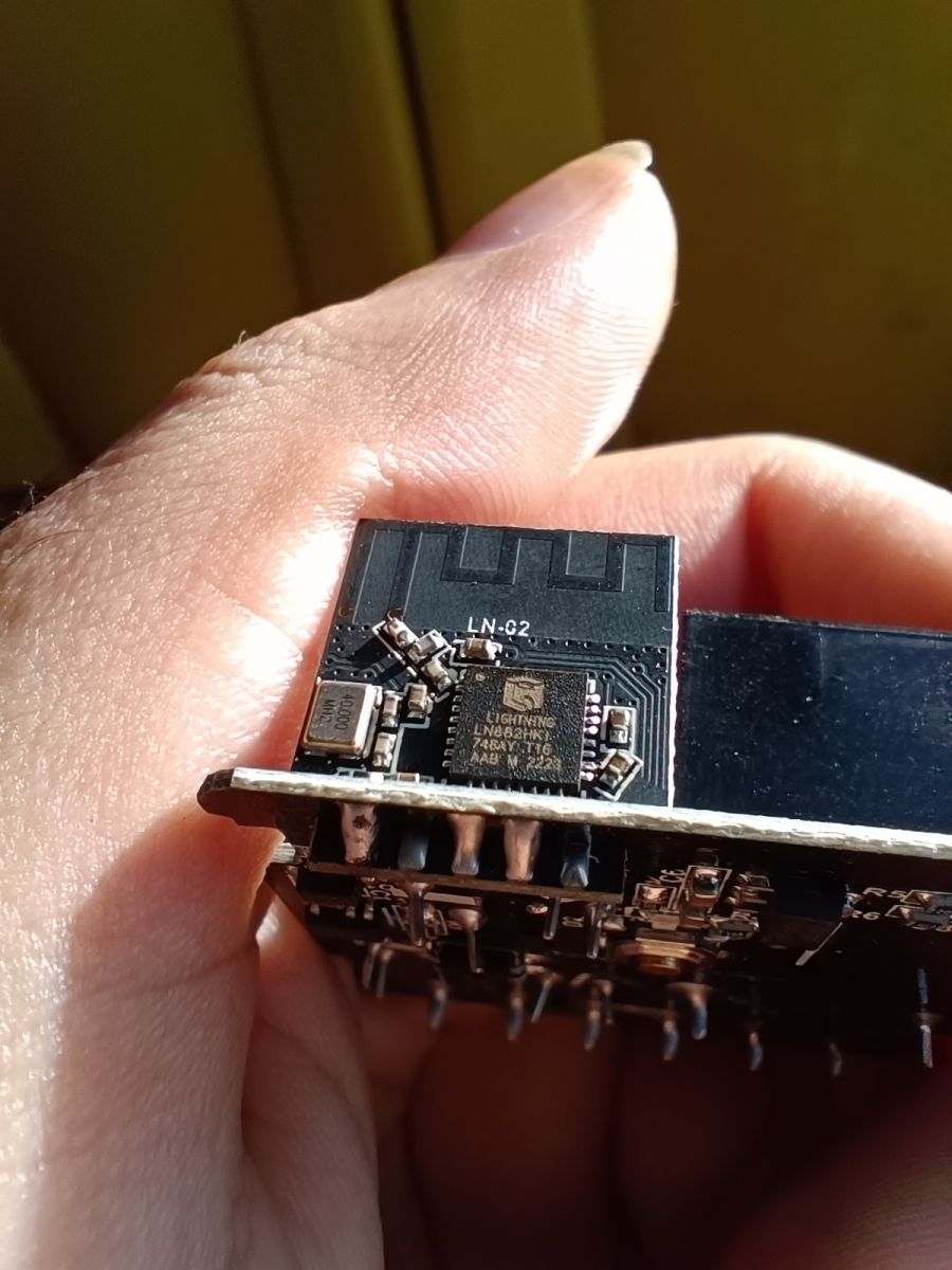

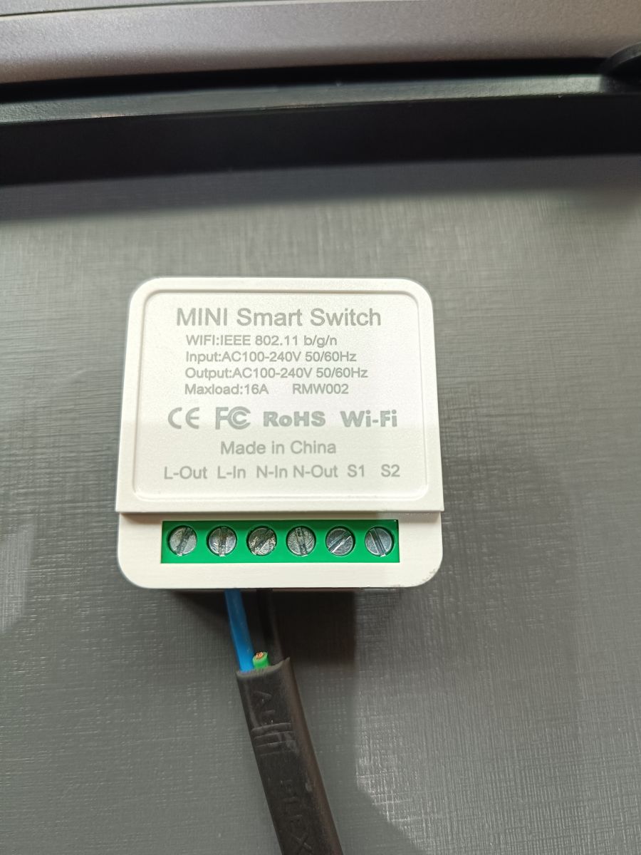

    charleswill2014
    I used the baud rate from the tutorial but it didn't work for recording only to extract the original system, when using the 115200 it worked perfectly, my mini switch rmw002 has the following configuration:
    A0-DINPUT_N 1
    A1-REL 1
    B3-LEN_N 1
    B8-BTN 1
    Close-up of an electronic module with LN-G2 chip held in a hand.
    Photo of a mini smart switch with a visible technical label and connected wires.
    OpenLN882H system interface with status information.
    Screenshot of a Windows command prompt window showing attempts to transfer a file via serial port.
  • #78 21014435

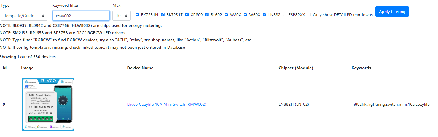

    Posts: 14755
    Rate: 12880
    @charleswill2014 good job and welcome to forum! So, it's the same device as the one already on our list?
    A screenshot showing a device list filtered by keyword rmw002 with one device displayed.

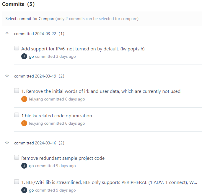

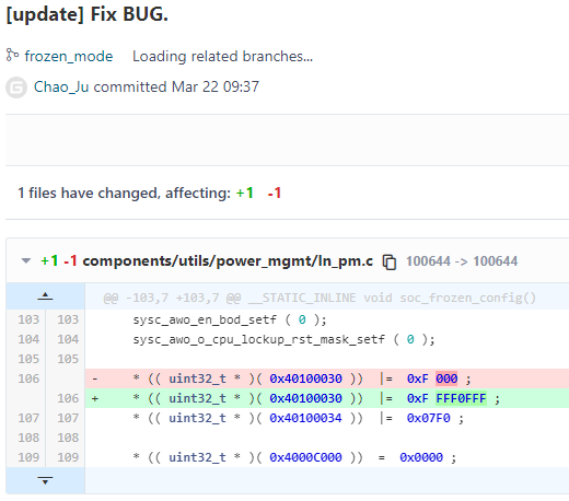

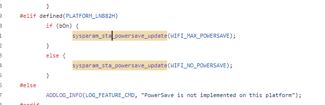

  • Calling wifi_sta_set_powersave for realtime effect
    #85 21016605
    Posts: 14755
    Rate: 12880
    Well, we were testing powersave on BL602 in the past here:
    and effect was noticeable.
    Here is the LN882H call:
    Screenshot of a code snippet related to power-saving update on the LN882H platform.
    Maybe the call is incomplete. It seems to lead only to:
    https://github.com/openshwprojects/OpenLN882H...3526/components/utils/system_parameter.c#L408
    Code: C / C++
    Maybe I should also call:
    Code: C / C++
    to apply the change in realtime, not just to save it in LN KV.
    The source code of wifi_sta_set_powersave is not visible anywhere, but let's give it a try...
    I've added the change here:
    https://github.com/openshwprojects/OpenBK7231...mmit/83d53cf82c58b61a02cdfb7e6661aa37176f7a8c
    Can you @divadiow retry with PowerSave 1 on 1.17.516?

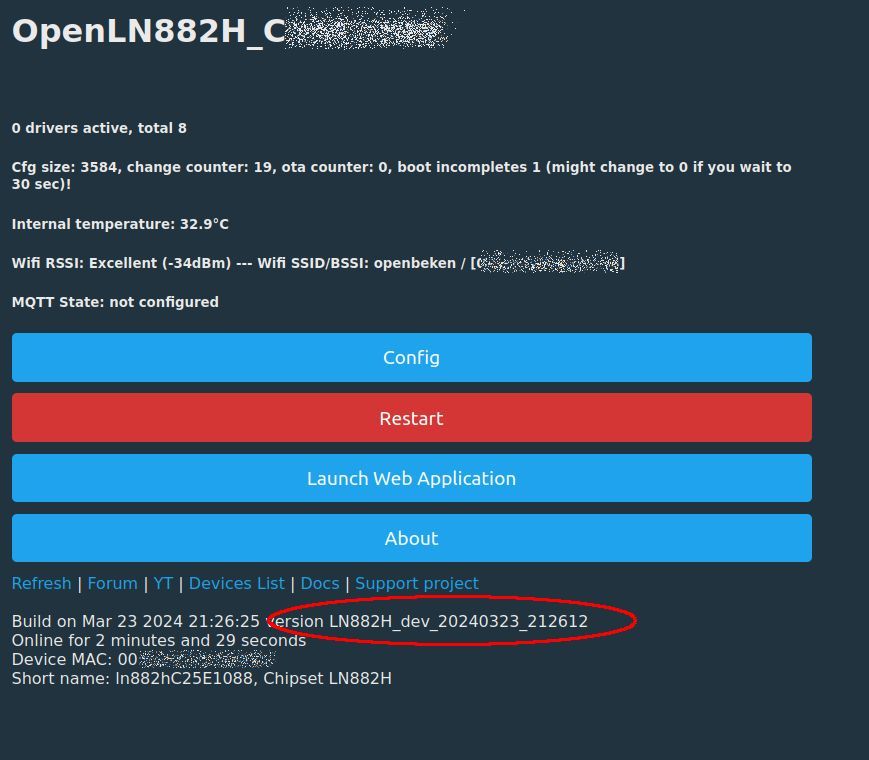

    #86 21016739
    max4elektroda
    Posts: 758
    Help: 49
    Rate: 189
    For me 1.17.516 sadly doesn't seem to change the current - toggling between 88 and 89mA - regardless if PowerSave is 0 or 1 :-(.
    BTW - since the version reports "LN882H_Test":
    I added
    add_definitions( -DUSER_SW_VER="LN882H_$(APP_VERSION)" )
    to
    sdk/OpenLN882H/project/OpenBeken/CMakeLists.txt
    giving me Screenshot of the OpenLN882H interface with diagnostic information, configuration buttons, and software version details.
    Will this include the "official" version on a release build?!?

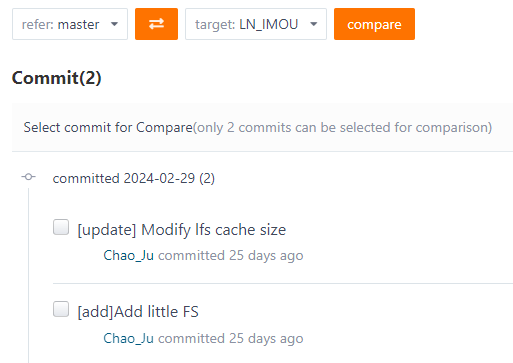

  • Lightning Semi Gitee commits and branch comparisons reviewed
    #88 21018533
    Posts: 5212
    Help: 446
    Rate: 914
    I was just poking around the Lightning Semi Gitee to see if there were any interesting commits to the code on any branches since it was all discovered and used to create LN OBK. I also checked LN_Customer ftp sites logins to see if there was anything new but the sites are down for me at the moment.
    Screenshot showing two computer icons next to email addresses: LN_Customersh.lightningsemi.cn and LN_Customer02sh.lightningsemi.cn.
    any of these commits of interest?
    List of code commits on Gitee for the Lightning Semi project.
    https://gitee.com/lightningsemi/ln882h/compare/master...frozen_mode
    Screenshot showing code changes made on Gitee by Chao_Ju, related to the ln_pm.c file.
    https://gitee.com/lightningsemi/ln882h/commit/6121af45a6a423c53fcc1adbb261b3d7d6bc1985
    Screenshot of a commit list on Gitee for a project named ln882h.
    https://gitee.com/lightningsemi/ln882h/compare/master...custom-imou
    Screenshot showing the Gitee comparison interface for the Lightning Semi repository.
    https://gitee.com/lightningsemi/ln882h/compare/master...LN_IMOU
    there are more
  • #89 21018569
    max4elektroda
    Posts: 758
    Help: 49
    Rate: 189
    That really looks promising: Fixes in power save, implementation of littlefs, ...
  • Proposed sleep mode API for PowerSave call
    #90 21018608
    Posts: 14755
    Rate: 12880
    Maybe we just need another call. Let's consider the app base:
    https://github.com/openshwprojects/OpenLN882H/blob/master/project/OpenBeken/usr_app.c
    This call looks interesting:
    C code snippet with a function setting sleep mode.
    This header seems related:
    https://github.com/openshwprojects/OpenLN882H...aster/components/utils/power_mgmt/ln_pm.h#L52
    Maybe we should try using:
    Code: C / C++
    along with:
    Code: C / C++
    I can try to plug it into PowerSave call in separate PR in a hour or two.
