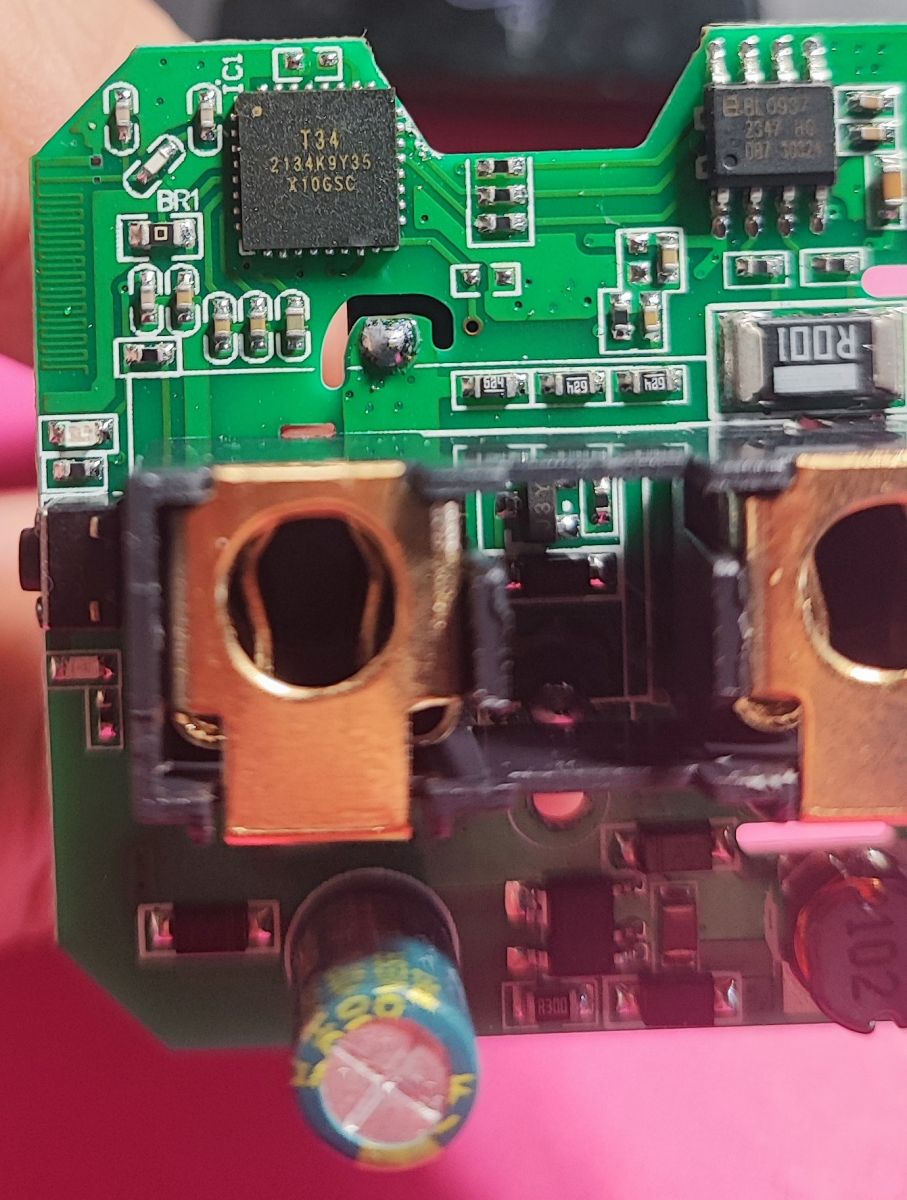

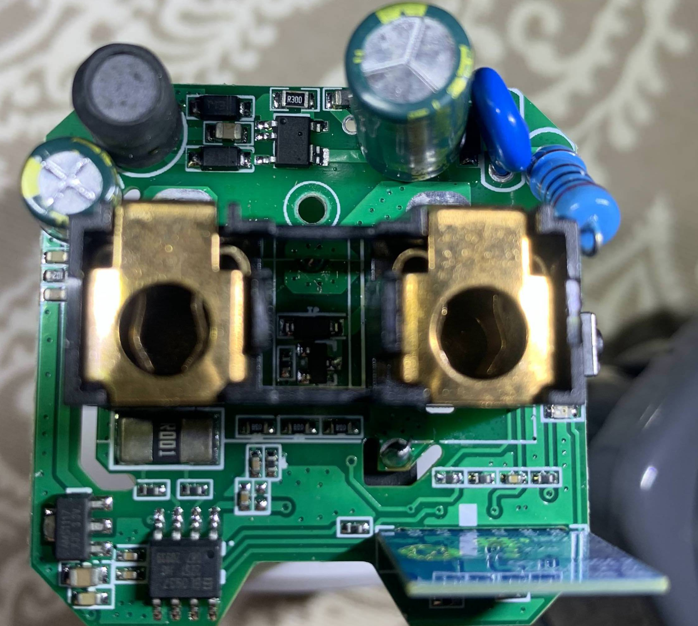

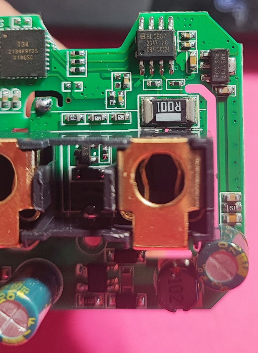

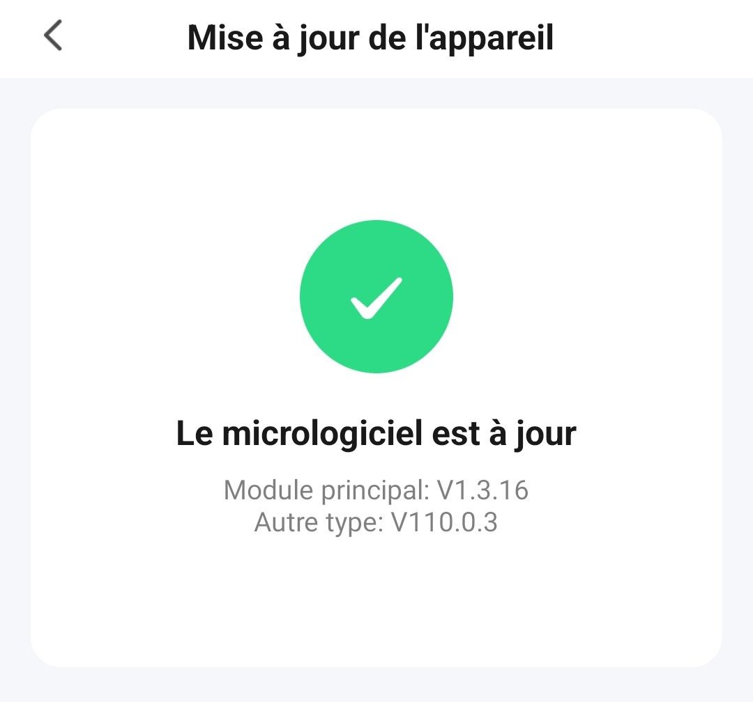

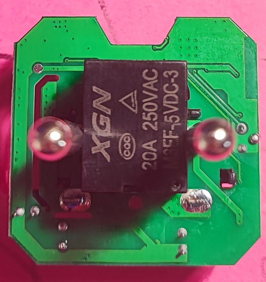

    Good morning,
    I have a QNCX brand smart plug (https://fr.aliexpress.com/item/1005005374840269.html?spm=a2g0o.order_list.order_list_main.24.29d95e5beB7gQG&gatewayAdapt=glo2fra) with energy measurement but I can't find it model in the database it looks a lot but doesn't have a map like the other models if someone can help me install openbeken that would be great
    I am attaching all the images and photos
    Thank you and see you soon.

    I think I recognize this device. It's a bit harder to flash than usual. You can find more info about that in the following thread:
    [T34/BL0937] Teardown Generic Wifi Smart Plug with Energy Measurement
    As you can see, no programming header is available there. You need to solder to QFN pins:
    Pinout diagram of T34 and BL0937 smart plug with a PCB view[/quote]
    You can also search more information for T34:
    https://www.elektroda.com/rtvforum/find.php?q=T34
    Alternatively, you can use the method with desoldering whole T34 from the board, which can be found here:
    [BK7231N / T34 ] Teardown Tuya Generic Wifi Wall Light Switch 3 Gang

    thank you I look I could flash I have to find the right configuration of the pins now
