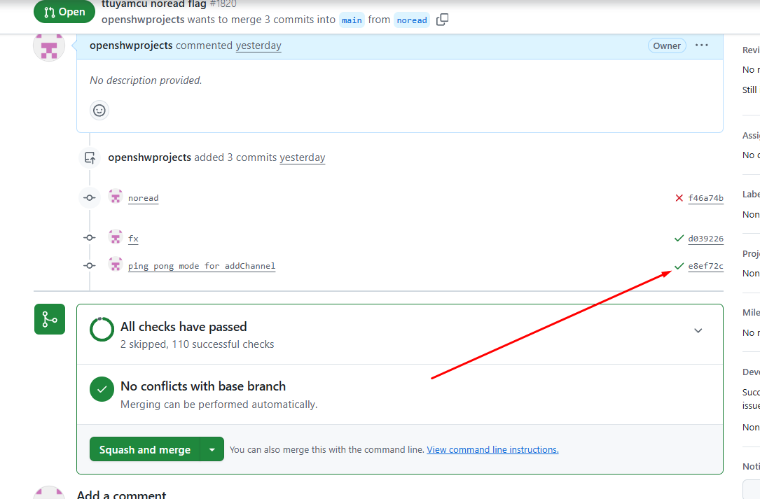

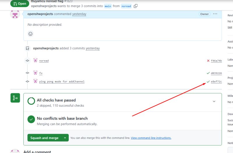

    Do you know C?
    I changed "bDPCache" argument to "flags", 1 means dpCache, 2 means "do not read"
    linkTuyaMCUOutputToChannel [dpId] [varType] [channelID] [obkFlags] [mult] [inv] [delta]
    If you use obkFlags value 2 for your mapping, it will ignore read. Can you check? Is it even acceptable for us to ignore that read? I am not sure, could it break other things?
    get binary here
    https://github.com/openshwprojects/OpenBK7231T_App/pull/1820

    Build has finished, do you know how to download binary from PR?
    Here is explanation how to download it: https://www.elektroda.com/rtvforum/topic4033833.html
  • #36 21708021
    sp4rk1e
    Posts: 37
    sorry, never dealt with this. Some hourglasses are still rotating in github. Really ready? I'll try to find out
    Added after 30 [minutes]:
    looking at the huge masses of 'Artifacts' of 'ttuyamcu noread flag #7229' how do I know which one is suitable for OTA? I'm used to look for .rbl suffix but none of them got that :-(
  • #37 21708313
    Posts: 14771
    Rate: 12914
    There is 93MB file which contains all binaries. Alternatively, you can download OpenBK7231T_App_1820_merge_fb5f7b416567_OpenBK7231N, which is pure OpenBK7231N, this should match CBU from the topic.

    PR has reused bDPCache argument for flags, and you set it to 2.
    https://github.com/openshwprojects/OpenBK7231T_App/pull/1820/files
    On old Release, 2 is intepreted as "true" and value is not sent at all because OBK thinks it's for dp cache request.
    Ok, I added "switch direction" hack for you.
    https://github.com/openshwprojects/OpenBK7231...mits/9bfeae5706a35498f5c7b7ed4b00c5acdbe4a570
    It is fairly simple - if you use mode 3 instead of 2, then max/min/delta values are ignored, and just direction is inverted. I think you know how to use it, right?
    thank you.
    with 'OpenBK7231N_1820_merge_db247b9d377d.rbl' it works again.
