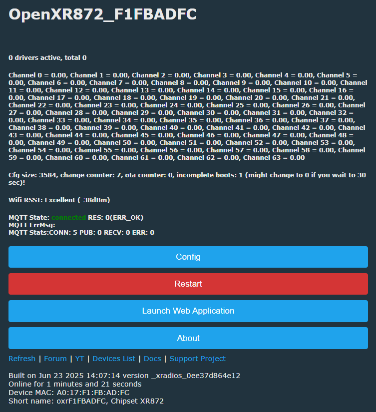

    XF16 _xradios_0ee37d864e12
    boot to AP and client connect to AP log:
    save config OK. wifi joined. startup command, MQTT connected but HA discovery not resulting in any new devices being added. Some of this in logs:
    Exploring A9 Minicam Variation: XF16 PB380EA6341 MCU, T25S80 SPI Flash, XR872, Skylark SDK

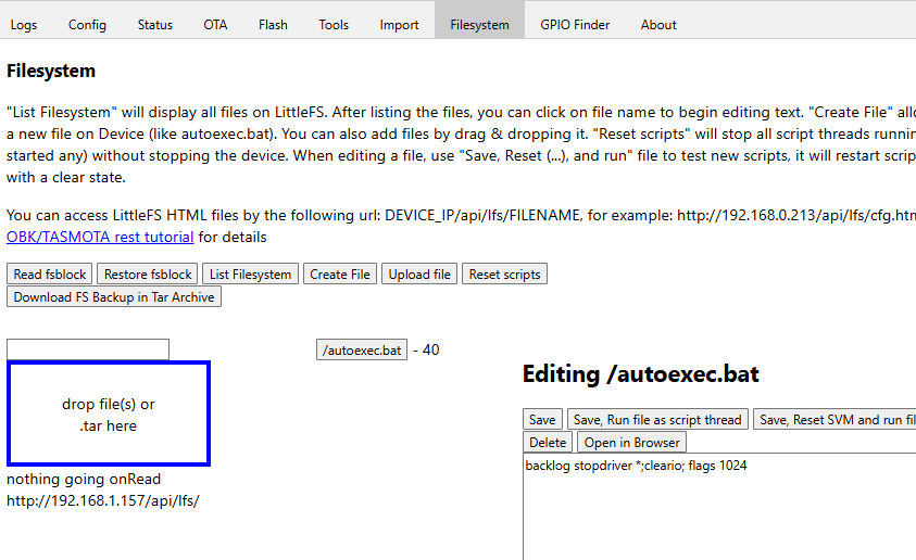

    LFS OK and persists through reboot. it's v quick to reboot and join wifi.

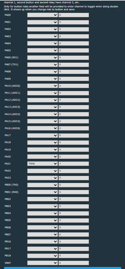

    PWM on PA21 to control blue LED on this cam PCB works. dimmer works.
    full pin list!!! 😁❤❤❤
    oh and this is with 1mb. console upgrade interrupt works still in PhoenixMC

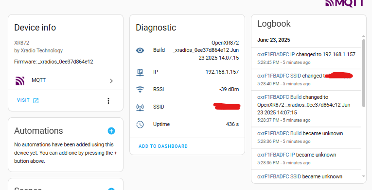

    well that took an age and many reboots/discoveries. I'll restart my HA, but it's not usually sluggish.

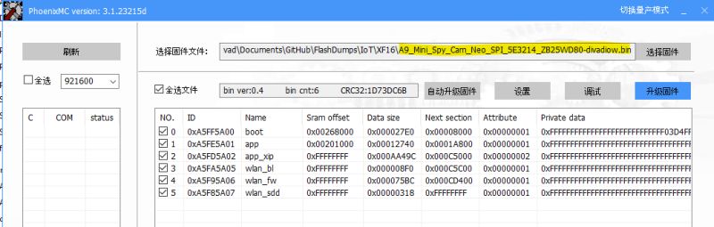

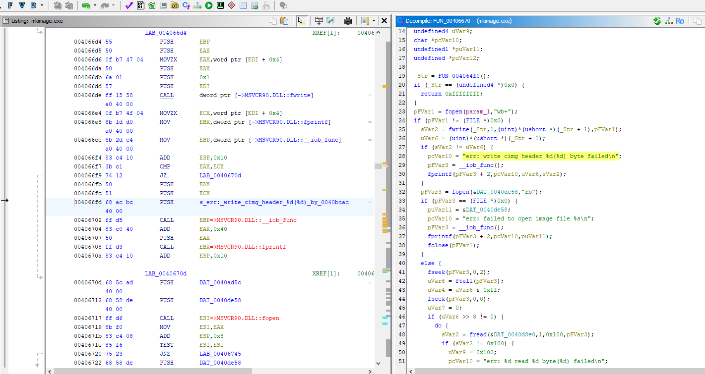

  • #221 21587644
    johndoudou
    Image is created that way:
    E:projectIOTtoolsxr-mkimageRelease>mkimage.exe
    so you would want mkimage source
    If that tool is responsible to assemble the different partitions into a bin file starting with AWIH, yes we need to reverse it :-)
  • #222 21587646

    You can load it in Ghidra to see how files are processed:
    Just one question - why? What is your goal here?

  • #224 21588441
    johndoudou
    >>21587646
    Thanks, I want to start reverse engineering the content of the stock firmware to find all accepted "commands" by the camera (on/off, record video to SD card, AP/client mode etc.)
    I saw that there are different "apps" inside a firmware: boot, app, app_xip, wlan_bl, wlan_fw, wlan_sdd
    https://obrazki.elektroda.pl/7685058500_1744977818_bigthumb.jpg
    So we need first to "slice" the stock firmware bin to then start reverse-engineer interesting apps.

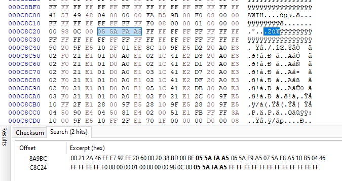

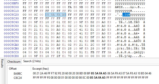

    also. if you search a dump for each of those hex values in little-endian format

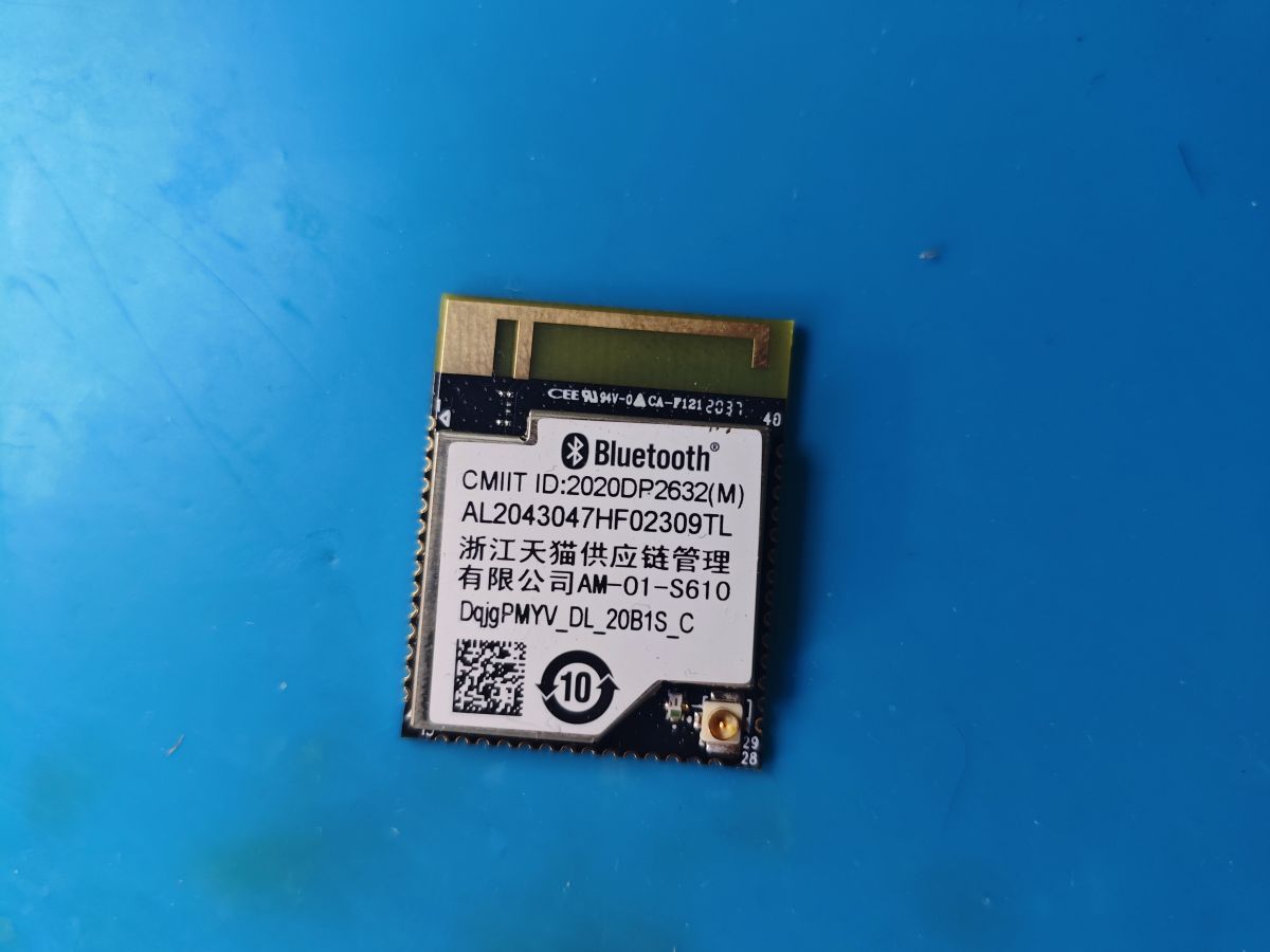

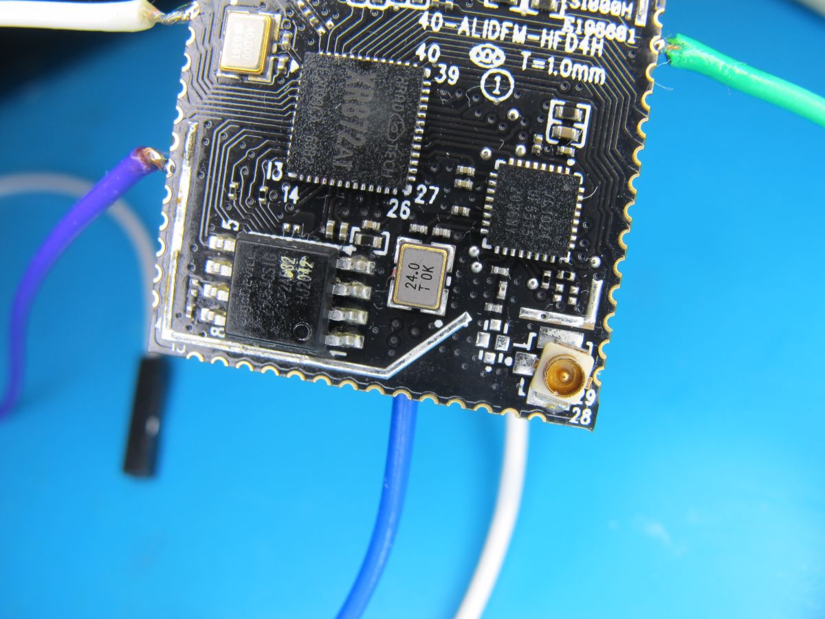

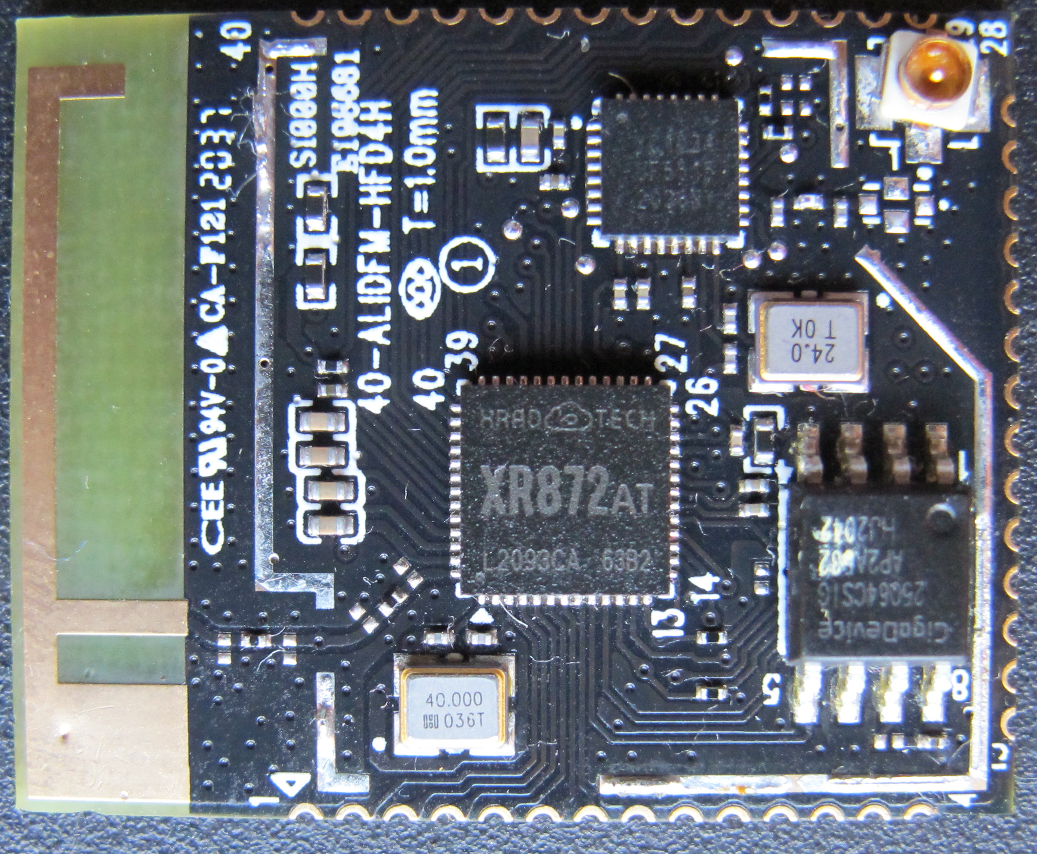

    Added after 10 [hours] 36 [minutes]:

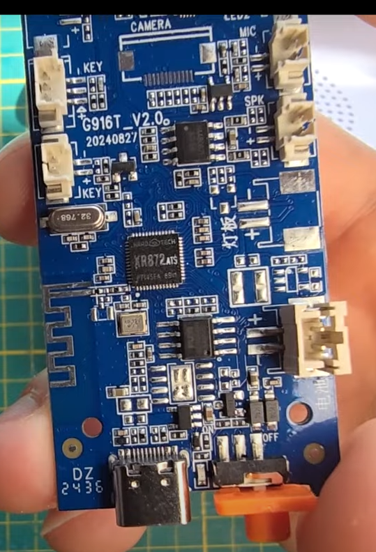

    AM-01-S610 module - 8mb GigaDevice GD25Q64CSIG. Flash shipped blank.
    OpenXR872 first boot.

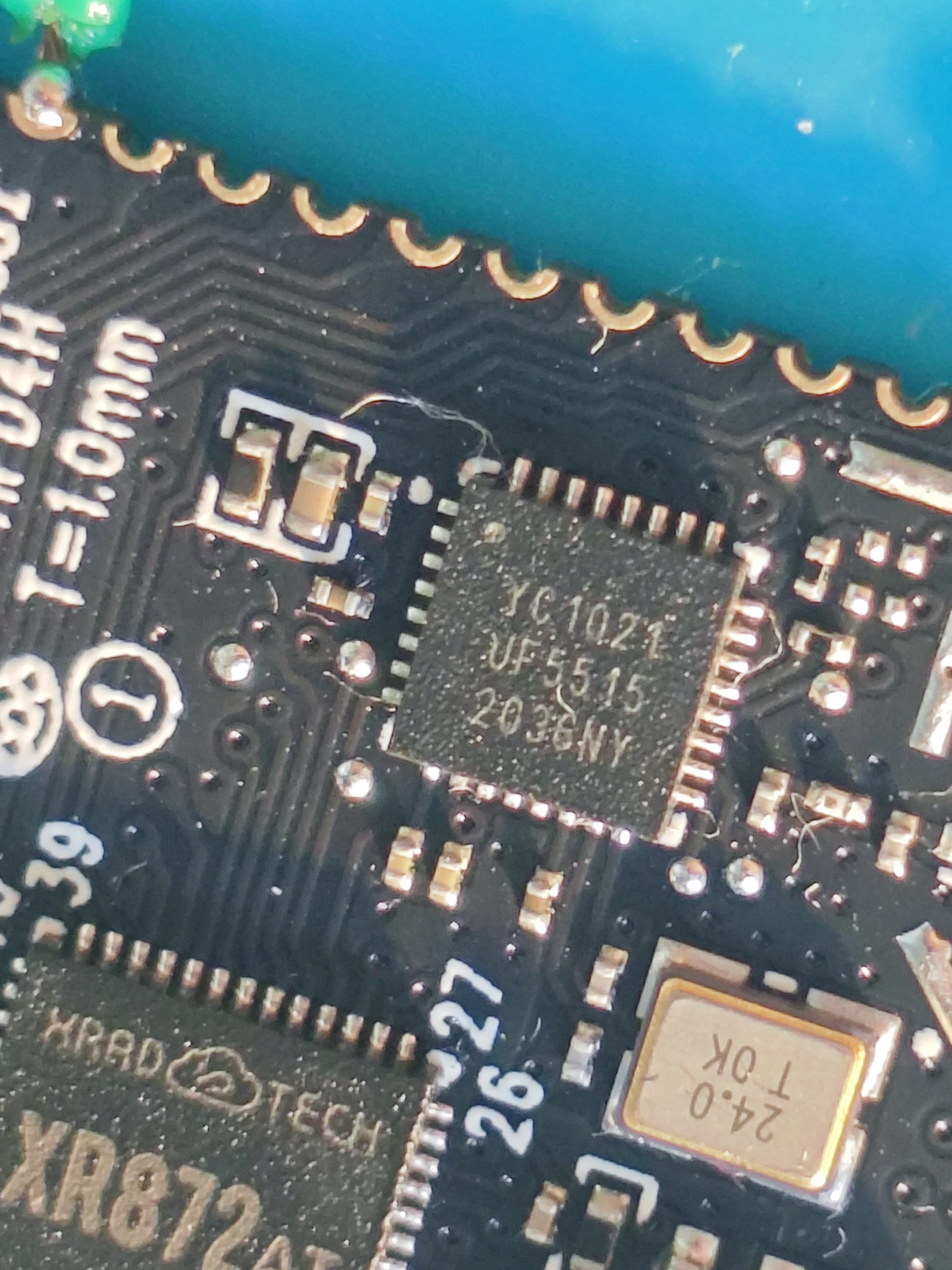

    not sure what this other little 32-pin chip is yet
    Added after 11 [hours] 16 [minutes]:

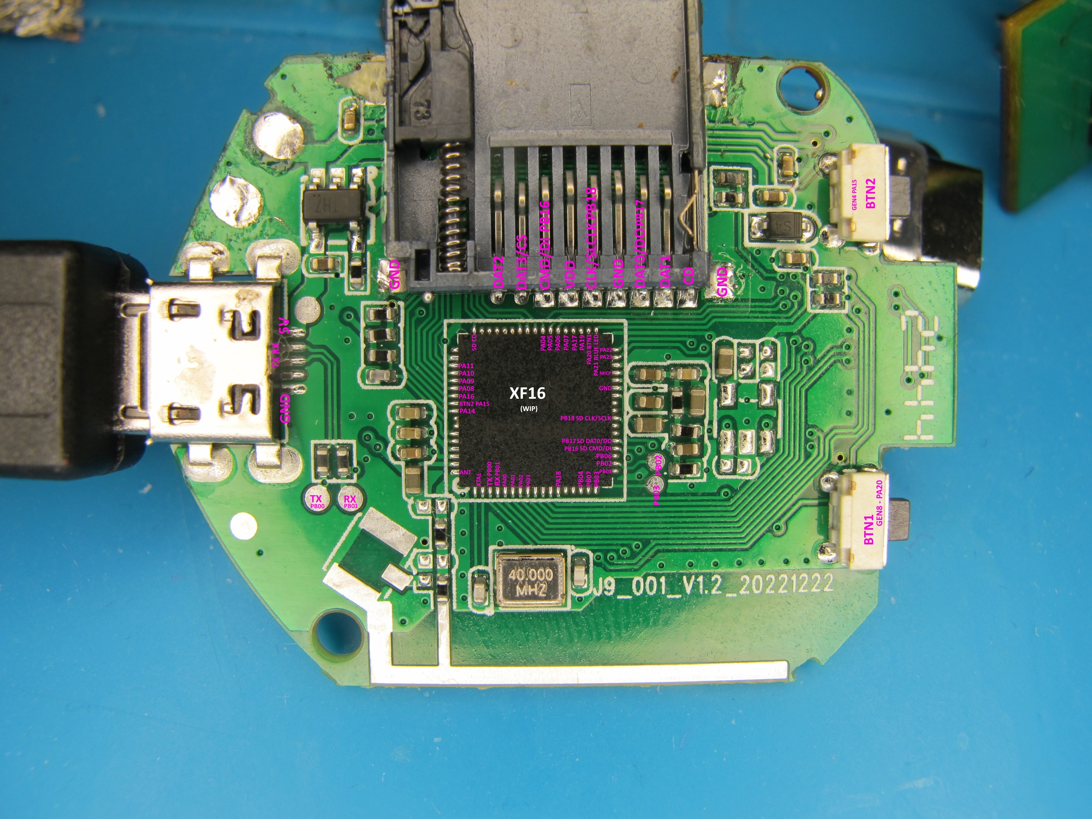

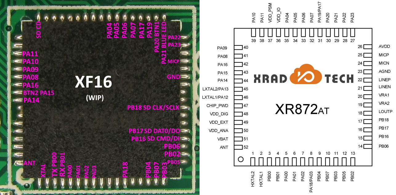

    >>21575844
    slowly. GPIOs are obviously easier than all the non-GPIO. Anyone see any pins that are obviously/probably x pin because of what it's connected to that I haven't marked yet?
    Also interesting to see how similar it is to the XR872AT

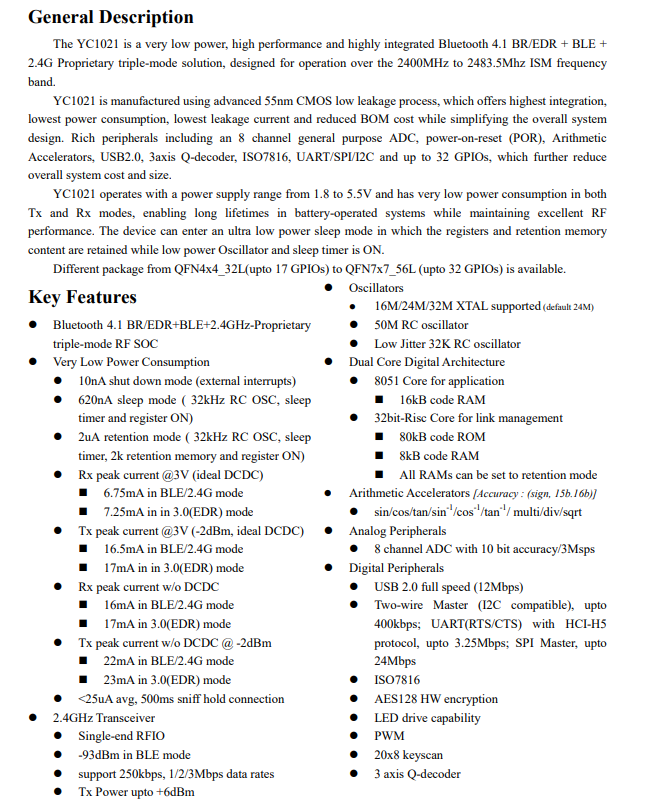

    YC1021 YiChip bluetooth
  • #233 21592614
    Posts: 14580
    Help: 654
    Rate: 12604
    How is it connected to XR? Here's datasheet first page

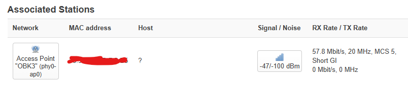

    WPA3 is OK on XF16

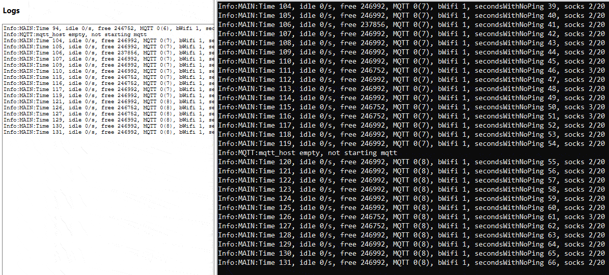

    Table showing Wi-Fi connection details to OBK3 network with -47 dBm signal strength
  • #235 21636062
    Posts: 5026
    Help: 438
    Rate: 891
    not necessarily an issue I guess, but on XF16 the web app log is pretty slow and misses a lot compared to UART log
    gif
    Comparison of web app logs vs. UART logs showing differences in detail and completeness
