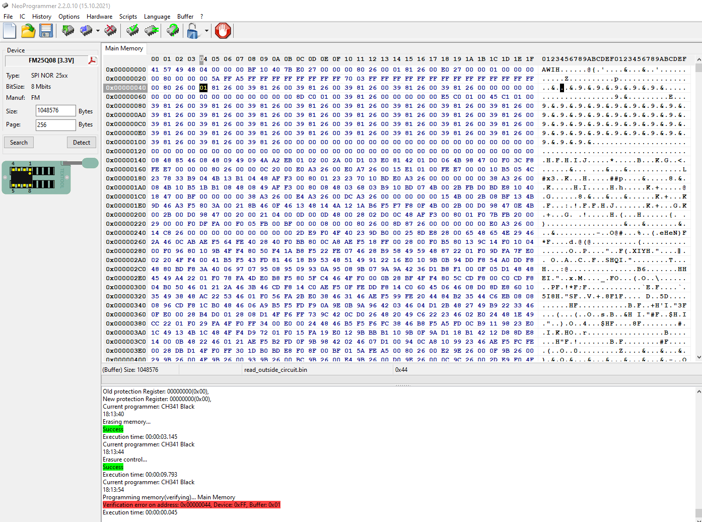

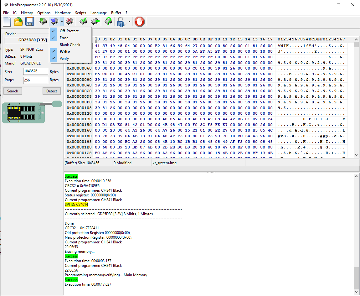

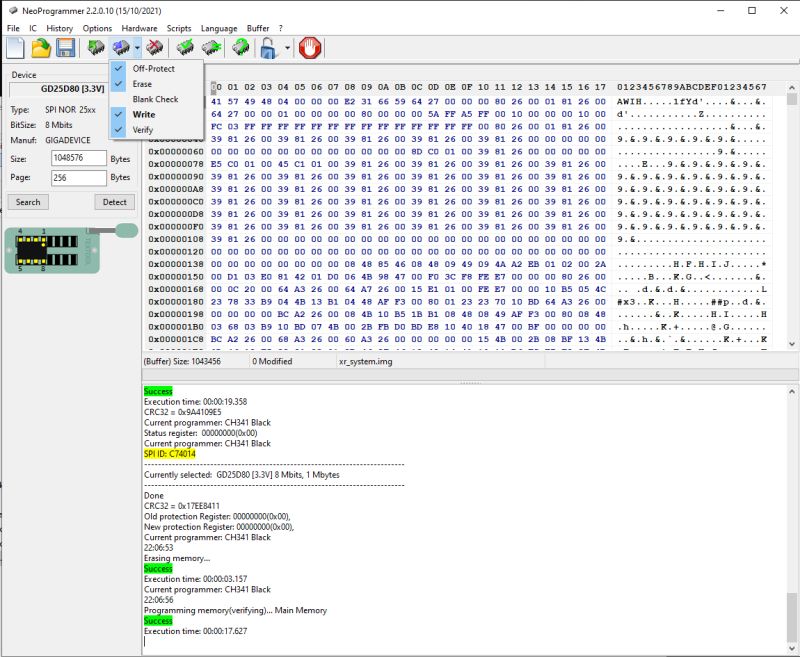

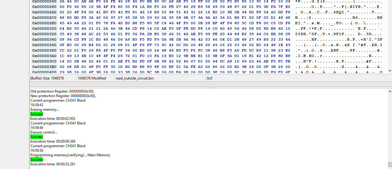

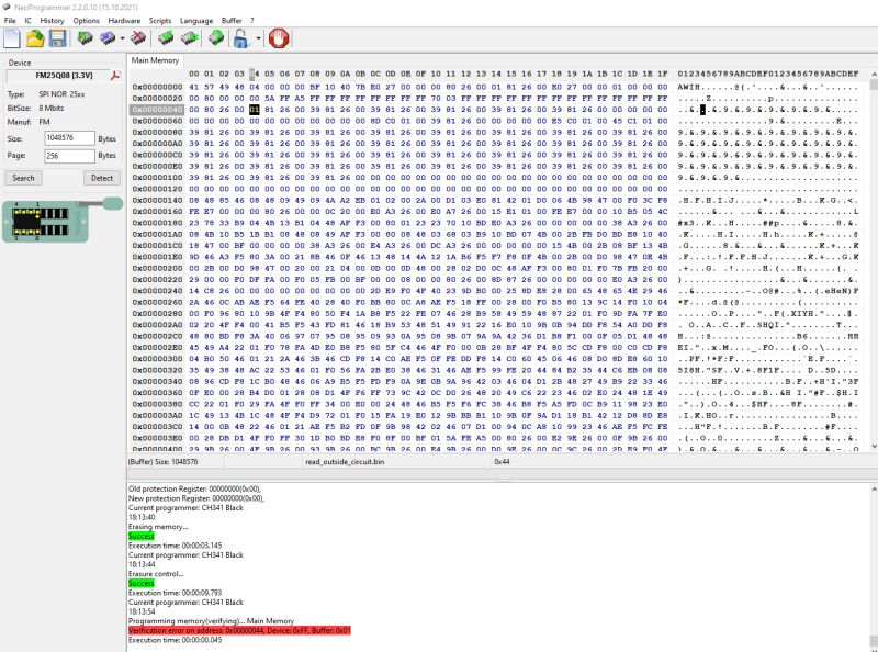

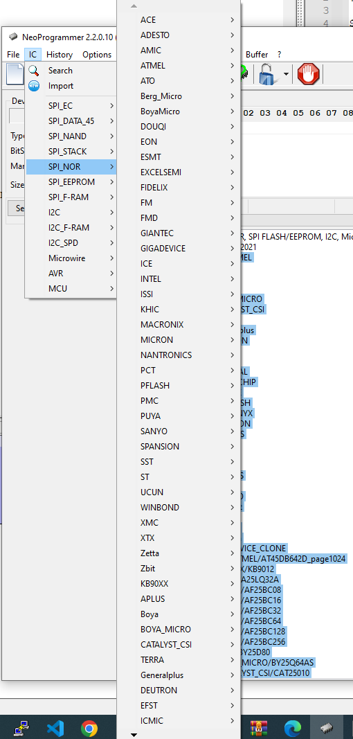

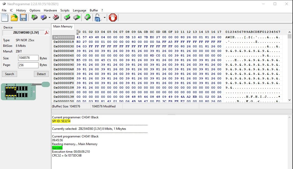

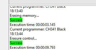

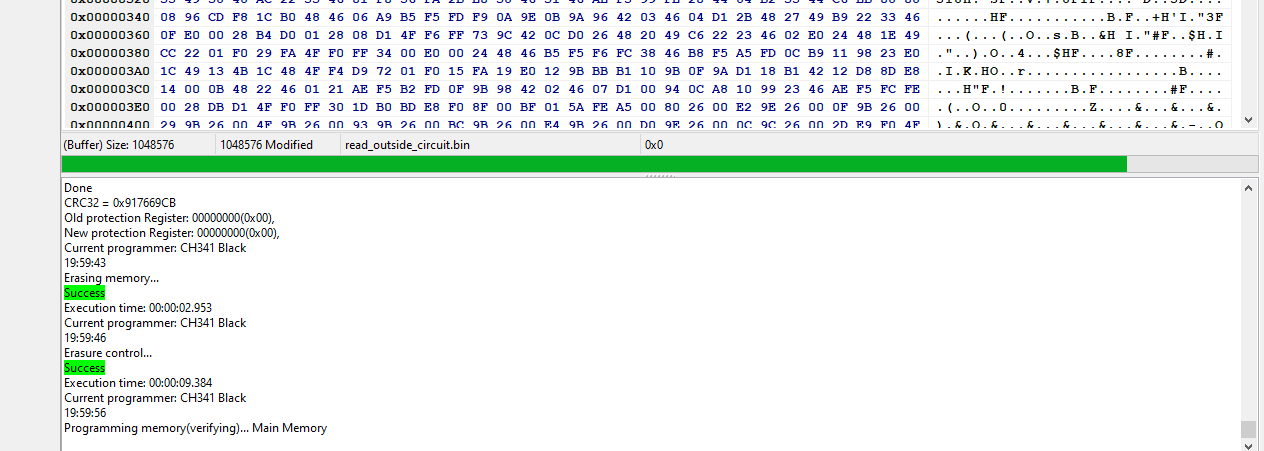

    NOTE: My chip is directly on CH341 daughter board, no clip used. I desoldered it.
    SREG in Neo Programmer:
    Old protection Register: 00000000(0x00),
    New protection Register: 00000000(0x00),
    Current programmer: CH341 Black
    Status register:  00000000(0x00)

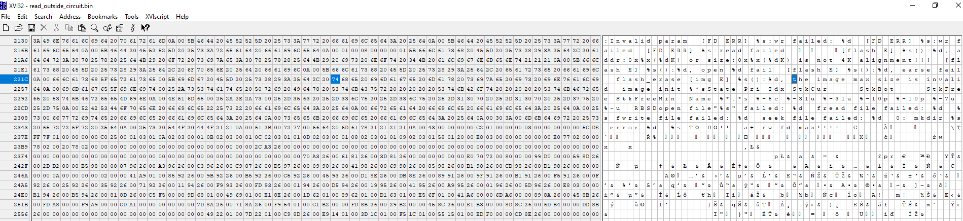

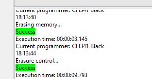

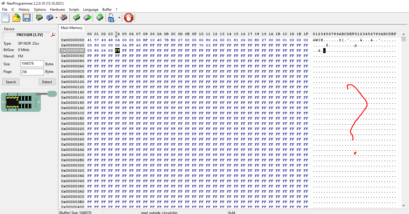

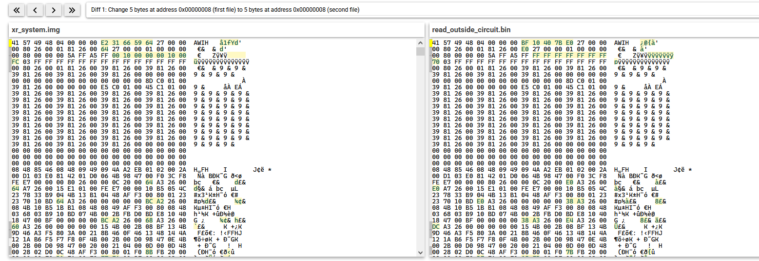

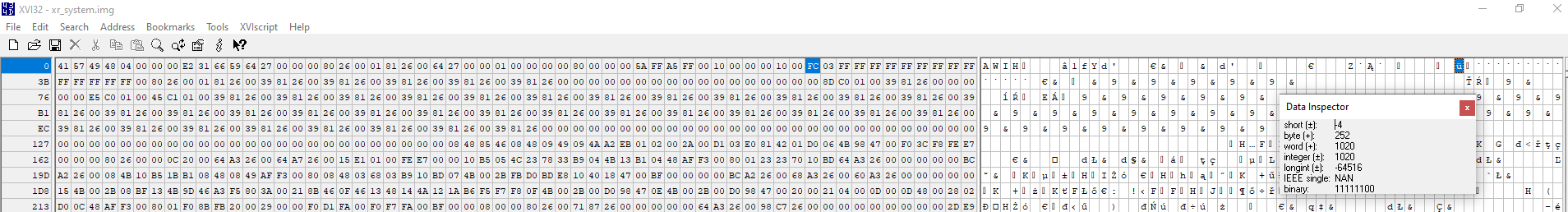

    When I try to flash back what I read outside circuit (before first write attempt):
    NeoProgrammer software window with hex view of FM25Q08 Flash memory and programming status messages, including a verification error.
    Then, when I do reaD:
    Screenshot of the NeoProgrammer software displaying flash memory content in hexadecimal, with a large red question mark drawn on the right side.
    So it's a write problem.
    A program window fragment showing status messages with Success highlighted in green background.
    Do you get the same? First 0x43 bytes written or so?

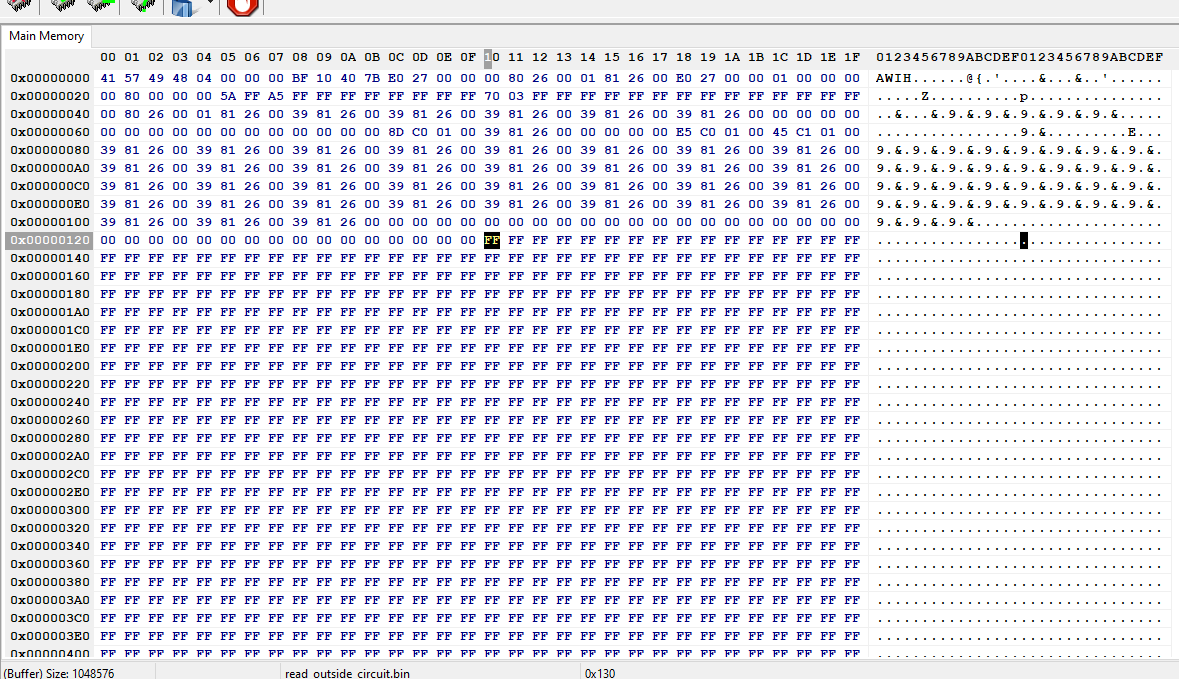

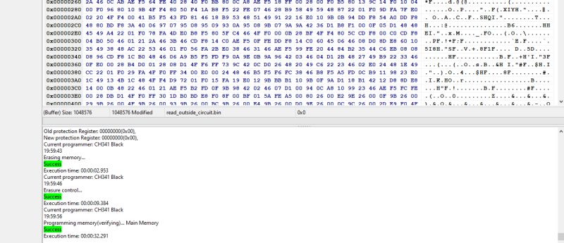

    Added after 46 [seconds]:
    Second attempt - it wrote up to 0x130 or so:
    Screenshot showing a hexadecimal editor window with the contents of a binary file.

    Yes. Same behaviour so far. I've not yet had time to desolder chip to attack it off the camera PCB. Asprogrammer appears to have better SREG reader..
    Added after 5 [minutes]:
    Actually, my read back hasn't been obvious that it wrote some bytes. Maybe you're getting a clearer picture with chip on breakout board. I'll do that soon

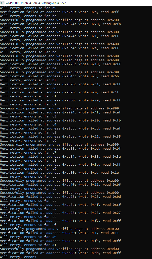

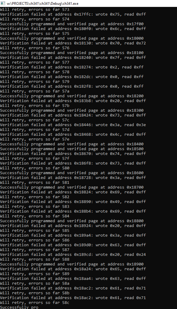

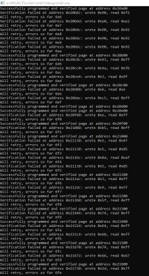

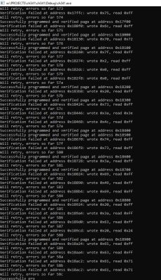

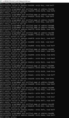

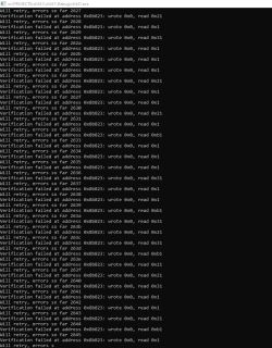

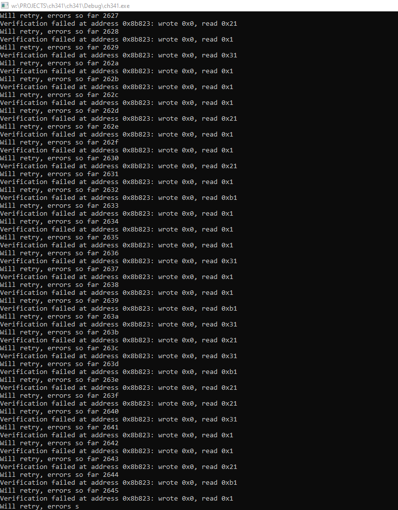

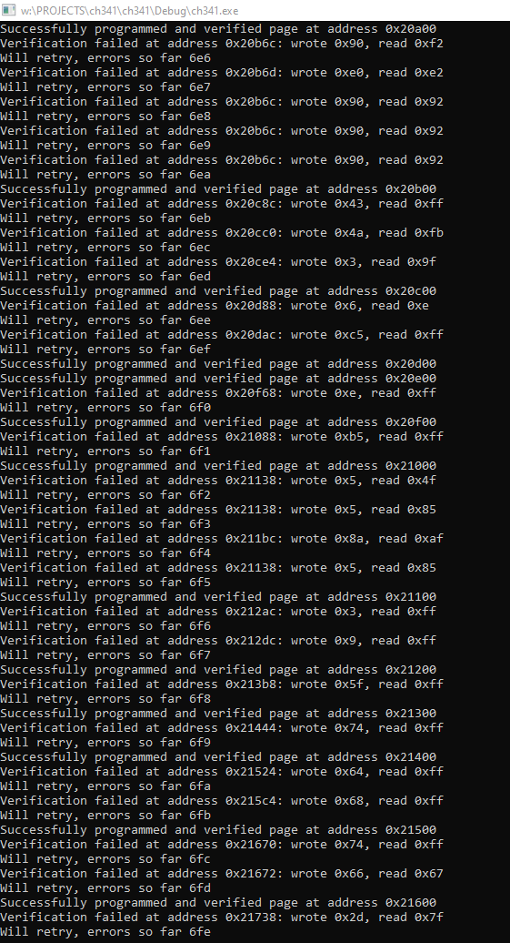

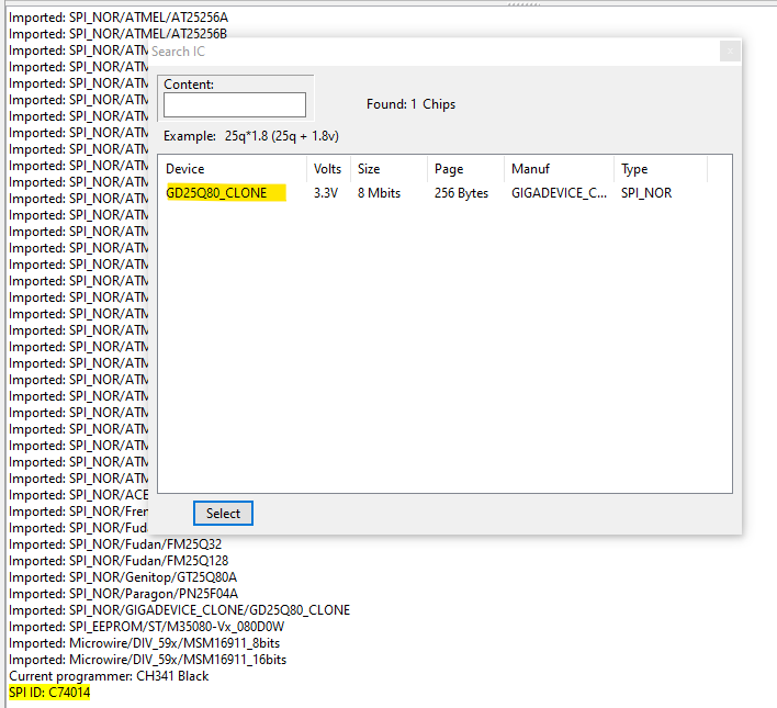

    I'm trying with custom C code to write pages:
    Console window with many verification error messages during flash programming by ch341.exe application.
    Console window with verification error messages when programming flash memory using CH341.
    Console window with verification error messages during flash memory programming via ch341.
    I have no idea, why so many errors? At random places? It's literally flash chip sitting on CH341 daughter board.
    Ok it stuck totally now:
    Console showing write and read verification errors while handling flash memory with CH341.
    Added after 7 [minutes]:
    Wait, I think I may be onto something:
    Screenshot of flash memory software showing a hex buffer and programming logs for CH341 Black programmer.
    Screenshot of a flash memory tool showing hex data, CH341 Black programmer status, and success messages for memory operations.
    Haha, I didn't expect it to actually work, but it works.

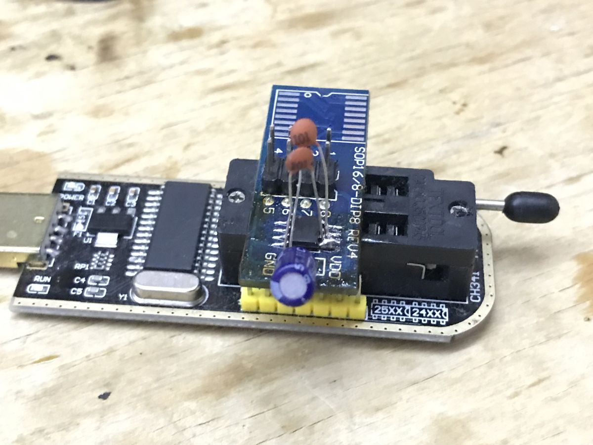

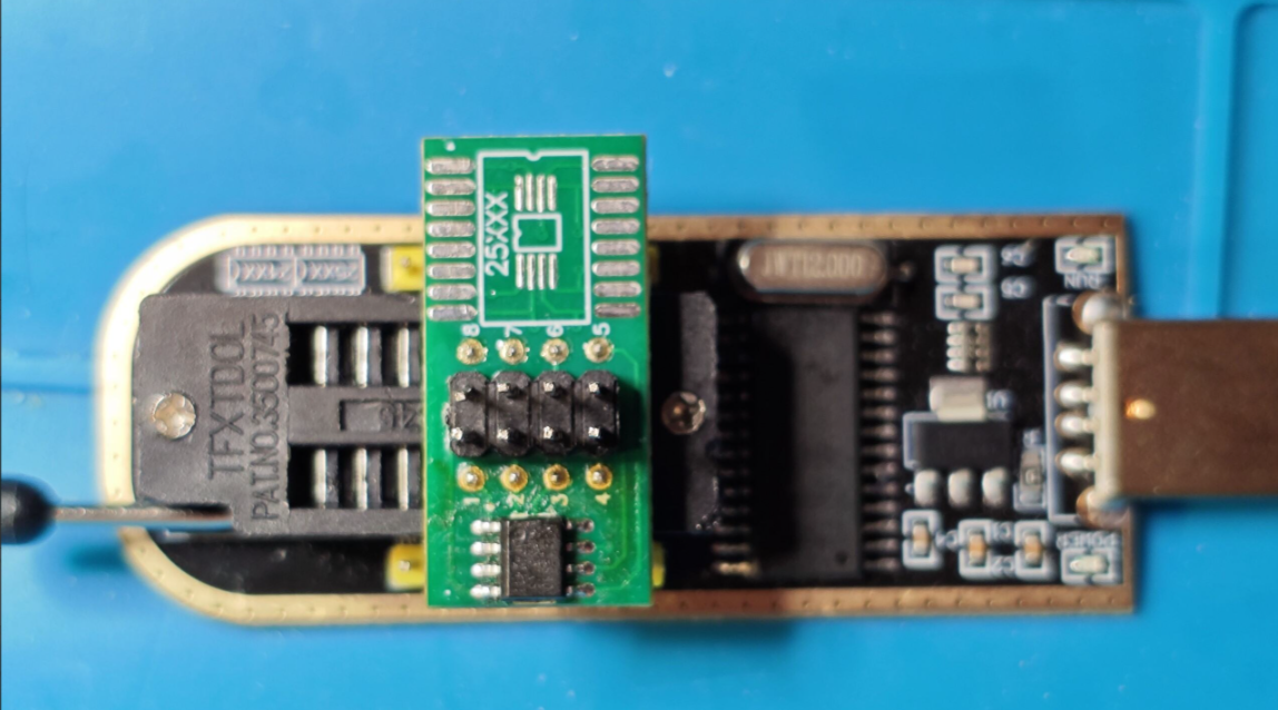

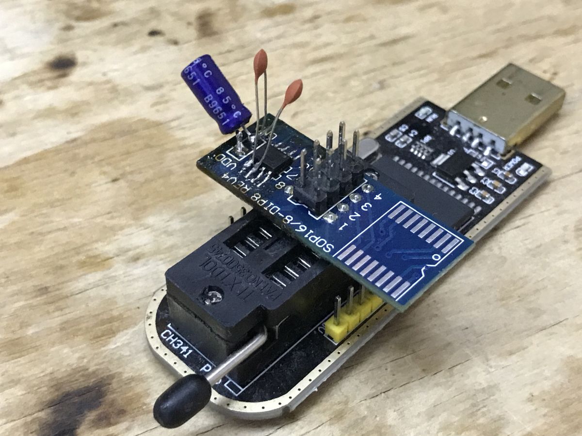

    I'm still testing because I would not like to fool myself, and it may be a fluke, but here is what I did directly before getting correct write/verify:
    USB programmer for integrated circuits with adapter and electronic components on a wooden surface.
    USB programmer for EEPROM with a chip mounted on an adapter.
    Added after 8 [minutes]:
    It seems I managed to write back original flash:

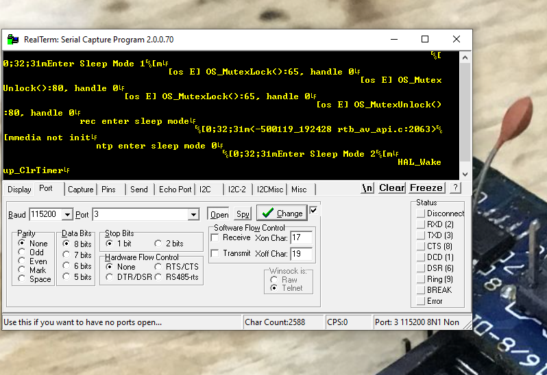

    I'm afraid I get no UART output on custom firmware.

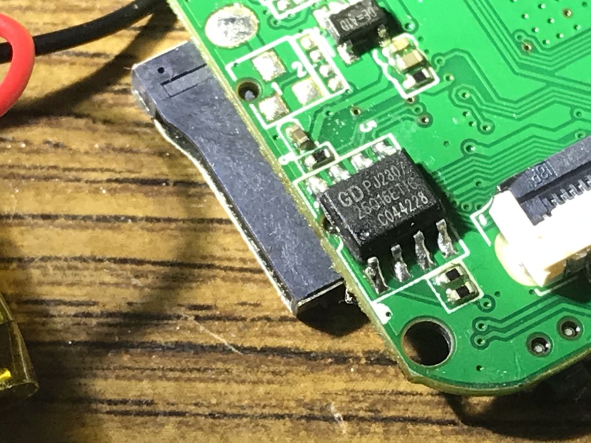

    On a bright side, I've flashed original dump to 2MB flash chip, and look:
    Close-up of a PCB with electronic components, including a chip labeled GDPJ280 and a microSD slot.

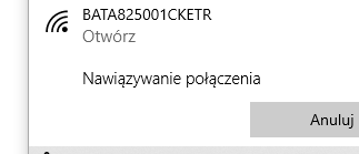

    Screen fragment showing Connecting to Wi-Fi network BATA825001CKETR in Windows.
    Camera works on 2MB flash chip with YSXLite App:

  • #38 21522662
    Posts: 5052
    Help: 438
    Rate: 893
    very interesting. good work.
    I've soldered flash to breakout and I have not needed to add any capacitors. .img flashed and verified OK
    Screenshot of NeoProgrammer software showing hex memory data and programming info for the GD25D80 chip.
    USB programmer with TFXTDOL socket and adapter for SPI 25XXX memory on a blue background.

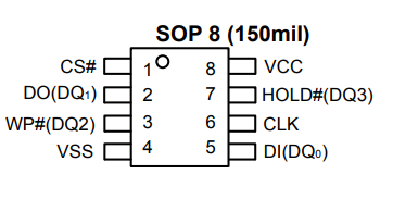

  • #43 21522674
    Posts: 14611
    Help: 654
    Rate: 12624
    Which resistor fell off?
    On my side, I've already managed to connect Flash clip in reverse, but CH341 survived.
  • #44 21522679
    Posts: 5052
    Help: 438
    Rate: 893
    this one
    Close-up of a circuit board with a red circle marking a missing surface-mount electronic component.
    #45 21522680
    Posts: 14611
    Help: 654
    Rate: 12624
    I see, a pull up resistor for hold pin.
    Pinout diagram of SOP 8 (150mil) package with labeled pins.

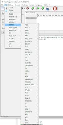

  • #46 21522829
    Posts: 5052
    Help: 438
    Rate: 893

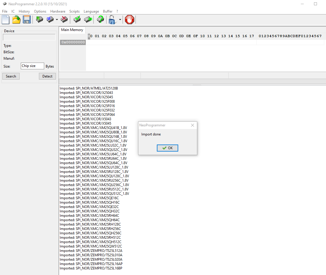

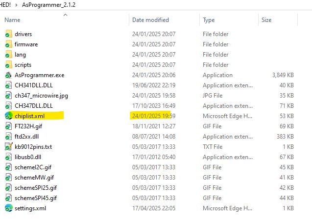

    btw here's an updated import.xml for Neo based on the latest Asprogrammer chiplist.xml with an added entry for these what looks like GigaDevice clones in the A9.
    GigaDevice = C8
    A9 flash = C7
    adds an additional 522 chips
    Screenshot of NeoProgrammer software with an Import done message and a list of imported SPI NOR/XMC memory chips.
    NOR list before/after
    Screenshot of NeoProgrammer software with the SPI NOR memory type selection menu open. Screenshot of NeoProgrammer showing the expanded menu for selecting SPI NOR memory type with a list of manufacturers.
    and now our A9 detection
    A flash memory programming software window with the GD25Q80_CLONE chip selected.
    • import.xml.zip (8.18 KB) You must be logged in to download this attachment.

    Is it from somewhere or did you add it yourself?
  • #48 21522871
    Posts: 5052
    Help: 438
    Rate: 893
    ChatGPT conversion from chiplist.xml
    Screenshot of the AsProgrammer_2.1.2 folder with the file chiplist.xml highlighted.
    Added after 4 [minutes]:
    Not from anywhere. I got ChatGPT to do it then I added Gigadevice_CLONE entry

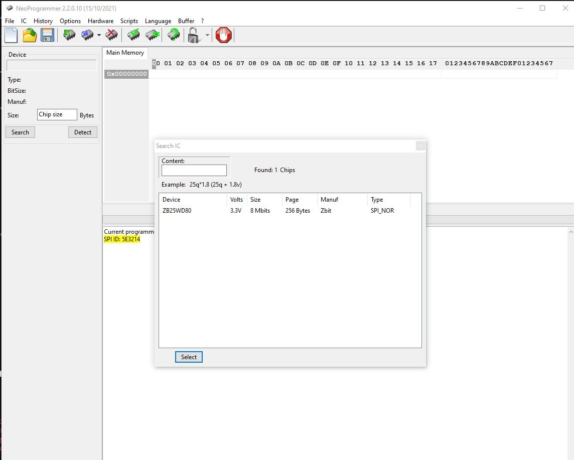

    moving on. Here's boot log from my 2nd XF16 cam, which I'd actually never looked after at after delivery apart from to check MCU it came with.
    and straight to unsoldering to breakout board and Neo detection - not C74014 this time although flash chip is still labelled T25S80!
    5E3214 / ZB25WD80 - dumped attached. (Detection is this with original Neo chip db and after import of additions from above chat)
    NeoProgrammer window showing a search for memory chip ZB25WD80 with details on type, size, and voltage. Screenshot of the NeoProgrammer application showing memory readout from ZB25WD80 flash chip via CH341 Black programmer.
    • neo_spi_5E3214_ZB25WD80.bin (1 MB) You must be logged in to download this attachment.

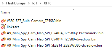

    new XF16 flashdumps folder in PR
    A folder window showing binary and text files related to spy cameras and IoT devices.

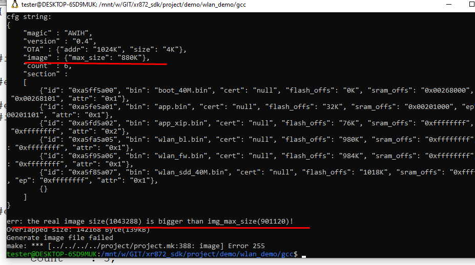

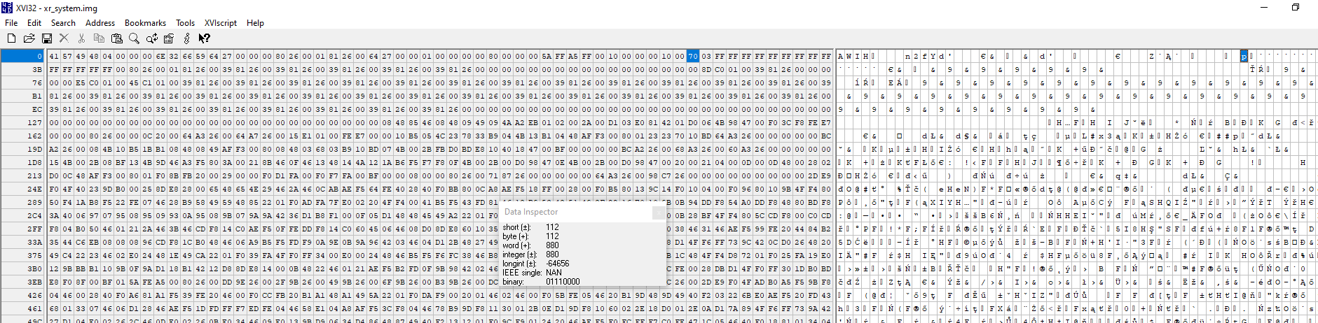

    This "size is invalid" looks like a message from bootloader? But we've changed bootloader as well?
    Screenshot of a hex editor showing binary data as hexadecimal values and ASCII characters.
    Screenshot of XVI32 editor showing a binary file in hex and text modes.

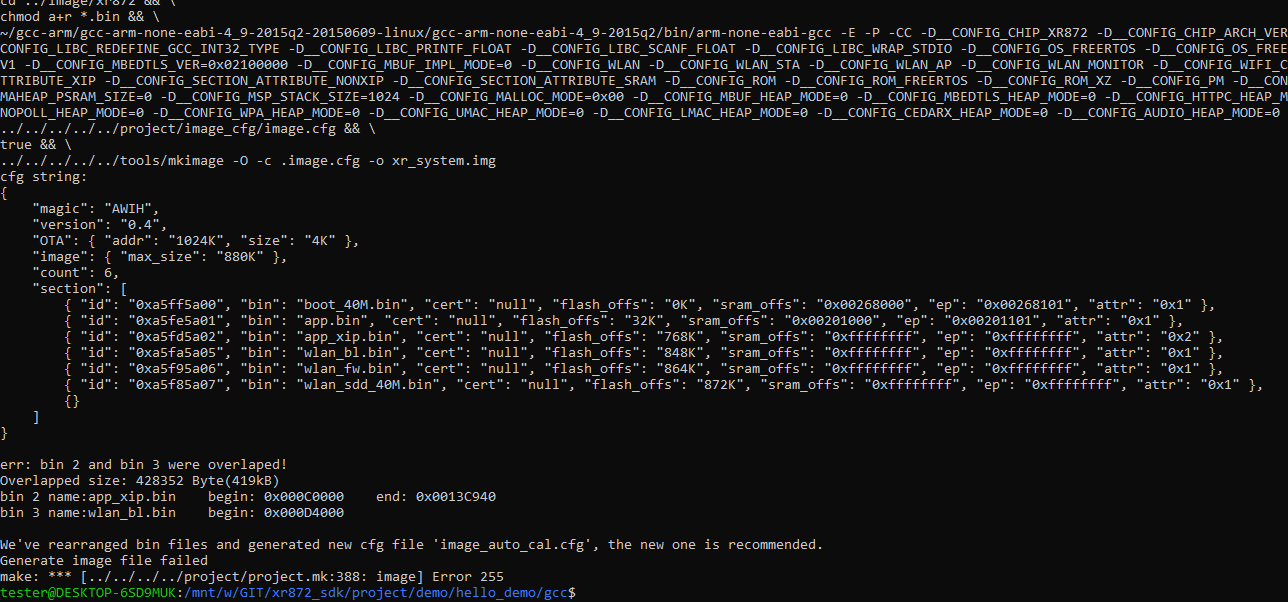

    xr872_sdk\project\image_cfg\image.cfg
        "magic"   : "AWIH",
        "version" : "0.4",
        "OTA"     : {"addr": "1024K", "size": "4K"},
    #if (__CONFIG_OTA_POLICY == 0x01)
        "image"   : {"max_size": "1020K", "xz_max_size": "600K"},
    #else
        "image"   : {"max_size": "1020K"},
    #endif
    #if (defined(__CONFIG_WLAN))
      #if (defined(__CONFIG_XIP) && defined(__CONFIG_PSRAM))
        "count"   : 7,
      #elif (defined(__CONFIG_XIP) || defined(__CONFIG_PSRAM))
        "count"   : 6,
      #else
        "count"   : 5,
      #endif
    #else
        "count"   : 4,
        "count"   : 3,
      #else
        "count"   : 2,
      #endif
    #endif

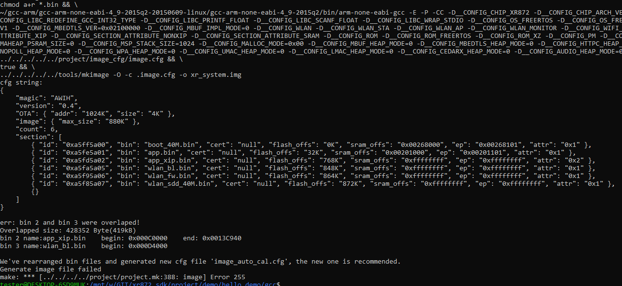

        "section" :
    max_size needs to be changed and then we recompile?
    Comparison of two binary files in a hex editor with highlighted byte-level differences.

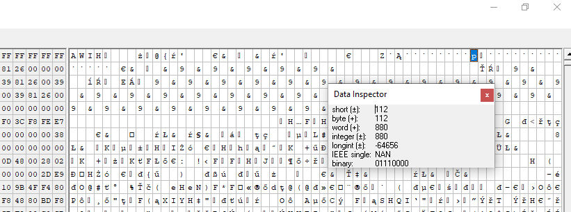

    Here is 1020 in compiled binary:
    Screenshot of the XVI32 hex editor showing a binary file with the Data Inspector window open.
    In read:
    Screenshot of a hex editor with an open Data Inspector window.

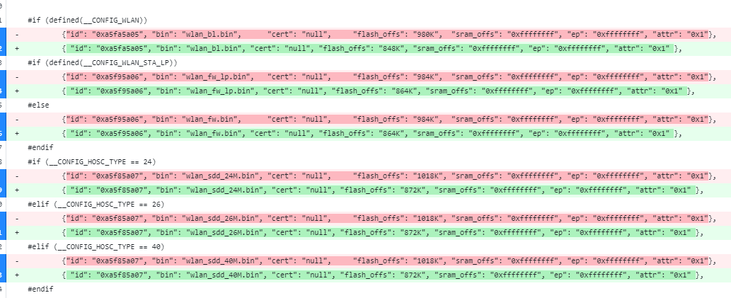

    Added after 10 [minutes]:
    I changed here:
    Screenshot of GitHub Desktop showing changes in image.cfg file in xr872_sdk repository.
    rebuild and
    Screenshot of a terminal showing an error about exceeding the maximum image size during compilation.
    not perfect but change is seen... let me adjust other offsets to fit 880K

  • #58 21523095
    Posts: 14611
    Help: 654
    Rate: 12624

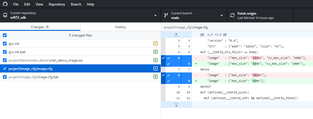

    I moved stuff back:
    Screenshot showing a source code file diff with removed lines in red and added lines in green.
    almost
    Screenshot of a software build process showing an error about overlapping binary files.
    I wonder, will new binary now have 880 at ofs 48 decimal?
    Not yet, it's stuck with overlap:
    Screenshot of a terminal showing compilation output, binary config, and a bin file overlap error.

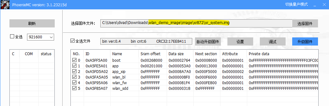

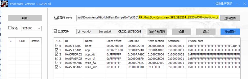

    any help?
    Screenshot of PhoenixMC version 3.1.23215d with a loaded firmware binary for the A9 Mini Spy Cam. Screenshot of PhoenixMC software showing details of the xr_system.img file and its multiple sections.
  • #60 21523102
    Posts: 14611
    Help: 654
    Rate: 12624
    I settled on:
    cfg string:
        "magic": "AWIH",
        "version": "0.4",
        "OTA": { "addr": "1024K", "size": "4K" },
        "image": { "max_size": "880K" },
        "count": 6,
        "section": [
            { "id": "0xa5ff5a00", "bin": "boot_40M.bin", "cert": "null", "flash_offs": "0K", "sram_offs": "0x00268000", "ep": "0x00268101", "attr": "0x1" },
            { "id": "0xa5fe5a01", "bin": "app.bin", "cert": "null", "flash_offs": "32K", "sram_offs": "0x00201000", "ep": "0x00201101", "attr": "0x1" },
            { "id": "0xa5fd5a02", "bin": "app_xip.bin", "cert": "null", "flash_offs": "76K", "sram_offs": "0xffffffff", "ep": "0xffffffff", "attr": "0x2" },
            { "id": "0xa5fa5a05", "bin": "wlan_bl.bin", "cert": "null", "flash_offs": "822K", "sram_offs": "0xffffffff", "ep": "0xffffffff", "attr": "0x1" },
            { "id": "0xa5f95a06", "bin": "wlan_fw.bin", "cert": "null", "flash_offs": "838K", "sram_offs": "0xffffffff", "ep": "0xffffffff", "attr": "0x1" },
            { "id": "0xa5f85a07", "bin": "wlan_sdd_40M.bin", "cert": "null", "flash_offs": "872K", "sram_offs": "0xffffffff", "ep": "0xffffffff", "attr": "0x1" },
    generate image: xr_system.img

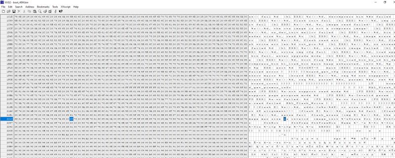

    Generated hello demo has 880 at 48 ofs decimal:
    Screenshot of XVI32 hex editor showing a binary file and an open Data Inspector window.
    Wait, so you can open existing dumps with that tool? That could be helpful.
    I attach hello_demo image with 880 size at 48 decimal offset, can you run it?
    • hello_demo_image.zip (780.06 KB) You must be logged in to download this attachment.
