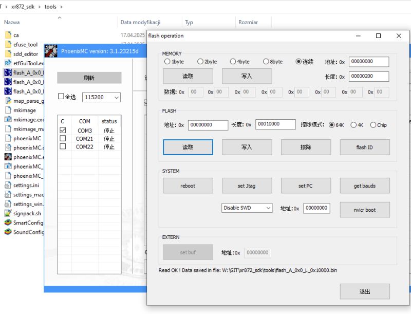

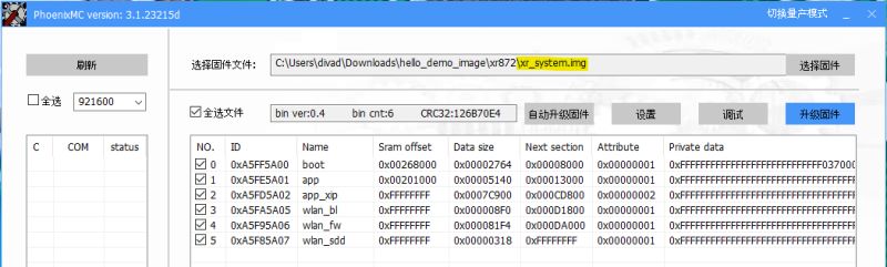

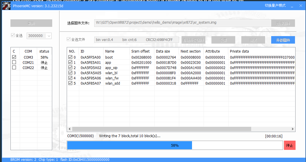

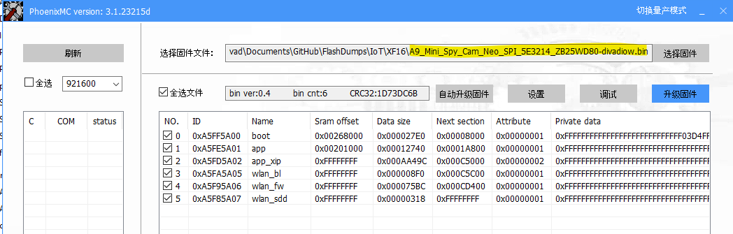

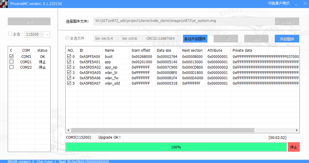

    second bin gives me this again

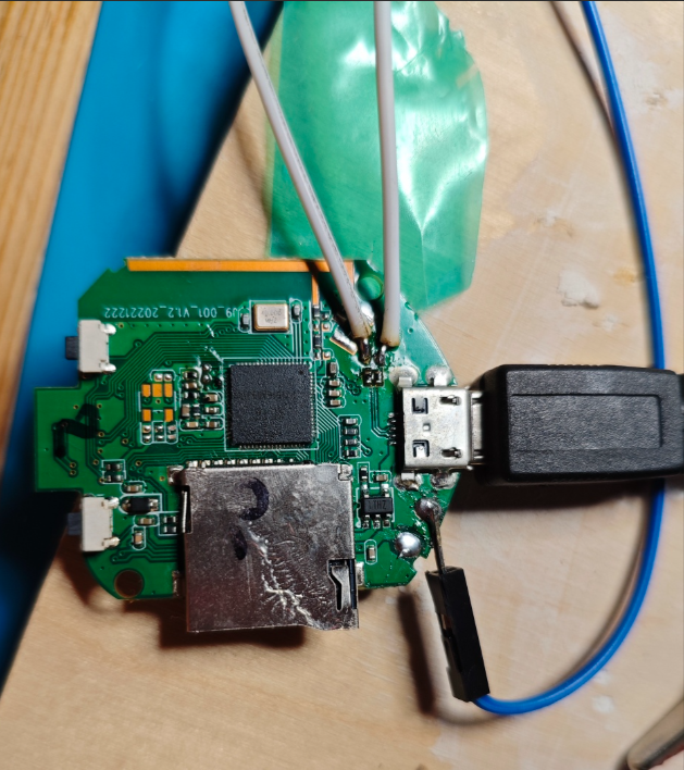

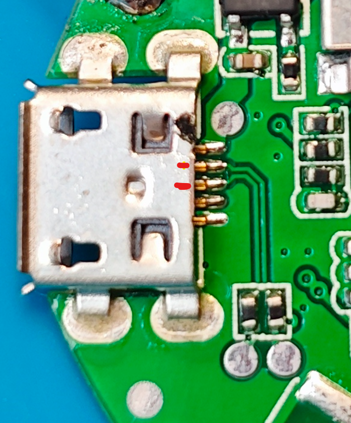

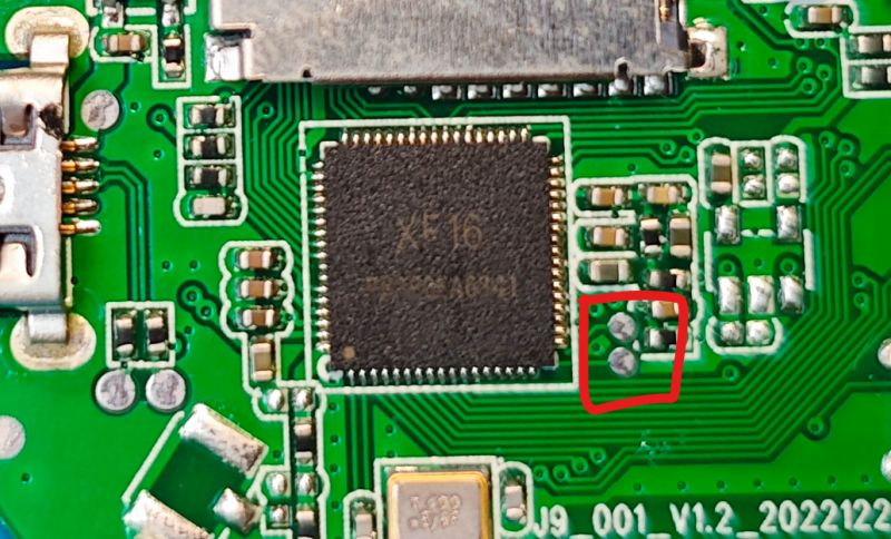

    at that point my needle on TX slipped off. I'd like to do flash it again to be 100% sure. de-soldering chip every time sucks. could do with a zif mod
    also, I'd like to try grounding these to see if they're PB02/PB03 (assuming uart download mode is same as XR872):
    Close-up of a PCB with an XF16 chip and four signal pads highlighted by a red border.
    for comparison. 2nd demo build vs original dump
    Screenshot of the PhoenixMC tool showing the configuration for flashing the xr_system.img file to an XR872 device.
    Screenshot of the PhoenixMC tool showing firmware sections and details while selecting a .bin file for device flashing.
    Added after 20 [minutes]:
    hmm. tried again. full log from second demo build

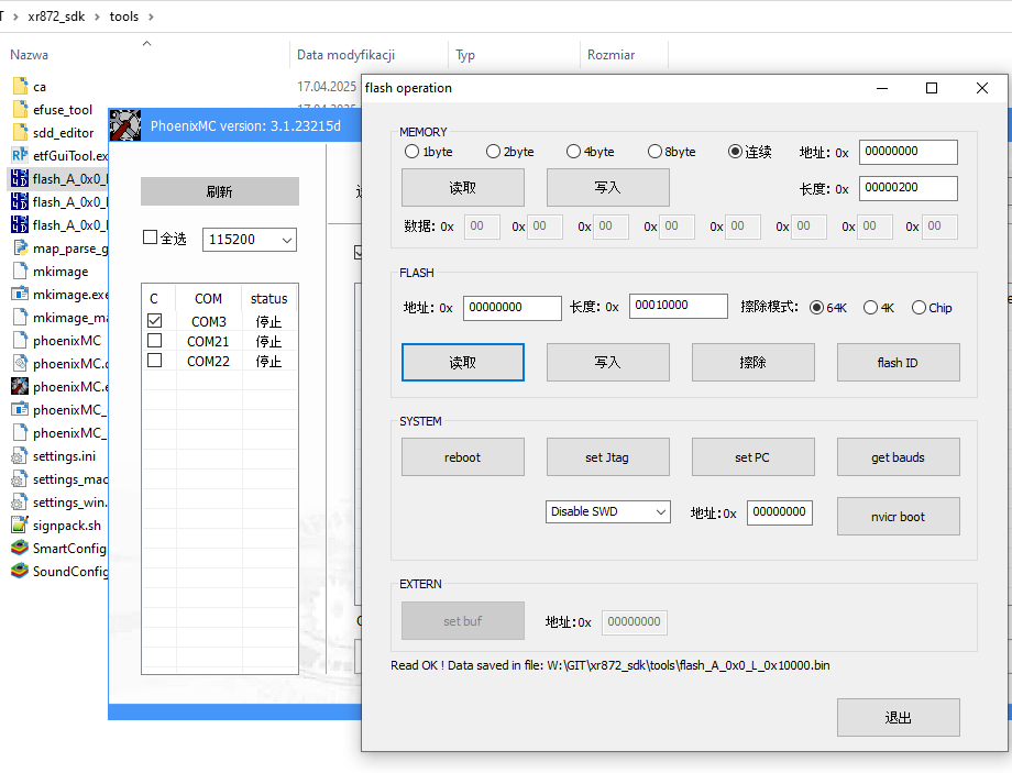

    I shorted your two pads to GND - I get synchron errors.
    I disconnected them from GND. And then I got - how?
    Screenshot showing the PhoenixMC program interface and a folder with debugging tools files.

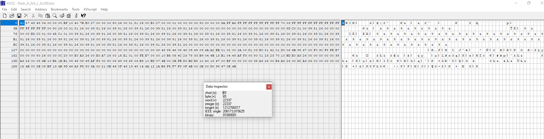

    Screenshot of the XV132 hex editor with an open binary file and active Data Inspector window.
    Added after 42 [seconds]:
    PhoenixMC software window for Flash memory operations and list of COM ports.

    lol. nice. I was just in the process of doing that too. I guess they are PB02/03 or something
    Added after 3 [minutes]:
    first I need a better UART connection. I just noticed the traces and now I know what your USB/uart flash cable was about
    Micro USB connector soldered to a green PCB with visible pins and burn marks near the pins.

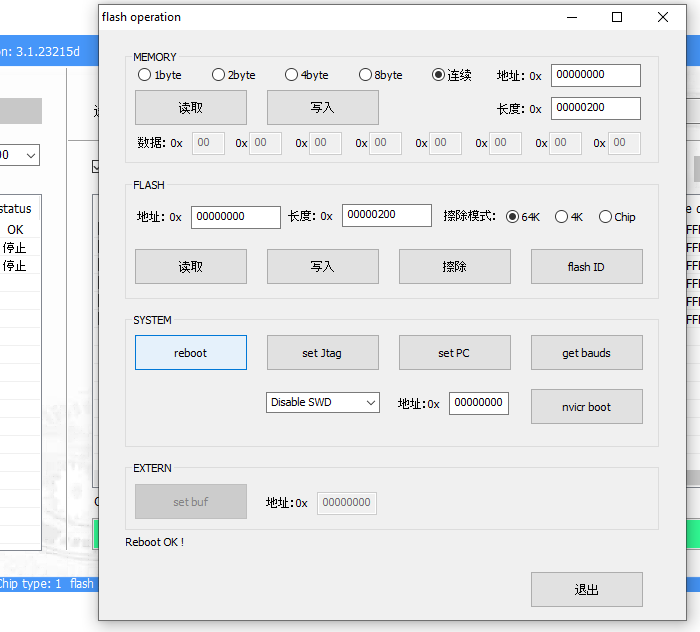

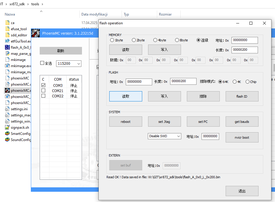

    Wait, I don't even remember now - those PB pads should be held low (ground) at reboot and then released, and then you can flash? Or should they be held all the time low during flash? It seems they should be released.
    Here's what I read:
    • flash_A_0x0_L_0x100000.zip (575.77 KB) You must be logged in to download this attachment.
  • #66 21523182

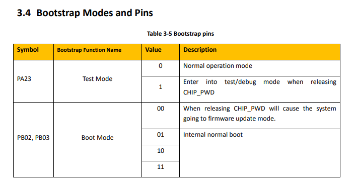

    well, XR809 and XR806 we've been keeping low and it's fine. but maybe XF16 is different.
    This is in XR872 DS
    Table showing bootstrap modes and associated pins with descriptions for PA23 and PB02, PB03.

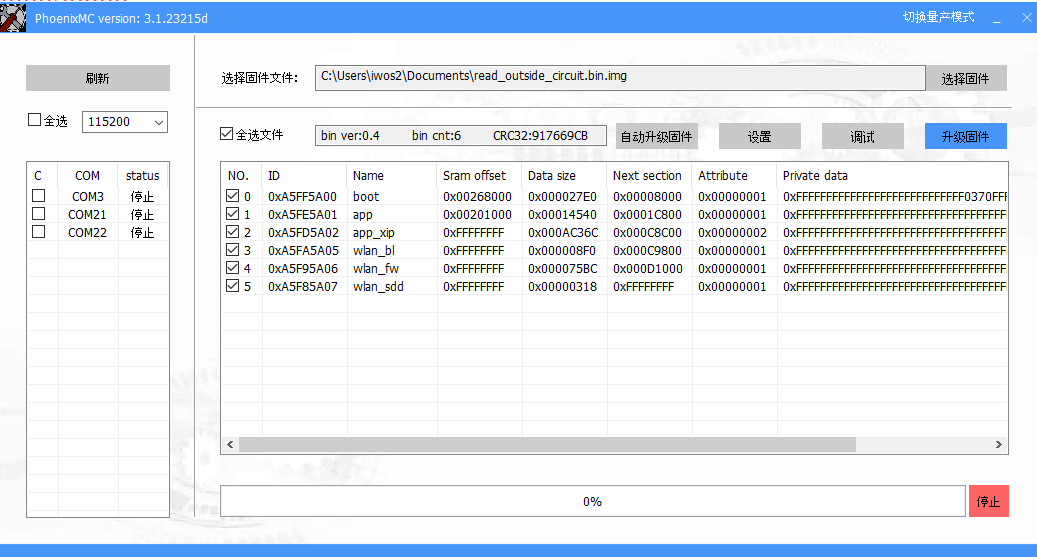

    EDIT: I have PB pads shorted together, but not to ground. I disconnected totally USB power, reconnected it, and I can still flash....
    but I also get SSID if I don't attempt to flash:
    Wi-Fi icon and the network name BATA825001CKETR on a light background.

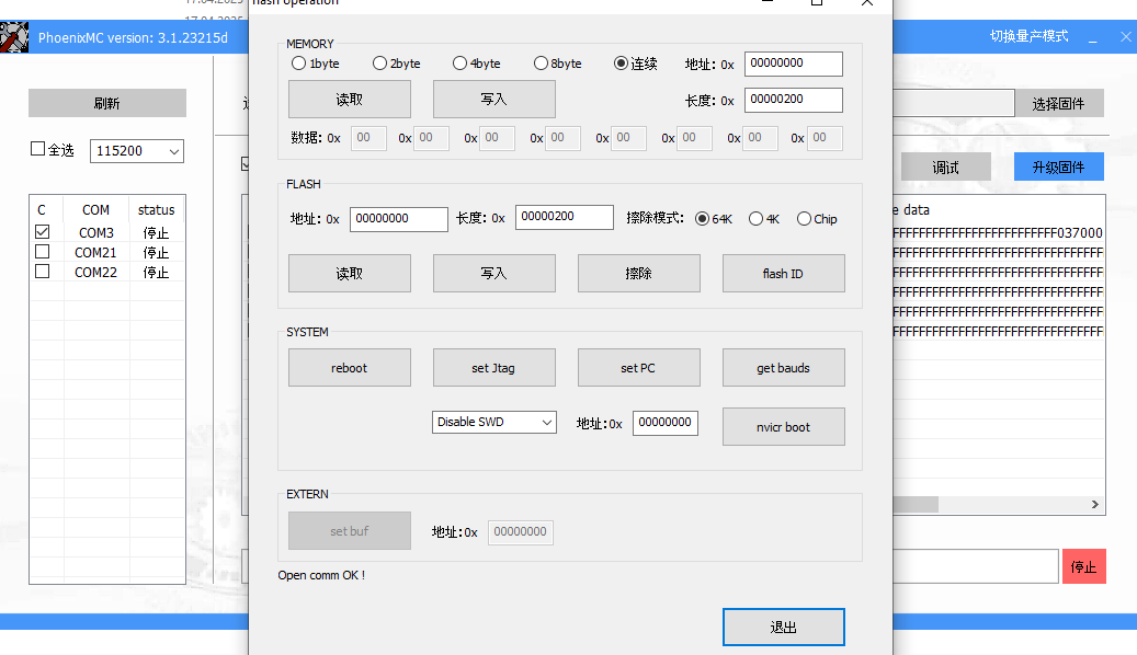

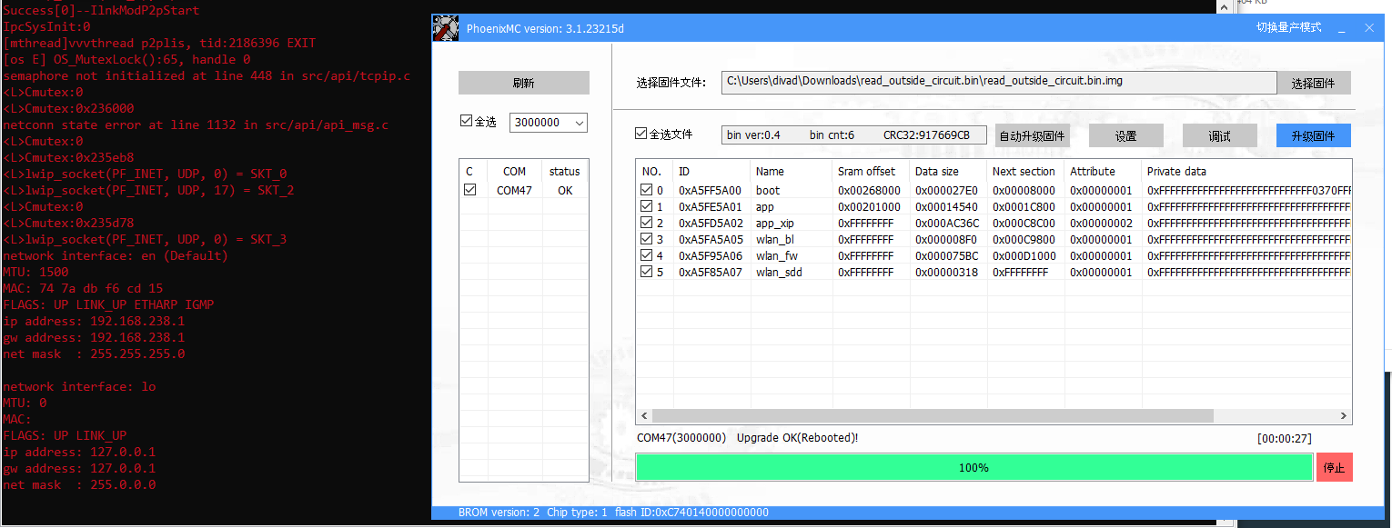

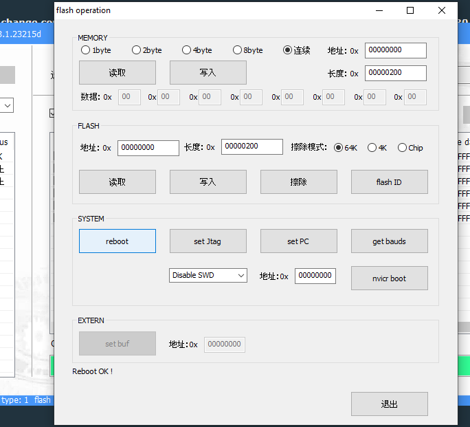

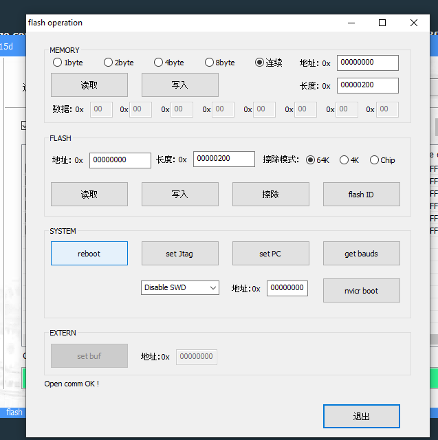

    Maybe... maybe phoenixMC sends via UART something to enable flash mode programmatically?
    I opened PhoenixMC again, it did "Open comm OK" and AP is gone, and I can flash.
    So.... it can flash without user intervention? I wonder what will happen if I flash my binary now.... will it keep the ability to flash without external reset/stuff...

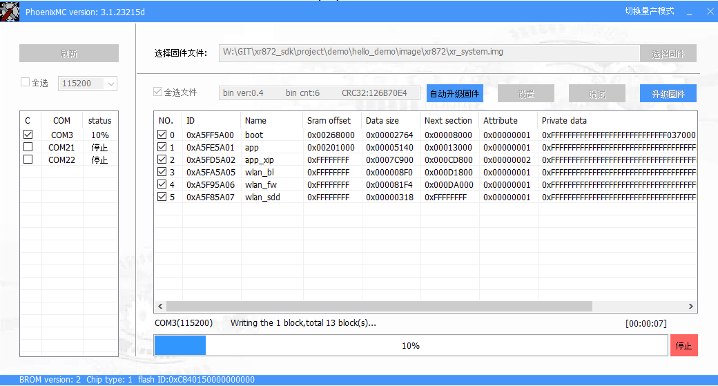

    Trying to flash:
    PhoenixMC software interface while loading firmware file to a microcontroller on COM3 port, with 10% progress.
    What the heck. This whole time...

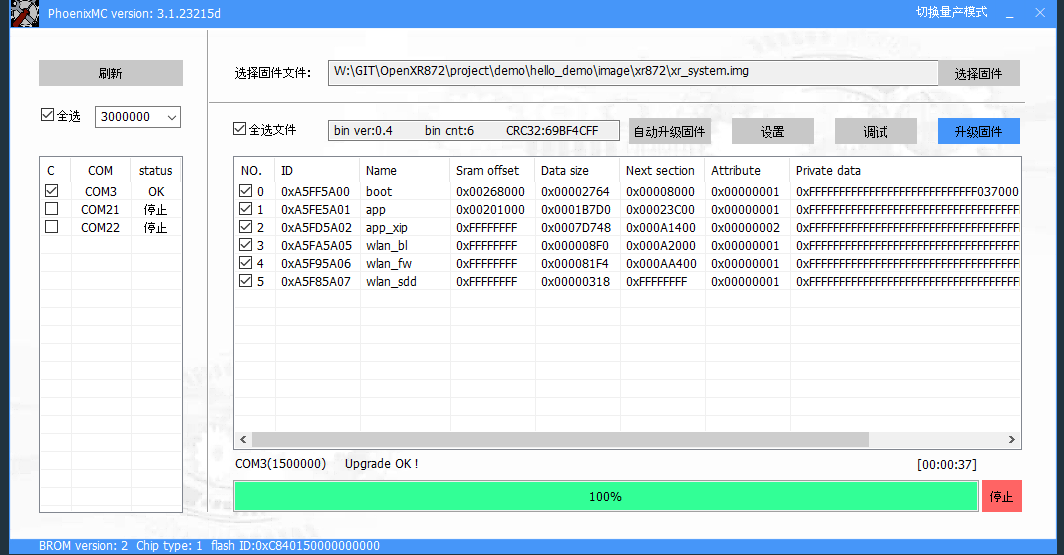

    We would need to check if PhoenixMC sends something via UART to let know the chip that it wants program mode.
    Flashed.
    Screenshot of PhoenixMC software used for firmware upgrades via COM ports; operation completed successfully.
    Added after 45 [seconds]:
    Still can open com after flash?
    Screenshot of software windows for communication with devices via COM ports and flash memory operations.

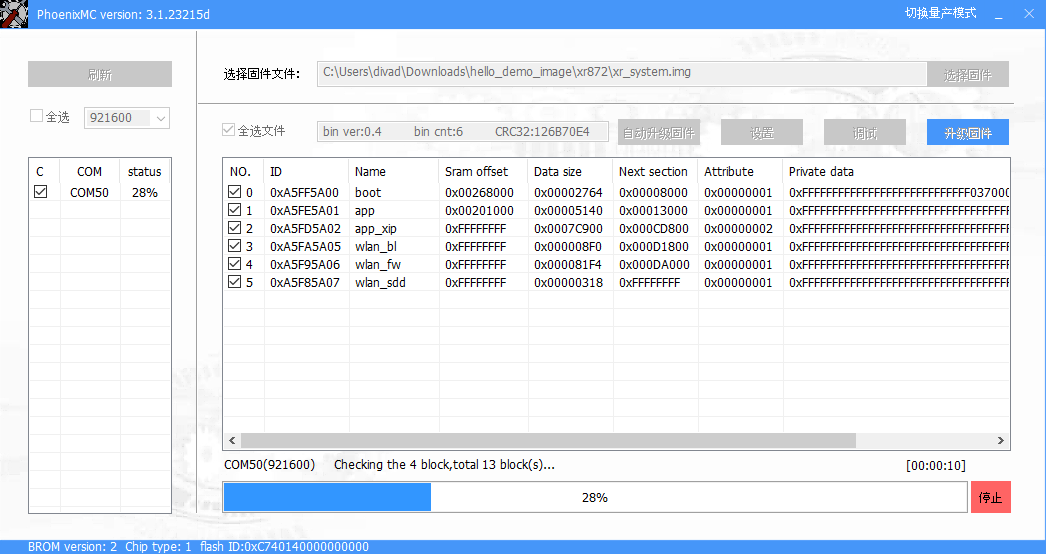

    Screenshot of PhoenixMC software updating firmware on a device connected via COM50 port. Progress bar at 28%.
    Warning dialog window in phoenixMC with BROM version and flash ID information.
    no uart log for me. hmm.

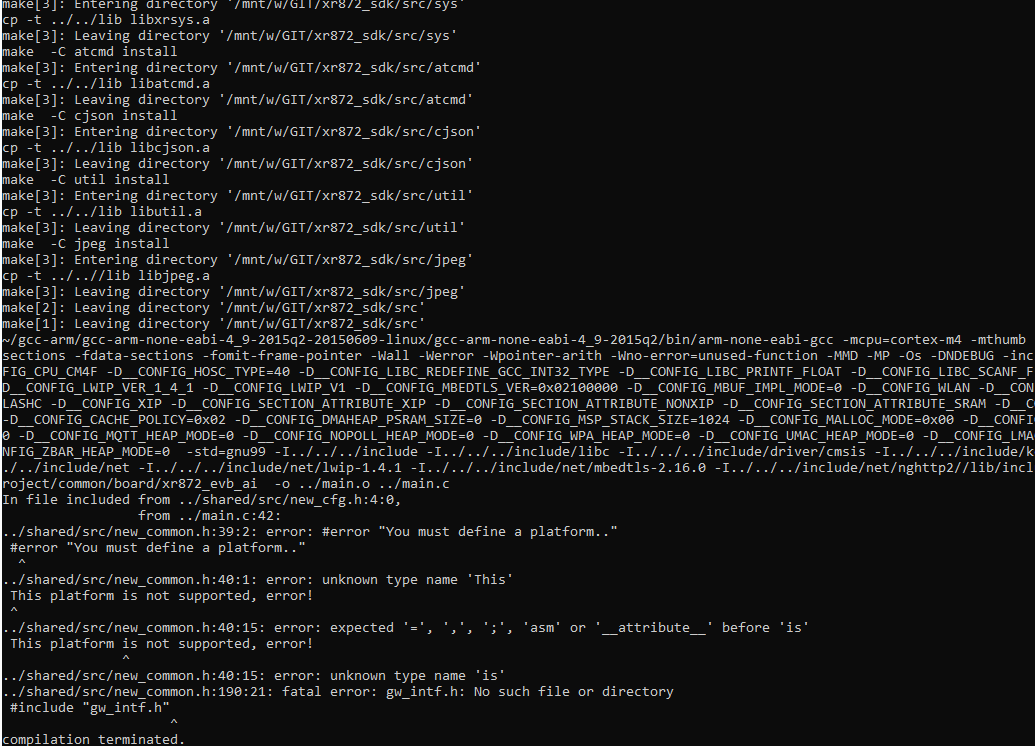

    Console with C project build errors, showing detailed error messages during compilation.

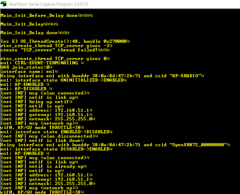

    I flashed original 1MB to 2MB flash chip and it works with that flash chip. UART bootloader works as long as working XR872 project is flashed (original firmware or hello world from SDK)
    So many problems...

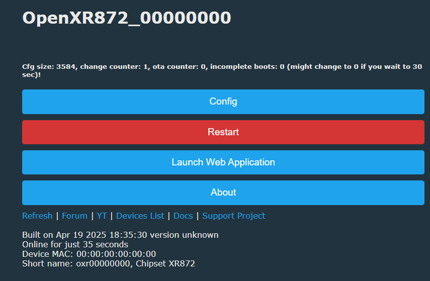

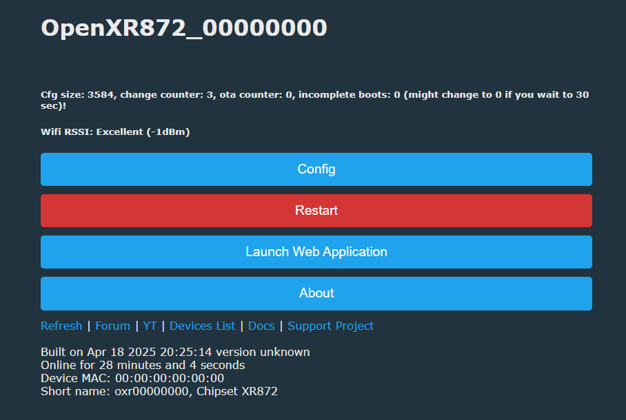

    Wi-Fi signal icon and network name OpenXR872_00000000 on a light background.
    Added after 10 [minutes]:
    Screenshot from RealTerm program displaying network device initialization logs and Wi-Fi connection attempts.
    I get -3 here:
       err = OS_ThreadCreate(thread,
                          name,
                          function,
                          arg,
                          new_priority,
                          stack_size);
    Invalid parameter, huh?
    i suspect configTOTAL_HEAP_SIZE
    Added after 9 [minutes]:
    There are two RTOS to choose:

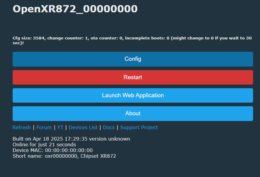

    Added after 7 [minutes]:
    OpenXR872 control panel with four large buttons: Config, Restart, Launch Web Application, and About. Shows XR872 device status.

    Rate: 12604
    can you check? 192.168.51.1

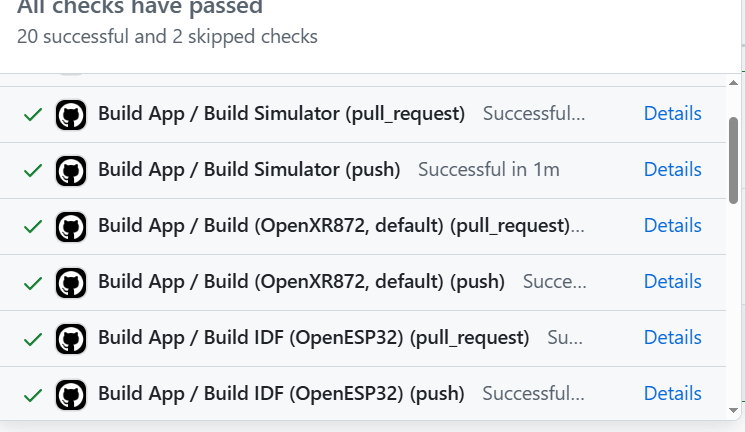

    No idea, for now I've added Github builds:
    A list of successful app builds on GitHub Actions platform.
    but much is still missing, we don't even have config save.
    Added after 46 [minutes]:
    config save works
    Console with yellow text on black background showing Wi-Fi connection logs for an embedded device.

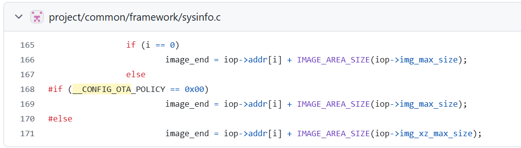

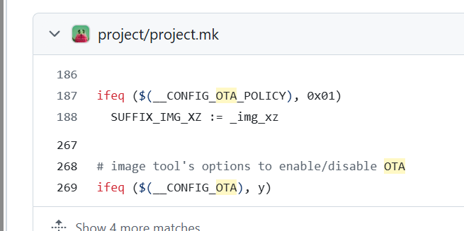

    I am investigating OTA currently:
    A fragment of the project.mk file with makefile code, showing conditions related to OTA configuration.
    > localconfig.mk:
    > * __CONFIG_XIP:可选项,配置是否开启XIP功能
    > * __CONFIG_OTA:可选项,配置是否开启OTA功能
    Added after 14 [minutes]:
    but how will OTA fit into 1MB...

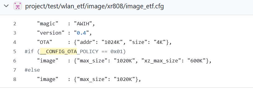

    It's just that OTA worries me. I can clearly see that this SDK has ota compressed by XZ just like BL602 does, but it still doesn't change the fact that OTA requires us to fit like almost a second whole image in the flash....
    Maybe we can investigate: https://github.com/search?q=repo%3Aopenshwprojects%2FOpenXR872%20OTA&type=code
    ota_update_image_process seems to be doing update
    Hm
    Code: C / C++
    Code: C / C++
    Is this OTA buffer?>
    Code: C / C++
    Code: C / C++
    I'm not sure yet where do they write this OTA image - at which flash offset.
    A fragment of C code from sysinfo.c, showing conditional statements and preprocessor directives.
    A fragment of the image_etf.cfg configuration file with conditional code related to OTA policy.
    Added after 36 [minutes]:

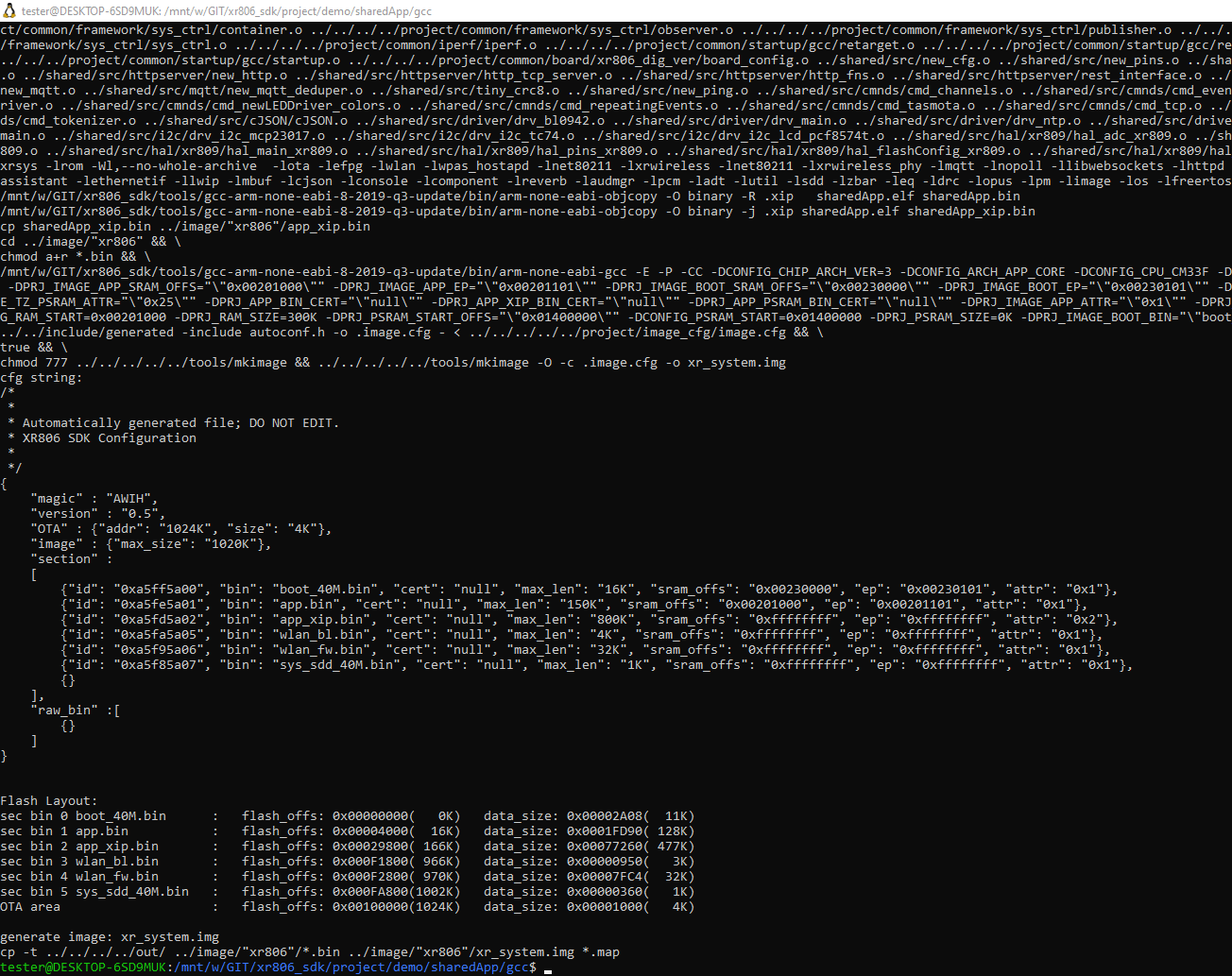

    out of curiosity, I ran xr806 compilation and it has OTA space in partitions layout:
    Screenshot of a terminal with code compilation and flash memory configuration for the XR806 project.

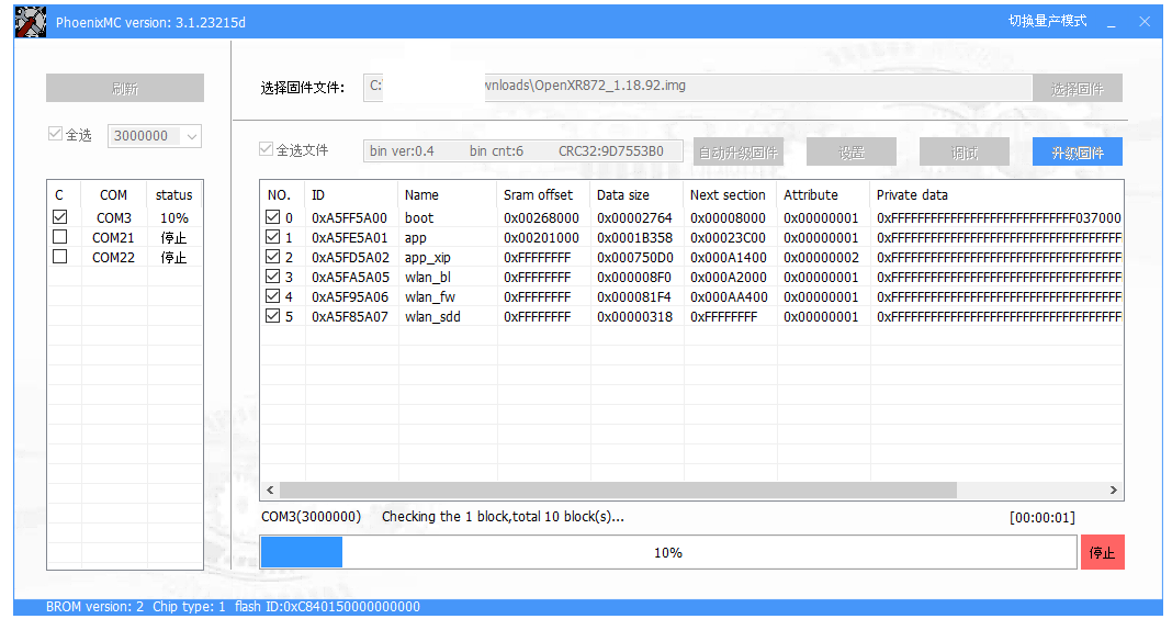

    So I have this page:
    Screenshot of the OpenXR872 device control panel with buttons for configuration, restart, launching web application, and device information.
    I have only USB to UART connected.

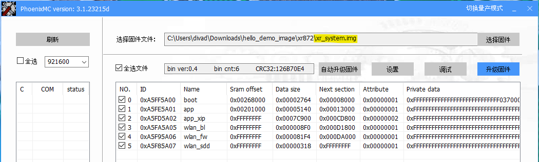

    I open pheoenixmc and try to flash original firmware:
    Screenshot of PhoenixMC software showing firmware file details and COM ports list.
    PhoenixMC software window flashing a binary image to flash memory via COM3 port, with 10% progress.
    Screenshot of PhoenixMC software showing a completed firmware upgrade process and a partition list.
    I do reboot:
    Window of a flash memory operation program with various read, write, and system management options.
    |I got factory firmware AP and fast led blink, ok:
    Wi-Fi signal icon with the text BATA825001CKETR on a light background.

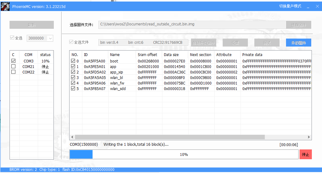

    Ok, now I try to flash firmware I compiled myself (It's OBK, I put it in hello demo project):
    Window of the PhoenixMC software used for updating XR872 microcontroller firmware, with the process completed at 100%.
    It flashes:
    Screenshot of PhoenixMC software during firmware update process via COM port.
    I reboot:
    A software window for flash memory operations with buttons for reading, writing, and device reboot.
    I get OBK AP:
    Wi-Fi signal icon and the text OpenXR872_00000000 on a white background.
    Conclusion: I can reboot and flash just via USB connector RX and TX, didn't have to repower or reattach anything.
    Extra test:
    Screenshot of the PhoenixMC software updating firmware on a device via COM port.
    revoot
    A tool window for flash memory operations with buttons for reading, writing, erasing, and address input fields.
    it works
    Web interface screen of the OpenXR872 device with control buttons visible.
    Conclusions:
    - all is done via phoenix mc, no reattaching wires needed, no cycling, etc
    - i can easily switch between online build, original fw and my local build
    Questions?

  • #86 21524776
    Posts: 5026
    Help: 438
    Rate: 891
    yep. all the same for me. Even my old backups of A9 from last year boot, just not OpenXR872. I am using same version of PhoenixMC, same settings in debug as you. flashing always starts OK and completes. I've desolered flash to put factory back on then UART over the top.
    Added after 43 [seconds]:
    Maybe I should find 100k resistor for 1st cam and repair that. I just don't see why this isn't booting for me.
  • #87 21524778
    Posts: 14580
    Help: 654
    Rate: 12604
    The one i used.
    • read_outside_circuit.bin.zip (575.77 KB) You must be logged in to download this attachment.
  • #88 21524781
    Posts: 5026
    Help: 438
    Rate: 891
    yep. that boots fine after flashing and I get BATxxx AP
    Screenshot showing the process of programming flash memory using PhoenixMC tool and a terminal window with network system startup logs.
    I am flashing via soldered wires
    A printed circuit board with connected wires, a micro USB port, and an SD card slot.
  • #89 21524787
    Posts: 14580
    Help: 654
    Rate: 12604
    So now you have to.... remove the incorrect flash dumps from our repository, I guess?
    That's why I specifically taken yet another backup after desoldering the Flash chip from the circuit. I was worried that it might come to this.
  • #90 21524791
    Posts: 5026
    Help: 438
    Rate: 891
    im not sure I follow. the factory A9 dumps boot fine...
