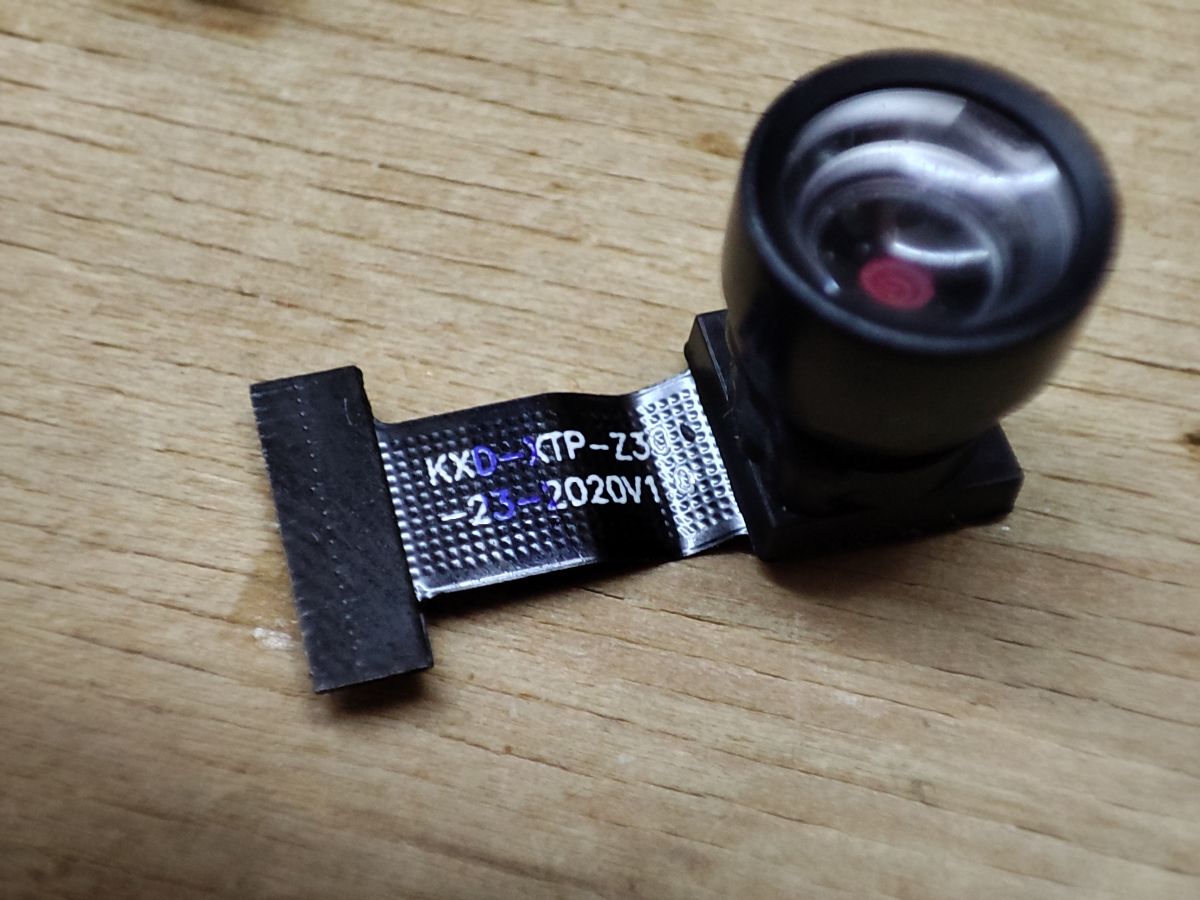

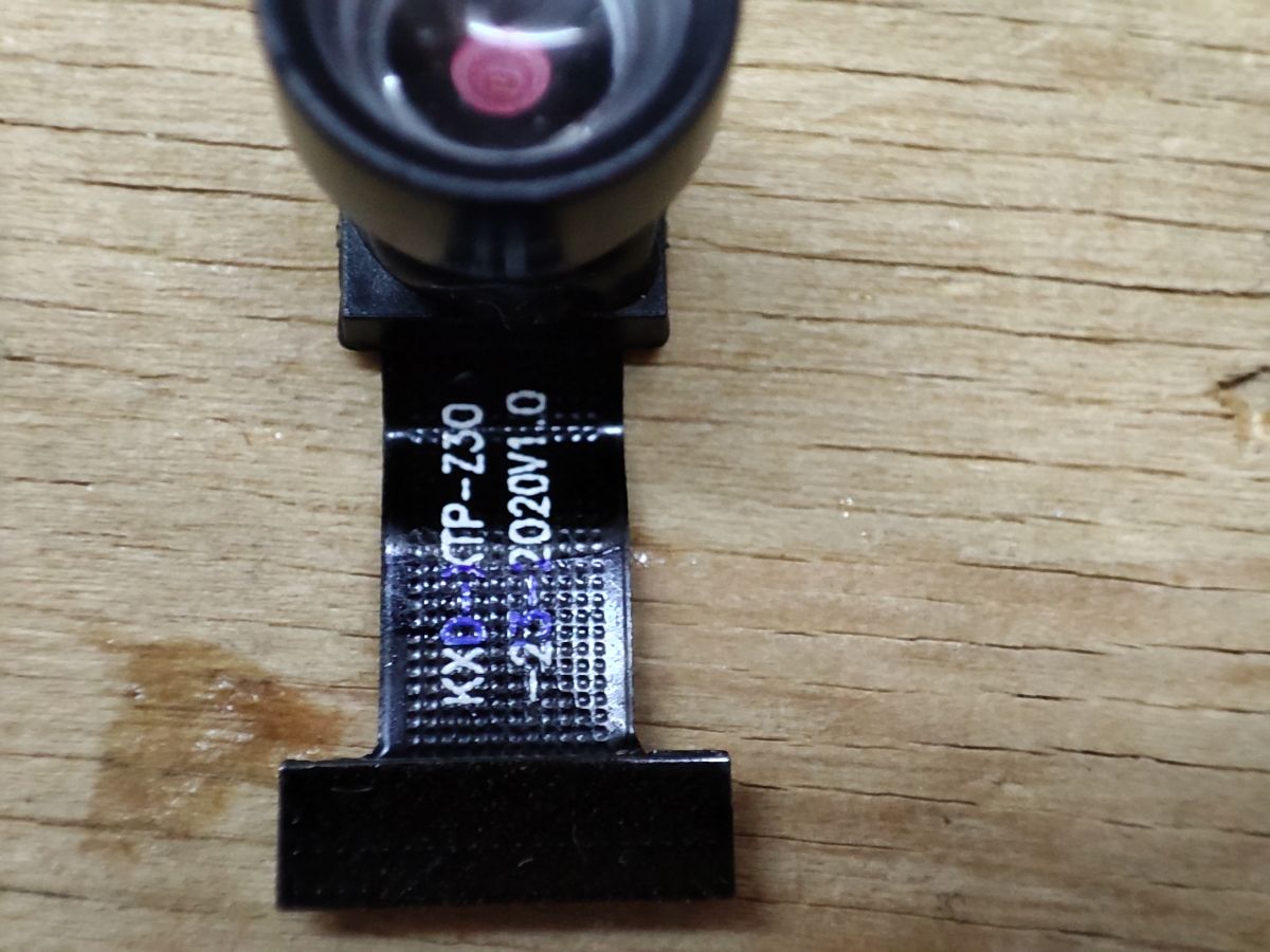

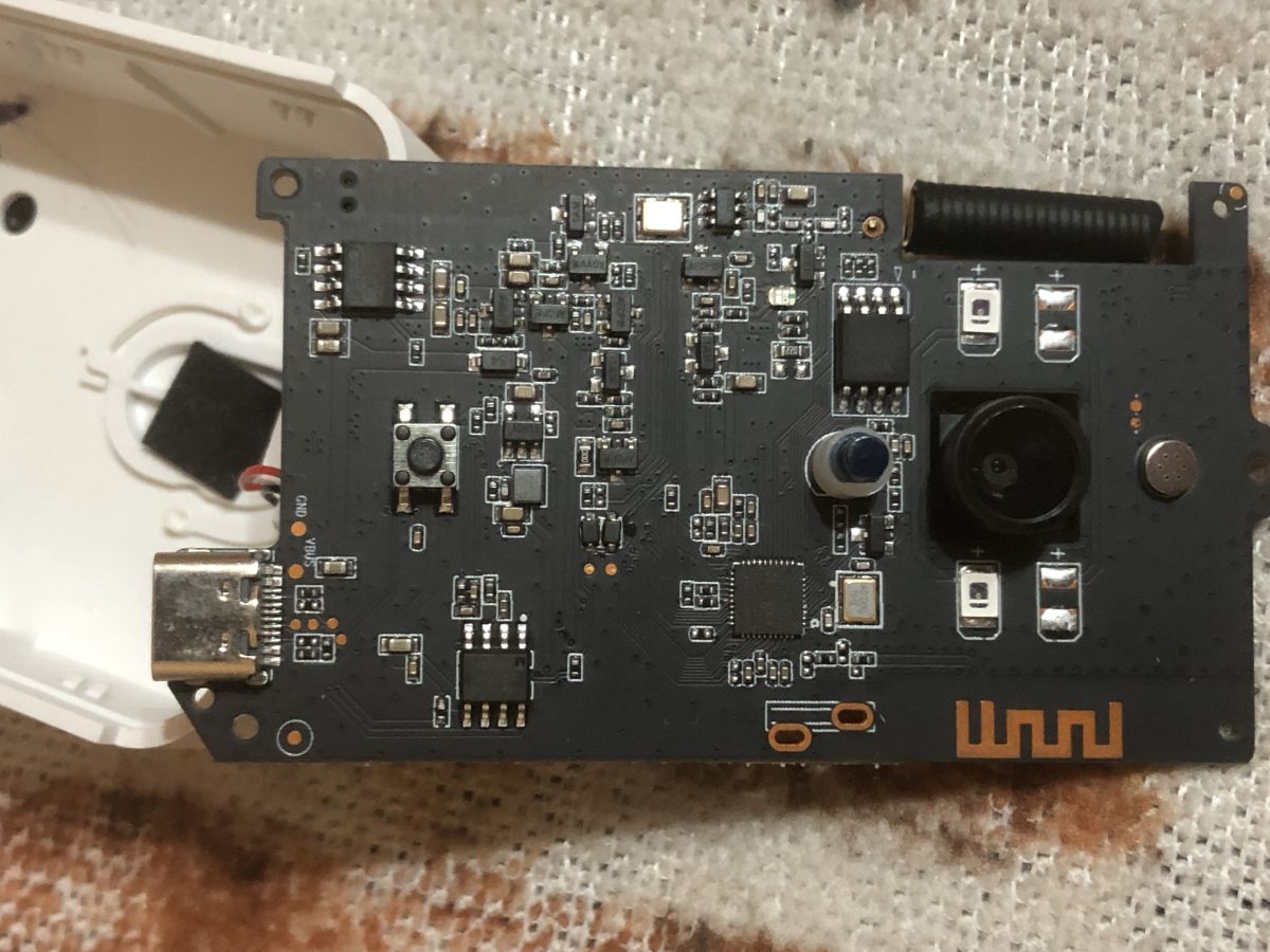

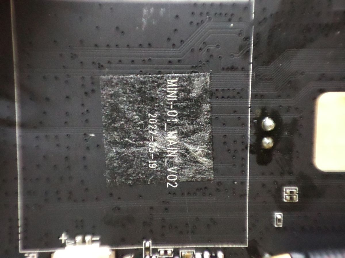

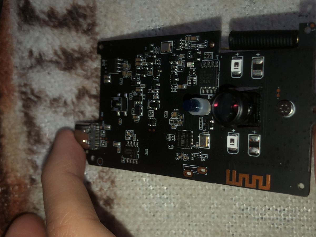

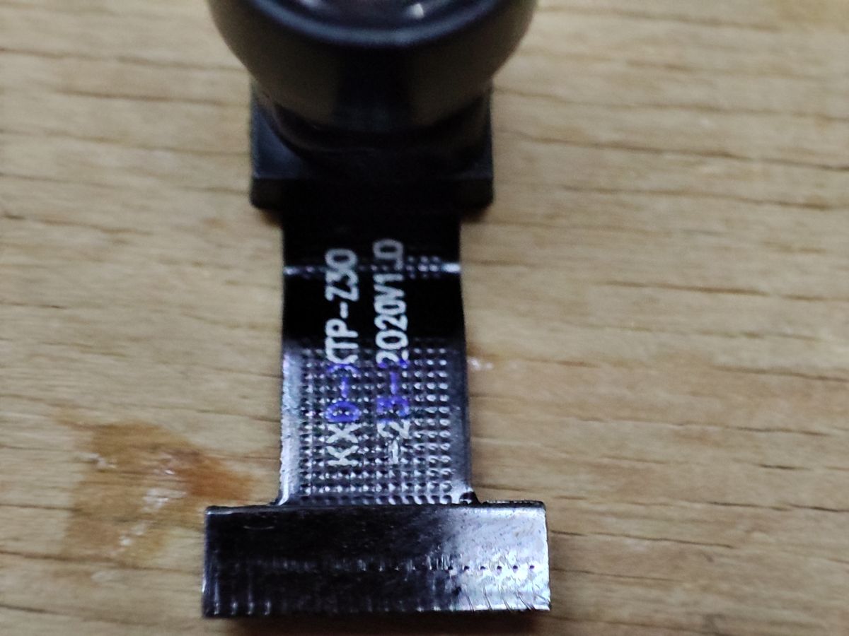

    This is what I have:
    Close-up of PCB labeled MINI-01_MAIN_V02 with date 2022-05-19
    Camera module labeled KXD-XTP-Z30-23-2020V1.0 on a wooden surface
    Camera module with flex cable on wooden surface, visible technical markings
    Camera module with lens and ribbon labeled KXP-STP-Z30 2020v1.0
    So board reads... MINI-01_MAIN_V02 2022-05-19 and camera... KXD-XTP-Z30-23-2020V1.0 ?

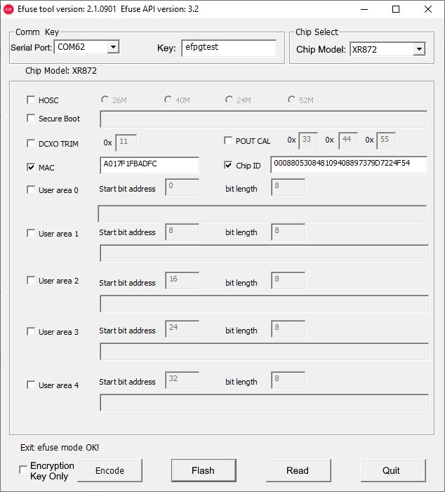

    hey look, here's the efuse tool retrieving some info from XF16 device. OBK is running at this point.
    Translated bits added too
    Screenshot of Efuse tool with chip model XR872 and MAC/Chip ID data enabled
    add extra things to read (eg secure boot) and this is the result
    Error message “device 405: Operation error, no valid data!” and Encode button
    Latest tool and API dll combination I could find attached as well as efuse tool PDF in Chinese and English.

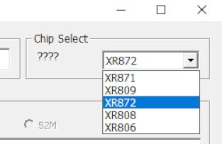

    I wonder if the Kement XR872s have anything interesting to be read.

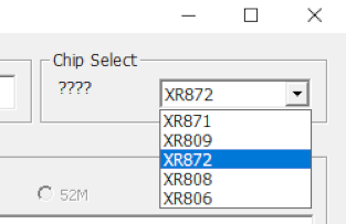

    Others supported:
    Screenshot with chip selection dropdown list, XR872 selected
    • efuse_tool_2.1.0901_api3.2.zip (111.34 KB) You must be logged in to download this attachment.
    • XRADIO_Efuse_Tool_User_Guide-CN.pdf (481.37 KB) You must be logged in to download this attachment.
    • XRADIO_Efuse_Tool_User_Guide-EN.pdf (1.18 MB) You must be logged in to download this attachment.

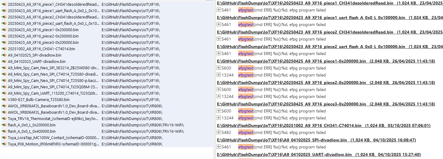

    efuse tool is sending the command efpg and some other bytes then getting back a <ACK> 200 OK and some bytes
    Added after 3 [minutes]:
    https://github.com/openshwprojects/OpenXR872/...de0b238e2c054265f88a9/include/efpg/efpg.h#L43
    Added after 18 [minutes]:
    unsurprisingly perhaps the key espgtest does not appear to be present in the Kement dumps
    List of binary files with paths, sizes, and programming error logs.
    the real key is proving elusive

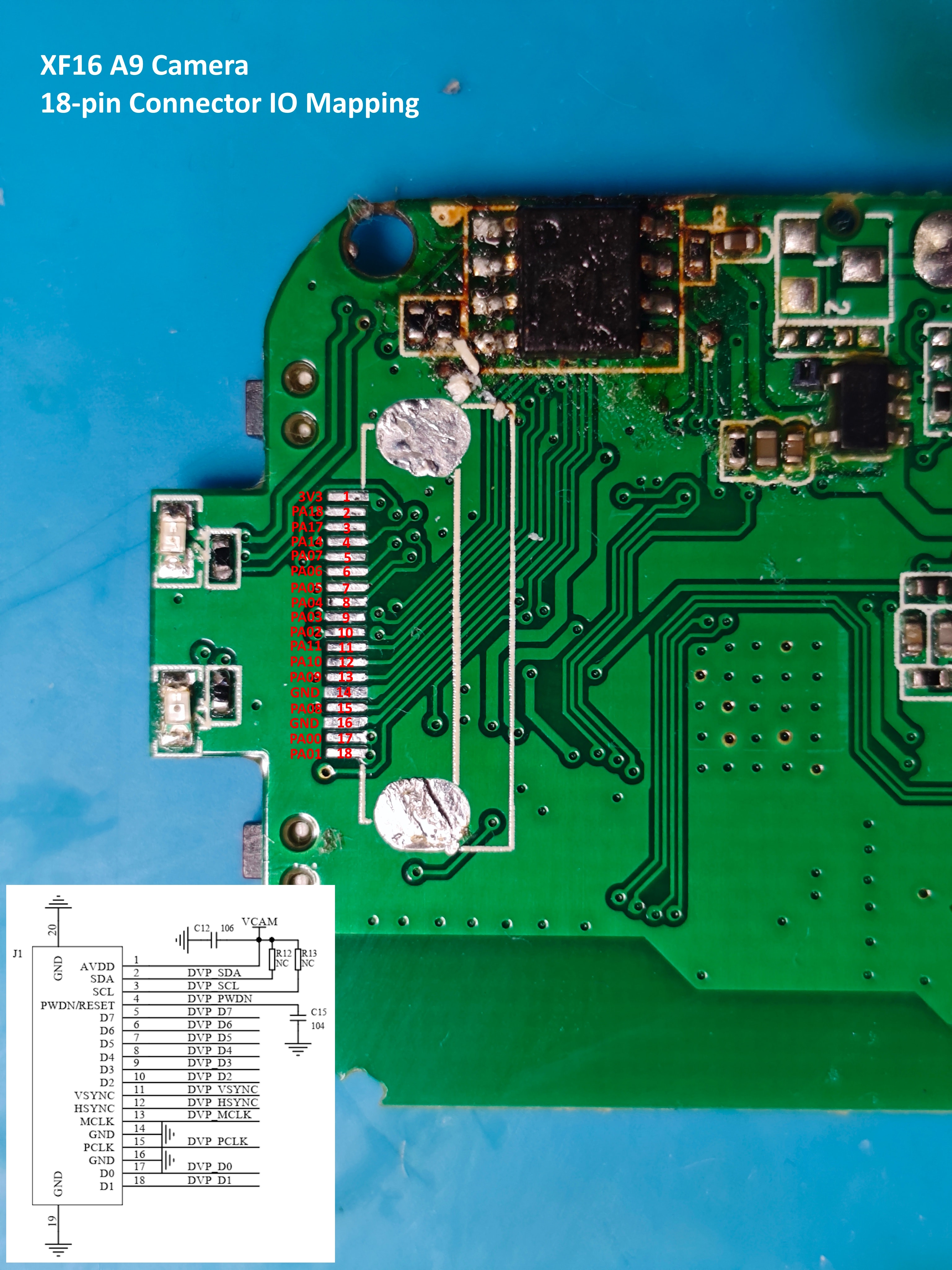

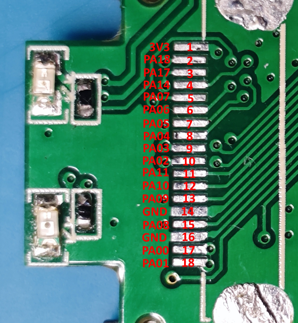

    Back to the XF16 A9 cam
    This is where each of the 18 pins trace to on this
    Exploring A9 Minicam Variation: XF16 PB380EA6341 MCU, T25S80 SPI Flash, XR872, Skylark SDK
    Pad #FunctionXF16 IO
    1AVDD
    2SDAPA18
    3SCLPA17
    4PWDN/RESETPA14
    5DVP D7PA07
    6DVP D6PA06
    7DVP D5PA05
    8DVP D4PA04
    9DVP D3PA03
    10DVP D2PA02
    11VSYNCPA11
    12HSYNCPA10
    13MCLKPA09
    14GND
    15PCLKPA08
    16GND
    17DVP D0PA00
    18DVP D1PA01
    • Exploring A9 Minicam Variation: XF16 PB380EA6341 MCU, T25S80 SPI Flash, XR872, Skylark SDK camconnectorpins.jpg (5.73 MB) You must be logged in to download this attachment.

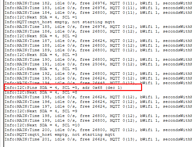

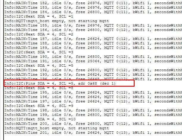

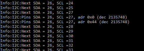

    This may be interesting for you and camera testing - a multi-pin I2C scanner, tested only on ESP8266:
    bool canUsePin(int pin) {
    #if PLATFORM_ESP8266
       if (pin == 6) {
          return false;
       if (pin == 7) {
          return false;
    #endif
       return true;
    I had to disable two pins there.
    startDriver MultiPinI2CScanner
    Correctly detects clock chip:
    ESP-12 connected to DS3231 RTC via I2C using GPIO4 and GPIO5
    System log screenshot showing I2C pins and address 0x68 highlighted

    Yep cheers. I've an i2c scanner now (GPT creation) but no detection. I need to go back a step and get a working detection with non-camera like AHT20, so not relying on camera to be in correct state first. Get proven i2c detection code then go back to cam.
    #282 21746839
    Posts: 5027
    Help: 438
    Rate: 891
    cool. it doesn't crash. going to take ages. I will wire up AHT20.
    Added after 6 [minutes]:
    not sure i2c's been added to XR872 actually anyway.
    platforms.md needs i2c column

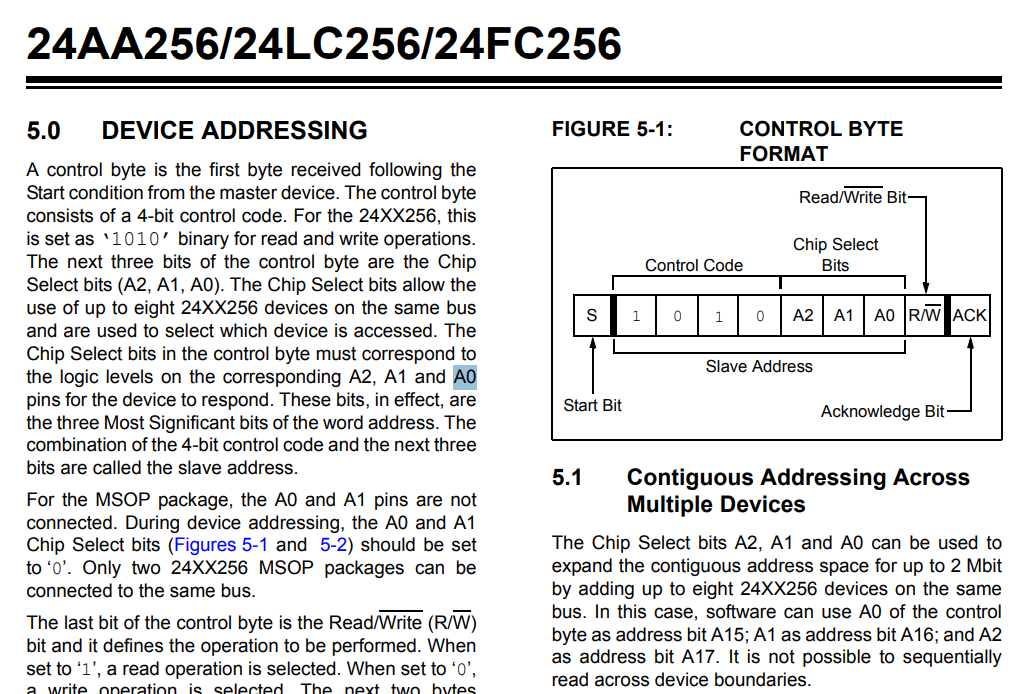

    Well, this AHT20 I2C address does not look okay. Strange.
    I2C is done in software, it should run more or less on any platform. No specific timings are required there, it's not problematic as DS18B20.
    I also got false positives on some pin configurations.
    I added 24AA256 to my clock bus and redid scan:
    , MQTT 0(12), bWifi 1, secondsWithNoPing 129, socks 0/0
    Info:I2C:Pins SDA = 4, SCL =5, adr 0x50 (dec 1)
    Info:MAIN:Time 199, idle 0/s, free 26780, MQTT 0(12), bWifi 1, secondsWithNoPing 130, socks 0/0
    Info:I2C:Pins SDA = 4, SCL =5, adr 0x68 (dec 1)
    Info:I2C:Next SDA = 4, SCL =8
    Info:MAIN:Time 200, idle 0/s, free 26604, MQ
    Well.. 0x50
    Control byte format diagram with device addressing info for 24XX256 memory
    assuming all address pins are tied to ground...
    We'd get 0b1010000, and this is exactly 0x50 hex.

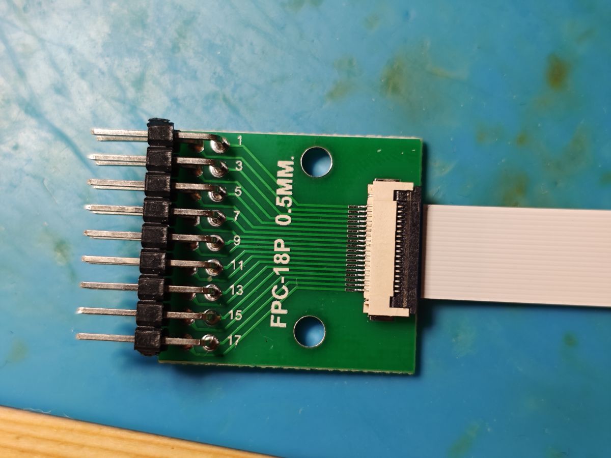

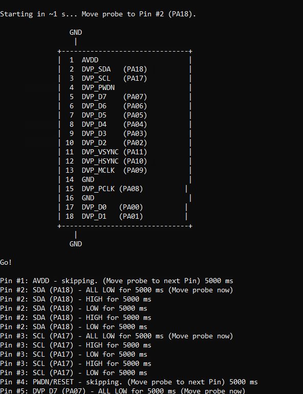

    Here's another thing.
    An XF16 CSI connector pin walker. This confirms the remaining IOs in the table above.
    DVP module pinout diagram with test log showing GPIO pin signal states
    Prints ASCII connector x3 every 3s.
    Countdown to Pin#2
    High/Low/High/Low 5s each
    Pause to move probe
    repeat for next pin.
    A bit slow but you get to watch the multimeter dance around and it confirms OpenXR872 pin mappings.
    Close-up of FFC connector on green PCB with a measurement probe touching the pins
    • XR872-XF16_A9_Cam_CSI_PinWalker.zip (41.93 KB) You must be logged in to download this attachment.

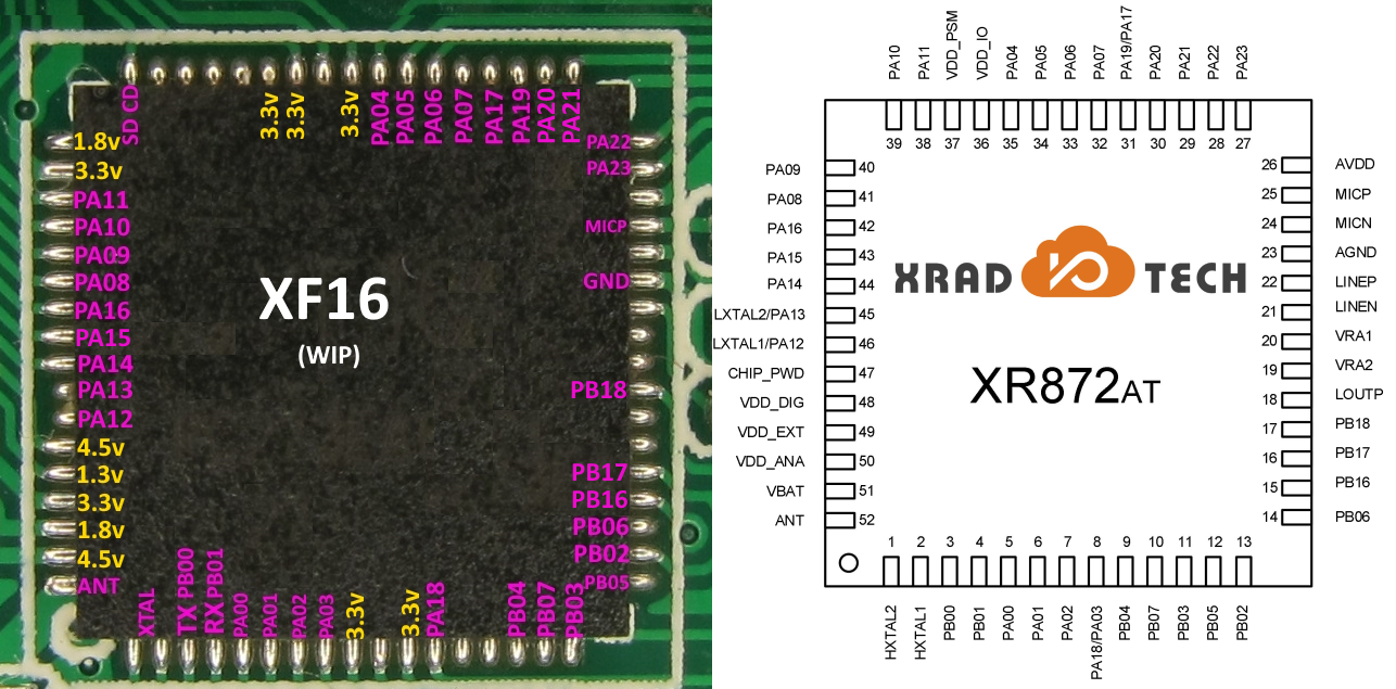

    Confirmed all GPIOs with new firmware that detects and prints when each one is pulled low. So the below is correct. XR872 for comparison.
    Comparison of XF16 chip and XR872AT pinout diagram from XRADIO

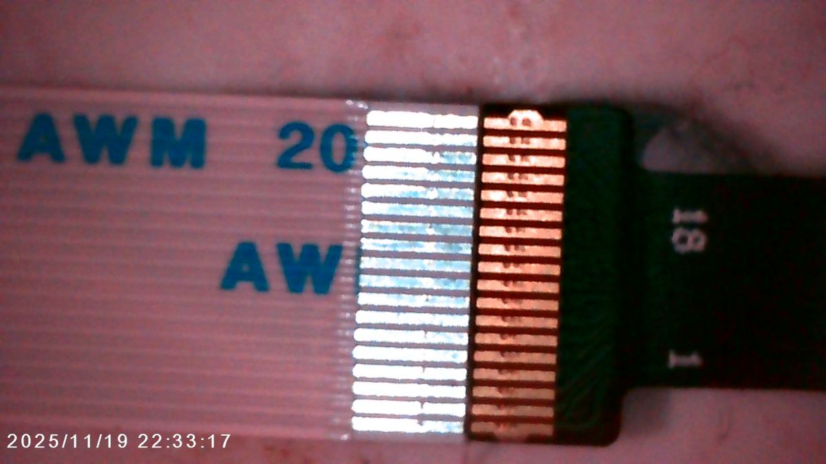

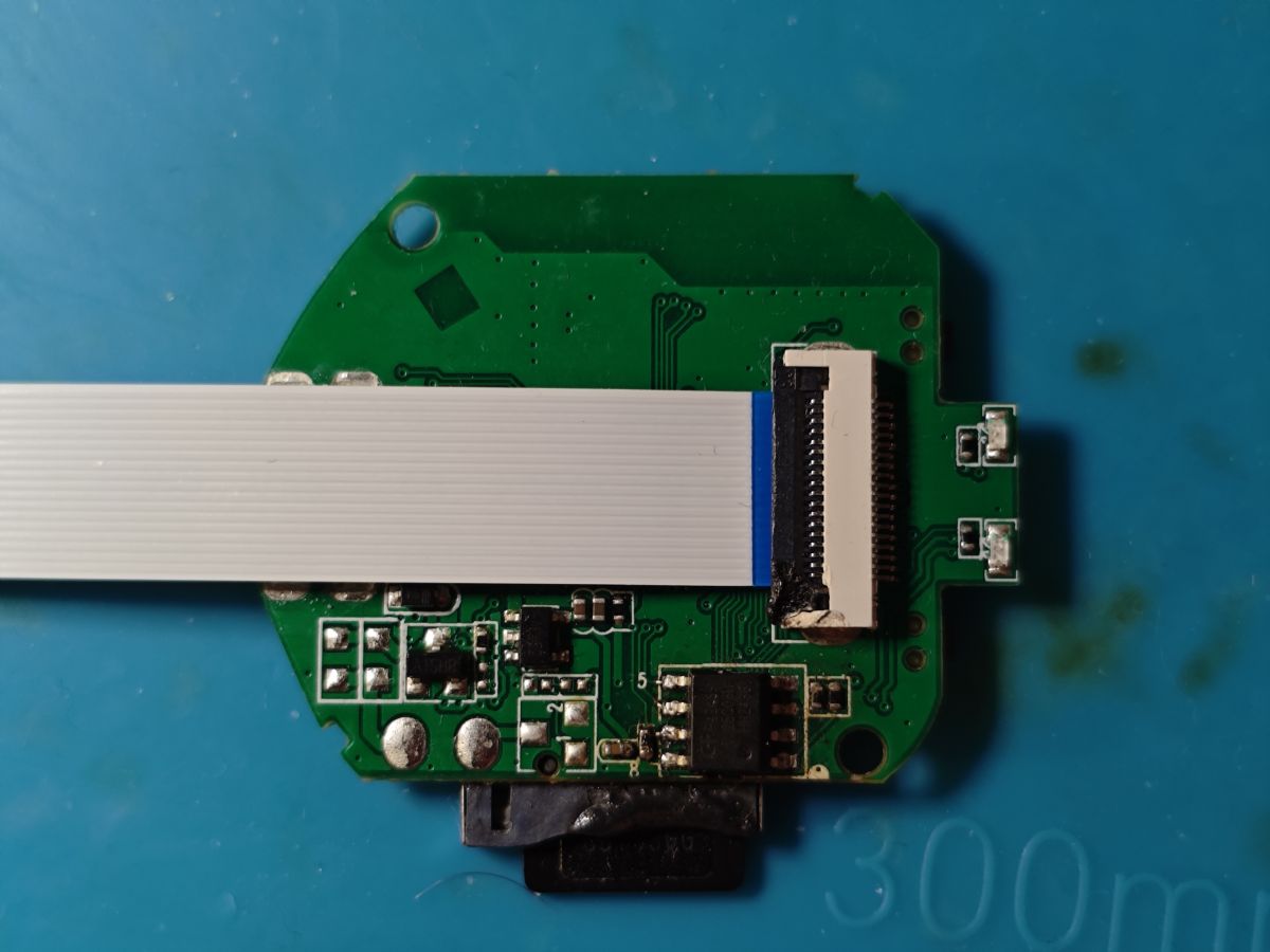

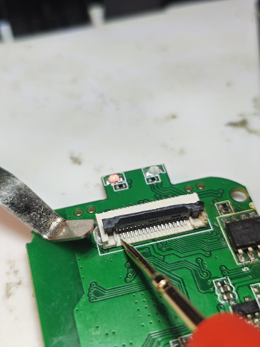

    the connectors on these cams and sensors appear to be standard 18-pin .5mm pitch FFC which can be used with various FFC connectors and ribbons from Ali
    Printed circuit board with flat ribbon cable connected, on blue background Close-up of FPC-18P 0.5 mm adapter with flat ribbon cable attached
    Close-up of AWM ribbon cable with exposed contact connector
    makes it even easier to confirm pins I guess. BK7252U48 next maybe

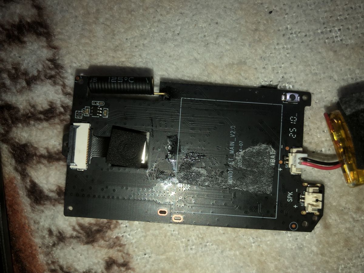

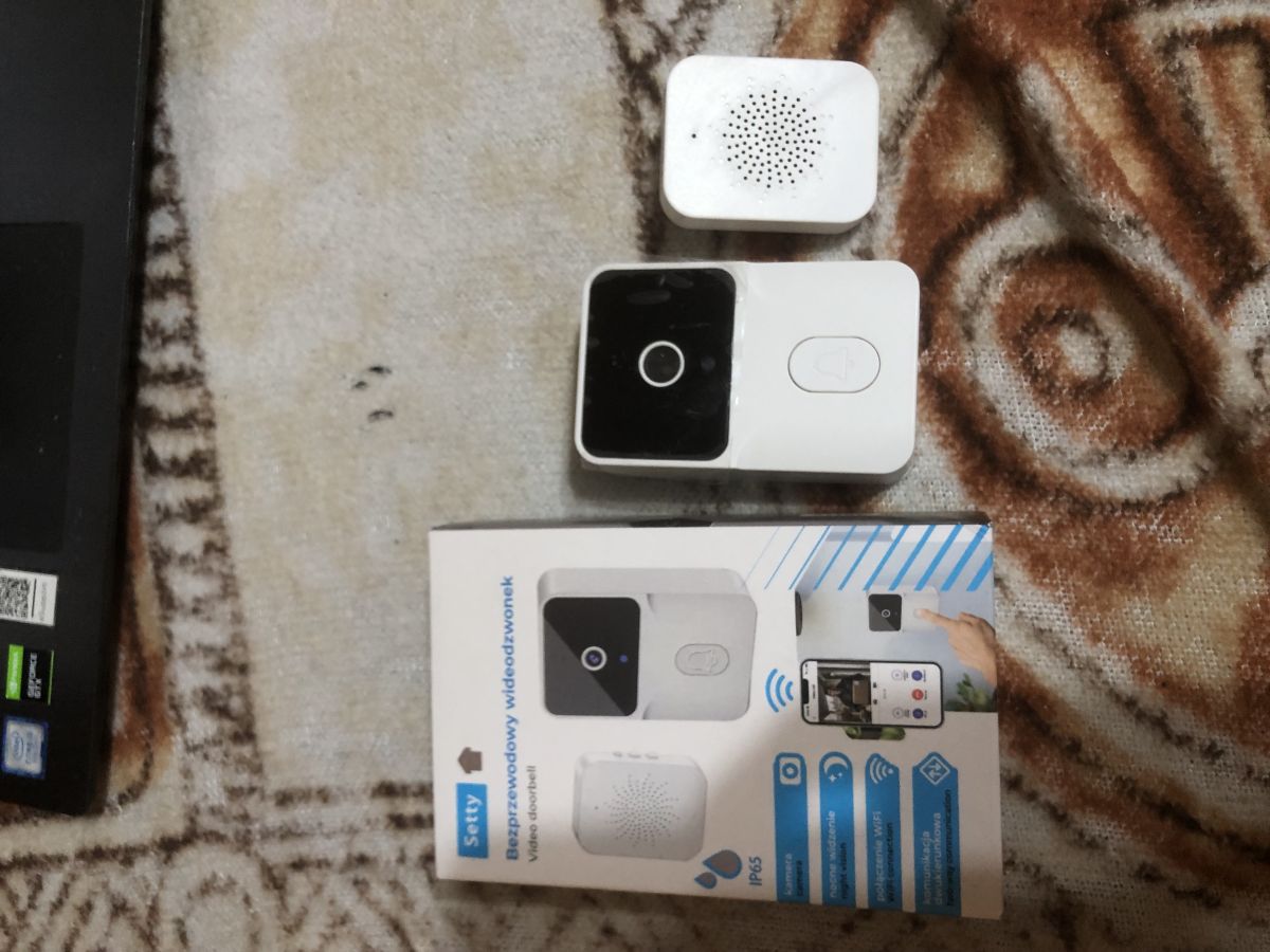

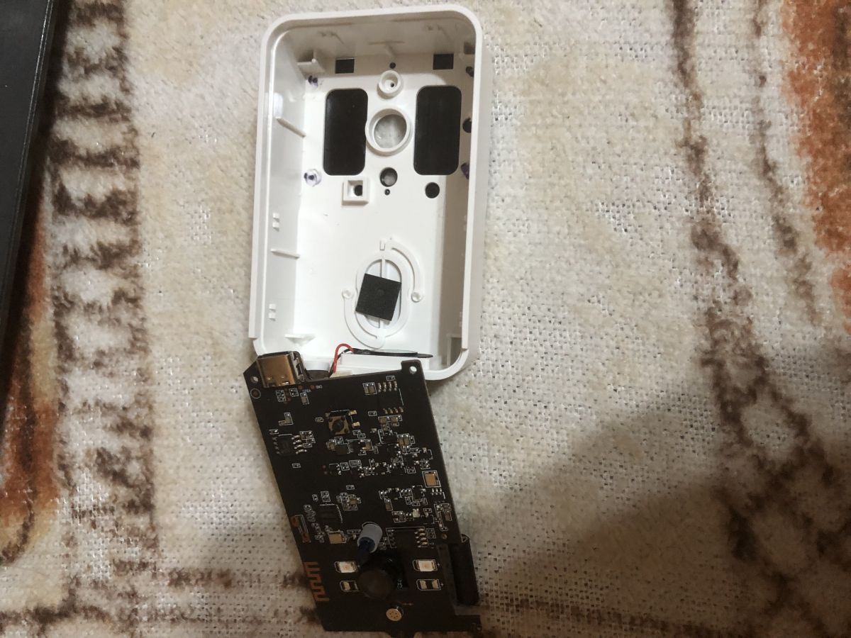

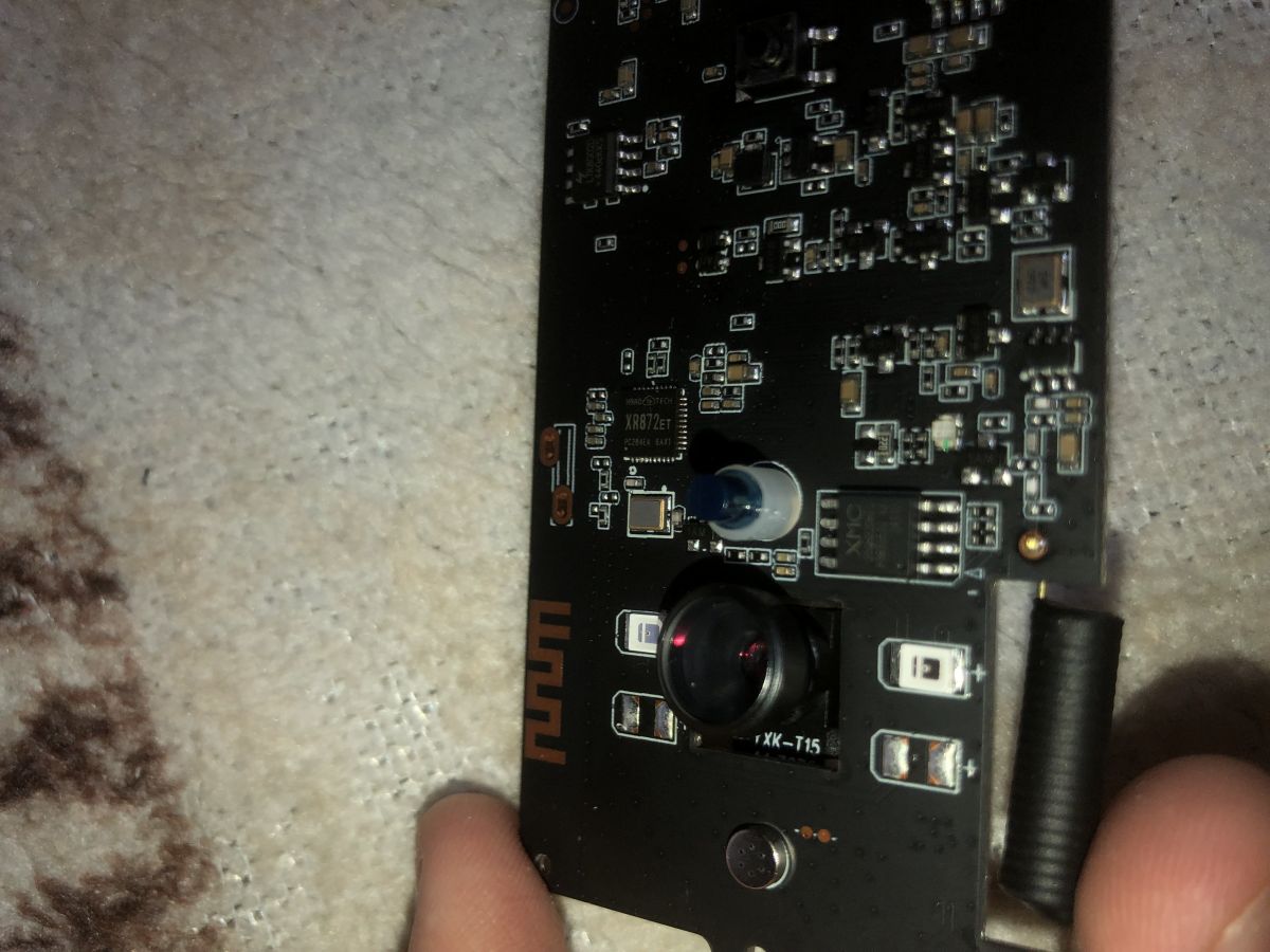

    mateusz6768
    >>21709811 Hmm, this looks familiar to my Setty wireless doorbell that I got in Biedronka not a while ago, as it has the same SoC and identical firmware that I could flash yours onto mine with no problems with booting and hardware functions as expected. If interested, I could also share the firmware dump of mine.
    Black PCB with connectors, wires, and a small battery on patterned fabric background Close-up of a black PCB with a camera lens, LED diodes, and a DC power jack on the right Black PCB with camera lens, LEDs and an antenna, held near a micro‑USB connector Disassembled device: white plastic case and black PCB with a USB port on patterned fabric Side of Setty package with specification list, barcode, and FSC label Wireless video doorbell set: camera unit, speaker receiver, and Setty box on a patterned carpet Device PCB with camera lens, USB-C port, and printed antenna pattern
  • #290 21847192
    Posts: 5027
    Help: 438
    Rate: 891
    sure thing.
    #291 21847257
    mateusz6768
    >>21847192 Here is the firmware dump of mine.
    • setty-video-doorbell.bin (4 MB) You must be logged in to download this attachment.

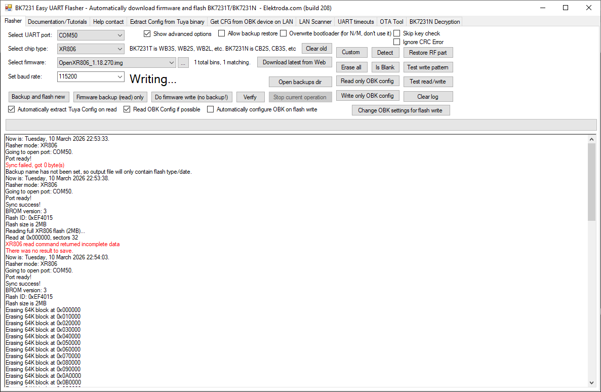

    Screenshot of BK7231 Easy UART Flasher showing “Writing...” and a console log of flashing actions.

    Oh, not bad, you're more advanced that I expected! Don't forget we also have Easy Flasher 2 - the web one.
  • #296 21859893
    Posts: 5027
    Help: 438
    Rate: 891
    just basic first-steps so far.
    indeed, but I got excited about XR in EF1 and couldn't help myself...
