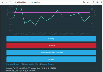

    jkwim wrote:
    One issue that I found when the chart is working is that the bottom part of the screen cannot be kept without scrolling back to chart window.
    Yes, I see what you mean.
    We will need to change the "redrawing". Actually the chart is destroyed and a new instance is created.
    I think I already have a solution, will open an PR soon and post it here.
    In my test I could change this to "update" the chart, which doesn't seem to refocus to the chart.
    Added after 1 [hours] 29 [minutes]:
    Please try the builds from PR #1389.
    For this does redrawing w/o setting the focus on the chart ...
    Web page with line chart and navigation buttons.
  • #62 21261957
    jkwim
    Posts: 186
    Rate: 25
    Will give it a try
    Thanks
    Added after 11 [hours] 32 [minutes]:
    Upgraded to OpenBK7231T_App_1389_merge_b1e0d8dd960f.
    It works fine now.
    Thanks for your quick update.

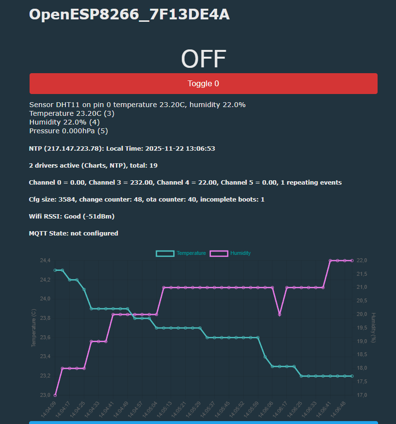

    @Zogdan interesting idea, if anyone is willing to give it a go I can accept PR.
    I've tested charts with ESP8266 and DHT11, works fine.
    OpenESP8266 dashboard with temperature and humidity charts
    Built on Nov 22 2025 13:00:05

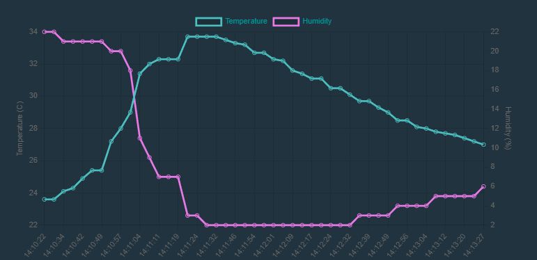

    Added after 5 [minutes]:
    Flashlight test (it heats up the sensor), then flashlight is removed:
    Line chart showing temperature and humidity changes over time
