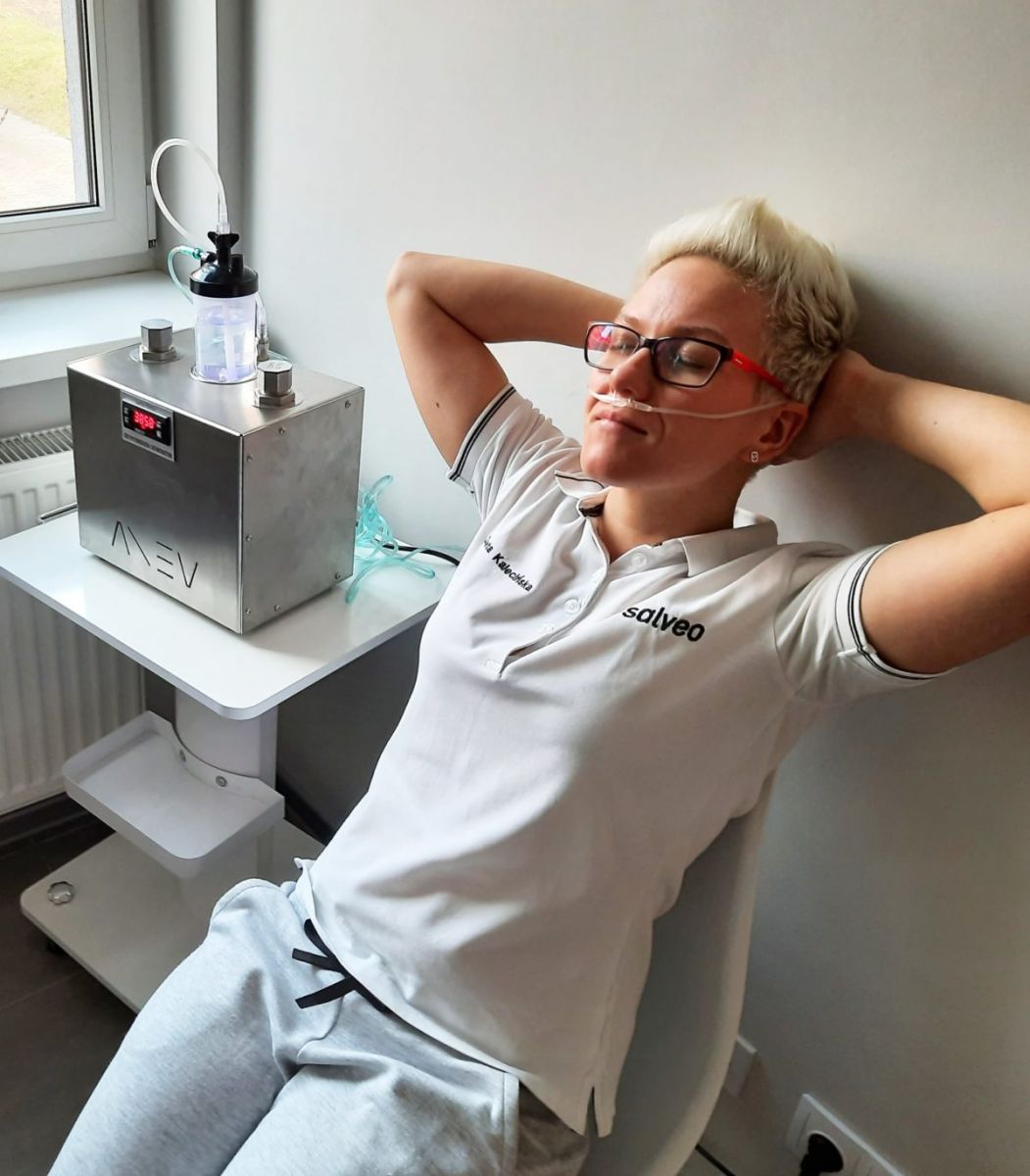

    Such inhalations are used in the Salveo dispensary (they have offices in Silesia). I do not know where they get the hydrogen from, but it is probably well purified. In the case of homemade methods, I would be afraid of radicals (supposedly they cleanse the body, but probably also the outside), strange ions in the air, organic pollutants or oxides from the electrodes.
    https://salveo-rudaslaska.pl/inhalacja-wodorem/

  • #37 21267039
    K3
    Level 30  
    Posts: 1684
    Help: 153
    Rate: 429
    >>21267006 .
    Company registered as physiotherapy and aesthetic medicine. A poor recommendation.
    And the hydrogen generator is the work of a tinsmith friend....
    Blonde woman sitting on a chair with nasal cannulas, connected to a device resembling a hydrogen generator.

    >>21267039 Yeah, from Czestochowa, after all, every tinsmith is wrecking such a site
    https://anev.com.pl/
    and issues CEs for their products
    Leaving aside the real efficacy, this colleague's comment seems very hasty, to say the least.

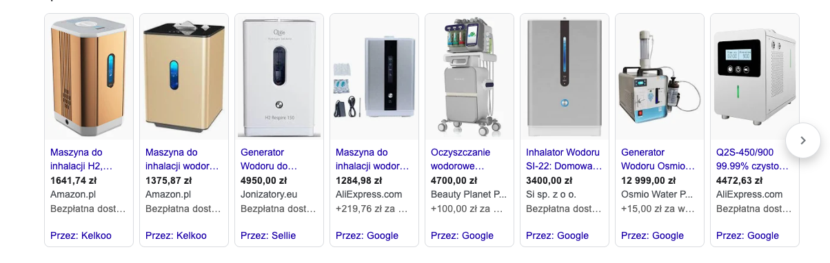

    The image shows various hydrogen inhalation devices available for online purchase. .
    Interesting, they make nice cash. No one is picking on them? But it's wrong with us that the user shows how it works and what's inside.
    Well that's the whole point of :) that's why I posted this post . I suspect that in those machines sold , the cheapest at 2k is much poorer than mine :)

    gulson wrote:
    But it's bad with us that the user shows how it works and what's inside.
    It's been a long time since a flock of lawmakers who, instead of substantively addressing the subjected issue, start droning on about whether the user has the authority to do something. And already prophetic visions of lungs exploding, filled with air with a homeopathic admixture of hydrogen - normally like in an American film. Where cars explode after any collision.
