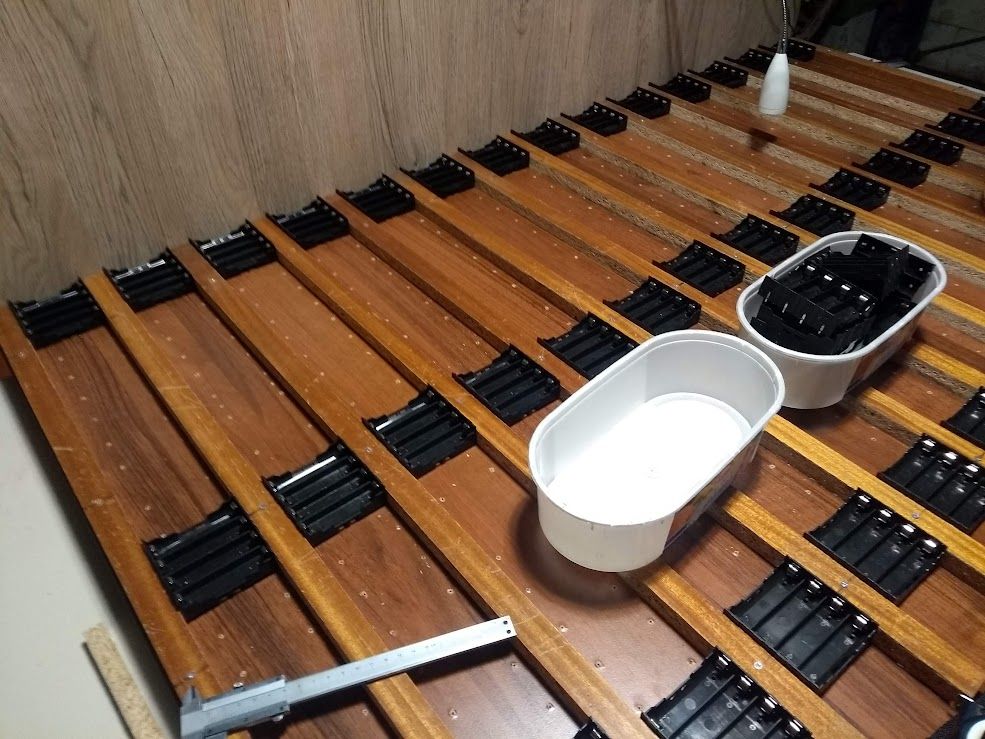

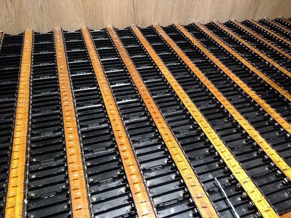

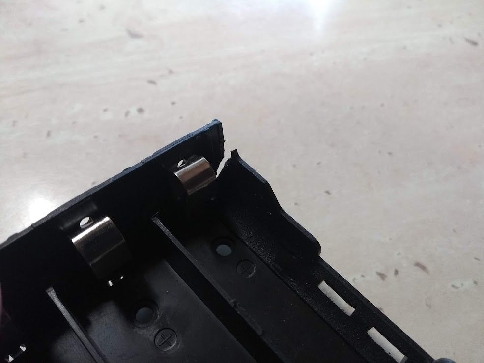

    Update, it's been over a month since the magazine completely paid for itself, so after a full financial 'blip', everything is now going to the upside.
    As befits an experimental magazine - the experiment continues - and the mothballing continues :)

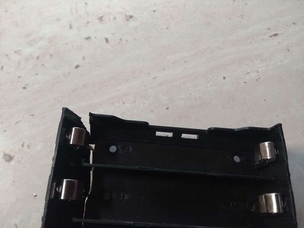

    Next news, sometime in March I noticed that some of the cell sockets from one batch started to crack after a while, so within two weeks (fortunately these were weeks of no sunshine at all) the storage unit was rebuilt to mechanically prevent this kind of malfunction in the future. The cracked sockets were replaced. The sockets that have the print on them are OK and nothing happens to them, but the ones from the Chinese supplier that don't have such prints and numbers - they started to break, so I LOSE to the quality of some Chinese stuff.
    Below are pics of how they break down and how I rebuilt the magazine (disassembling/disassembling it was one afternoon - I was surprised myself how quickly you can take something apart :) ) . This info would actually need to be added to the first post.
    Close-up of a damaged plastic battery holder for cylindrical cells, visible crack on the left side. Close-up of a cracked battery holder slot in a plastic cell holder. .
    Wooden energy storage frame with rows of black plastic battery holders, two white containers with additional connectors on the surface. Rows of black battery cells connected with copper busbars, arranged on a wooden background. .

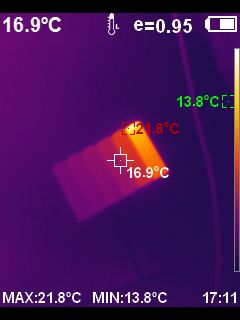

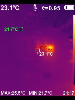

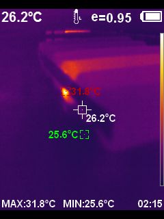

    By the way, I throw in an example of a cell caught during a periodic thermal imaging inspection, a point of higher temperature by 3 degrees relative to the background, a cell that got a slight leak (after removing the tee shirt, I found a tiny electrolyte leak, a droplet). There was still a long way to go before such a cell was destroyed, maybe 3-6 months, but the thermal imaging had already caught the "dude" early enough - the cell was of course replaced immediately (without shutting down the storage), service-wise the design works.
    Here the thought really comes to mind that if the factory packs were not sealed and people/users were able to check with thermal imaging, the number of different "accidents" could be significantly reduced.
    Thermal image of a battery cell with a local temperature rise up to 25.5°C against a background of about 23°C. Thermal image of a single cell showing a hot spot with a temperature of 21.8°C.

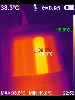

    partyzancik wrote:
    @remzibi and if the cells heat up when charging do you just blow it off? I have had sanyo cells heat up even when charging with tp4056 and I have thrown all the batteries with them in the scrap
    Yes, with a 700mA landing current, anything above 40 deg C drops out automatically, cells usually start to heat up when charged above 3.9V, charging of course I check with thermal imaging and not "finger" :) .
    Example photo of a thermo cell which will be discarded in a moment
    Thermal image showing three cells in a charger, one cell reaching 38.3°C.

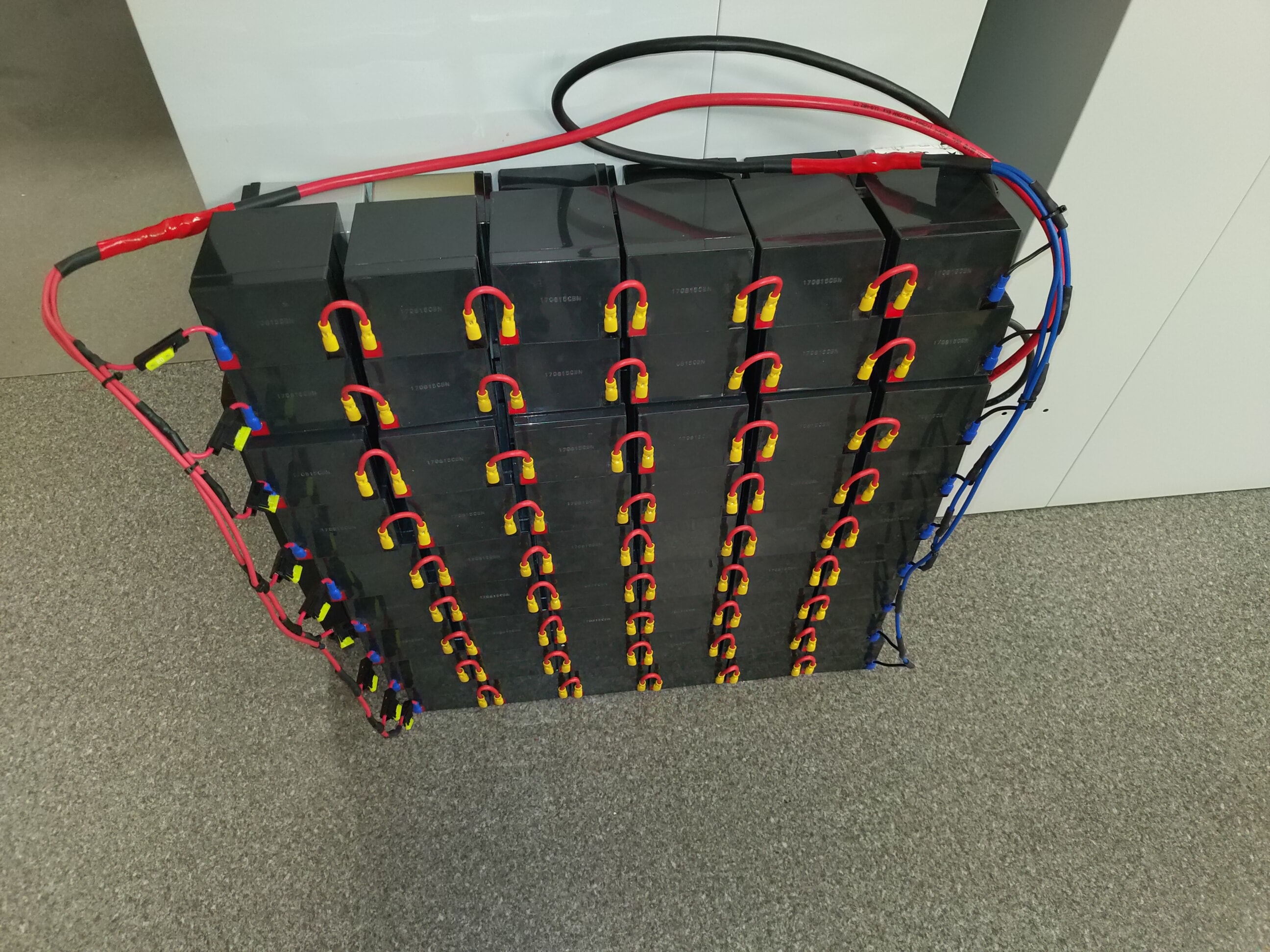

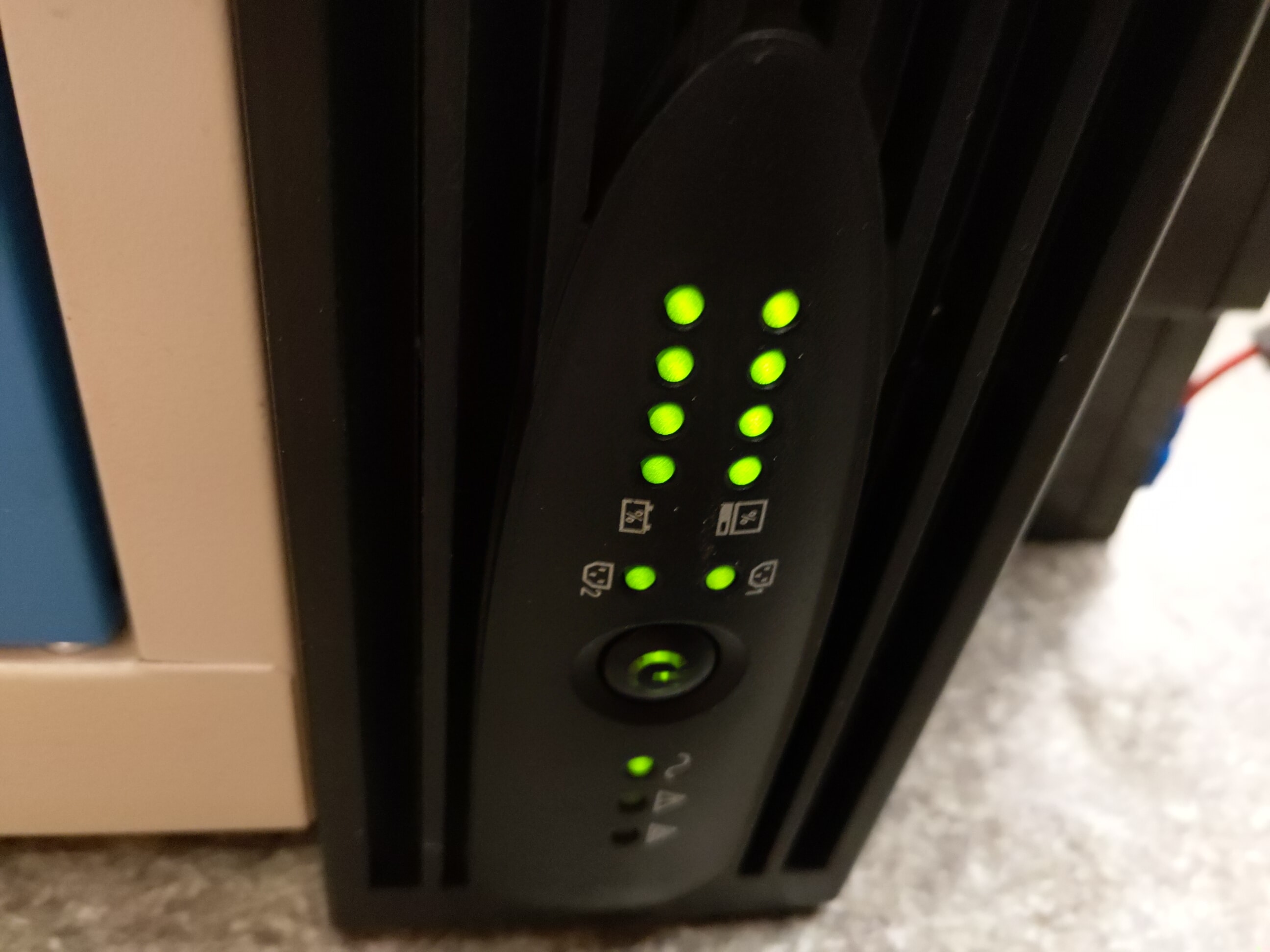

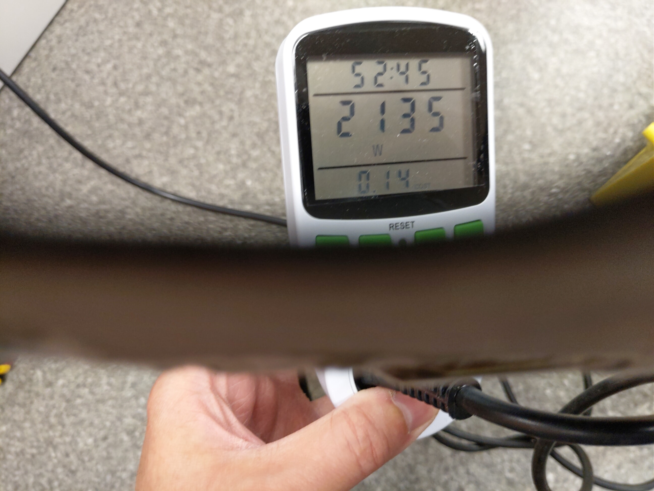

    I have built on popular gel batteries about 30-40Ah 82V. This works with an Eaton 2.5kW UPS, which is designed to connect external batteries in addition to the internal 9Ah battery.The 2100W Farelka test ran for about an hour.
    The UPS charging can cope with such a battery, but it charges everything with only 1.5 - 2 A. (long).

    A question from me, did a colleague do a battery test after loading the inverter with the maximum power i.e. 4KW without charging the PV panels at the same time? This would provide nice information (actual battery capacity and inverter efficiency).
  • #145 21596531
    remzibi
    Posts: 1393
    Help: 34
    Rate: 887
    robert123 wrote:
    Question from me, did a colleague do a battery test after loading the inverter with maximum power i.e. 4KW without simultaneous charging with PV panels? This would provide nice information (actual battery capacity and inverter efficiency).
    No, I did not do typical measurement tests under load.
    On the other hand, yes, it happened to load the installation with up to 4.5kW for a short time, everything worked, but detailed measurement data - no.

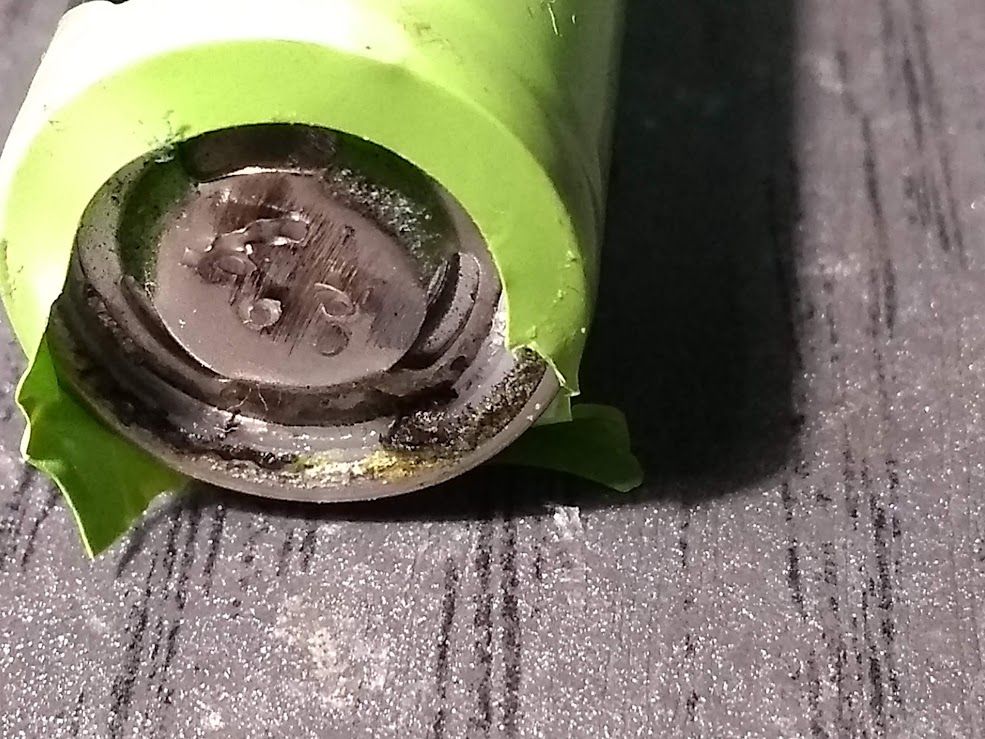

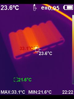

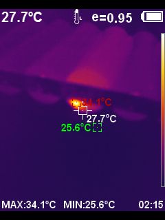

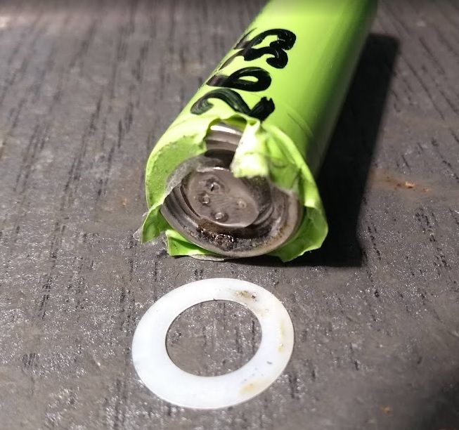

    ....... As befits an experimental magazine - the experiment continues - and the mania continues :) .........
    Update, it's been a productive year for the magazine, when did it fly by ? :) .
    A recent monthly thermal imaging check caught two cells, cause the same - cell leak,
    one cell caught and immediately replaced a month ago
    Thermal image of battery cells, one cell displaying significantly higher temperature Damaged 18650 lithium-ion cell with torn top and signs of overheating .
    and the other one caught recently, also immediately replaced
    Thermal image showing one overheated battery cell with a temperature of 34.1°C Thermal image of a battery cell with a hotspot reaching 31.8°C .
    Damaged green cylindrical cell with visible leakage and corrosion on the positive terminal .
    apart from these two "bugs", everything works fine and as intended.
    It is worth adding that these changes, are absolutely not catchable by means of voltage observations on the sections in the BMS application, temperature sensors from the BMS or other methods, only thermal imaging inspection gives the desired diagnostic results unequivocally and immediately.
    The bottom line is that all those who pin their hopes on the reliable operation of their factory stock (any Li-Ion or LiFePo4) because they think they have temperature sensors from the BMS spread across the cases - I'm afraid this is a very illusory feeling, and yet these sensors are just crap and are there - because they are there, they will show an alarm/fire when it's already too late.
    Even more so, my conviction grows that regular thermal imaging checks of the energy stores are simply essential, preferably without having to dismantle the enclosure for this activity every time, or at least without it being too time- and labour-intensive.
    As befits an experimental storage facility - the experiment continues - and continues :) .

  • Konfiguracja magazynu to 14S, 48 V, docelowo 40 stringów po 6 ogniw; początkowo miał ok. 12 kWh, później ok. 20 kWh, a pełna wersja ma przekroczyć 24 kWh. [#21276258]

  • Autor odrzuca ogniwa, które przy ładowaniu 700 mA przekraczają 40°C; podczas eksploatacji typowy prąd na ogniwo wynosi ok. 250–350 mA, a po pełnym zapełnieniu ma spaść do 150–250 mA. [#21565641]
  • Do kontroli termicznej użyto kamery HT18+, spotykanej też jako GW256; praktyka z wątku pokazuje, że termowizja wykryła punkt gorętszy o 3°C i dwa wycieki ogniw, których nie pokazały sekcyjne odczyty BMS. [#21637020]

Budujesz go jako stojący, rozbudowywalny magazyn 14S 48 V z równoległymi modułami dodawanymi etapami. Autor zrobił ramę przez około 3 tygodnie, użył koszyków na ogniwa, zgrzewanych połączeń, bezpieczników 4 A na stringach i hybrydowego falownika 5,5 kW. Docelowa architektura to 40 stringów po 6 ogniw, czyli układ nastawiony bardziej na pojemność i niski prąd na celę niż na maksymalną moc chwilową. Kluczowe są testy odzyskanych ogniw, selekcja temperaturą i termowizją oraz BMS z balansowaniem. [#21276258]
What is a Paragon-class battery storage design, and why do DIY builders choose it for expandable 18650 packs?
Magazyn klasy Paragon to otwarta, modułowa konstrukcja 18650 inspirowana rozwiązaniem popularyzowanym przez Leszka Kwitka, która ułatwia dokładanie ogniw i serwis bez wyłączania całego systemu. Autor wybrał ten styl właśnie dlatego, że można dodawać sekcje online, wymieniać wadliwe cele w pracującym magazynie i rozłożyć inwestycję w czasie. To ma znaczenie przy odzysku, bo napływ dobrych ogniw jest nieregularny, a pojemność rośnie etapami od ok. 12 kWh do ponad 24 kWh. [#21278484]
How are the cells arranged and connected in this 14S 48V pack, and how is the JK BMS wired to the storage?
Ogniwa są połączone jako 14 sekcji szeregowych, a każda sekcja docelowo ma 40 równoległych stringów po 6 ogniw. Autor podał schemat połączeń do JK BMS 20S z balanserem 1 A, a sam magazyn pracuje jako 14S 48 V. BMS mierzy napięcia sekcji, temperatury i steruje balansowaniem, natomiast ładowanie realizuje falownik hybrydowy w trybie CC/CV. W praktyce autor dobierał stringi pod pojemność i rezystancję wewnętrzną, a środkowe 8 stringów dostało podwójne bezpieczniki 8 A. [#21277727]

What is the CID fuse inside an 18650 cell, and how does it affect safety if a cell starts failing or shorting internally?
„CID” jest wewnętrznym bezpiecznikiem ciśnieniowym w ogniwie 18650, który odłącza celę, gdy awaria powoduje wzrost ciśnienia lub nieprawidłową pracę, zmniejszając ryzyko dalszego zasilania uszkodzonego ogniwa. Autor wyjaśnił, że jeśli cela nagle zaczęłaby zwierać, najpierw powinien zadziałać właśnie CID. Jeśli nie zadziała, pozostałe ogniwa rozładują wadliwy pakiet, a potem ma zadziałać zewnętrzny bezpiecznik stringu. To nie eliminuje ryzyka, ale dodaje warstwę ochrony przy lokalnej awarii celi. [#21276258]
How does thermal imaging help detect leaking or overheating 18650 cells earlier than BMS temperature sensors in a battery storage wall?
Termowizja wykrywa pojedyncze anomalie cieplne na konkretnej celi, zanim pokażą je czujniki rozmieszczone w magazynie. Autor podał przykład ogniwa z punktem cieplejszym o 3°C względem tła; po zdjęciu koszulki znalazł mały wyciek elektrolitu i od razu wymienił celę bez wyłączania magazynu. W sierpniu 2025 opisał też dwa kolejne wycieki złapane miesięczną kontrolą termowizyjną, których nie było widać po napięciach sekcji ani po czujnikach BMS. To główny argument za regularną inspekcją całej ściany ogniw. [#21636483]
Which thermal imaging camera model was used for inspecting the battery pack, and what should you look for when choosing one for cell diagnostics?
Autor używa kamery HT18+, występującej też pod nazwą GW256. Do diagnostyki ogniw liczy się nie marketingowy opis, lecz możliwość szybkiego wychwycenia lokalnych odchyleń temperatury na pojedynczych celach i wygodna kontrola całego magazynu bez rozbierania go. W tym wątku kamera miała wykrywać nawet niewielkie różnice i służyła do okresowych przeglądów, które zastąpiły żmudne kontrole mechaniczne. To narzędzie serwisowe, nie gadżet, bo pozwala wychwycić uszkodzoną celę miesiące wcześniej. [#21637020]
What problems can cracked 18650 holders from cheap Chinese suppliers cause, and how can the rack be rebuilt to prevent this failure?
Pękające koszyki mogą osłabić podparcie ogniw i wymusić przebudowę całego magazynu. Autor zauważył w marcu pękanie części uchwytów z jednej partii; problem dotyczył nieoznaczonych koszyków od chińskiego dostawcy, podczas gdy wersje z nadrukami były stabilne. W ciągu dwóch tygodni rozebrał i przebudował magazyn tak, by mechanicznie wyeliminować to miejsce awarii, a uszkodzone uchwyty wymienił. Później doprecyzował, że zbudowanie podstawy z prowadnicami pod koszyki dodatkowo ogranicza ich pękanie. [#21565641]
