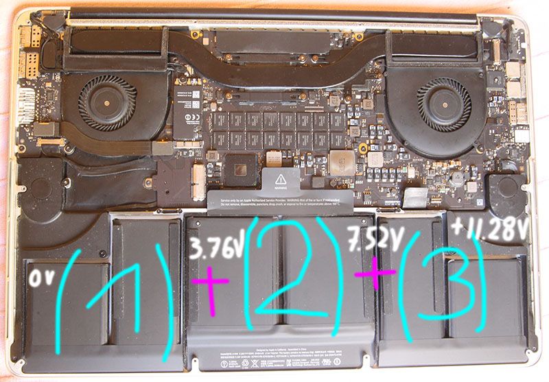

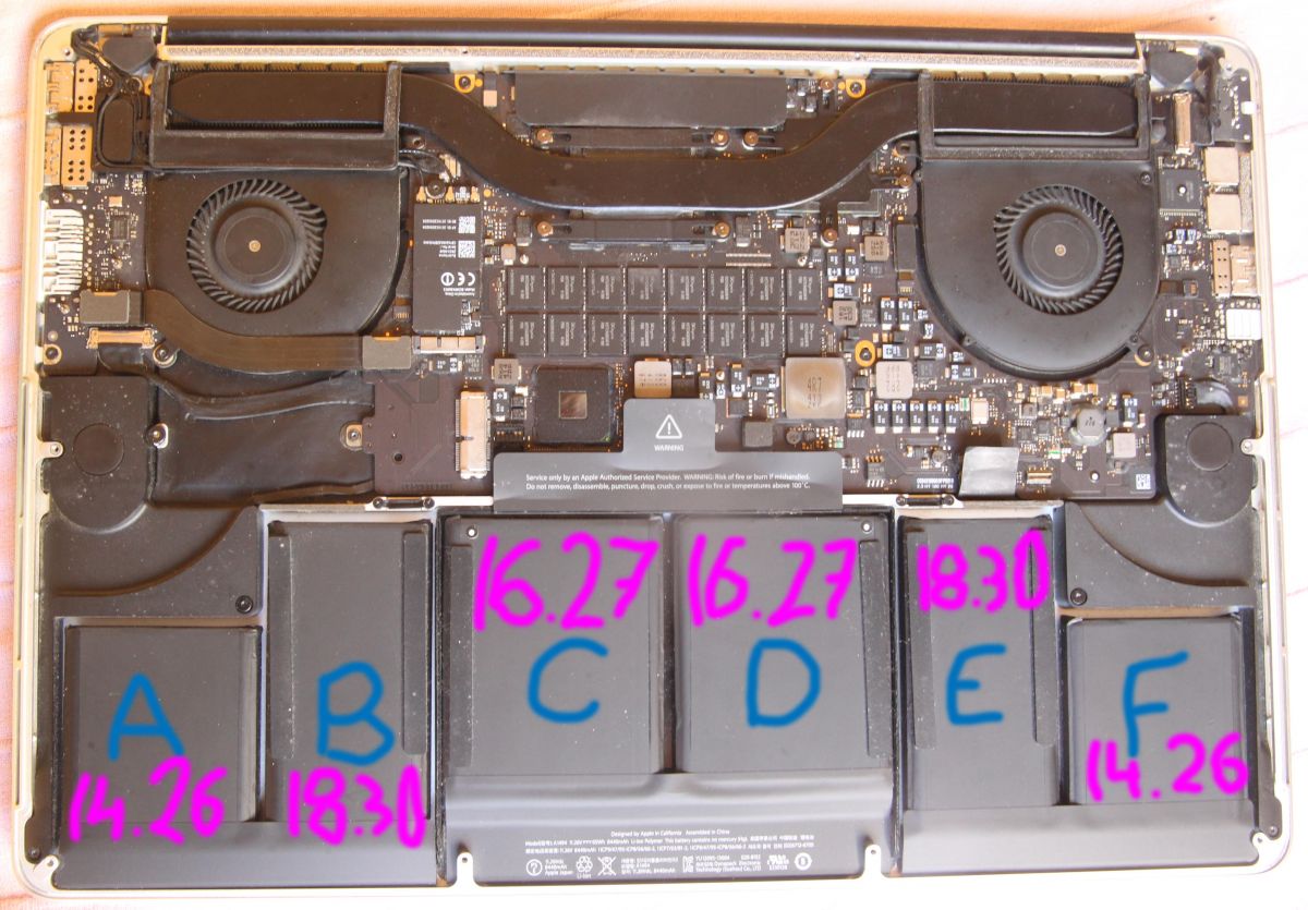

    Rate: 10
    View of an open laptop with visible battery cells labeled as A, B, C, D, E, and F with given capacities. .
    A little off topic in relation to link linking.
    Question-interest how are the battery cells connected in the photo? For ease of reference, the cell capacity is given .
  • #44 21278572

    jonex21 wrote:
    Question-interest how are the battery cells connected in the photo? For ease of reference it is given cell capacity .
    What, you don't have a meter and a question for the clairvoyants? :) .
    Measure and write us, we'll know too. To make it easier we are not going anywhere :) .
  • #47 21279041
    jonex21
    Posts: 18
    Rate: 10
    remzibi wrote:
    ... And what, you don't have a meter and a question for the clairvoyants? :) ...
    Sorry, but my question was misunderstood ;) I know exactly the answer :) .
    From the discussion in other posts there was some confusion :( By asking such a question I wanted to show that you don't always have to use the same ( capacity ) cells to make a battery. The only thing to remember is that the capacity of the cell in parallel connection should be the same as the other cells connected in series and the type of cell should be the same.
    Interior of an open laptop with labeled battery configuration and capacities. .

    jonex21 wrote:
    .... The only thing to remember is that the capacity of the cell in parallel connection should be the same as the other cells connected in series and the cell type should be the same......
    Well, and a good example, the "Apple style" cells :) .
