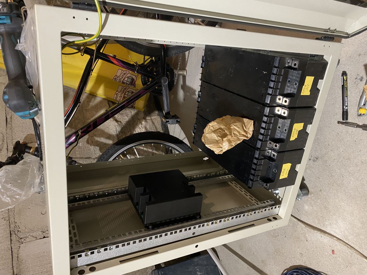

    p.obelix
    Refrigeration equipment specialist
    Posts: 1995
    Help: 215
    Rate: 558
    Energy storage enclosure under construction with visible components and batteries. .
    Such a small snapshot of the construction of my energy storage. Admittedly I'm using off-the-shelf components but there's plenty to do. The main thing is to plan it well.
