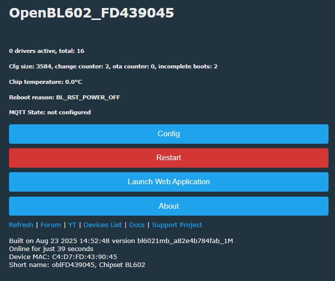

  • Enabled 1 MB flash config by default
    #129 21646003
    Posts: 5220
    Help: 449
    Rate: 918
    insmod wrote:
    Enabled 1M config by default (it works fine on 4mb module).
    thanks.
    bl602_ir_9f263cba4454
    https://github.com/NonPIayerCharacter/OpenBK7231T_App/actions/runs/17263341611
    1mb module. miegapele 1mb toml

    OpenBL602, version bl602_ir_9f263cba4454
    Entering initLog()...
    Commands registered!
    initLog() done!
    [MTD] >>>>>> Hanlde info Dump >>>>>>
    name PSM
    id 0
    offset 0x000e9000(954368)
    size 0x00008000(32Kbytes)
    xip_addr 0x230d8000
    [MTD] <<<<<< Hanlde info End <<<<<<
    [EF] Found Valid PSM partition, XIP Addr 230d8000, flash addr 000e9000, size 32768
    ENV AREA SIZE 32768, SECTOR NUM 8
    *default_env_size = 0x00000001
    EasyFlash V4.0.99 is initialize success.
    You can get the latest version on https://github.com/armink/EasyFlash .

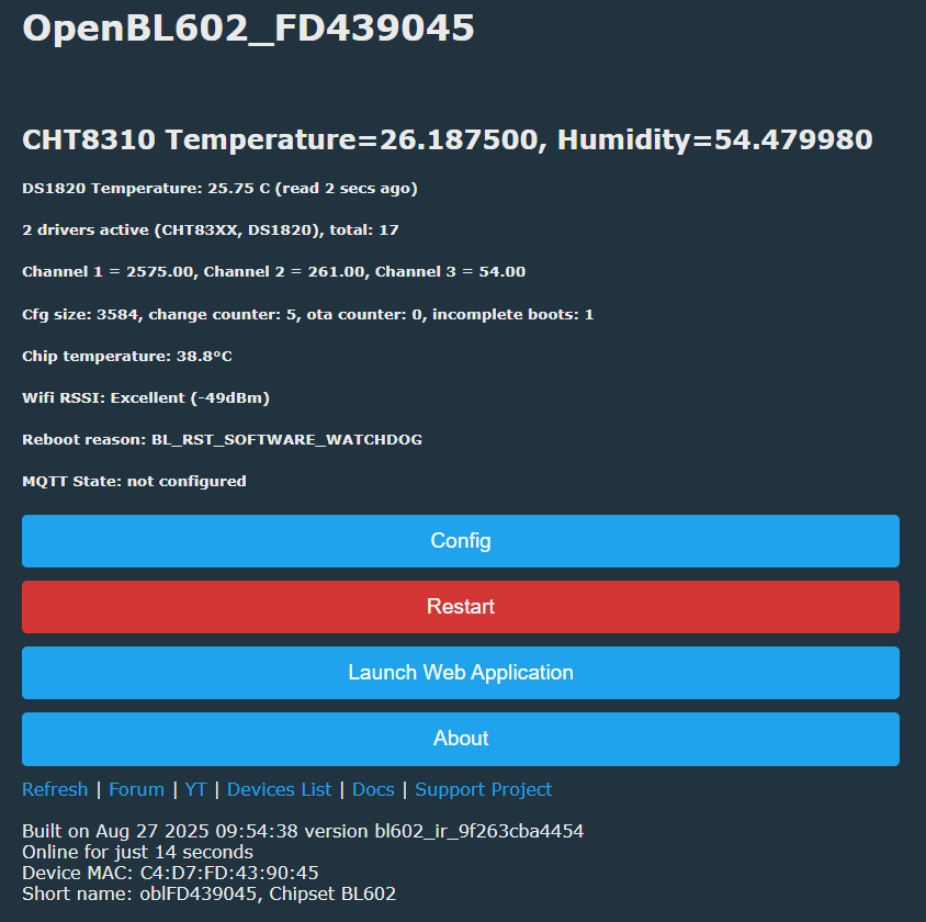

    DS1820 and CHT8310 OK
    OpenBL602 web interface showing sensor temperature, humidity, and diagnostics
    Fake Prolific TTL adapter likely killed the module

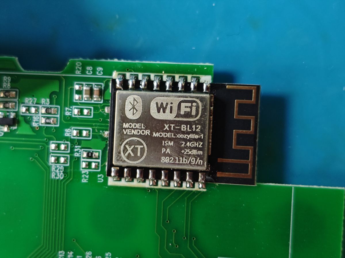

    PCB board with ESP8266 Wi-Fi module and various electronic components WiFi and Bluetooth communication module XT-BL12 on a green PCB Black rectangular touch panel with a centered circle, covered in protective film Green box with product label DS-1211AN-BLACK-01 and barcode
