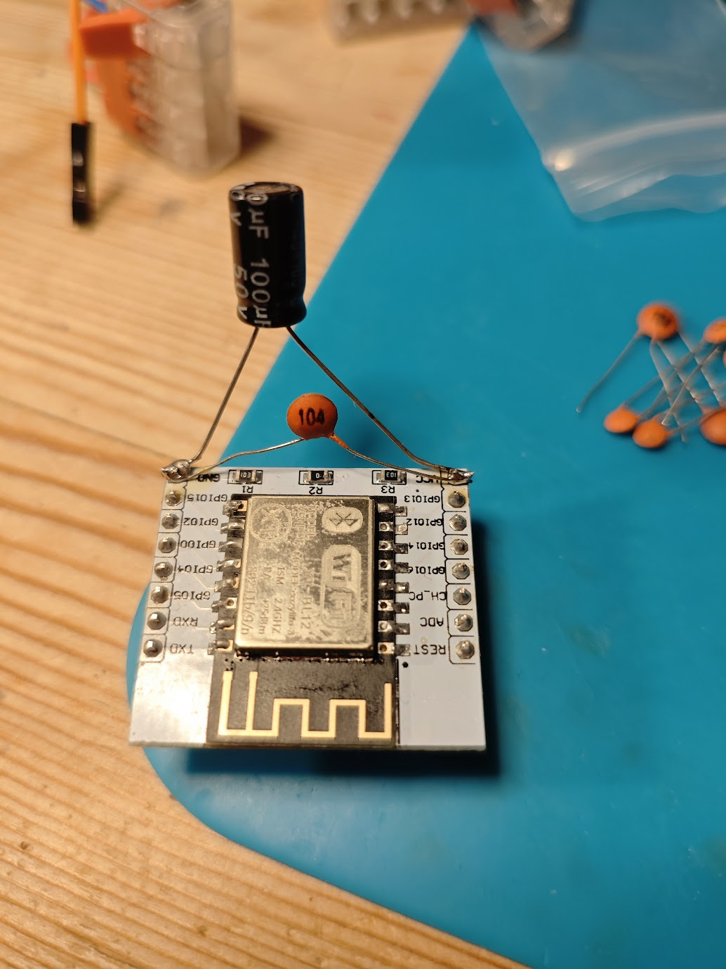

  • Need 100 nF decoupling and 10–100 Ω series resistor
    #37 21435172
    Posts: 5220
    Help: 449
    Rate: 918
    I have been distracted with my apparent power problem with this module, so have not progressed in testing. I have been adding capacitors in an attempt to get it stable. No stability even at 3.6v.
    Would be good to have someone else try a 1MB device. Or I could solder back into original DS-1211AN I suppose.
    Ideally, it'd be operational test module. My multimeter doesn't have a capacitance test mode. @p.kaczmarek2 said try 100nF but I've only found 100uF in my collection so far. Have been also using 22pF in parallel with 100uF test.
    Electronic module with a soldered capacitor on a wooden surface.
    I also note this at the end of the XT-BL12 doc http://download.bl602.fun/XT-BL12_User_Manual.pdf

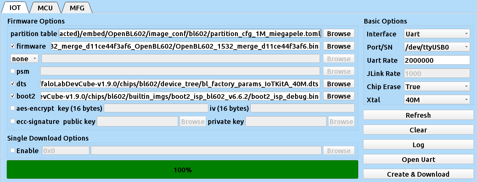

    you've definitely flashed OpenBL602_1532_merge_d11ce44f3af6.bin from the attached?
    • OpenBK7231T_App_1532_merge_d11ce44f3af6_OpenBL602.zip (1.71 MB) You must be logged in to download this attachment.
  • Boot loop with partition table shown in BL602 log
    #44 21435975
    maxim2002
    Posts: 46
    Rate: 12
    No, I've compiled it myself. Will give it a go and lyk, thanks for the bin.

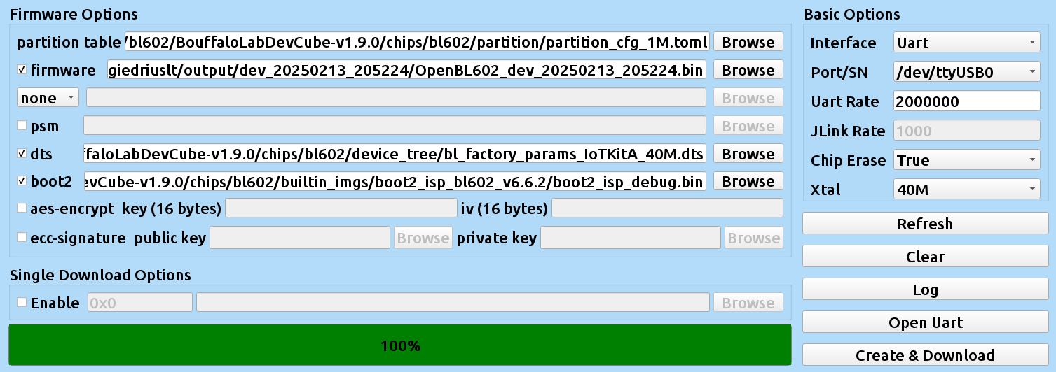

    Firmware options configuration panel for BL602
    ... it has partition table at the top of the log.

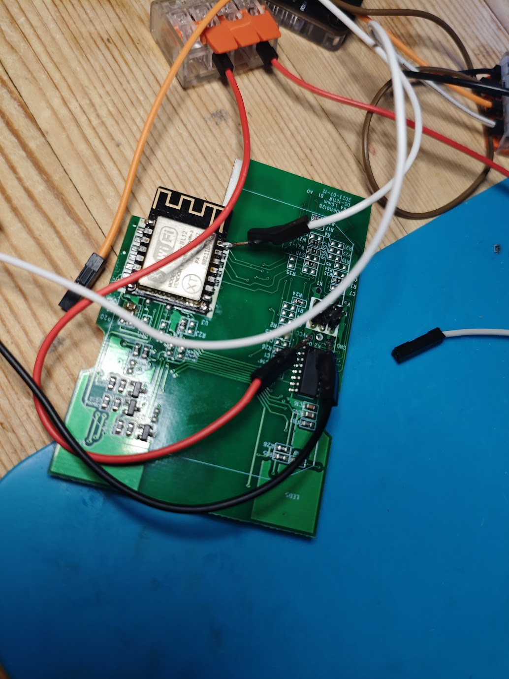

    My module is back in original device where 3.3v through test pad provides necessary stability through capacitors /resistors I do not have separately to get module stable on its own. So, ready for testing requests.
  • #47 21436902
    maxim2002
    Posts: 46
    Rate: 12
    You are right! It's stable when ground connected closer to the board. Thank you.

    Posts: 5220
    Help: 449
    Rate: 918
    >>21436902
    this is interesting. I didn't consider making ground shorter.

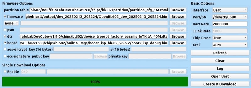

    Firmware configuration interface for BL602 with options for partition table, firmware, and other settings.
    PSM 0x000e9000
    PSM 0x000f9000
    Added after 9 [minutes]:
    Not sure if that the correct place, but if this BL602L10 is actually 1MB, why the sdk/OpenBL602/components/platform/soc/bl602/bl602/evb/ld/flash.ld has this ?
    I've went through couple of articles from this guy https://lupyuen.github.io/ but it just convinced me to grab some books ;)

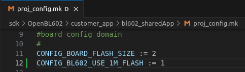

  • #56 21438497
    maxim2002
    Posts: 46
    Rate: 12
    Nope, freezes. Unless sdk/OpenBL602/customer_app/bl602_sharedApp/proj_config.mk isn't the correct place for that.

    Apparently each time when rebuilding we also need to run ./sdk/OpenBL602/clean script, noted that build date wasn't changed...
    So this config is a GO!!!
    CONFIG_BL602_USE_1M_FLASH := 1
    CONFIG_BL602_USE_ROM_DRIVER:=1
    We have it running, yey!
    Worked also with CONFIG_BL602_USE_ROM_DRIVER:=0, so the CONFIG_BL602_USE_1M_FLASH is what we where after.
