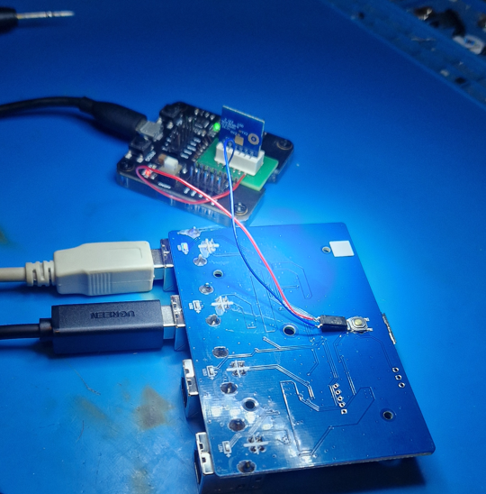

    So, let's start with basic requirements. What do we need to do to simulate a button press?
    - we need to add our WiFi module to hub and power it, but USB is 5V, and WiFi module uses 3.3V, so we will need a step down converter or LDO regulator
    - we need to send a short pulse to a button (short it to ground), for like 0.5 second, so we will need to script OBK for that

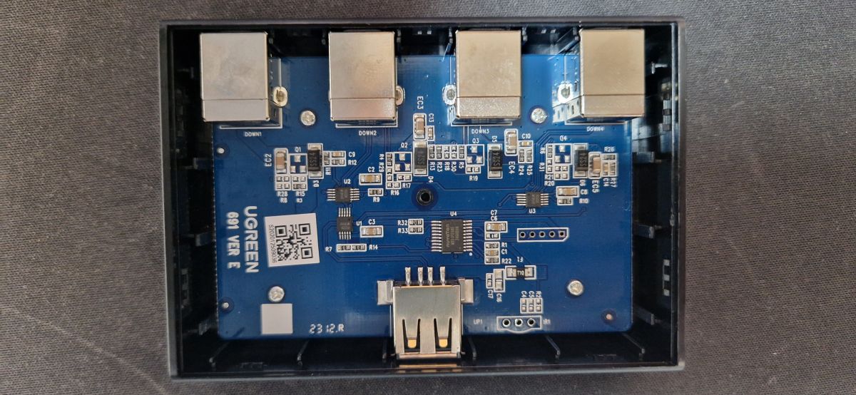

    Let's start with looking into our switch. There is a single button that when held, shorts the Nuvoton MCU pin to ground:
    Electronic layout of the Ugreen 30346 USB switch with visible components and USB ports.
    The pin is pulled high by default. We can connect it to our WiFi module GPIO directly in most cases. If you need to have isolation, use optocoupler. Here is a photo showing it during testing phrase with our dev board:;
    Image of a module with a circuit board and cables for testing.

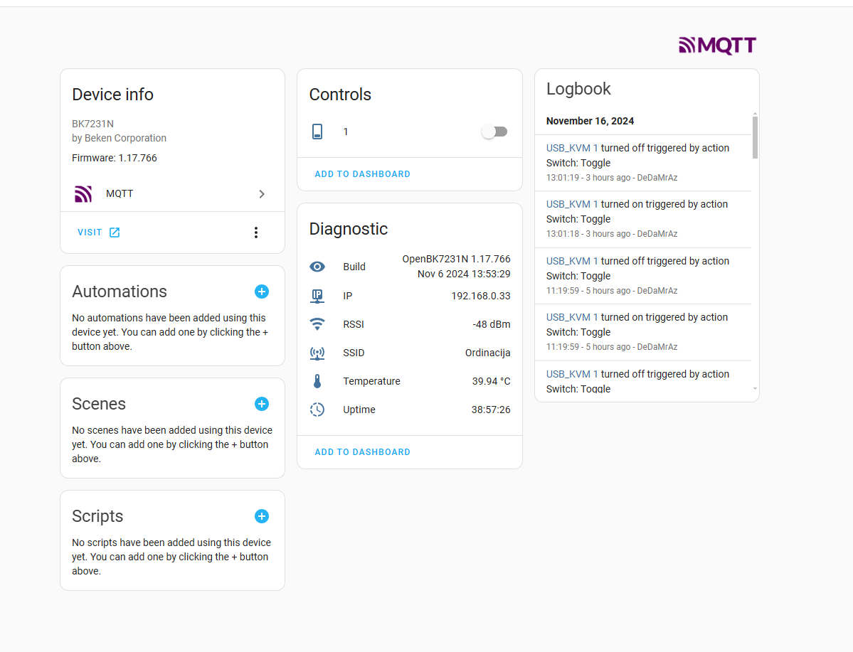

    In order to keep the pin high by default, we've used Rel_n role, because Rel_n is active-low, while simply Rel is active-high in OBK. Here is OBK config:
    In order to make the pin return to high state after half a second, we've also added a short autoexec.bat script.
    // 0.5 is delay in seconds, 1 is number of repeats - once
    addChangeHandler Channel1 == 1 addRepeatingEvent 0.5 1 setChannel 1 0
    The following is enough to control it via Home Assistant, just do HASS Discovery and you'll get:
    Screenshot of the MQTT user interface for the BK7231N device, showing controls, diagnostic information, and event log.
    Let's test it - observe the LED moving between ports, it marks active port:

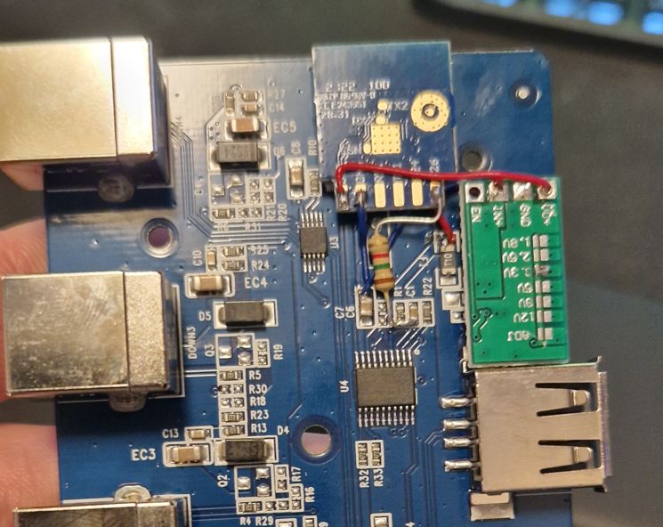

    It's a very cheap and little device that can be useful for many projects. Aparat from that, no other external parts are required by WiFi module like CB2S or WB2S, it works out of the box, but it's good to add some decoupling capacitors as well:
    Photo showing a circuit board with electronic modules and a resistor on a wire.
    Resistor on the photo is the pull up, it may not be necessary, as Beken has internal pull-ups on GPIOs.
