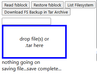

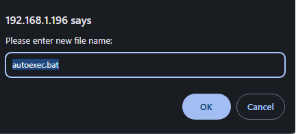

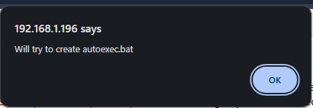

    Basically I have this MagicHome RGBW LED Controller Flashed with OBK version 1.17.777. I am trying to create an autoexec.bat file for LED scheduling purposes. But when I try to create these shows in the logs:
    Error:LFS:LFS media partition position 0x190000 while expected is 0x192000
    I know that LFS is now supported for BL602. Am I doing something wrong? Thanks in advance :) I've attached some images when trying to create bat file.
    Screenshot from a web browser showing a dialog box for creating a new file named autoexec.bat.
    Browser message with IP address 192.168.1.196 indicating an attempt to create an autoexec.bat file.

    AI: Could you please describe the steps you took to create the autoexec.bat file? This will help us understand if there might be an issue in the process.
    Going into the webapp and the Filesystem tab as usual.
    AI: What operating system and tools are you using to work with the MagicHome RGBW LED Controller? This info might help in troubleshooting the error.
    Nothing special, just using the stock OpenBeken Firmware.

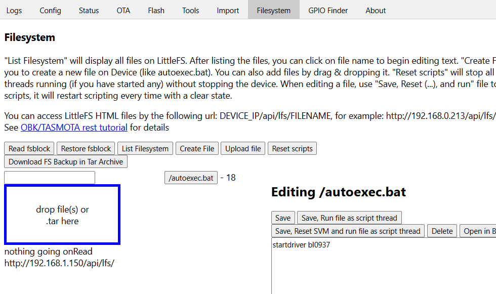

    that is an option, assuming 1.4.8 is OK with the flash ID of your particular BL602. You'll need to use 1.4.8 (or modify the partition_cfg_2M.toml file in the latest BLDC to match the older partition layout) to get the layout needed to get LFS support and be able to OTA to future OpenBK releases.

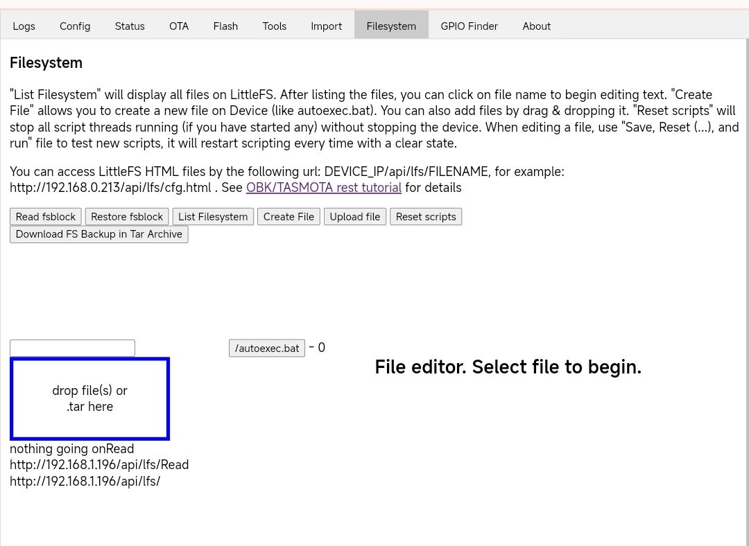

    However, I have been playing with the LFS addresses in src/littlefs/our_lfs.h - https://github.com/openshwprojects/OpenBK7231T_App/pull/1444/files
    and my GRB MagicHome test is now able to create an autoexec.bat file with the result of that PR.
    Screenshot of the LittleFS file system editor in the OpenBK application.
    I attach the OTA file for you to try. This does mean you'd lose this function if you OTA upgrade to any general release firmwares

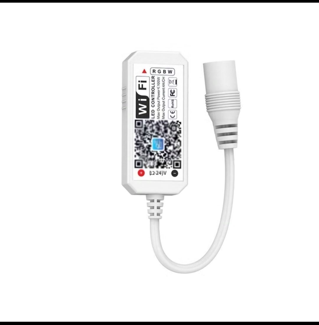

    btw the backup I have been testing from is with this from this GRB controller
    WiFi LED controller with QR code on the casing.
    is that what you have?

    Oh crap šŸ¤¦ā€ā™‚ļø I made a huge mistake. The controller I have is actually a RGBW Magic Home LED Controller
    Does that matter though? I tried the firmware you sent and got these from the logs:
    .file_max=0, .attr_max=0})
    Debug:LFS:lfs_mount -> 0
    Debug:API:LFS write of autoexec.bat len 0
    Debug:LFS:lfs_file_open(0x4201e7ec, 0x4202c8f8, "autoexec.bat", 103)
    Debug:LFS:lfs_file_open -> 0
    Debug:LFS:lfs_file_write(0x4201e7ec, 0x4202c8f8, 0x4202d016, 0)
    Debug:LFS:lfs_file_write -> 0
    Debug:LFS:lfs_file_truncate(0x4201e7ec, 0x4202c8f8, 0)
    Debug:LFS:lfs_file_truncate -> 0
    Debug:LFS:lfs_file_close(0x4201e7ec, 0x4202c8f8)
    Debug:LFS:lfs_file_close -> 0
    Debug:API:0 total bytes written
    Debug:API:GET of api/lfs/
    Debug:API:LFS read of
    Debug:LFS:lfs_file_open(0x4201e7ec, 0x4202c710, "", 1)
    Debug:LFS:lfs_file_open -> -21
    Debug:API: is a folder
    Debug:LFS:lfs_dir_open(0x4201e7ec, 0x4202c770, "")
    Debug:LFS:lfs_dir_open -> 0
    Debug:API:opened folder  lfs result 0

    Do they have different partition layout? (The GRB, RGB and RGBW?) This the one I actually have. Editing the title now 😬
    RGBW Magic Home LED controller with a cable and QR code. LittleFS interface for managing files on a Magic Home LED controller. [/img]

    looks like it has the same media partition start address. your LFS is working it seems.
    Maybe all MagicHome BL602s have this partition layout and you're the first to want LFS after mhflasher OTA exploit, noticing it doesn't work with standard OBK firmware.
    The only thing custom in the PR firmware posted related to the partition addresses, you still configure OBK the same way to work with your specific device.

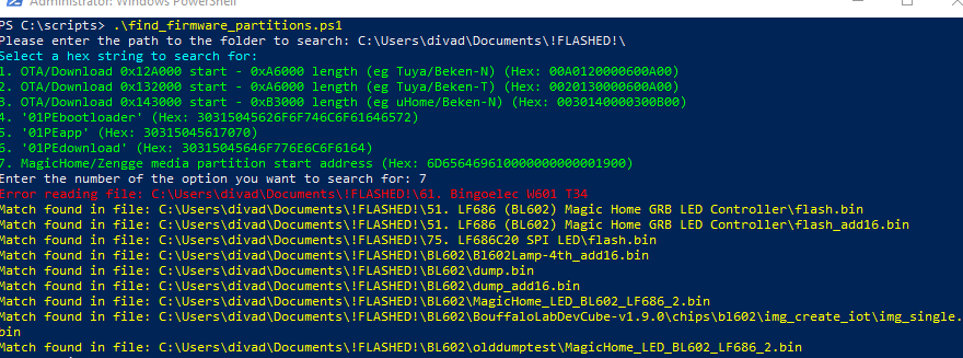

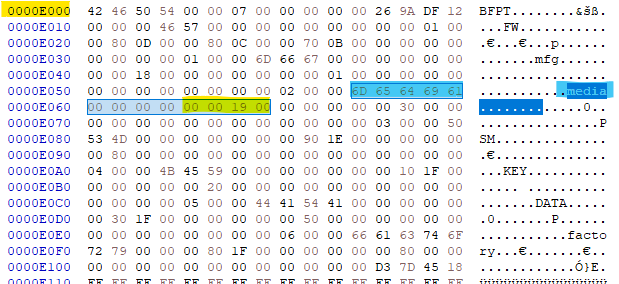

    so if you peer inside the GRB firmware backup I have been testing with and go to where the partition table starts - 0xE000 - you can see the 0x190000 media partition start address is set in there in little-endian32 reverse-byte order.
    Screenshot of a hex editor showing the partition table for MagicHome firmware.
    to see which firmware backups I have (my repo holds a few MagicHome types) that contain the same hex string 6D656469610000000000001900 I added a new search option to my little script (born in here: https://www.elektroda.com/rtvforum/topic4074263.html#21217939) to find that hex in all bin files
    Screenshot of PowerShell commands for searching firmware partitions.
    TLDR: It seems Zengge/MH use a custom partition layout for their devices

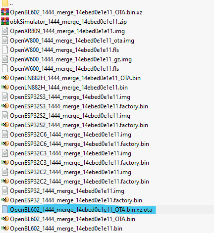

    Ok so after reading the docs and building guide, I managed to build the firmware with lfs modifications. However I got a .bin file in the build_out folder. How do I "convert" this to an OTA file? I want to see if I can use the latest release and just modify the our_lfs.h every update temporarily.
  • GitHub build produces BL602 .bin.xz.ota file
    #14 21326398
    Posts: 5234
    Help: 449
    Rate: 918
    ah OK. sounds like you're compiling offline. I've only used the Github code/build/pr way which will result in a zip file that includes the BL602 OTA file with extension .bin.xz.ota
    List of various binary files, including a file with the extension .bin.xz.ota selected in a file manager.
    The start of this way of outlined in step 1 here: https://www.elektroda.com/rtvforum/topic4056286.html
    but basically
    -login to your github
    -fork https://github.com/openshwprojects/OpenBK7231T_App/ main branch
    -edit src/littlefs/our_lfs.h in your fork
    -commit changes
    -create pull request
    -wait for admin to approve
    -download build zip after approval and build run complete

Where do GitHub build artifacts appear, and what file do I flash?
Open your fork’s Actions tab after the workflow completes. Download the artifact ZIP and flash the BL602-specific .bin.xz.ota file via the OBK web updater. This bundle includes everything needed for OTA deployment. [Elektroda, divadiow, post #21326398]
