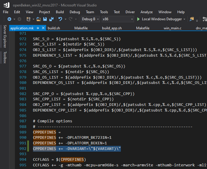

    I'm still working on it, but I can't see now any other way to pass the define to make other than manually setting it per platform in like:
    \OpenBK7231T\apps\OpenBK7231T_App\sdk\OpenBK7231N\platforms\bk7231n\bk7231n_os\application.mk
    Screenshot from Visual Studio showing makefile code with highlighted lines related to the CPPDEFINES variable.
    Maybe I will fall back to separate obk_config.h, at least currently. not sure yet

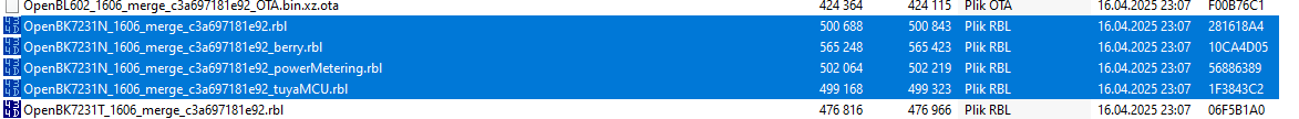

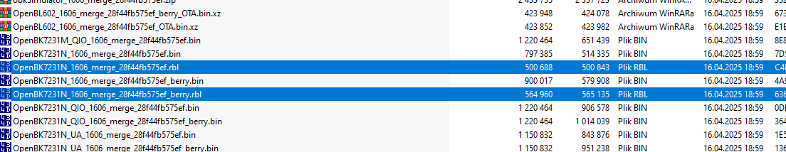

    Ok so I did copy config approach, at least for now. Here is current obk with and without berry:
    A list of files in Windows Explorer, with three .rbl and .bin files highlighted.

    Added after 4 [hours] 35 [minutes]:
    List of firmware files, including RBL and OTA types for OpenBK7231, with four RBL files selected.

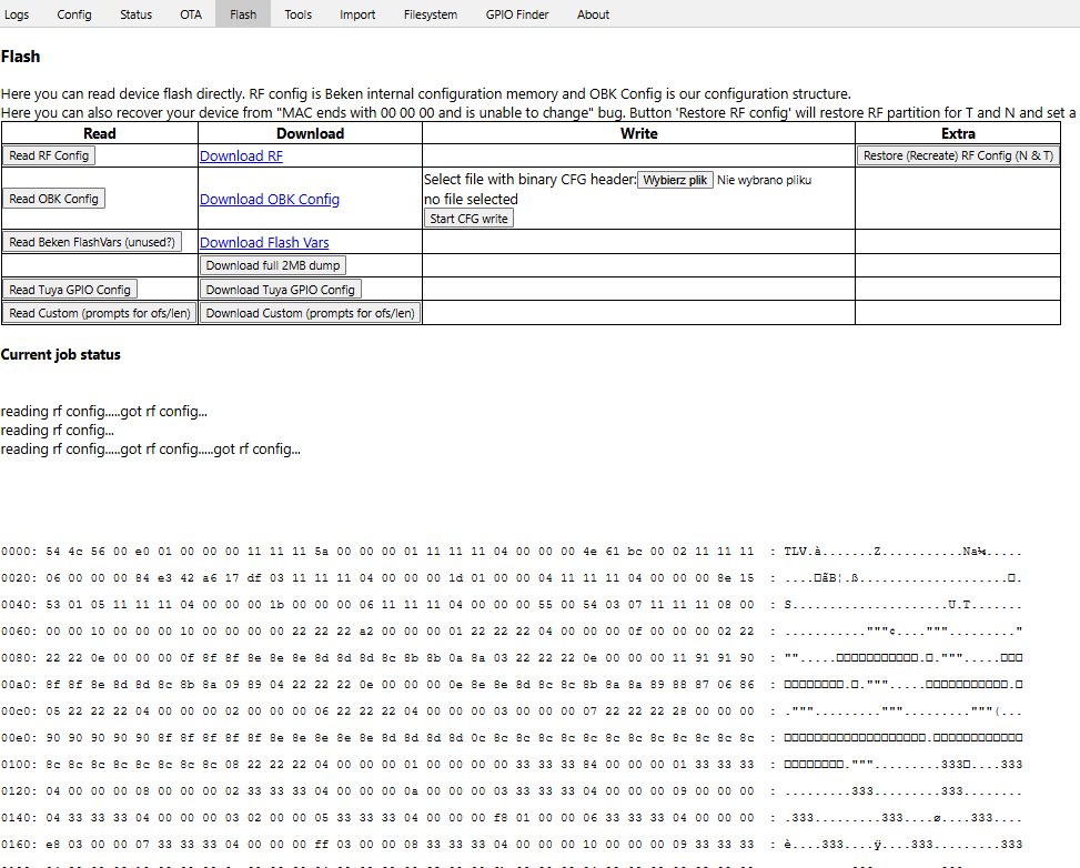

    Also, is RF partition on beken have some recognizable header? Perhaps a function in gui flasher can be created, that would search for it in a dump and flash it to device at a required offset.
    Well, TLV header for the start, and then, I don't know, but I know that MAC is at fixed offset in this section, because in the flasher, the "Restore RF partition" and "change MAC" just writes mac to fixed offset along with header. For more info, we would need to write script to check https://github.com/openshwprojects/FlashDumps/commits/main
    Screenshot of a configuration panel for reading and writing device flash memory with displayed data in hexadecimal format.
    insmod wrote:
    I noticed that my HLK-B30 mac address was a default one, instead of the one it came with. I eventually found that a partition with TLV header was at 0x1fe000, instead of 0x1e1000 like on T.
    Do we have source code for that partition read? We have a partition table in code, I remember. Could we modify it to search for RF partition in a list of predefined places so OBK works out of the box on various chip types?

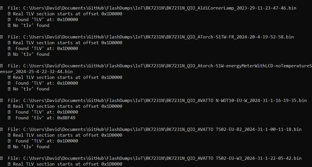

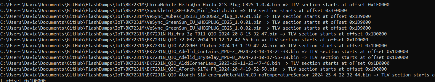

    like a kind of byte pattern search?
    Screenshot of a Windows console showing a list of .bin files and TLV section offsets.

    As a search? Yes, that's what've been thinking about, but make sure you list all occurencies and not just first, just to be sure.
    Regarding Github actions -I've been thinking about much more. Maybe on each commit we could generate some statistics or information or just check for firmware versions/flavours/etc and create a report in HTML, etc. Still, it would not be actually that useful, so it's a very low priority idea.
    You can also check bins for Tuya config magic string.

    just a little gpt thing for PS
    Code: Powershell
    Screenshot of a terminal window showing .bin file analysis results for various IoT devices.

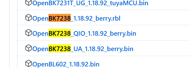

    the BK7238 asset links in the main table on release page are broken. big asset list below works.
    https://github.com/openshwprojects/OpenBK7231...eases/download/1.18.92/OpenBK7238_1.18.92.rbl
    https://github.com/openshwprojects/OpenBK7231...s/download/1.18.92/OpenBK7238_QIO_1.18.92.bin
    script checked all others in latest release and they work

    Strange
    A screenshot of a file list with the text BK7238 highlighted.
    it was run as berry and not default, fixed

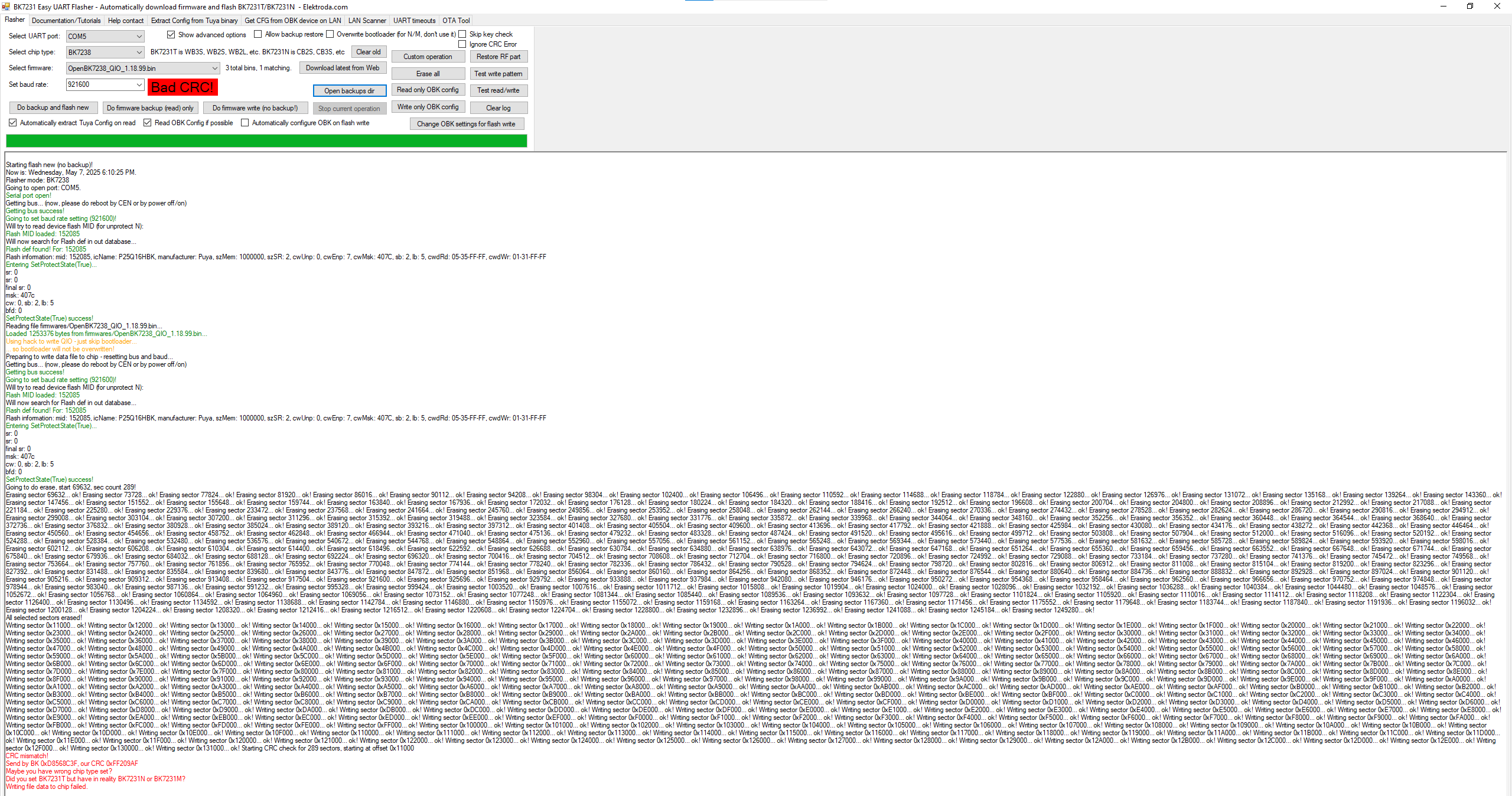

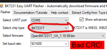

    I am really sorry, but I went through all comments as I did receive NiceMCU board(s) and hit the CRC issue.
    Is there a bin (firmware) and flash tool I can use without requiring to compile stuff ?
  • #194 21542272
    apsis
    Posts: 26

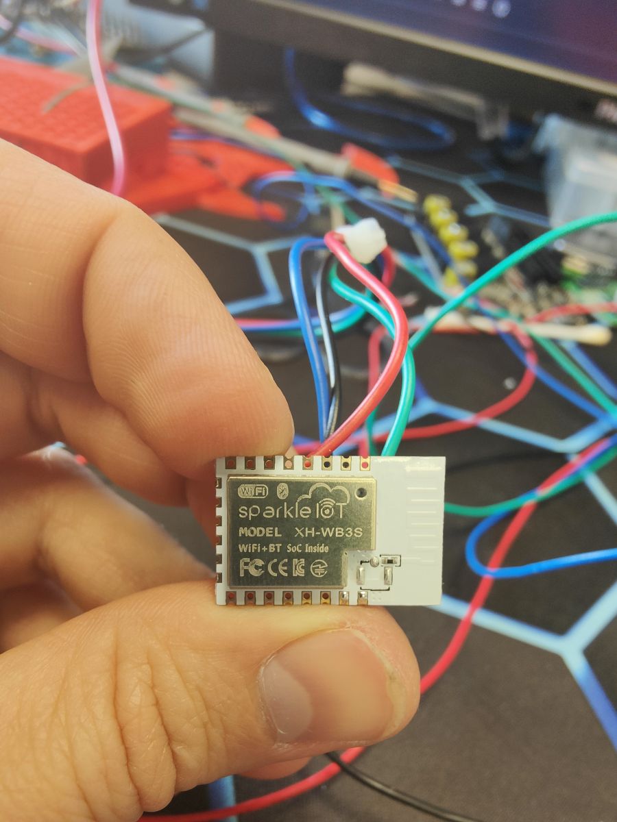

    I am using BK7231GUIFlashTool-v19 which reports icName: P25Q16HBK
    on the shield board says:
    sparkle IoT
    MODEL XH-WB3S

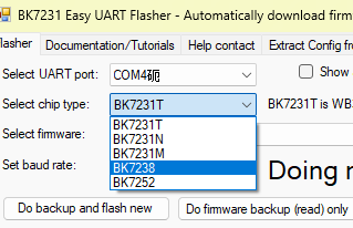

    WB3S module is based on BK7231T chip - so you should use the file named OpenBK7231T_UA_1.18.99.bin link here - https://github.com/openshwprojects/OpenBK7231...s/download/1.18.99/OpenBK7231T_UA_1.18.99.bin
    CORRECTION: XH-WB3S is BK7238 so file to be used is here - https://github.com/openshwprojects/OpenBK7231...s/download/1.18.99/OpenBK7238_QIO_1.18.99.bin
    If the problem persists lower your UART speed from 921k to something like 115200. Also share log form the GUI flasher.
  • #196 21542291
    apsis
    Posts: 26

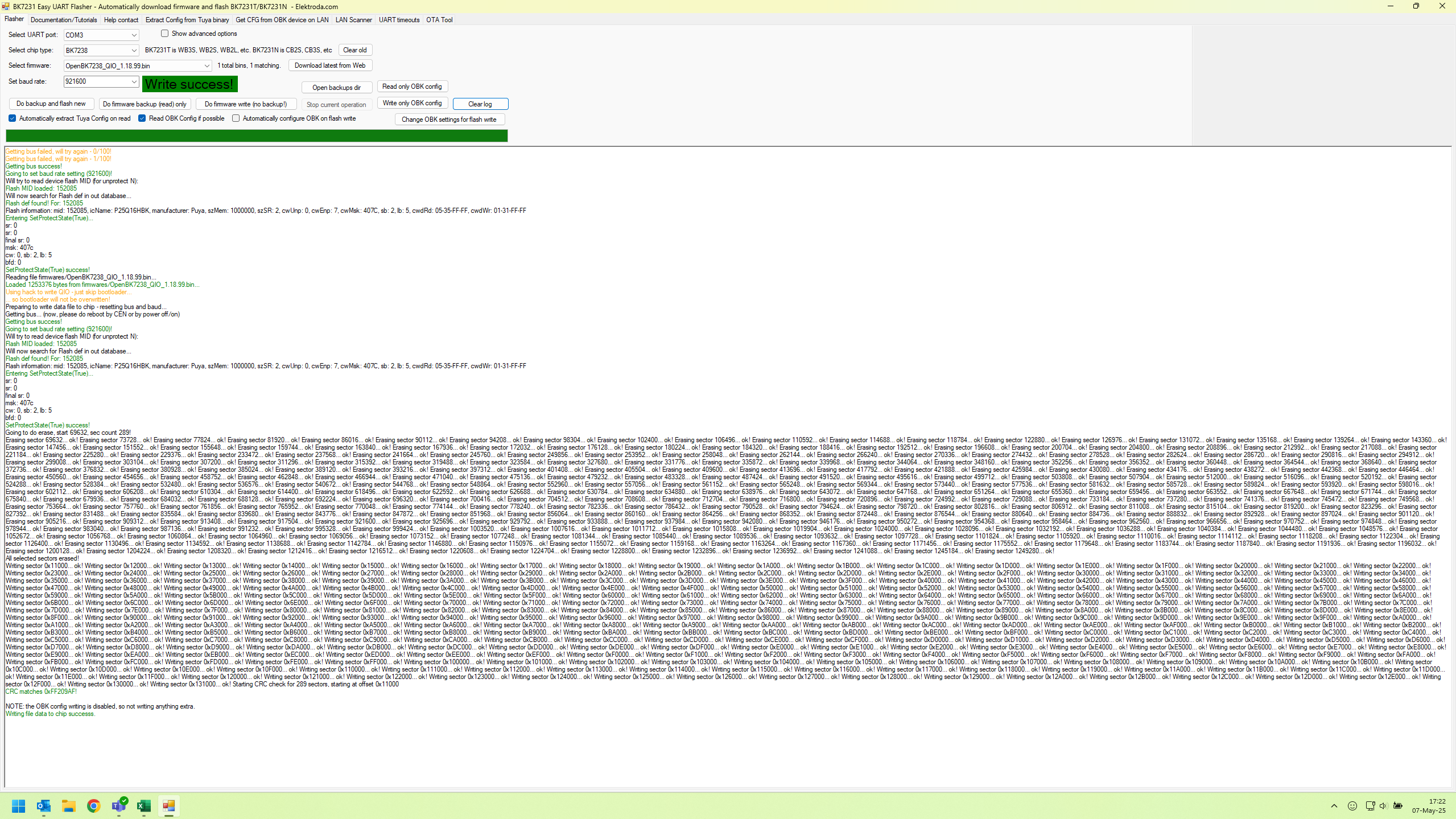

    Tried all possible modes.

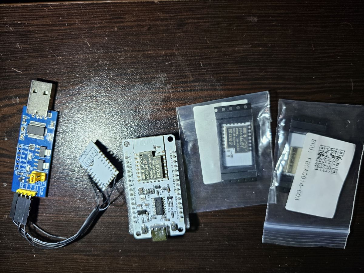

    including getting 7238 image, renaming it and flashing as 7231N
    Screenshot of BK7231 Easy UART Flasher software with a red Bad CRC! error and flashing operation logs.
    A set of electronic modules: a USB programmer, an ESP8266 board, a small ESP module, and two ICs in plastic bags.

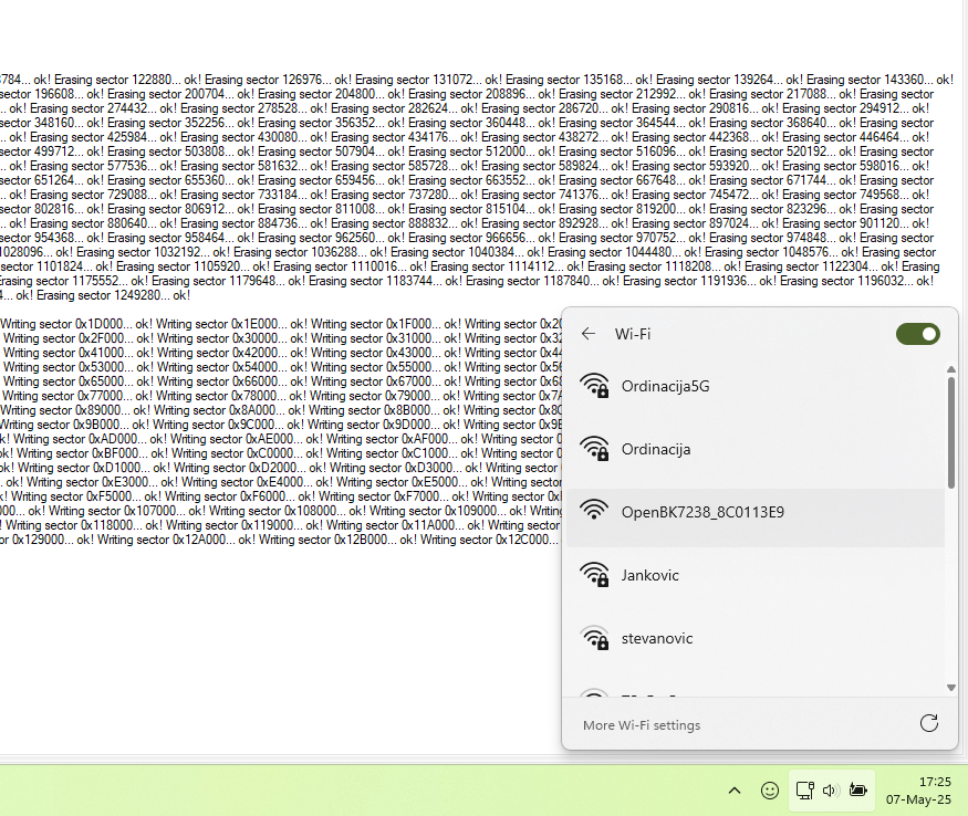

    Ok, stand-by, I will do the same on my side and try to figure out what is going on and report here shortly.
    Brand new module:
    Screenshot of a firmware flashing tool showing the message “Write success!”.
    Screenshot of a computer desktop with a sector scan window and a list of available Wi-Fi networks.
    Can't find anything unusual on the first go. Did you maybe tried to flash any other BIN file before?

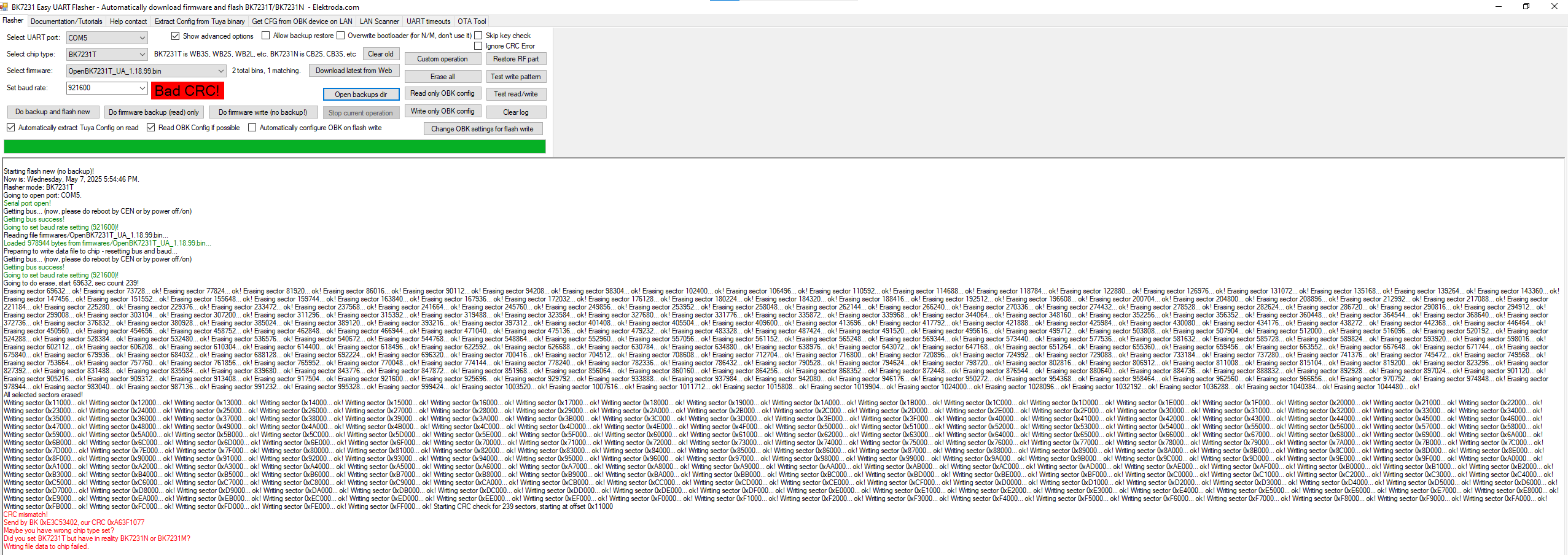

    Connected adapter RX to P0, opened putty on the COM port with baud rate 115200 - noting, attempted 921600 and 9600 with reboots after each - nothing.
    then tried with override bootloader flash, checked P0 again and got this
    BK7238_1.0.14

    Hmm, attempted same on the soldered module /that I never flashed/ and seemed to work....
    Then tried to write the backup on the other chip (with other programmer) - got same issue (CRC) with same settings - ODD
    Likely some of the previous flash attempts bricked the board?
    Seems I placed power on p17 and p16 instead of VCC and GND - FACEPALM

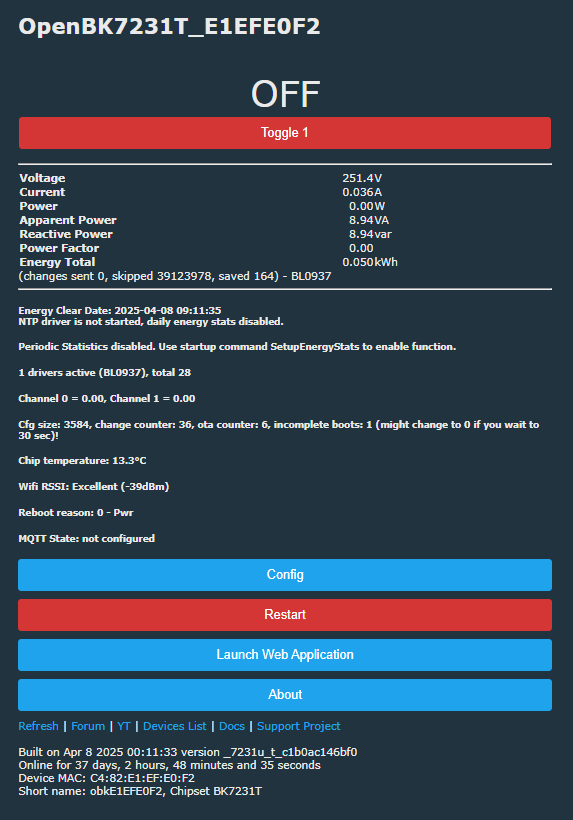

    Help: 441
    Rate: 900
    >>21511229
    still up with new SDK
    Screenshot of the OpenBK7231T device control panel showing status, measurements, and configuration details.

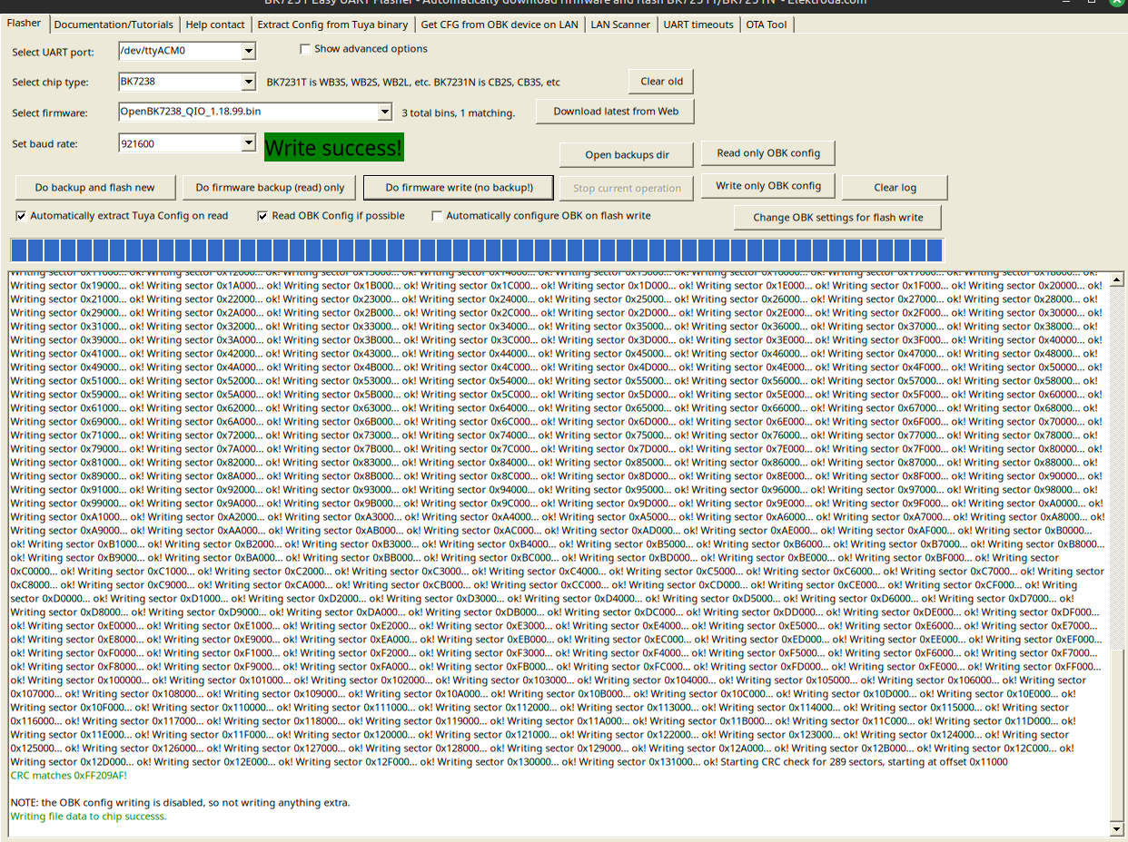

    Flash done. But no AP appears.
    What should I do?
    Window of a microcontroller flashing program with the „Write success!” message and detailed memory write log.
