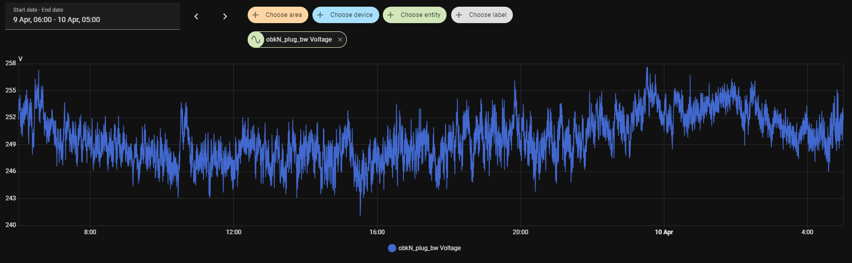

    Trying to log bl0937 with lfs is probably not working because all lfs calls are disabling interrupts. And flash read/write is not the fastest thing. I suspect other problems are also because of that, this new sdk might be disabling interrupts more frequently for some reason

    >>21513556 Just raw binary won't work, it must be crc'd first. Just use encrypt v0.3 (take it from new sdk, encrypt is v0.3 and encrypt_n is v0.3.1) on it, then it can be flashed. The way i did bk7251 bootloader - use 0.3.1 to encrypt, and then 0.3 on resulting binary to crc it. And since U is not encrypted, 0.3.1 can be skipped.
    New sdk with loglevel 0 is perfectly alright. But why is logging doesn't work properly with new sdk...
    Graph showing voltage changes over time.

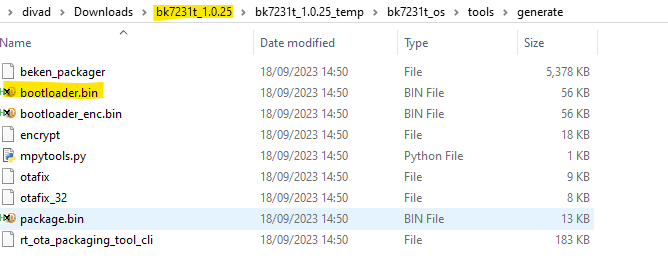

    ah yes. thank you. I've not long since been through that too here trying to get the Uascent Matter devices fully convertible. That adventure has stalled for now.
    Anyway, with the Windows encrypt.exe (version 0.2) used on bootloader.bin from bk7231t_3.1.4 Tuya SDK:
    I got bootloader_crc.bin created which does boot when flashed to U
    I already had U OBK on there so I guess it started to try boot app
    • bootloader_crc.bin (58.74 KB) You must be logged in to download this attachment.

    >>21513854 Will it boot T OBK? U OBK should fail to boot, since it lacks certain things needed to boot on 1.0.5 bootloader (and i guess 1.0.6?)

    >>21514558
    checking
    >>21514572
    here's hoping you don't end up with a Taixin which I have 4+ of trying to get BK7252 :)
    Added after 29 [minutes]:
    yes, T rbl to 132000 and OTA/boot success

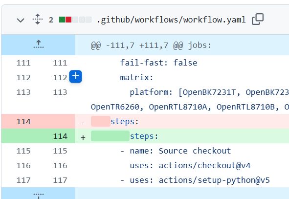

  • #158 21518056
    Posts: 14655
    Help: 655

    #159 21520134
    insmod
    Posts: 1408
    Help: 164
    Rate: 443
    >>21518056

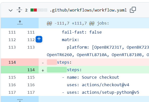

    Sure, it can be merged. I redid powersave, now it is like before, but if BL0937 CF pin is set, mcu power save is disabled.
    Added after 11 [minutes]:
    And since today is 15.04, ubuntu 20.04 runner have been removed and thus T build failed.
    And this is what happens if built on 22.04
    make[3]: Leaving directory '/home/runner/work/OpenBK7231T_App/OpenBK7231T_App/sdk/OpenBK7231T/platforms/bk7231t/bk7231t_os'
    make[2]: Leaving directory '/home/runner/work/OpenBK7231T_App/OpenBK7231T_App/sdk/OpenBK7231T/platforms/bk7231t/bk7231t_os'
    Start Combined
    Combined will do cd
    make[1]: *** [Makefile:263: build-BK7231] Error 176
    Combined will do OTAFIX
    make[1]: Leaving directory '/home/runner/work/OpenBK7231T_App/OpenBK7231T_App'
    make: *** [Makefile:234: OpenBK7231T] Error 2
  • #160 21520724
    insmod
    Posts: 1408
    Help: 164
    Rate: 443
    Found how to fix it, will open a pull soon
    Also disabled bluetooth, used LTO for os (this reduced rbl by 1-2kb in new sdk), enabled CFG_LESS_MEMERY_IN_RWNX (should increase available stack), enabled CFG_GENERAL_DMA (needed for ws2812?), and g0 flag instead of g for gcc.
    Final rbl binary size is 476752 bytes or 465kb.

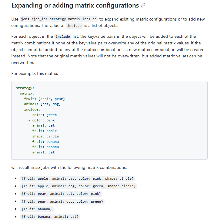

    I'll merge your I2C change once we can test it, do you still have full code? @divadiow could help certainly. I also may still have TC74 somewhere (that IC has a very simple I2C interface, just a single byte read).
    I'm currently looking into this permutations build and my current idea is to just plug into workflow.yaml another matrix and then receive it in build as obk_config.h override, I should be able to show a bit more in a moment
    Added after 5 [minutes]:
    Here's my idea, not tested yet:
    https://github.com/openshwprojects/OpenBK7231...mits/1622033de5a20c70d0f2a5b525b4f053c825eb37
    Currently I'm passing VARIANT to makefile, but now that I think about it... maybe I could just plug OBK config copy already at workflow.yaml, not sure yet...
    Added after 14 [minutes]:
    https://docs.github.com/en/actions/writing-wo...does/running-variations-of-jobs-in-a-workflow
    The image shows a technical documentation section on expanding or adding matrix configurations in CI/CD, including a YAML code example.
    Ok it seems this workflow file has a very strict whitespace requirements, I changed one and it does not run anymore.
    A fragment of a YAML file showing a change in the steps section in a GitHub repository.
    I restored whitespaces and it runs.

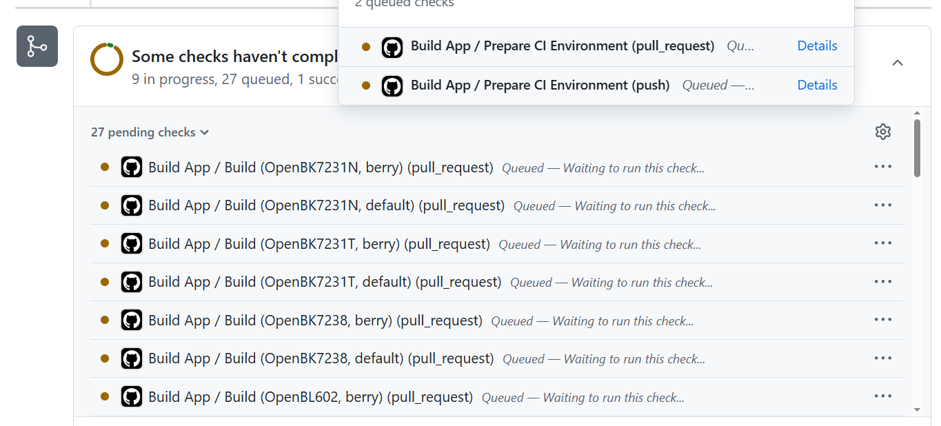

    Something seems to be working:
    List of pending CI tasks in GitHub for various project builds.
    but I need to trim excess permutations, we obviously don't need berry on Xr809

    >>21521194
    VARIANT is a good idea, then just check it in obk_config and enable/disable berry based on it.
    Like
    #if VARIANT == "berry"
    #define ENABLE_OBK_BERRY 1
    #endif
    #179 21521210
    Posts: 14655
    Help: 655
    Rate: 12662
    Ok I will try that in a moment.
    An obvious error, so it works so far:
    Run actions/upload-artifact@v4
    Multiple search paths detected. Calculating the least common ancestor of all paths
    The least common ancestor is /home/runner/work/OpenBK7231T_App/OpenBK7231T_App/output/1606_merge_3b9b22a33401. This will be the root directory of the artifact
    With the provided path, there will be 3 files uploaded
    Artifact name is valid!
    Root directory input is valid!
    Error: Failed to CreateArtifact: Received non-retryable error: Failed request: (409) Conflict: an artifact with this name already exists on the workflow run

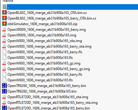

    Added after 1 [hours] 50 [minutes]:
    Progress:
    A folder view showing a list of firmware and ZIP archive files, all starting with Open.
    Added after 1 [hours] 13 [minutes]:
    Almost done, now I'm only looking for a place to add:
    CFLAGS += -DVARIANT=$(VARIANT)
    I really hoped that I can avoid doing it separately per each platform...
    Added after 3 [minutes]:
    Wait, in application.mk we have:
    CFLAGS = $(CCFLAGS)
    CFLAGS += -std=c99 -Wunknown-pragmas -nostdlib -Wall
  • #180 21521460
