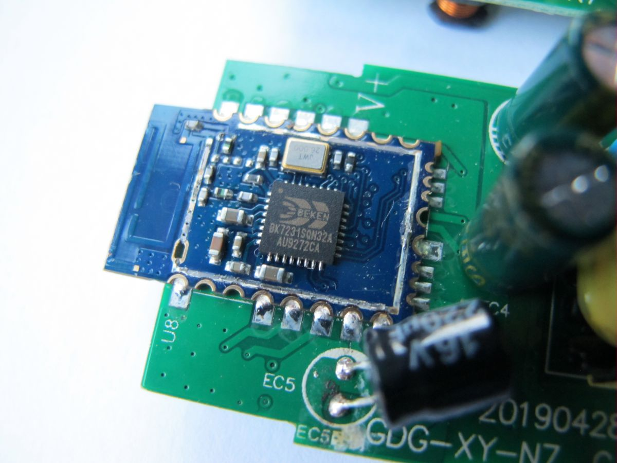

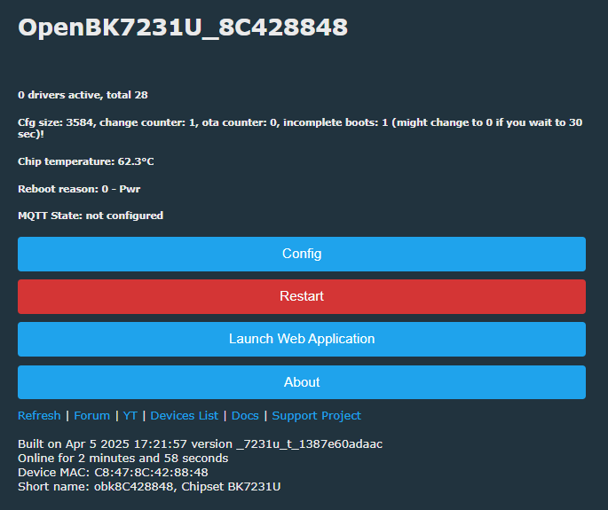

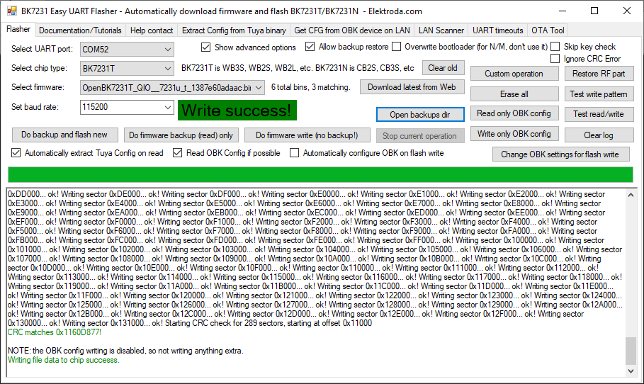

    and here is U fw flashed to BK7231S (but U?) on C-8133U module using Easy Flasher. Module from https://www.elektroda.com/rtvforum/topic4071547.html
    Software interface for flashing BK7231T/BK7231N with successful operation.
    Screenshot of OpenBK7231U control panel with system information.
    Close-up of a circuit board with a soldered electronic module and an integrated circuit.
    dumps https://github.com/openshwprojects/FlashDumps...474f62f/IoT/BK7231U/C-Chip_C-8133U_LED_Driver
    original BL.
  • BK7231S may be earlier BK7231U variant

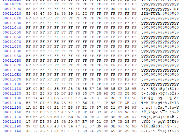

    I just noticed that your bk7252 device is tuya-made. That means flash is encrypted, my binaries won't work.

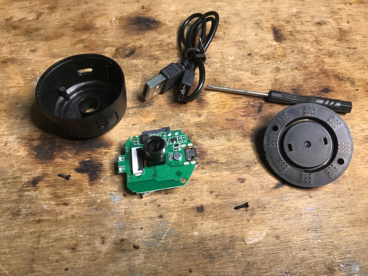

  • #131 21510820
    Posts: 5220
    Help: 449
    Rate: 918
    >>21510817
    bum OK.
    Just soldering up a CB2S in a plug with BL0937 in place of WL2S.
  • #132 21510847

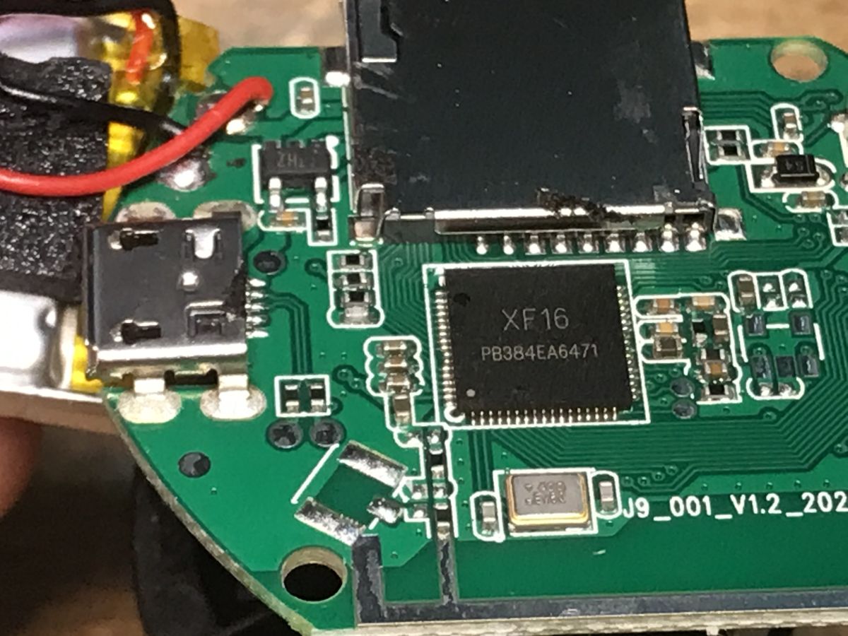

    Posts: 14769
    Rate: 12911
    I think I have one bk7252 camera, but as far as I remember, I've accidentally overwrote bootloader so now I will most likely need to do SPI recovery, which may be hard if pins are not accessible..
    Some time ago I tried getting another A9, but got that:
    Close-up of a circuit board with an XF16 chip and a USB port.
    Disassembled camera with electronic components on a wooden table.
    App verify failed triggers factory firmware recovery

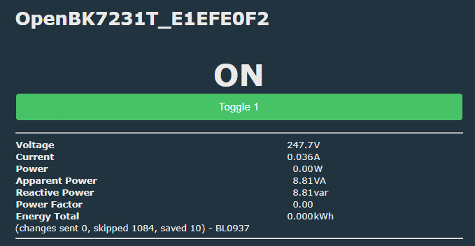

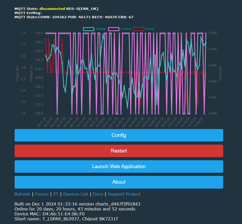

  • BL0937 shows no spikes without load or calibration

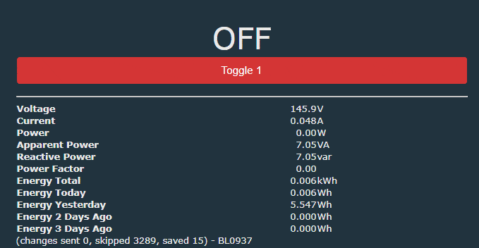

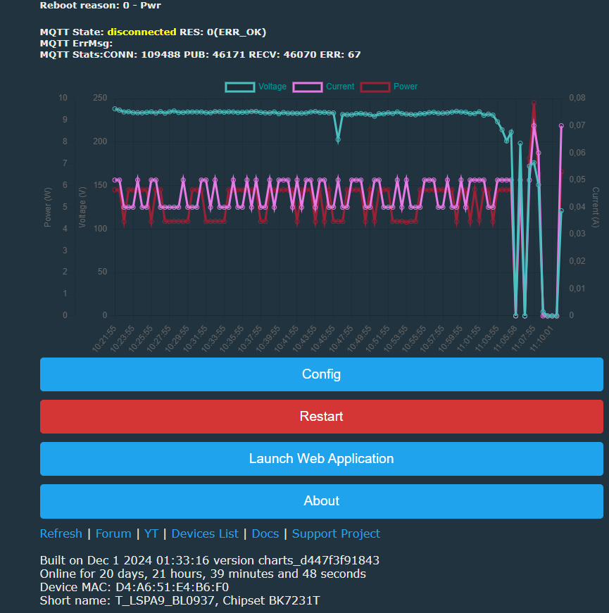

    #134 21510984
    Posts: 5220
    Help: 449
    Rate: 918
    right. What am I expecting to see and under what conditions? I see no spikes - no load and no calib yet
    Device configuration interface named OpenBK7231T displaying measurement data.
    Added after 1 [hours] 24 [minutes]:
    soldering iron from standby to 400c. Is the wavering between 230s to 240s indicative of the issue seen on N?
    OpenBK7231T energy monitoring system interface with an on button and displayed electrical parameters.

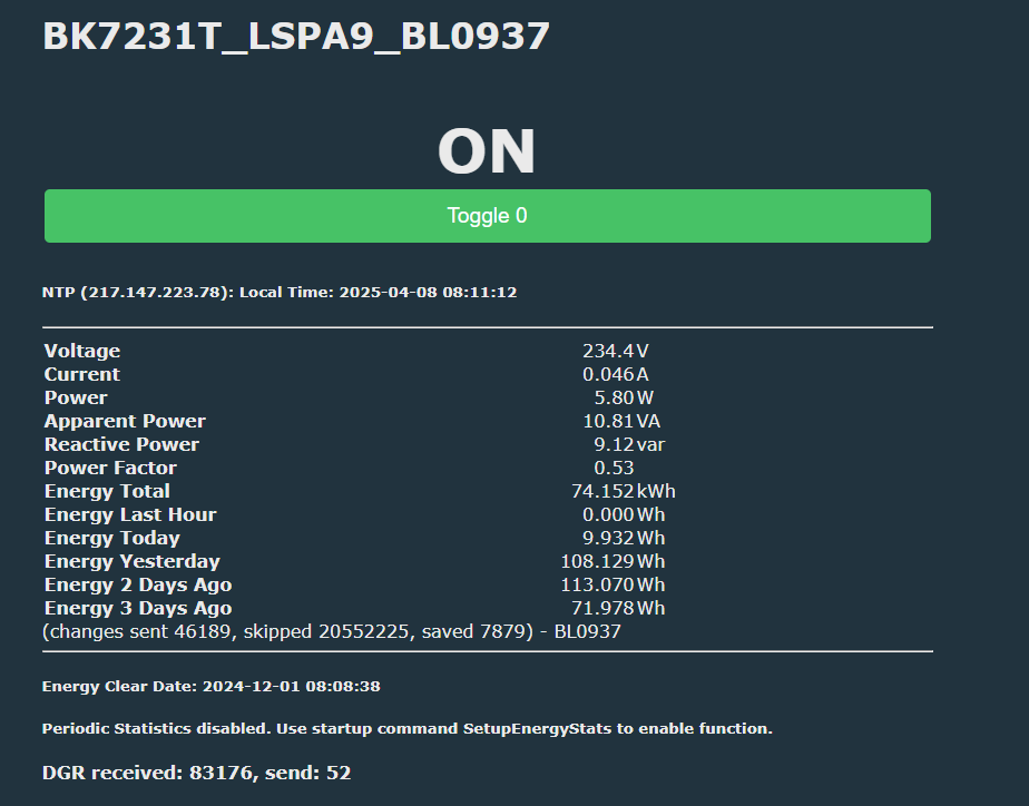

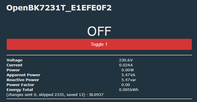

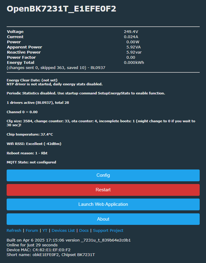

  • #136 21511229
    Posts: 5220
    Help: 449
    Rate: 918
    insmod wrote:
    Are voltage drops similar with normal T firmware?
    no.
    new comparison this morning
    1.18.75
    OpenBK7231T interface screen with electrical data, off button.
    _7231u_t_c1b0ac146bf0
    Screenshot of an interface displaying electrical load information with identifier OpenBK7231T_E1EFE0F2.

    I have BK7231T with BL0937, what can I test?
    Screenshot displaying electrical energy measurements from the device BK7231T_LSPA9_BL0937, showing various voltage, current, and power values.
    A chart displaying the device's voltage, current, and power with system information.
    Probably I should update first.
  • LFS dump script biased the chart results

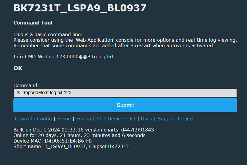

    i see.. but maybe we should come up with some better approach to testing?
    lfs_appendFloat log.txt $voltage

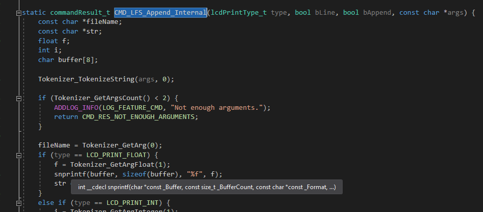

    Wait a sec, it seems there is some kind of bug, I'll need to debug this
    Console screen with a command tool for the BK7231T device.
    Source code snippet in C with the CMD_LFS_Append_Internal function.
    Strange, I was always working under assumption that snprintf will take NULL terminating character into the account.

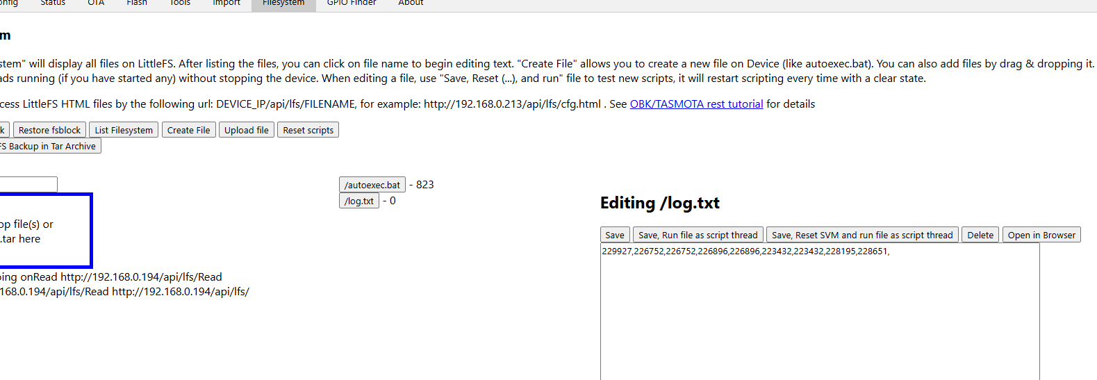

    User interface for managing files in LittleFS.
    I'm on Built on Dec 1 2024 01:33:16 version charts_d447f3f91843
    My script :
    Spoiler:

    Added after 6 [minutes]:
    EDIT: It seems that my LFS dump script has actually biased the results... the graph has started before I run my script.
    Charts of voltage, current, and power on a console background with a configuration menu.
    229927,226752,226752,226896,226896,223432,223432,228195,228651,226586,227040,225308,225759,223721,223273,217947,132054,174213,223143,223143,225308,225308,225308,225308,224875,224875,215638,215638,217515,217515,493,224875,224875,211163,211163,217805,217370,225247,217709,218669,218669,214050,214050,214050,102105,152852,205101,205101,207122,207122,217081,217081,207844,207844,208277,208277,203514,203514,1091,209143,209143,213761,213761,219968,219968,217947,217947,200338,200338,201204,201204,201204,47233,104290,217514,217514,206545,206545,211308,211308,214483,214483,212174,212174,208854,363,213177,212326,194565,194565,213040,213466,207699,207284,212895,212895,211308,211308,211308,1648,19629,220986,220104,196395,188693,201060,201060,187059,187059,210009,210009,195142,448,183306,183306,199003,198209,198462,198462,201637,201637,194853,194853,190235,190235,54334,112726,199328,199328,178467,177754,206112,206112,203081,203081,186482,186482,186482,198,169595,169595,200482,200482,175719,175017,190326,189946,185101,185471,198606,198606,10117,48641,201204,201204,207699,207699,191338,190574,201781,201781,184894,184894,184894,185,164473,171327,212174,212174,183306,191372,166896,173865,214050,214050,216608,17069,63219,176811,176811,164687,164687,187781,187781,166752,166086,194132,194132,176,188647,188647,199183,199183,185616,185616,169883,170223,177020,175960,172193,9628,47197,193554,193554,165842,165842,188070,188070,172914,172914,170817,167169,167169,1,131113,172106,203150,180822,166479,138992,185018,175681,129981,176336,176336,6,1325,172325,147430,162895,177921,166188,203275,137760,170192,153531,153531,0,136993,147531,202503,193510,130397,126538,183367,194051,129121,150820,150820,0,379,174948,193200,159404,147232,104524,115758,182485,182830,143366,143366,6,98379,144617,113966,140409,150424,142084,181025,240143,105323,111815,4821,34155,152312,159787,171533,164386,178832,200292,132096,150109,167862,43,128723,128723,173544,178543,162557,183235,96465,111745,155334,145588,145588,0,485,101116,128321,130035,180475,92467,116004,220380,231340,231340,0,155638,169758,149285,145758,131194,180906,127551,134776,94049,104290,0,0,2,799,118983,161909,137972,139624,119382,168081,121565,56,173477,192371,131784,169687,97594,131583,130549,157735,132821,132821,0,0,3,833,135328,167563,126584,136906,154599,141001,141001,0,183316,131886,160468,177001,146509,

    ok weird. I used your script (though charts isnt enabled on new-SDK PR anyway) and now the readings really are crazy after reboot.
    Screenshot of a control panel displaying OFF and energy usage data.
    removed autoexec entirely so no ntp even and now readings are frozen after reboot and even after counter reset. not sure what's happening. will flash back to general release and report back on change

    OK. I don't see the usual RBL headers in the dump. So went with the Tuya UA (transplanted into full dump) at 11000, which gives this on boot
    or if transplanted to 11110 just:
    this is what original dump looks like around here
    Flash memory dump in hexadecimal table form with signs of read errors.
