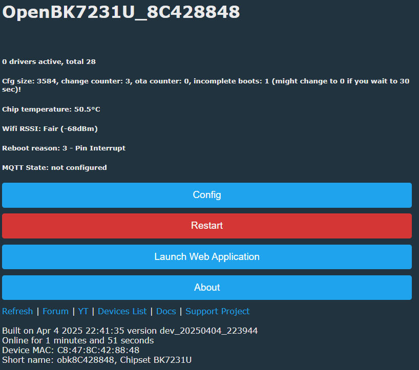

    >>21386560 Doesn't build. If replace SOC_BK7231 with SOC_BK7231U (like in LT), then it builds but throws a lot of undefined references, mainly bt or wolfssl ones.
    Added after 39 [minutes]:
    This sdk boots: https://github.com/tiancj/bdk_freertos
    But, it doesn't support BK7238 and there is no config for T (but, it can be taken from LT source)
    All in all, bk7231u is very rare, so i don't see a reason to port it.

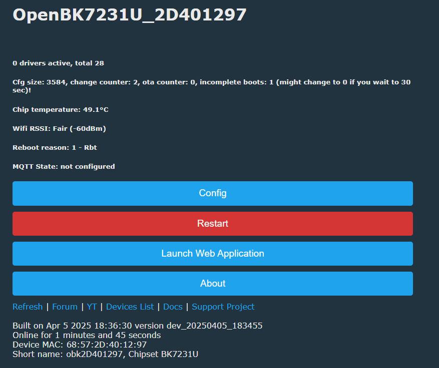

    LibreTiny works, since it uses this sdk.
    But, it can only be flashed with rbl, since setting bkcrypt_coeffs to zeroes throws this:
    |-- ValueError: non-hexadecimal number found in fromhex() arg at position 1
    |   |-- File "/root/.platformio/penv/.libretiny/lib/python3.11/site-packages/ltchiptool/soc/bk72xx/util/binary.py", line 36, in __init__
    LT must be built as BK7231T with additional platformio_options:
    esphome:
      friendly_name: bk7231u_test
      platformio_options:
        #board_build.bkcrypt_coeffs: 00000000000000000000000000000000
        board_build.bkboot_version: "0.1.4-bk7231u"
        board_build.mcu: "bk7231u"
    (board_build.mcu can probably be skipped, and bkboot_version can be set to anythigs but default for T "1.0.5-bk7231s", since that would include T-specific LT fix, which would prevent it from working)

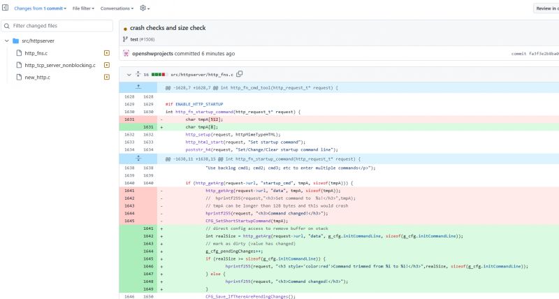

    I have cc8000 if that's needed. I could try to help somehow, altough I'm doing misc/W800 stuff now:
    Code editor screen showing changes in the http_fns.c file.
    Which board will I be able to add there next? Hopefully NiceMCU:

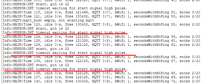

  • #98 21440151
    Posts: 14654
    Help: 655
    Rate: 12661

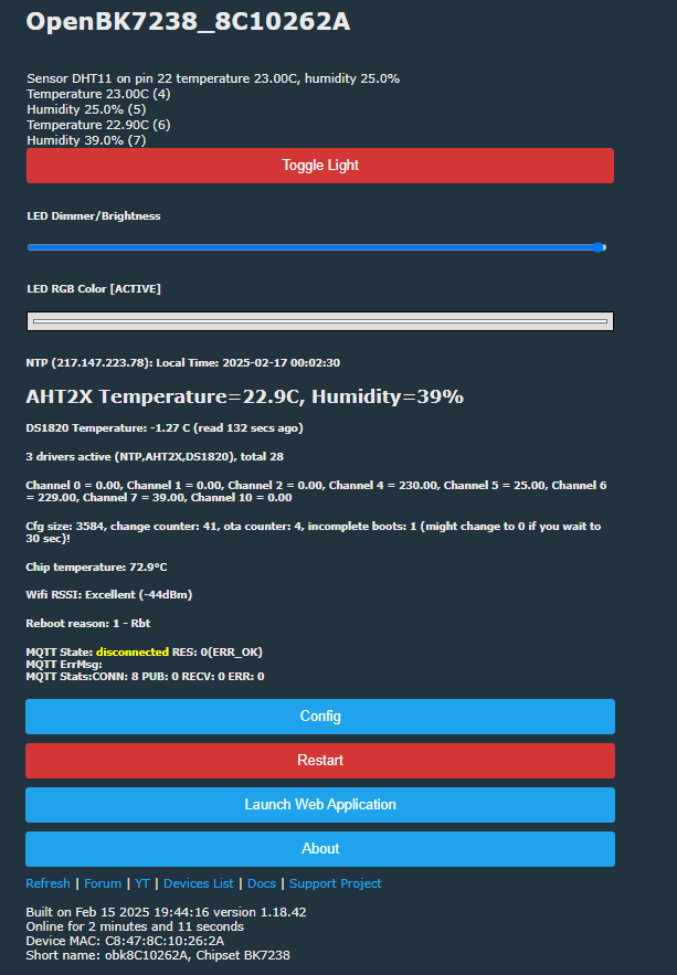

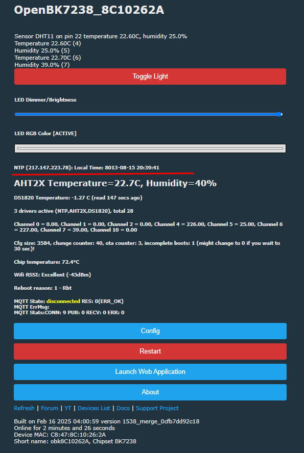

    Is DHT11 working on BK7238?
    Screenshot of error messages related to the DHT sensor on pin 22.
    Tried both P15 and P22
  • #99 21440156
    insmod
    Posts: 1408
    Help: 164
    Rate: 443
    >>21440151 Need to implement delay_us, because current n/t are for 120mhz.
    BK7238 freq is 160mhz. Just take it from arduino, there is no need to guess how many nops are needed.
  • #100 21440247
    Posts: 14654
    Help: 655
    Rate: 12661
    I've did a naive fix and it works:
    https://github.com/openshwprojects/OpenBK7231...mmit/e88875a458661aeb1d8e7184520e9e6319452266
    I think I'd rather need to fix usleep itself but I had trouble finding it in:
    https://github.com/NonPIayerCharacter/OpenBK7238_asdk
    Or maybe it's just in binary blob?

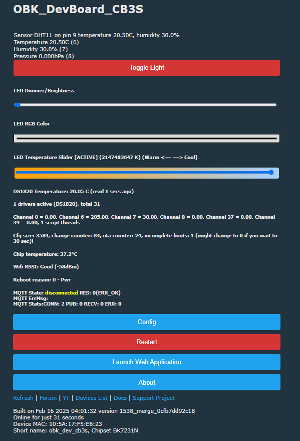

    Thank you, any toughts on the accuracy of the new delay? From what I can tell, Calendar driver is a hardware timer, so it should be more precise, but again, there is an overhead for function calls etc, so I would guess it will be much better than previous delay version, but only for relatively longer delays?
  • #103 21441514
    insmod
    Posts: 1408
    Help: 164
    Rate: 443
    >>21441495 I tried 5ms, 8ms, 10ms, 50ms and 100ms in ds1820 driver.
    5ms reported 4ms without ps and 6 with ps. Everything else, tested without ps matched perfectly.

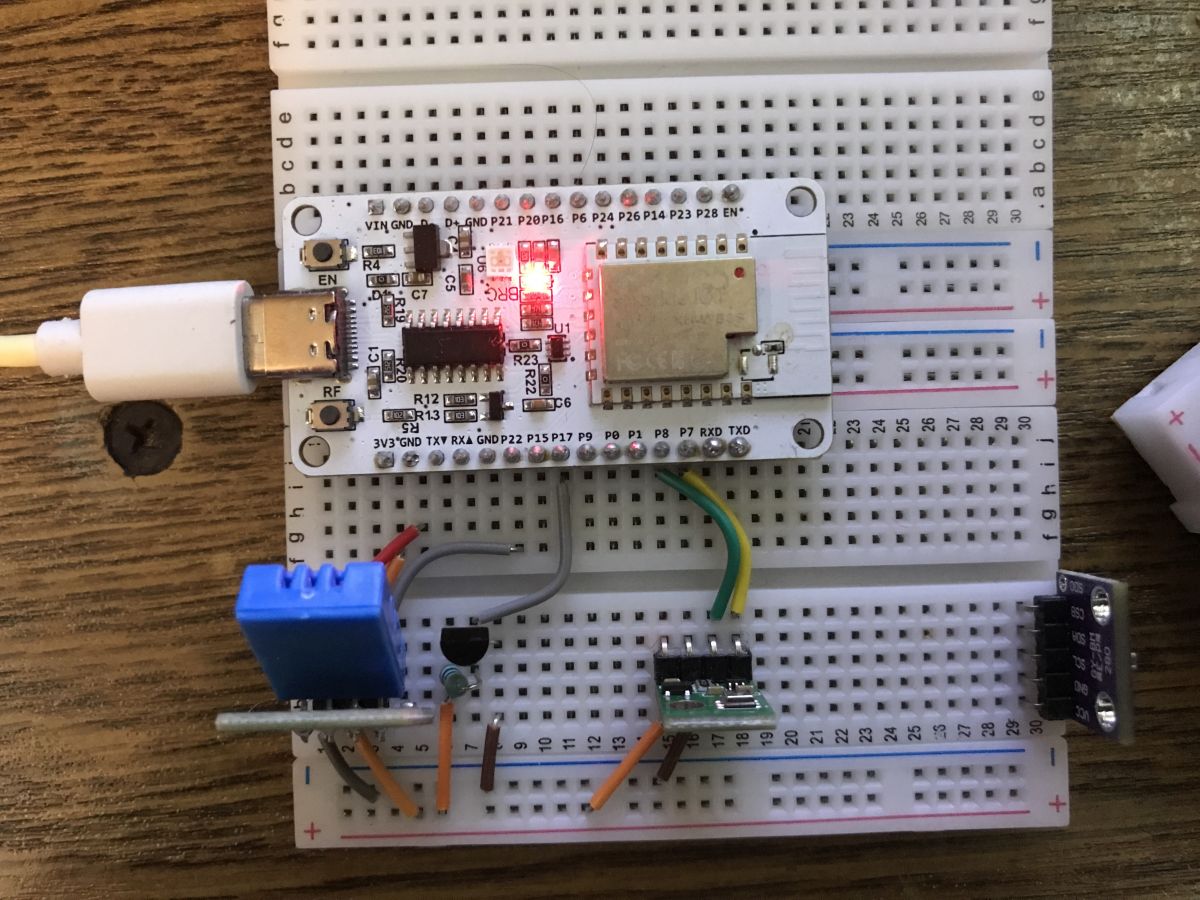

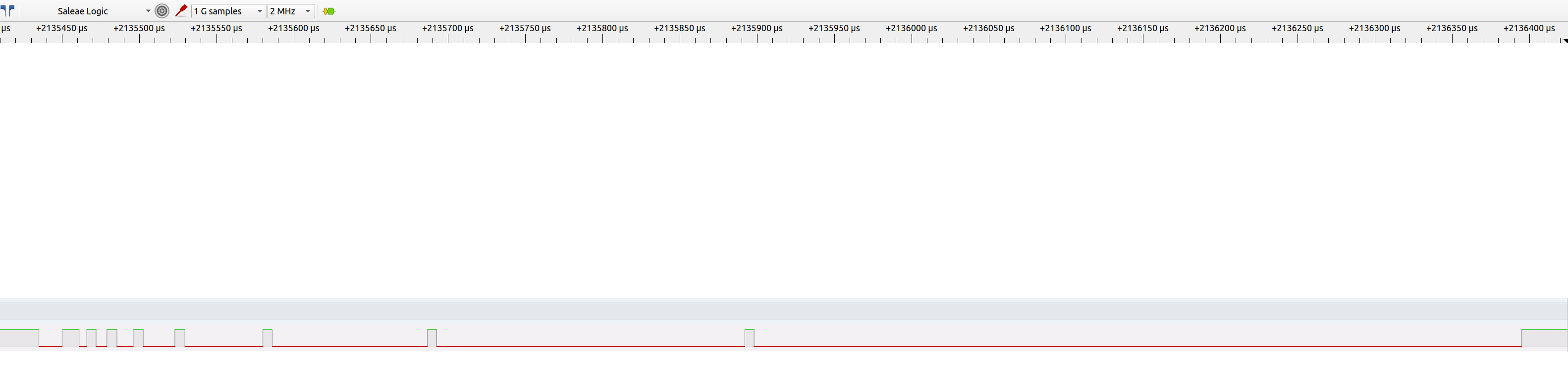

    Hope it's o.k. if I report here and not in the Bluetooth Gateway/CR3L thread:
    Sadly my tests with DS18B20 and the new timing from PR#1538 where not successful on Beken-N :-(.
    Delay is working "o.k." with the old delay(s), but not with "HAL_Delay_us()".
    Even if I only use one delay (not the three short/medium/long) timing is working, but not with the new delay.
    For testing I simply changed the #if to "PLATFORM_BK7231T" so it should use "HAL_Delay_us(r);" for BK7231N.
    Here the code, maybe I missed something?

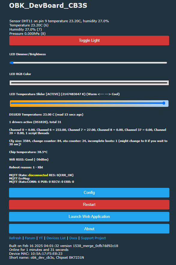

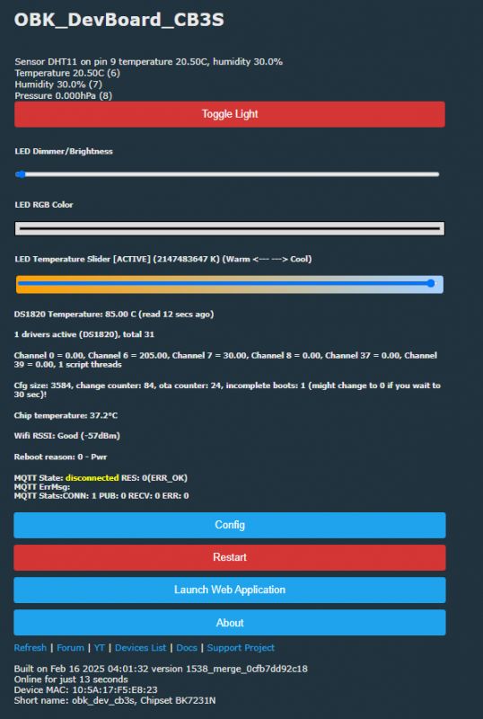

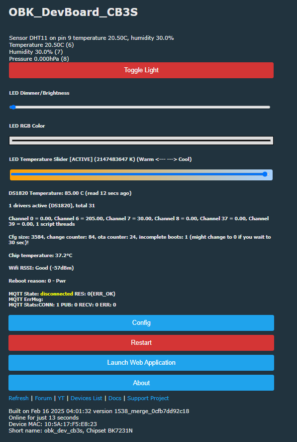

    >>21442351 I just tried to test mine, and it works. But, there are still some "read reset failed".
    Sometimes it will get data after only one of those, sometimes only after ~10. But what is this first reading?
    Debug:API:POST to api/cmnd
    Debug:CMD:cmd [startdriver ds1820]
    Info:MAIN:Started ds1820.
    Info:CMD:[WebApp Cmd 'startdriver ds1820' Result] OK
    Info:SENSOR:DS1820[7] - Discover Family - discovered 28
    Info:SENSOR:DS1820[7] - Starting conversion
    Info:MAIN:Time 48, idle 193315/s, free 77808, MQTT 1(6), bWifi 1, secondsWithNoPing -1, socks 2/38
    Error:SENSOR:DS1820[7] - Read Reset failed
    Info:MAIN:Time 49, idle 185809/s, free 77808, MQTT 1(6), bWifi 1, secondsWithNoPing -1, socks 2/38
    Info:MAIN:Time 50, idle 196047/s, free 77808, MQTT 1(6), bWifi 1, secondsWithNoPing -1, socks 2/38
    Info:MAIN:Time 51, idle 188523/s, free 77808, MQTT 1(6), bWifi 1, secondsWithNoPing -1, socks 2/38
    Info:MAIN:Time 52, idle 190942/s, free 77808, MQTT 1(6), bWifi 1, secondsWithNoPing -1, socks 2/38
    Info:MAIN:Time 53, idle 193540/s, free 77808, MQTT 1(6), bWifi 1, secondsWithNoPing -1, socks 2/38
    Debug:SENSOR:DS1820[7] - family=28, raw=10880, cfg=60 (12 bit resolution)
    Info:SENSOR:DS1820[7] - Temp=85.00
    Info:MAIN:Time 54, idle 189578/s, free 77808, MQTT 1(6), bWifi 1, secondsWithNoPing -1, socks 2/38

    DHT11 works without problems.

    1538_merge_0cfb7dd92c18 on CB3S:
    Screenshot of OBK_DevBoard_CB3S user interface showing temperature, humidity, and pressure data, along with LED control options.
    1538_merge_0cfb7dd92c18 on NiceMCU:
    Screenshot of OpenBK7238 control panel with sensor data and settings.
    DS18B20 is not working, what's wrong with NTP?
    I'm sure NTP worked few days before: https://www.elektroda.com/rtvforum/topic4106397.html
    Probably strtotime expects 64 bit and gets 32 bit?
    1.18.42 NiceMCU:
    OpenBK7238_8C10262A user interface displaying sensor temperature and humidity data.
    It seems DS18B20 does not work on NiceMCU for me yet, not in release and neither in pr. Still, I need to triple-check my connections.
    Added after 3 [minutes]:
    Error:SENSOR:DS1820[17] - Family not discovered
    P17 NiceMCU

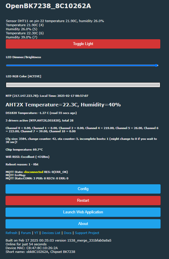

    1538_merge_331bfab0a8a5 NiceMCU:
    OpenBK7238_8C10262A user interface screenshot showing sensor information.
    Info:MAIN:Time 225, idle 0/s, free 122424, MQTT 0(14), bWifi 1, secondsWithNoPing 159, socks 2/20
    Info:SENSOR:DHT start, pin is 22
    Error:SENSOR:DS1820[17] - Family not discovered, but continuing anyway
    Info:SENSOR:DS1820[17] - Starting conversion
    Info:MAIN:Time 226, idle 0/s, free 122424, MQTT 0(14), bWifi 1, secondsWithNoPing 160, socks 2/20
    Error:SENSOR:DS1820[17] - Read Reset failed
    Info:MAIN:Time 227, idle 0/s, free 122424, MQTT 0(14), bWifi 1, secondsWithNoPing 161, socks 2/20
    Error:SENSOR:DS1820[17] - Read CRC=ff != calculated:c9 (errcount=1)
    Error:SENSOR:DS1820[17] - Scratchpad Data Read: ff ff ff ff ff ff ff ff ff
    Info:MAIN:Time 228, idle 0/s, free 122424, MQTT 0(14), bWifi 1, secondsWithNoPing 162, socks 2/20
    Error:SENSOR:DS1820[17] - Read CRC=ff != calculated:c9 (errcount=2)
    Info:MAIN:Time 229, idle 0/s, free 122424, MQTT 0(14), bWifi 1, secondsWithNoPing 163, socks 2/20
    Error:SENSOR:DS1820[17] - Read CRC=ff != calculated:c9 (errcount=3)
    Error:SENSOR:DS1820[17] - Read CRC=ff != calculated:c9 (errcount=4)
    Info:MAIN:Time 231, idle 0/s, free 130728, MQTT 0(14), bWifi 1, secondsWithNoPing 165, socks 2/20
    Info:GEN:No change in channel 6 (still set to 226) - ignoring
    Info:GEN:No change in channel 7 (still set to 39) - ignoring
    Error:SENSOR:DS1820[17] - Read CRC=ff != calculated:c9 (errcount=6)
    1538_merge_331bfab0a8a5 CB3S:
    first read:
    Screenshot of the OBK_DevBoard_CB3S user interface displaying sensor readings and configuration options.
    next:
    Screenshot of the OBK_DevBoard_CB3S interface showing temperature and humidity data.

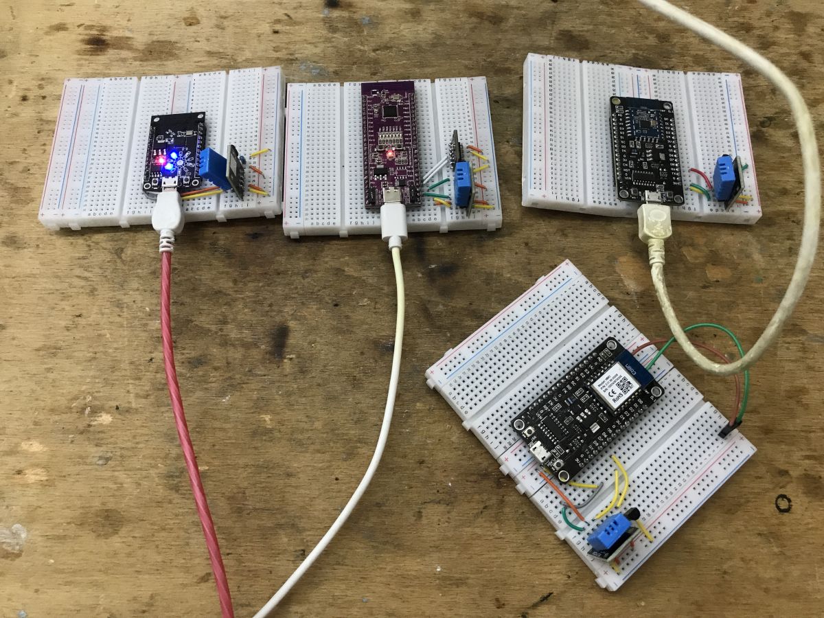

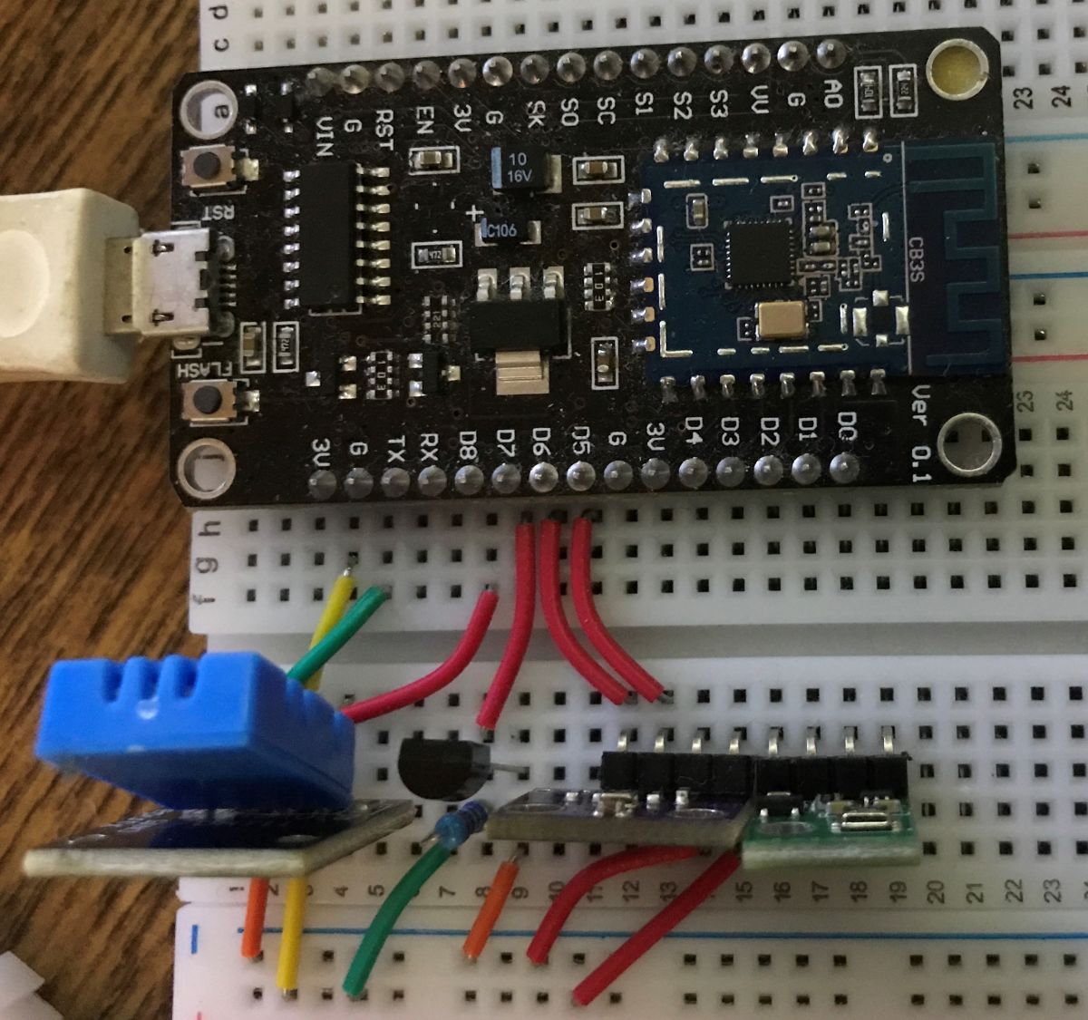

    When I swap DS18B20s, it still work with CB3S. I also swapped resistors. Still, NiceMCU can't read.
    Electronic circuit on a breadboard with a NiceMCU module and several wires.
    Electronic circuit on a breadboard with a NiceMCU module and temperature sensors.
    Maybe I will attempt to check with scope, if I'll manage to get enough free time. I'm still not sure if it's not just a human error, but I triple checked on P15 and P17 (on photo and screenshot).
  • #109 21443290
    max4elektroda
    Posts: 756
    Help: 48
    Rate: 187

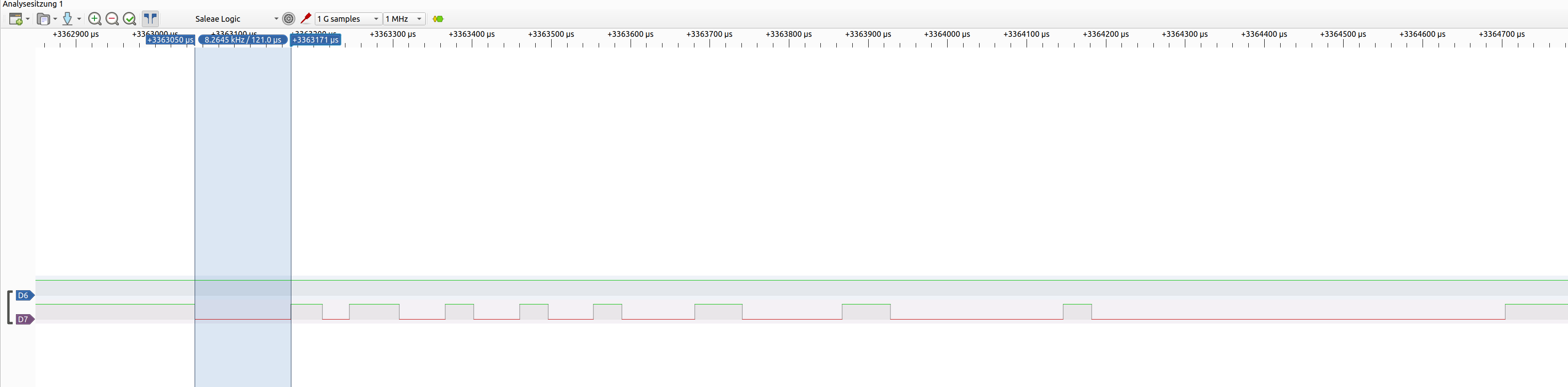

    I tried again with the PR and BK7238 this time - I can't get DS1820 running while DHT11 runs fine.
    I made a simple testing command and if I didn't make a mistake the results show, why it doesn't work:
    This test was "testus 17 5 2 4 6 10 20 50 100 200 500", which should set pin 17 to low for 2, 4, 6, 10, ... 500 us.
    The result for the first test 2us e.g. was over 120us according to the analyzer, but that's probably due to loading the code (it can also be seen on other platforms).
    But if you compare the values 3 4 5 (which should be 6 10 and 20 us), there is no visible difference.
    Screenshot from a logic analyzer showing signal waveforms on D6 and D7.
    Some "measured" values: 58us for 6, 58us for 10, 57us for 20, 126us for 100 and 522us for 500
    The same test on a W800:
    Logic signal waveform graph from an analyzer
    The first test is also longer than the following ones, but after that you can see the length seems good related to the numbers
    (measured 5us for 4, 10.6us for 10, 20,5us for 20 .. and 497 for 500)
    The used code, maybe there is something wrong?!?:

    BK7231U incoming...
    And with it, probably BK7231T with new sdk.
    And all i had to do, was to comment out one line that was added in v3.0.56.
    OpenBK7231U user interface with system information and buttons.
    @p.kaczmarek2 did you check https://github.com/openshwprojects/OpenBK7231T_App/pull/1297 ?
    It contains PSK connecting, that was 'fixed up' and now behind a flag. More info in comment: https://github.com/openshwprojects/OpenBK7231T_App/pull/1297#issuecomment-2761705960
    One question though, why HAL_DisconnectFromWifi is called in WIFI_STA_DISCONNECTED handler? It changed nothing when i removed it, but fixed occasional realtek crashes for me.
  • #112 21507236
    Posts: 14654
    Help: 655
    Rate: 12661
    Great news! What was the single line fix? Is BK7231U that CC8000 chip? I think so. I may still have this module.

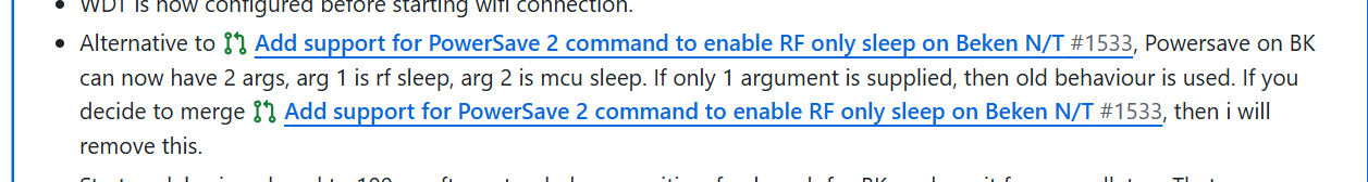

    I can merge it right away if you can confirm that it works. This is a strongly desired change for battery-powered devices. Maybe @divadiow can check. Or I can try to check soon as well myself.
    However... there may be one thing I'd request to be changed.
    That part:
    A section of technical documentation related to PowerSave command support on Beken devices.
    Is RF only or MCU only sleep possible for other platforms as well? Because we're already starting to have per-platform PowerSave syntax.
    Wouldn't it be better to move on to some better syntax that can be more meaningful and just print "not supported" message if it's not available on current platform?
    Something like "PowerSave MCU", "PowerSave MCURF", "PowerSave RF", but of course only add the necessary ones. And don't break compatibility with older syntax, just don't introduce arguments meaning different things per platform.
    Interestingly enough, I remember that original BK7231N SDK had this feature enabled. I know this because it was overwriting the same area where OBK config is in. It was the first bug I had to fix after porting to BK7231N back in the days.

    >>21507236 Yes, i'm using a CC8000 module (HLK-B30).

    Regarding power save, i think most complex one is for ESP. Up to 4 arguments.
    First is default power save(esp_wifi_set_ps), if 1 - WIFI_PS_MIN_MODEM, 2 - WIFI_PS_MAX_MODEM. 0 is WIFI_PS_NONE.
    Second is TX power in dBm.
    Third and fourth is min frequency and max frequency respectively.
    And while powersave for realtek is only 1 argument, in RTL8710B powersave 2 reduces frequency by half, and 3 by quarter.
    So, we need 2 more commands? For powersave, make argument 1 for RF, argument 2, if possible, for MCU. One is for TX power, and another for frequency selection.
    I just replaced line https://github.com/NonPIayerCharacter/beken_f...001d32b6/beken378/func/misc/start_type.c#L249 with #if 0.
    Unfortunately, if i press restart or reset power on U, reboot reason is always pin interrupt.

    >>21507930
    @divadiow
    This version is with fast connect

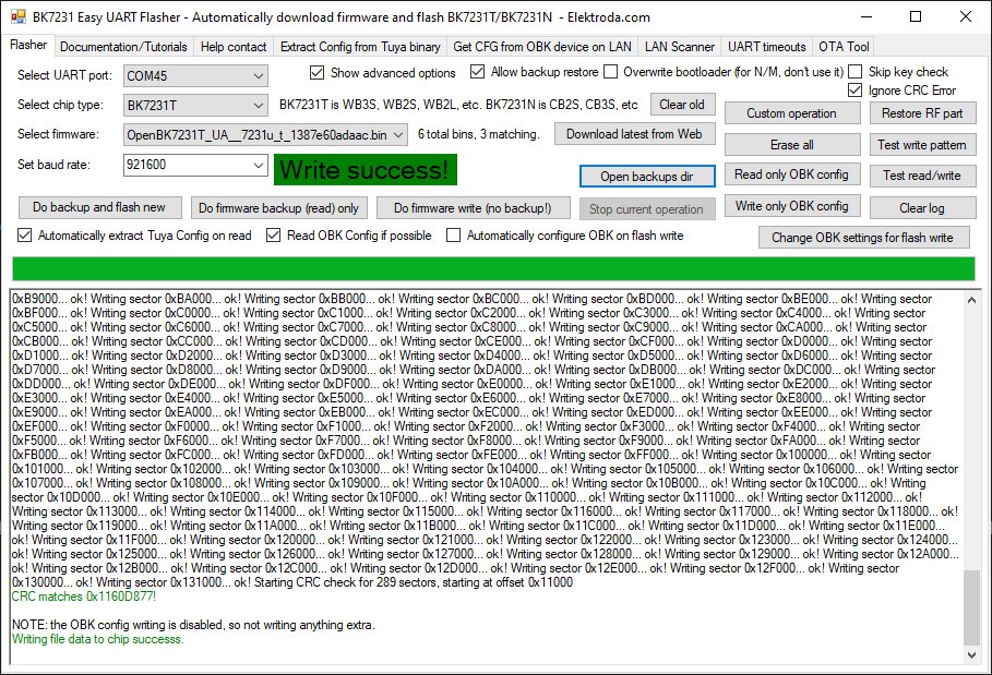

    Added after 5 [hours] 37 [minutes]:
    nice
    Screenshot of the OpenBK7231U device user interface with system information.
    QIO bit-banged to HLK-B30. log from D12
    Added after 6 [minutes]:
    did you fix this? I always have Pwr or Rbt

    >>21507945 I did, you can check latest sdk commit, fix is in beken378/driver/sys_ctrl/sys_ctrl.c, taken from T sdk.

    with original V(0.1.4) I have flashed BK7231U to 0x11000 using EF
    Screen showing firmware flash success in BK7231 Easy UART Flasher tool.
    OTA appears to work still:
    If it's complicated, we can try something simpler but still user friendly.
    Maybe...
    Make "PowerSave" and/or "PowerSave 1" (the ones that appears in many posts as recommendation) could be changed into a "smart" powersave. Make it run the best powersave options for current platform. We could even insert a "are BL0937 pins set" check there to automatically choose RF only or RF+MCU PS.
    And then other PowerSave options could stay per platform if you think that's necessary.
