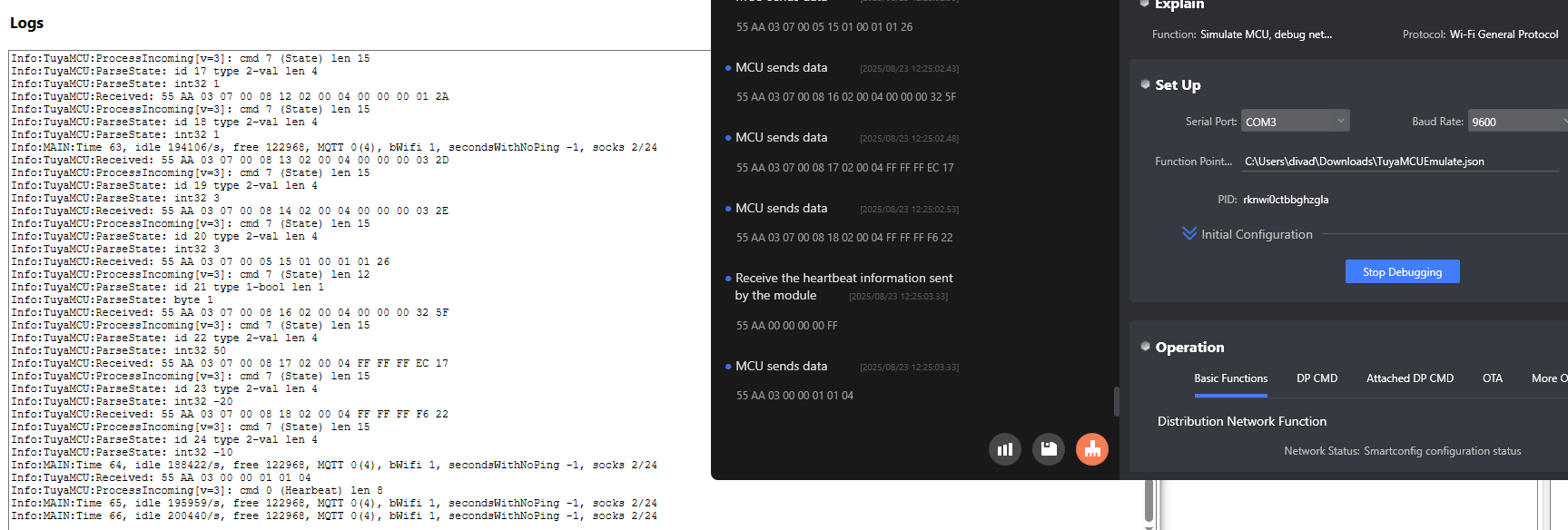

    yay. maybe i can finish soil sensor
    MCU communication logs with Wi-Fi module in Tuya debug interface

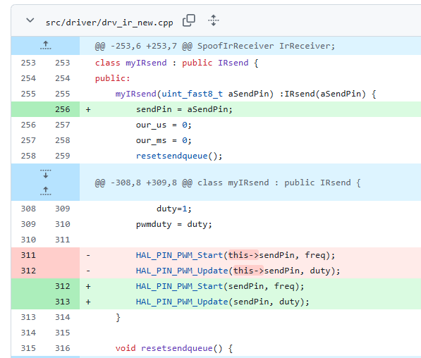

    Tuya BK7252 QIO is fixed, i believe.
    Bootloader was first encrypted, then added default partition table on top of it.
    Added after 1 [hours] 17 [minutes]:
    Well, it turns out sendPin in myIRsend was never set to anything.
    Added after 10 [minutes]:
    Fix uploaded, logic analyzer shows that behaviour is the same as in 1.18.153.
    I also disabled https://github.com/openshwprojects/OpenBK7231...015edf449a6d048d028b1a0f/src/new_pins.c#L2155
    No effect on PWM for me.

  • #264 21645715
    Posts: 14615
    Help: 655
    Rate: 12632
    I saw report that this irRemote issue is fixed, what was wrong? Looks like... you're culling repetitive calls to PWM?
    Now second call to HAL_PIN_PWM_Start will get culled... interestingly enough, you set g_periods[pwmIndex] before culling?
  • #265 21645718
    insmod
    Posts: 1395
    Help: 164
    Rate: 436
    >>21645715
    The issue was that sendPin in myIRsend was never set. So HAL calls did nothing.
  • #266 21645720
    Posts: 14615
    Help: 655
    Rate: 12632
    That's this fix:
    Source code diff showing changes to myIRsend class function in a C++ file.
    So what is the purpose of g_pwm_on?
  • #267 21645722
    insmod
    Posts: 1395
    Help: 164
    Rate: 436
    >>21645720
    So that pwm is not reinitialized on every enableIROut call.
    It wasn't before moving to HALs.
    Plus it simplifies setting g_periods[pwmIndex], compared to what was before.
  • #268 21645732
    Posts: 14615
    Help: 655
    Rate: 12632
    But with this:
    Code: C / C++
    This will ignore period change on repeated init start.... however I'm not sure if it affects anything.
    I'll merge it for now, just curious.
