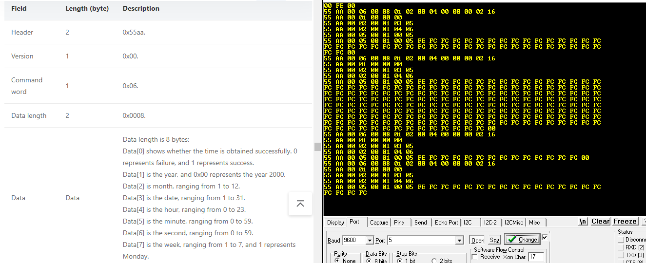

  • OpenBK7231N works, but Wi-Fi–TuyaMCU link corrupts over time
    #153 20567416
    spin55
    Posts: 209
    Help: 17
    Rate: 42

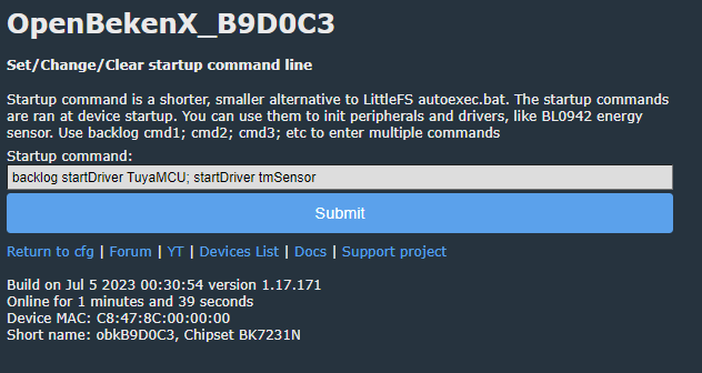

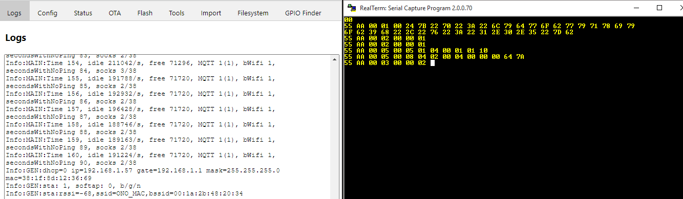

    I'm sorry I can't continue the thread at this time because there are family matters that need my attention.
    p.kaczmarek2, the latest version OpenBK7231N_1.17.98 seems to work fine, but after some time of use the inter-chip communication (Wifi- TuyaMCU) gets corrupted. I think that in 15 days I will have enough time to make a detailed comment on all the problems that I have been encountering. Without monitoring the communication with Realterm it would have been impossible for me to see what is happening.
    Regards

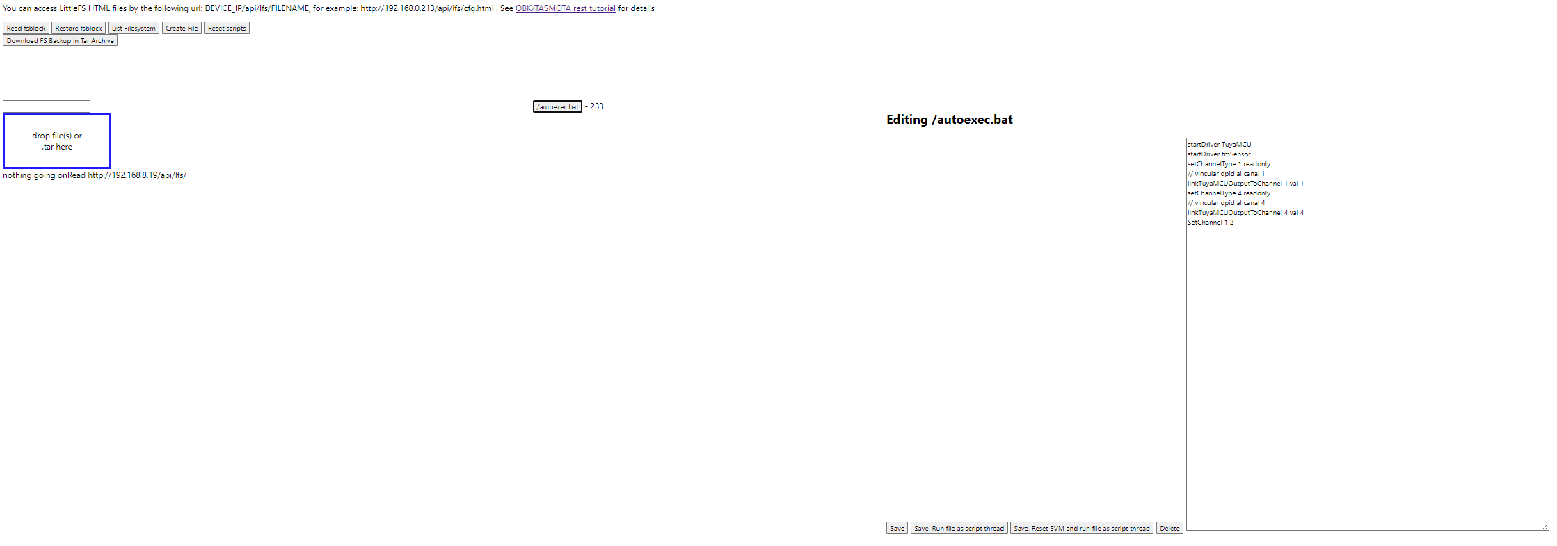

    The ESP82** chip had to be erased before flashing to avoid unstable operation. Is there any possibility to do the same with BK7321N?
    Because I have had to make multiple firmware changes during the tests, both via USB and OTA, I have been able to see strange behaviors reminiscent of the ESP82** when they were not previously erased.

    Thanks for the clarification.

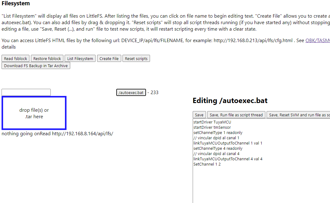

    Is it normal that the SSID and Wifi Password data are kept after flashing via USB?
    Until now, the OTA update destroyed the autoexec.bat configuration. It no longer destroys it in the latest firmware versions?
  • OTA now preserves autoexec on affected N devices
    #157 20577886
    DeDaMrAz
    Posts: 623
    Help: 34
    Rate: 130
    Regarding OTA update, LFS purge was a problem that was only influencing N devices and was fixed in one of the previous versions, so autoexec will stay intact after OTA update as the autoexec deletion is bringing more problems than it solves.
    There is an issue that affects certain N devices that is reflecting exactly as you described and for such devices RF recovery is not recommended as well as it can interfere with WiFi functionality and destroy the MAC address - meaning it is known and can be replicated (I have 2 such devices).

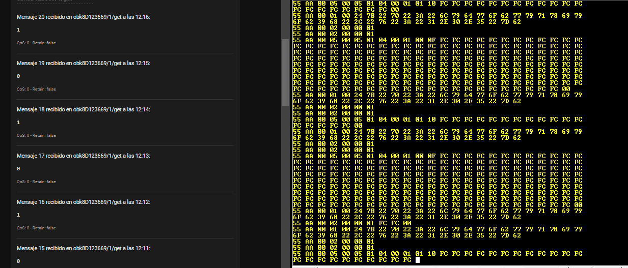

  • Forced MQTT publish for motion reset state
    #158 20577962
    spin55
    Posts: 209
    Help: 17
    Rate: 42

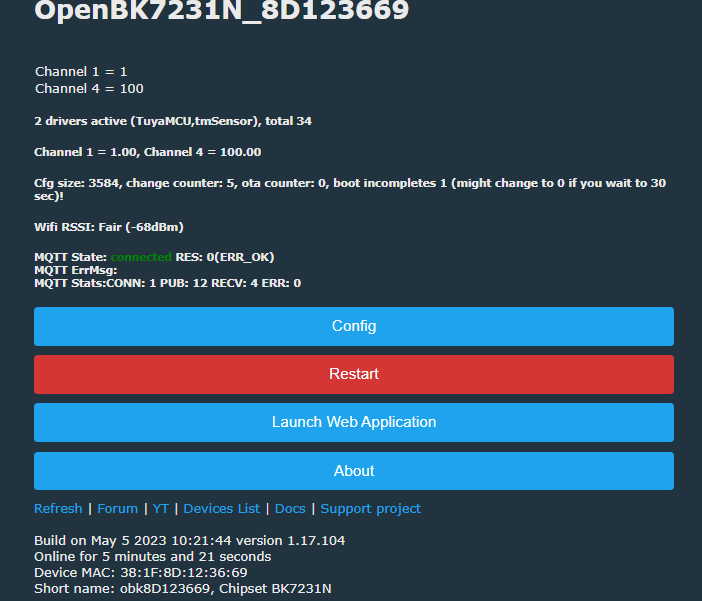

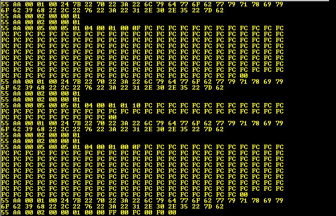

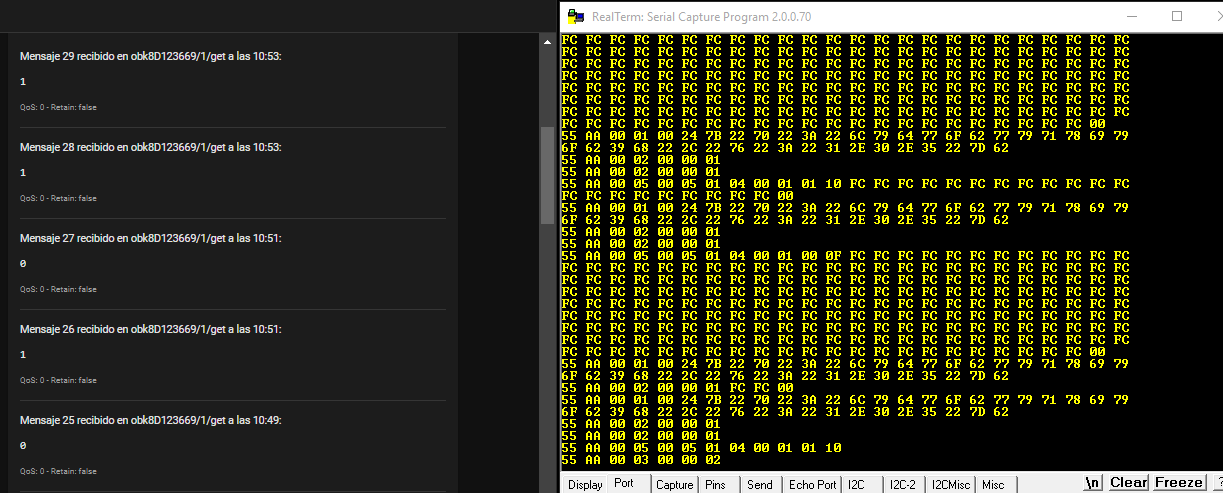

    With the latest firmware versions the device works "almost" fine.
    OpenBK7231N_1.17.104.rbl
    Let's see if I can describe step by step what I've seen:
    It starts working fine. It transmits the detection information but only publishes the reset information. For this reason only 1 is published in MQTT, the one for motion detection (0) is not published because it assumes that the variable is already at zero and does not change. I've fixed it by forcing publish with a script called from autoexec.bat.
    MQTT log:
    Message 22 received on obk1F8D1236/1/get at 11:18:
    1
    QoS: 0 - Retain: false
    Message 21 received on obk1F8D1236/1/get at 11:14:
    1
    Message 20 received on obk1F8D1236/1/get at 11:13:
    1
    Message 19 received on obk1F8D1236/1/get at 11:09:
    1
    Message 18 received on obk1F8D1236/1/get at 11:04:
    1
    Message 17 received on obk1F8D1236/1/get at 11:04:
    1
    Message 16 received on obk1F8D1236/1/get at 11:02:
    1
    Message 15 received on obk1F8D1236/1/get at 11:00:
    1
    Message 14 received on obk1F8D1236/1/get at 10:55:
    1
    Message 13 received on obk1F8D1236/1/get at 10:52:
    1
    Message 12 received on obk1F8D1236/1/get at 10:49:
    1
    Message 11 received on obk1F8D1236/1/get at 10:42:
    1
    Message 10 received on obk1F8D1236/1/get at 10:39:
    1
    Message 9 received on obk1F8D1236/1/get at 10:33:
    1
    Message 8 received on obk1F8D1236/1/get at 10:30:
    1
    Message 7 received on obk1F8D1236/1/get at 10:27:
    1
    Message 6 received on obk1F8D1236/1/get at 10:21:
    1
    Message 5 received on obk1F8D1236/1/get at 10:19:
    1
    Message 4 received on obk1F8D1236/1/get at 10:16:
    1
    Message 3 received on obk1F8D1236/1/get at 10:11:
    1
    Message 2 received on obk1F8D1236/1/get at 10:06:
    1
    Message 1 received on obk1F8D1236/1/get at 10:04:
    1
    Message 0 received on obk1F8D1236/1/get at 10:01:
    0
    QoS: 0 - Retain: true

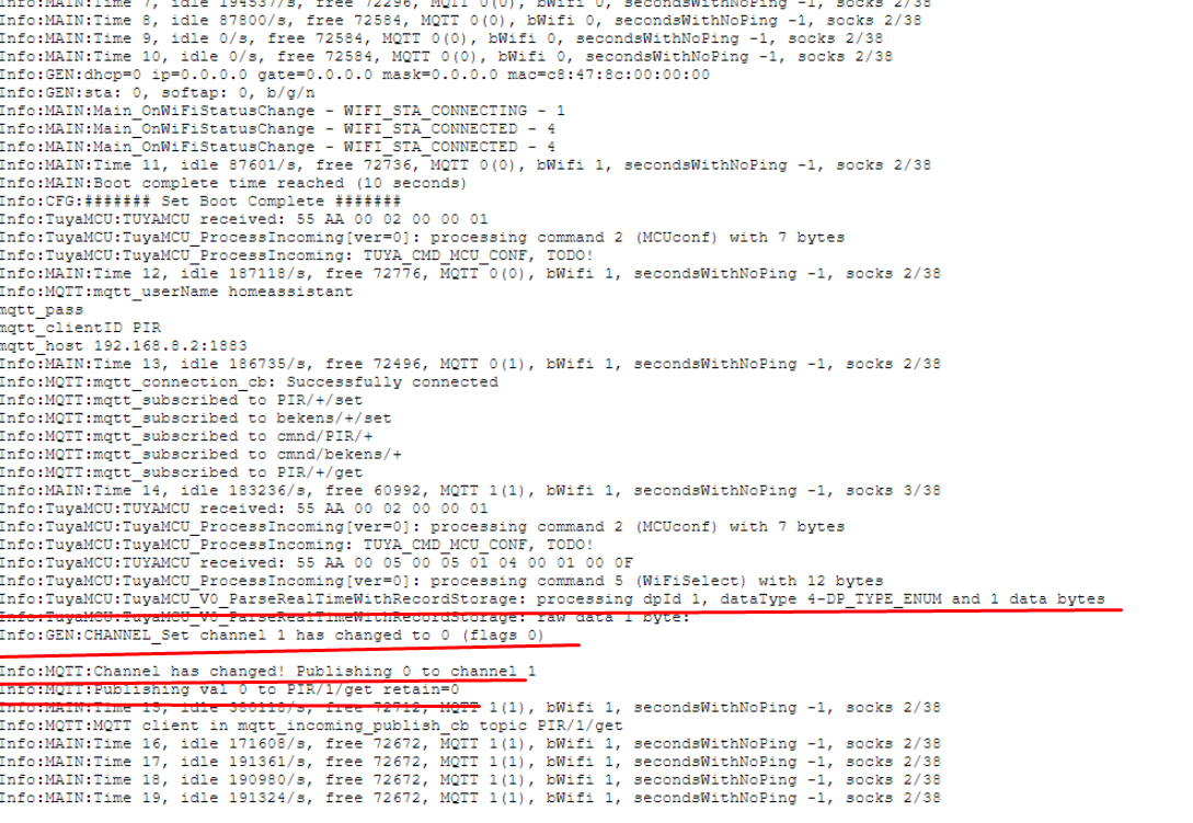

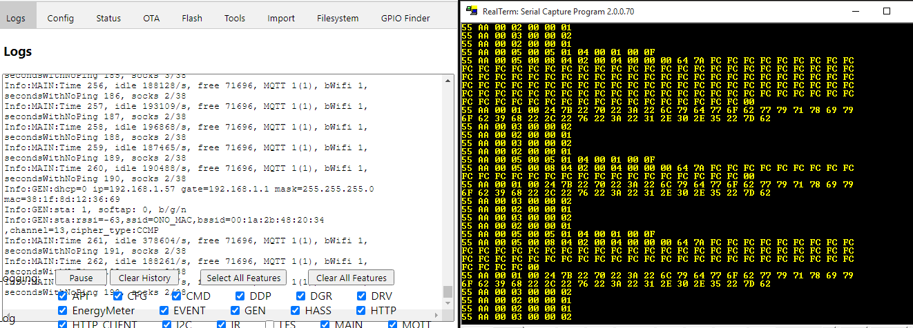

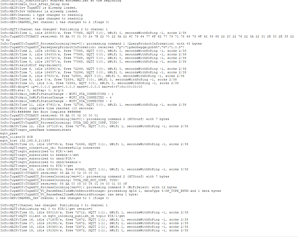

    WebApp Log:
    Info:CFG:####### Boot Count 1 #######
    Warn:CFG:CFG_InitAndLoad: Correct config has been loaded with 9 changes count.
    Info:MAIN:Main_Init_Delay
    Info:MAIN:ssid:ONO_MAC key:
    Info:MAIN:Using SSID []
    Info:MAIN:Using Pass []
    Info:MQTT:MQTT_RegisterCallback called for bT obk1F8D1236/ subT obk1F8D1236/+/set
    Info:MQTT:MQTT_RegisterCallback called for bT bekens/ subT bekens/+/set
    Info:MQTT:MQTT_RegisterCallback called for bT cmnd/obk1F8D1236/ subT cmnd/obk1F8D1236/+
    Info:MQTT:MQTT_RegisterCallback called for bT cmnd/bekens/ subT cmnd/bekens/+
    Info:MQTT:MQTT_RegisterCallback called for bT obk1F8D1236/ subT obk1F8D1236/+/get
    Info:MAIN:Started TuyaMCU.
    Info:MAIN:Started tmSensor.
    Info:GEN:Channel 1 type changed to readonly
    Info:GEN:Channel 4 type changed to readonly
    Info:MAIN:Time 1, idle 275224/s, free 71736, MQTT 0(0), bWifi 0, secondsWithNoPing -1, socks 2/38
    Info:TuyaMCU:TUYAMCU received: 55 AA 00 01 00 24 7B 22 70 22 3A 22 6C 79 64 77 6F 62 77 79 71 78 69 79 6F 62 39 68 22 2C 22 76 22 3A 22 31 2E 30 2E 35 22 7D 62
    Info:TuyaMCU:TuyaMCU_ProcessIncoming[ver=0]: processing command 1 (QueryProductInformation) with 43 bytes
    Info:TuyaMCU:TuyaMCU_ParseQueryProductInformation: received {"p":"lydwobwyqxiyob9h","v":"1.0.5"}
    Info:MAIN:Time 2, idle 185637/s, free 71736, MQTT 0(0), bWifi 0, secondsWithNoPing -1, socks 2/38
    Info:MAIN:Time 3, idle 63129/s, free 71752, MQTT 0(0), bWifi 0, secondsWithNoPing -1, socks 2/38
    Info:MAIN:Time 4, idle 0/s, free 71752, MQTT 0(0), bWifi 0, secondsWithNoPing -1, socks 2/38
    Info:MAIN:Time 5, idle 0/s, free 71752, MQTT 0(0), bWifi 0, secondsWithNoPing -1, socks 2/38
    Info:MQTT:mqtt_userName
    mqtt_pass
    mqtt_clientID obk1F8D1236
    mqtt_host 192.168.1.45:1883
    Info:MAIN:Time 6, idle 109285/s, free 71376, MQTT 0(1), bWifi 1, secondsWithNoPing -1, socks 2/38
    Info:TuyaMCU:TUYAMCU received: 55 AA 00 02 00 00 01
    Info:TuyaMCU:TuyaMCU_ProcessIncoming[ver=0]: processing command 2 (MCUconf) with 7 bytes
    Info:TuyaMCU:TuyaMCU_ProcessIncoming: TUYA_CMD_MCU_CONF, TODO!
    Info:MAIN:Time 7, idle 182606/s, free 71224, MQTT 0(1), bWifi 1, secondsWithNoPing -1, socks 2/38
    Info:MAIN:Time 8, idle 188253/s, free 71032, MQTT 0(1), bWifi 1, secondsWithNoPing -1, socks 2/38
    Info:MAIN:Time 9, idle 189599/s, free 71800, MQTT 0(1), bWifi 1, secondsWithNoPing -1, socks 2/38
    Info:MQTT:mqtt_subscribed to obk1F8D1236/+/set
    Info:MQTT:mqtt_subscribed to bekens/+/set
    Info:MQTT:mqtt_subscribed to cmnd/obk1F8D1236/+
    Info:MQTT:mqtt_subscribed to cmnd/bekens/+
    Info:MQTT:mqtt_subscribed to obk1F8D1236/+/get
    Info:MQTT:MQTT client in mqtt_incoming_publish_cb topic obk1F8D1236/1/get
    Info:MQTT:MQTT client in mqtt_incoming_publish_cb topic obk1F8D1236/4/get
    Info:MQTT:Publishing val obk1F8D1236 to obk1F8D1236/host retain=0
    Info:MAIN:Time 10, idle 180659/s, free 71800, MQTT 1(1), bWifi 1, secondsWithNoPing -1, socks 2/38
    Info:GEN:dhcp=0 ip=192.168.1.57 gate=192.168.1.1 mask=255.255.255.0 mac=38:1f:8d:12:36:69
    Info:GEN:sta:rssi=-63,ssid=,bssid=00:1a:2b:48:20:34 ,channel=13,cipher_type:CCMP
    Info:MQTT:Publishing val Build on May  3 2023 09:13:10 version 1.17.98 to obk1F8D1236/build retain=0
    Info:TuyaMCU:TUYAMCU received: 55 AA 00 05 00 05 01 04 00 01 01 10
    Info:TuyaMCU:TuyaMCU_ProcessIncoming[ver=0]: processing command 5 (WiFiSelect) with 12 bytes
    Info:TuyaMCU:TuyaMCU_V0_ParseRealTimeWithRecordStorage: processing dpId 1, dataType 4-DP_TYPE_ENUM and 1 data bytes
    Info:TuyaMCU:TuyaMCU_V0_ParseRealTimeWithRecordStorage: raw data 1 byte:
    Info:GEN:CHANNEL_Set channel 1 has changed to 1 (flags 0)
    Info:MQTT:Channel has changed! Publishing 1 to channel 1
    Info:MQTT:Publishing val 1 to obk1F8D1236/1/get retain=0
    Info:MAIN:Time 11, idle 190493/s, free 71800, MQTT 1(1), bWifi 1, secondsWithNoPing -1, socks 2/38
    Info:MQTT:Publishing val 38:1f:8d:12:36:69  to obk1F8D1236/mac retain=0
    Info:MAIN:Time 12, idle 175848/s, free 60104, MQTT 1(1), bWifi 1, secondsWithNoPing -1, socks 3/38
    Info:MQTT:Publishing val 2 to obk1F8D1236/sockets retain=0
    Info:MAIN:Time 13, idle 183632/s, free 71568, MQTT 1(1), bWifi 1, secondsWithNoPing -1, socks 2/38
    Info:MQTT:Publishing val -63 to obk1F8D1236/rssi retain=0
    Info:MAIN:Time 14, idle 189787/s, free 71800, MQTT 1(1), bWifi 1, secondsWithNoPing -1, socks 2/38
    Info:MQTT:Publishing val 14 to obk1F8D1236/uptime retain=0
    Info:MAIN:Time 15, idle 187475/s, free 71800, MQTT 1(1), bWifi 1, secondsWithNoPing -1, socks 2/38

    Info:MAIN:Time 6, idle 109450/s, free 71176, MQTT 0(1), bWifi 1, secondsWithNoPing -1, socks 2/38
    Info:MAIN:Time 7, idle 297145/s, free 71024, MQTT 0(1), bWifi 1, secondsWithNoPing -1, socks 2/38
    Info:MAIN:Time 8, idle 189474/s, free 71792, MQTT 0(1), bWifi 1, secondsWithNoPing -1, socks 2/38
    Info:MAIN:Time 9, idle 188021/s, free 71336, MQTT 1(1), bWifi 1, secondsWithNoPing -1, socks 3/38
    Info:TuyaMCU:TUYAMCU received: 55 AA 00 05 00 05 01 04 00 01 00 0F
    Info:GEN:No change in channel 1 (still set to 0) - ignoring
    Info:MAIN:Time 10, idle 192406/s, free 71584, MQTT 1(1), bWifi 1, secondsWithNoPing -1, socks 2/38
    Info:MAIN:Time 11, idle 182696/s, free 71544, MQTT 1(1), bWifi 1, secondsWithNoPing -1, socks 2/38
    Info:MAIN:Time 12, idle 197047/s, free 71560, MQTT 1(1), bWifi 1, secondsWithNoPing -1, socks 2/38
    Info:MAIN:Time 13, idle 191860/s, free 71560, MQTT 1(1), bWifi 1, secondsWithNoPing -1, socks 2/38
    Info:MQTT:Publishing val 13 to obk1F8D1236/uptime retain=0
    Info:MAIN:Time 14, idle 191642/s, free 71560, MQTT 1(1), bWifi 1, secondsWithNoPing -1, socks 2/38

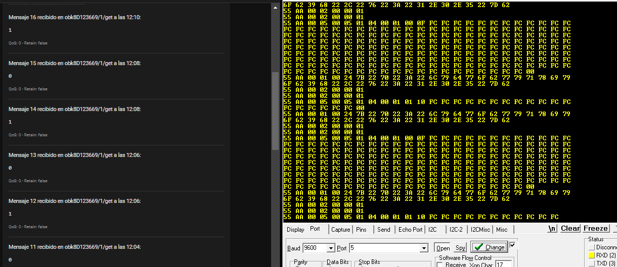

    autoexec.bat
    startDriver TuyaMCU
    startDriver tmSensor
    setChannelType 1 readonly
    // vincular dpid al canal 1
    setChannelType 4 readonly
    // vincular dpid al canal 4
    linkTuyaMCUOutputToChannel 4 val 4
    startScript pir.bat
    pir.bat
    addRepeatingEvent 10 -1 publish "1" $CH1
    MQTT log (with pir.bat):
    Message 25 received on obk8D123669/1/get at 16:42:
    0
    Message 24 received on obk8D123669/1/get at 16:41:
    1
    Message 23 received on obk8D123669/1/get at 16:41:
    1
    Message 22 received on obk8D123669/1/get at 16:36:
    0
    Message 21 received on obk8D123669/1/get at 16:36:
    1
    Message 20 received on obk8D123669/1/get at 16:36:
    1
    Message 19 received on obk8D123669/1/get at 16:32:
    0
    Message 18 received on obk8D123669/1/get at 16:31:
    1
    Message 17 received on obk8D123669/1/get at 16:31:
    1
    Message 16 received on obk8D123669/1/get at 16:28:
    1
    Message 15 received on obk8D123669/1/get at 16:28:
    1
    Message 14 received on obk8D123669/1/get at 16:22:
    1
    Message 13 received on obk8D123669/1/get at 16:22:
    1
    Message 12 received on obk8D123669/1/get at 16:16:
    0
    Message 11 received on obk8D123669/1/get at 16:16:
    1
    Message 10 received on obk8D123669/1/get at 16:16:
    1
    Message 9 received on obk8D123669/1/get at 16:12:
    0
    Message 8 received on obk8D123669/1/get at 16:08:
    0
    Message 7 received on obk8D123669/1/get at 16:08:
    1
    Message 6 received on obk8D123669/1/get at 16:05:
    0
    Message 5 received on obk8D123669/1/get at 16:04:
    1
    Message 4 received on obk8D123669/1/get at 16:01:
    0
    Message 3 received on obk8D123669/1/get at 16:01:
    1
    Message 2 received on obk8D123669/1/get at 16:01:
    1
    Message 1 received on obk8D123669/1/get at 15:59:
    0
    Message 0 received on obk8D123669/1/get at 15:58:
    1
    Sometimes the replenishment is skipped. Others do not respond. Sometimes it does not publish the detection. All this while the communication between chips is correct (monitored with Realterm).
    More tomorrow...

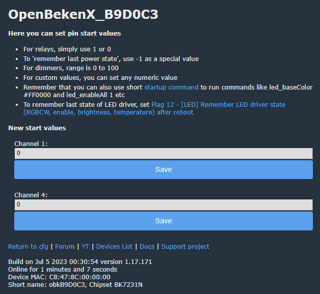

  • Use SetStartValue to restore last channel state
    #160 20578050
    Posts: 14811
    Rate: 12978
    Hmm nice, but maybe instead of forcing a publish, just use SetStartValue to make channel remember its previous value after reboot? I am not sure...
    but the usage would be like:
    SetStartValue channelIndex -1
    start value -1 means "remember last state".
    Or... if you don't want to save value in flash... you could do a setChannel in autoexec.bat and set it to for example, value like 999 or just -1, so both 0 and 1 makes a change...

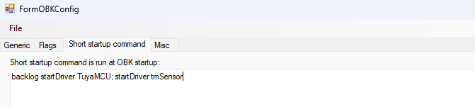

    Very nice proposal that would prevent double posting, but I can't access autoexec.bat because the device doesn't go into pairing mode with this firmware.

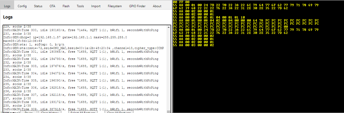

    55 AA 00 03 00 00 02
    55 AA 00 03 00 00 02 -->  Here it should stop
    55 AA 00 05 00 08 04 02 00 04 00 00 00 64 7A FC FC FC FC FC FC FC FC FC
    FC FC FC FC FC FC FC FC FC FC FC FC FC F
    Added after 5 [minutes]:
    Go on:

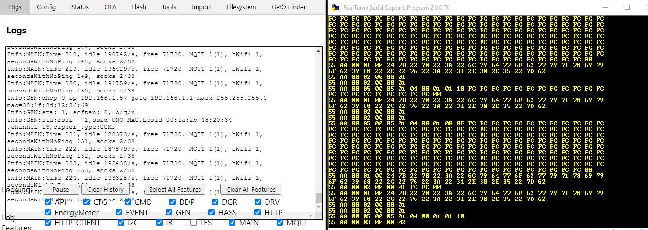

    When the communication between MCU's gets corrupted, what I do is flash via USB the OpenBK7231N_QIO_1.15.599.bin firmware that allows me to pair and access WebApp to configure autoexec.bat. Once this is done I update via OTA to the current firmware. I do it this way because often you can't put the device in pairing mode with this firmware.
    I have also verified that the MAC is set to 0 when the copy of the original firmware is loaded via USB and it is returned to Openbeken.
    As I have already mentioned, I have a device that has an ESP8266 chip flashed with Esphome. I took screenshots of the communication between MCU's with Realterm and compared to the one that BK7321N has, there are important differences in the way of processing the information. They use different versions of the Tuya protocol and I think that the version {"P":"Okurono2XLVRV0fB","v":"1.1.0"} that TuyaMCU Esphome has is more efficient because it saves better battery consumption, compared to version { "p":"lydwobwyqxiyob9h","v":"1.0.5"} running TuyaMCU OpenBeken.
    ESP8266 Log Rx:
    55 AA 00 01 00 24 7B 22 50 22 3A 22 4F 6B 75 72 6F 6E 6F 32 58 4C 56 52
    56 30 66 42 22 2C 22 76 22 3A 22 31 2E 31 2E 30 22 7D 19
    55 AA 00 05 00 0A 65 01 00 01 00 66 04 00 01 03 E3
    BK7321N Log Rx:
    FC FC FC FC FC FC FC FC FC FC FC FC FC FC FC FC FC FC FC FC FC FC FC 00
    55 AA 00 05 00 05 01 04 00 01 00 0F FC FC FC FC FC FC FC FC FC FC FC FC
    FC FC FC FC FC FC FC FC FC FC FC FC FC FC FC FC FC FC FC FC FC FC FC FC
    BK7321N makes two Wi-Fi connections: one to send the motion sensor reset (55 AA 00 05 00 05 01 04 00 01 01 10) and another to report that there is an intrusion (55 AA 00 05 00 05 01 04 00 01 00 0F).
    ESP8266 only makes one connection to send intrusion (55 AA 00 05 00 0A 65 01 00 01 00 66 04 00 01 03 E3). Send sensor and battery status in the same command 05.
    In addition, the reset time of the motion sensor in BK7321N is 2 minutes or more and sometimes it fails. The one for ESP8266 is much shorter.
    But this depends on the firmware of the TuyaMCU chip, so for the moment it is untouchable, unless someone dares to reprogram it.
    Another thing that is observed with Realterm, is that there are no FC's between chip communications in ESP8266. Imagine the amount of FC generated for 2 minutes or more. There are not so many here because I have edited them.
    ESP8266 Log Tx:
    55 AA 00 01 00 00 00
    55 AA 00 02 00 01 02 04
    55 AA 00 02 00 01 03 05
    55 AA 00 02 00 01 04 06
    55 AA 00 05 00 01 00 05 49 00 FF 04 80 3D F3 FE FE
    BK7321N Log Tx:
    55 AA 00 05 00 01 00 05 FC FC FC FC FC FC FC FC FC FC FC FC FC FC FC FC
    In the ESP8266 Tx line, one more command line can be seen Report the network status of the device (55 AA 00 02 00 01 03 05 --> Wi-Fi has been configured, but not connected to the router).
    https://developer.tuya.com/en/docs/iot/tuyacl...niversalserialaccessprotocol?id=K95afs9h4tjjh

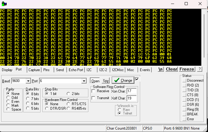

  • TuyaMCU communication corruption after two days

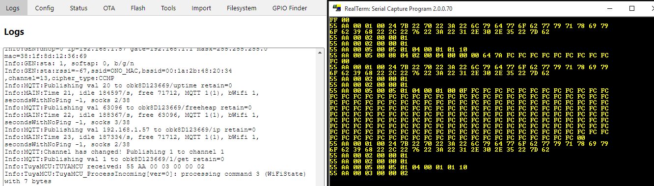

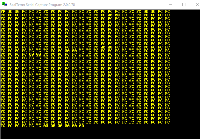

    #162 20579398
    spin55
    Posts: 209
    Help: 17
    Rate: 42

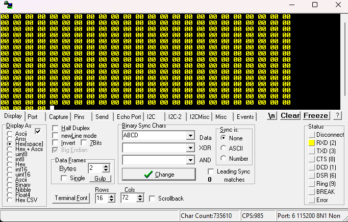

    After two days of proper communication between MCU's, it starts to get corrupted. On the first and second reboots it can be seen that it doesn't even respond to the 01 command anymore. It's like the TuyaMCU driver is not loaded. autoexec.bat corruption?
    Corruption Begins:
    FC FC FC 00
    55 AA 00 02 00 00 01 00 00 00 00 00 00 00 00 00 00 00 00 FC FC FC FC FC
    FC FC FC FC FC FC FC FC FC FC FC FC 00 00 00 00 00 00 00 00 00 00 00 00
    00 00 00 00 00 00 00 00 00 00 00 00 00 00 00 00 00 00 00 00 00 00 00 00
    00 00 00 00 00 00 00 00 00 00 00 00 00 00 00 00 00 FC FC FC FC FC FC FC
    FC FC FC FC FC FC FC FC FC FC 00 00 00 00 00 00 00 00 00 00 00 00 00 00
    00 00 00 00 00 00 00 00 00 00 00 00 00 00 00 00 00 00 00 00 FC FC FC FC
    00 00 00 00 00 00 00 00 00 00 00 00 00 00 00 00 00 00 00 00 00 FC FC FC
    FC FC FC FC FC FC FC FC FC FC FC FC FC FC 00 00 00 00 00 00 00 00 00 00
    New boot:
    FF 00 00 00 00 00 00 00 00 00 00 00 00 00 00 00 00 00 00 00 00 00 00 00
    00 00 00 00 00 00 00 00 00 00 FC FC FC FC FC FC FC FC FC FC FC FC FC FC
    FC FC FC 00 00 00 00 00 00 00 00 00 00 00 00 00 00 00 00 00 00 00 00 00
    00 00 00 00 00 00 00 00 00 00 00 00 00 FC FC FC FC FC FC FC FC FC FC FC
    FC FC FC FC FC FC 00 00 00 00 00 00 00 00 00 00 00 00 00 00 00 00 00 00
    00 00 00 00 00 00 00 00 00 00 00 FC FC FC FC FC FC FC FC FC FC FC FC FC
    00 00 00 00 00 00 00 00 00 00 00 00 00 00 00 00 00 00 00 00 00 00 FC FC
    New boot:
    FE 00 00 00 00 00 00 00 00 00 00 00 00 00 00 00 00 00 00 00 00 00 00 00
    00 00 00 00 00 00 00 00 00 00 00 00 00 00 00 FC FC FC FC FC FC FC FC FC
    FC FC FC FC FC FC FC FC 00 00 00 00 00 00 00 00 00 00 00 00 00 00 00 00
    00 00 00 00 00 00 00 00 00 00 00 00 00 00 FC FC FC FC FC FC FC FC FC FC
    00 00 00 00
  • SetChannel 1 2 fixes MQTT duplication
    #163 20582898
    spin55
    Posts: 209
    Help: 17
    Rate: 42

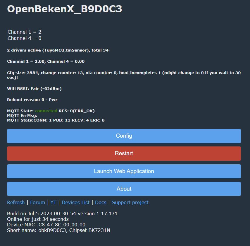

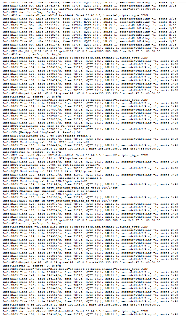

    p.kaczmarek2, I was about to validate your firmware OpenBK7231N_QIO_1.17.104 and suddenly I find myself again with symptoms of what I call code corruption.
    Those 00s that you see seem to be generated by TuyaMCU to try to communicate with the Wifi module, but the communication between chips according to the Tuya protocol disappears as if autoexec.bat was not executed to load the tuyaMCU and tmSensor drivers.
    Motion sensor with BK7231N and TuyaMCU battery powered devices protocol
    I was able to access autoexec.bat and edit it to add SetChannel 1 2 as you suggested and it works. There is no duplication of posts in MQTT anymore.
    autoexec.bat
    startDriver TuyaMCU
    SetChannel 1 2
    MQTT Log

    I had timed the reset cadence and it is 1 minute and 16 seconds. And as seen in the following screenshot, it is practically identical in each cycle.
    When I saw that the operation was already stable, I tried to put it in pairing mode and I succeeded, but as a result of that the code corruption problems began. I don't know if it's a consequence of this or it's just a coincidence, but right now the pir motion device is inoperative and I will once again carry out the already described process of downgrading via USB to the OpenBK7231N_QIO_1.15.599 firmware that will allow me to configure autoexec.bat without fear of cuts .
  • Original firmware restored RF and TuyaMCU communication

    I think the RF part of the chip has been corrupted because, although I can flash it via USB with other Openbeken firmwares, there is no communication according to Tuya protocol between chips nor can I create wifi AP by disconnecting and reconnecting repeatedly. The TuyaMCU chip tries to communicate with BK7321N but gets no response.
    So I reloaded the backup of the original firmware and, despite losing the MAC, it seems that it has regenerated the RF part and is operational again. I can now update both via USB and OTA. I have been able to configure autoexec.bat according to what was published in previous posts and I see that the OpenBK7231N_1.17.104.rbl firmware works fine while the communication between chips remains within the Tuya protocol.
    I'll let it run for a few days to see if the code corruption issue reproduces.

    Sorry for the later reply. To the best of my knowledge, the latest OBK should work at least BETTER than the old one, so I am not sure why downgrading was helping in your case.
    I will, however, note here that you may be right with that corruption. During my testing, I have experienced one strange issue. Basically, I have used very old batteries, with very low voltage and it somehow bricked CB3S, and I had to flash it again so it can with new batteries. There was no problem with recovering it, but still, it was a surprising issue..
    Regarding FC:
    FC FC FC FC FC FC F
    I think I saw it several times while testing door sensors with TuyaMCU and it was just a noise caused by one of the modules (WiFi or MCU, I don't remember) being off. I didn't consider it a problem.
    So I would say there are two options:
    1. it's a low battery problem, maybe your battery is too discharged?
    2. what do you have here:
    Maybe it goes into safe mode?
    It would be interesting to see how @DeDaMrAz 's humidity/temperature TuyaMCU sensor from this topics works for him, after a longer time, is it still stable?
    https://www.elektroda.com/rtvforum/topic3975583.html
    Food with external stabilized source of 3.3V.
    Motion sensor with BK7231N and TuyaMCU battery powered devices protocol Motion sensor with BK7231N and TuyaMCU battery powered devices protocol
    I don't see Wi-Fi SSID AP
    For now I'm going to leave it with this firmware to parcel out the cause of the possible corruption of autoexec.bat
    NOTE: It would be very interesting to be able to implement a response to command 10 in the wifi module to try to shorten the reset time of the sensor, but we would have to discover how to make tuyaMCU generate the request for that command 10.

    #167 20587122
    spin55
    Posts: 209
    Help: 17
    Rate: 42
    I usually monitor the Rx line with Realterm and I have never seen a 06 command request from TuyaMCU. However, you have implemented a command 06 in BK7231N that simulates sending a dummy date.
    According to Tuya's documentation:
    Obtain the local time
    Note:
    Start to send a data packet to obtain the local time, after the device is connected to network, that is, the device receives status 5 through the command of “reporting the network status of the device”.
    After the device is connected to the server, if the network performance is poor, it might fails to obtain time data. Regarding time-dependent devices, such as locks, if local time is not calibrated and it fails to obtain time data, it is required to obtain the time value every 3 seconds, in order to obtain time data successfully.
    MCU sends the following command: 55 aa 00 06 00 00 05
    The module returns the following command: 55 aa 00 06 00 08 01 12 09 11 10 09 05 01 59
    The preceding example represents the local time of Monday, September 17, 2018, 16:09:05.
    I deduce from this information that TuyaMCU sends command 06 after receiving command 02 notifying that there is already a connection to the router and cloud. This request is received by the wifi module and responds with another command 06 that contains the data of the current date.
    That is, as it is implemented, that command 06 does nothing. It is a situation similar to the 08 command that was sent in previous firmwares.
    In any case, I don't think this is of any importance because TuyaMCU ignores the command.
    I continue with the tests and at the moment this firmware works fine. Starting Monday, if there is no incident, I will start playing with the pairing to see if I am able to reproduce the anomalies described in previous posts.
    Good weekend.

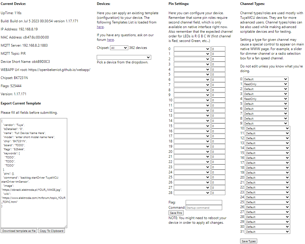

    As I had commented, today I began to carry out tests to put the device in pairing mode and I have verified the difficulty to achieve it with this firmware.
    Until now I followed the instructions in the manual and managed to do it without problems with other previous firmwares, but with this firmware it seems like a lottery.
    The process is already described throughout the thread and is as follows:
    How to reset?
    (1) Press the reset button for 6 seconds till the indicator flash rapidly. Then device turn to smart wifi mode.
    (2) Press the reset button again for 6 seconds till the indicator flash slowly. The device turns to AP mode.
    Device Status                LED State
    Smart Wi Fi                    Indicator flashes quicly
    AP mode                        Indicator flashes slowly
    Triggered                       LED will rapidly blink and OFF after scheduled time
    Suspend mode              Indicator OFF
    Reset                               Indicator lights up for 4s and after 2seconds ligths OFF. Device goes
                                             into configuration mode
    Main function
    Operate status: alarma/ normal (the device can be triggered only once 1 minute)

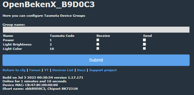

    I have found that it is possible to put it into pairing mode with a single long press instead of two, but you have to do it when you have just sent the 05 command and before the communication drops. Monitoring the Rx line with Realterm is relatively easy to achieve.
    The process looks like this:
    Failed attempts:
    For now it is still working fine.
    Mensaje 23 recibido en obk8D123669/1/get a las 10:47:

    And get into pairing mode the first time with a single long press of the configuration button.
    And here you can see the entire sequence from connecting the device to +Vcc to putting it into pairing mode, including the sensor reset period which takes approximately 1 minute 16 seconds.
    And the Log of the entire sequence.
     obk8D123669/ subT obk8D123669/+/set
    Info:MQTT:MQTT_RegisterCallback called for bT cmnd/obk8D123669/ subT cmnd/obk8D123669/+
    Info:MQTT:MQTT_RegisterCallback called for bT obk8D123669/ subT obk8D123669/+/get
    Info:GEN:CHANNEL_Set channel 1 has changed to 2 (flags 0)
    Info:MQTT:Channel has changed! Publishing 2 to channel 1
    Info:MAIN:Time 1, idle 275151/s, free 76400, MQTT 0(0), bWifi 0, secondsWithNoPing -1, socks 2/38
    Info:MAIN:Time 2, idle 190129/s, free 76400, MQTT 0(0), bWifi 0, secondsWithNoPing -1, socks 2/38
    Info:MAIN:Time 3, idle 182774/s, free 76400, MQTT 0(0), bWifi 0, secondsWithNoPing -1, socks 2/38
    Info:MAIN:Time 4, idle 189329/s, free 76400, MQTT 0(0), bWifi 0, secondsWithNoPing -1, socks 2/38
    Info:MAIN:Time 5, idle 190471/s, free 76400, MQTT 0(0), bWifi 0, secondsWithNoPing -1, socks 2/38
    Info:MAIN:ssid: key:
    Info:MAIN:Time 6, idle 181544/s, free 71656, MQTT 0(0), bWifi 0, secondsWithNoPing -1, socks 2/38
    Info:MAIN:Time 7, idle 183929/s, free 71656, MQTT 0(0), bWifi 0, secondsWithNoPing -1, socks 2/38
    Info:MAIN:Time 8, idle 83796/s, free 71672, MQTT 0(0), bWifi 0, secondsWithNoPing -1, socks 2/38
    Info:MAIN:Time 9, idle 0/s, free 71672, MQTT 0(0), bWifi 0, secondsWithNoPing -1, socks 2/38
    Info:MAIN:Time 10, idle 0/s, free 71672, MQTT 0(0), bWifi 0, secondsWithNoPing -1, socks 2/38
    Info:GEN:dhcp=0 ip=0.0.0.0 gate=0.0.0.0 mask=0.0.0.0 mac=38:1f:8d:12:36:69
    Info:GEN:sta: 0, softap: 0, b/g/n
    Info:MAIN:Time 11, idle 97468/s, free 71760, MQTT 0(0), bWifi 1, secondsWithNoPing -1, socks 2/38
    Info:MAIN:Time 12, idle 187196/s, free 71800, MQTT 0(0), bWifi 1, secondsWithNoPing -1, socks 2/38
    mqtt_pass
    mqtt_clientID obk8D123669
    Info:MQTT:Connect error in mqtt_client_connect - code: -4 (ERR_RTE)
    Info:MAIN:Time 13, idle 183858/s, free 71800, MQTT 0(1), bWifi 1, secondsWithNoPing -1, socks 2/38
    mqtt_pass
    Info:MAIN:Time 14, idle 184929/s, free 71120, MQTT 0(2), bWifi 1, secondsWithNoPing -1, socks 2/38
    Info:MAIN:Time 15, idle 188256/s, free 70928, MQTT 0(2), bWifi 1, secondsWithNoPing -1, socks 2/38
    Info:MQTT:mqtt_subscribed to obk8D123669/+/set
    Info:MQTT:mqtt_subscribed to cmnd/obk8D123669/+
    Info:MQTT:mqtt_subscribed to obk8D123669/+/get
    Info:MQTT:Publishing val obk8D123669 to obk8D123669/host retain=0
    Info:MAIN:Time 16, idle 186482/s, free 71696, MQTT 1(2), bWifi 1, secondsWithNoPing -1, socks 2/38
    Info:MQTT:Publishing val Build on May  5 2023 10:21:44 version 1.17.104 to obk8D123669/build retain=0
    Info:MQTT:Publishing val 1 to obk8D123669/1/get retain=0
    Info:TuyaMCU:TUYAMCU received: 55 AA 00 05 00 08 04 02 00 04 00 00 00 64 7A
    Info:TuyaMCU:TuyaMCU_ProcessIncoming[ver=0]: processing command 5 (WiFiSelect) with 15 bytes
    Info:TuyaMCU:TuyaMCU_V0_ParseRealTimeWithRecordStorage: processing dpId 4, dataType 2-DP_TYPE_VALUE and 4 data bytes
    Info:TuyaMCU:TuyaMCU_V0_ParseRealTimeWithRecordStorage: raw data 4 int: 100
    Info:GEN:CHANNEL_Set channel 4 has changed to 100 (flags 0)
    Info:MQTT:Channel has changed! Publishing 100 to channel 4
    Info:MQTT:Publishing val 100 to obk8D123669/4/get retain=0
    Info:MAIN:Time 17, idle 190090/s, free 71696, MQTT 1(2), bWifi 1, secondsWithNoPing -1, socks 2/38
    Info:MQTT:MQTT client in mqtt_incoming_publish_cb topic obk8D123669/1/get
    Info:MQTT:MQTT client in mqtt_incoming_publish_cb topic obk8D123669/4/get
    Info:MQTT:Publishing val 38:1f:8d:12:36:69  to obk8D123669/mac retain=0
    Info:MAIN:Time 18, idle 159280/s, free 71696, MQTT 1(2), bWifi 1, secondsWithNoPing -1, socks 2/38
    Info:MQTT:Publishing val 2 to obk8D123669/sockets retain=0
    Info:MAIN:Time 19, idle 185761/s, free 71696, MQTT 1(2), bWifi 1, secondsWithNoPing -1, socks 2/38
    Info:MQTT:Publishing val -71 to obk8D123669/rssi retain=0
    Info:MAIN:Time 20, idle 188264/s, free 71696, MQTT 1(2), bWifi 1, secondsWithNoPing -1, socks 2/38
    Info:GEN:sta:rssi=-71,ssid=,bssid=00:1a:2b:48:20:34 ,channel=13,cipher_type:CCMP
    Info:MQTT:Publishing val 20 to obk8D123669/uptime retain=0
    Info:MAIN:Time 21, idle 186729/s, free 71464, MQTT 1(2), bWifi 1, secondsWithNoPing -1, socks 2/38
    Info:MAIN:Time 2, idle 190900/s, free 76400, MQTT 0(0), bWifi 0, secondsWithNoPing -1, socks 2/38
    Info:MAIN:Time 3, idle 184998/s, free 76400, MQTT 0(0), bWifi 0, secondsWithNoPing -1, socks 2/38
    Info:MAIN:Time 4, idle 191341/s, free 76400, MQTT 0(0), bWifi 0, secondsWithNoPing -1, socks 2/38
    Info:MAIN:Time 5, idle 191146/s, free 76400, MQTT 0(0), bWifi 0, secondsWithNoPing -1, socks 2/38
    Info:MAIN:Time 6, idle 184069/s, free 71656, MQTT 0(0), bWifi 0, secondsWithNoPing -1, socks 2/38
    Info:MAIN:Time 7, idle 184765/s, free 71656, MQTT 0(0), bWifi 0, secondsWithNoPing -1, socks 2/38
    Info:MAIN:Time 8, idle 85259/s, free 71672, MQTT 0(0), bWifi 0, secondsWithNoPing -1, socks 2/38
    Info:MAIN:Time 11, idle 95602/s, free 71768, MQTT 0(0), bWifi 1, secondsWithNoPing -1, socks 2/38
    Info:MAIN:Time 12, idle 189088/s, free 71808, MQTT 0(0), bWifi 1, secondsWithNoPing -1, socks 2/38
    mqtt_pass
    Info:MAIN:Time 13, idle 189647/s, free 71720, MQTT 0(1), bWifi 1, secondsWithNoPing -1, socks 2/38
    Info:MAIN:Time 14, idle 187118/s, free 71720, MQTT 0(1), bWifi 1, secondsWithNoPing -1, socks 2/38
    Info:MAIN:Time 15, idle 182454/s, free 71480, MQTT 1(1), bWifi 1, secondsWithNoPing -1, socks 2/38
    Info:GEN:CHANNEL_Set channel 1 has changed to 0 (flags 0)
    Info:MQTT:Channel has changed! Publishing 0 to channel 1
    Info:MQTT:Publishing val 0 to obk8D123669/1/get retain=0
    Info:MAIN:Time 16, idle 190147/s, free 71720, MQTT 1(1), bWifi 1, secondsWithNoPing -1, socks 2/38
    Info:MAIN:Time 17, idle 174406/s, free 71472, MQTT 1(1), bWifi 1, secondsWithNoPing -1, socks 2/38
    Info:MAIN:Time 18, idle 188731/s, free 66608, MQTT 1(1), bWifi 1, secondsWithNoPing -1, socks 2/38
    Info:MAIN:Time 19, idle 193245/s, free 66608, MQTT 1(1), bWifi 1, secondsWithNoPing -1, socks 2/38
    Info:MQTT:Publishing val 19 to obk8D123669/uptime retain=0
    Info:MAIN:Time 20, idle 190119/s, free 71720, MQTT 1(1), bWifi 1, secondsWithNoPing -1, socks 2/38
    Info:CFG:####### Boot Count 185 #######
    Warn:CFG:CFG_InitAndLoad: Correct config has been loaded with 5 changes count.
    Info:MQTT:MQTT_RegisterCallback called for bT obk8D123669/ subT obk8D123669/+/set
    Info:MAIN:Time 1, idle 273450/s, free 76400, MQTT 0(0), bWifi 0, secondsWithNoPing -1, socks 2/38
    Info:MAIN:Time 2, idle 190231/s, free 76400, MQTT 0(0), bWifi 0, secondsWithNoPing -1, socks 2/38
    Info:MAIN:Time 3, idle 182810/s, free 76400, MQTT 0(0), bWifi 0, secondsWithNoPing -1, socks 2/38
    Info:MAIN:Time 4, idle 188901/s, free 76400, MQTT 0(0), bWifi 0, secondsWithNoPing -1, socks 2/38
    Info:MAIN:Time 5, idle 190230/s, free 76400, MQTT 0(0), bWifi 0, secondsWithNoPing -1, socks 2/38
    Info:MAIN:Time 6, idle 180658/s, free 71656, MQTT 0(0), bWifi 0, secondsWithNoPing -1, socks 2/38
    Info:MAIN:Time 7, idle 184607/s, free 71656, MQTT 0(0), bWifi 0, secondsWithNoPing -1, socks 2/38
    Info:MAIN:Time 8, idle 84829/s, free 71672, MQTT 0(0), bWifi 0, secondsWithNoPing -1, socks 2/38

    NOTE: Battery drain could be reduced if only intrusion information was sent via Wi-Fi:

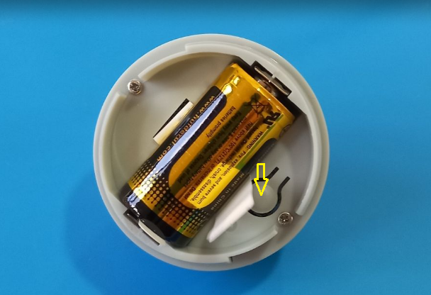

    Today I have received package from @spin55 , here's the sensor:
    The sensor is currently waiting in queue to be analyzed, flashed and tested. I am not sure when I'll have time to look into it, as there are already also smoke sensor guys waiting and the TM1650 module from aliexpress is waiting for support as well. Let's hope I will get onto it soon. Thank you for your continued support and testing, @spin55!

    #173 20641106
    dmarcondescctv
    Posts: 7
    >>20634360
    Hi spin55,
    Would you be able to assist? I bought a similar PIR device, and I'm having problems with the firmware.
    I have flashed it, apparently no problems on the process.
    After that, it just connects to my WiFi for a brief moment, 3 - 5 seconds, and then goes offline. I can't ping it or access the GUI.
    From the realterm, I get "00 00 00 00...."
    I also have tried a few other suggestions in this (and other) post, like erase all, restore the RF part, install the FullFW, with no luck.
    Do you have any advice?
    Thanks,
  • #174 20641145
    Posts: 14811
    Rate: 12978
    Well, have you configured it with the proper autoexec.bat?
  • #175 20641170
    dmarcondescctv
    Posts: 7
    First of all, thank you for getting back to me in such a short time.
    I have no chance to launch the web application within the 3 - 5 seconds that the device is reachable.
    What I tried instead was to add some commands that I would assume would be in the autoexec.bat in the short startup command and push it to the OBKConfig.

    #176 20641388
    spin55
    Posts: 209
    Help: 17
    Rate: 42
    In order for the connection to be maintained long enough to configure autoexec.bat, you have to put it in pairing mode. To do this, you have to hold down the button next to the battery until the blue LEDs go off. Check that the web remains active and configure autoexec.bat.
    In the image you posted from Realterm, you have the port set to 115200, change it to 9600.
    As problems arise, we will guide you.
  • Progress after changing baud rate to 9600
    #177 20642362
    dmarcondescctv
    Posts: 7
    Hi Spin55.
    With the change to 9600, I can see some progress in my troubleshooting:
    Pressing and holding the button for +5 seconds gave me more time to access the web application and create the autoexec.bat.
    I have copied your autoexec.bat from a previous post.
    Thank you for the help so far.
  • #178 20642407
    spin55
    Posts: 209
    Help: 17
    Rate: 42

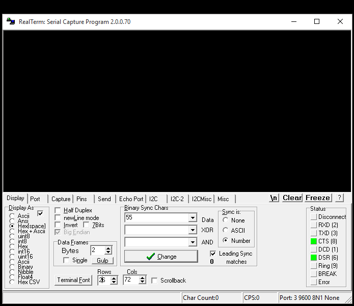

    Configure Realterm/Display like so:
    For the TuyaMCU information to be displayed clearly:

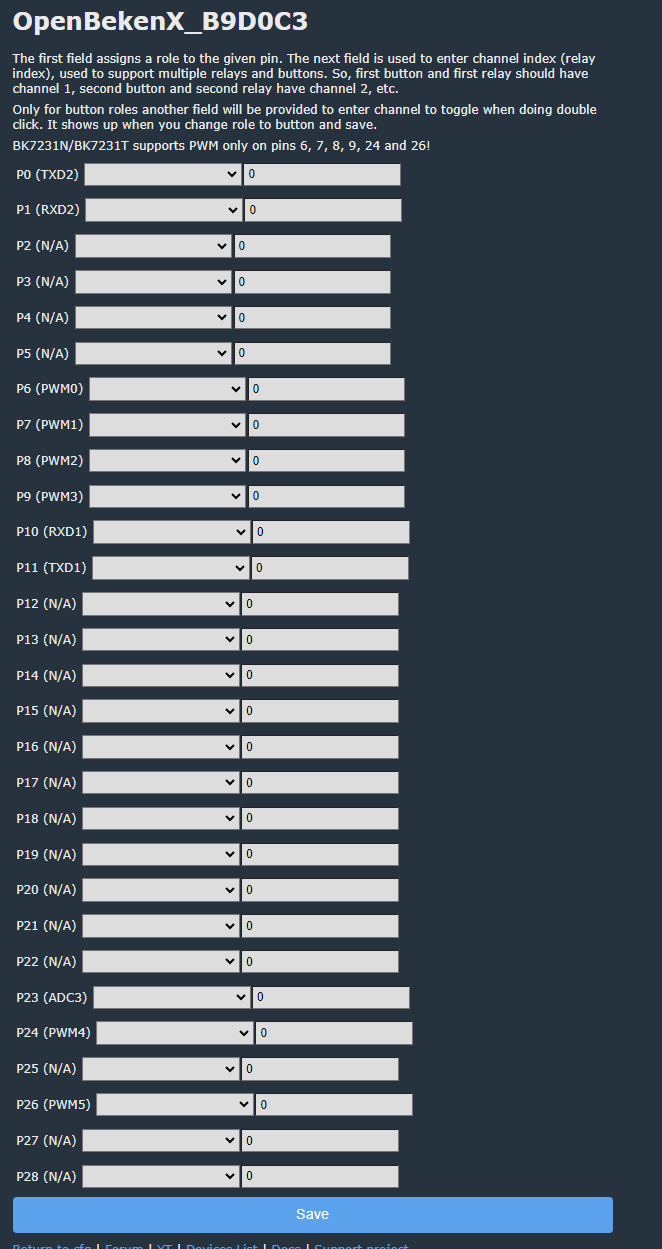

    Added after 13 [minutes]:
    Can you post a screenshot of the web like this?
  • Requesting more details after confirming TuyaMCU MQTT forwarding
    #179 20642500
    Posts: 14811
    Rate: 12978
    @dmarcondescctv I looked at your Web App Log screenshot and it seems to look like your device is correctly getting TuyaMCU packet with dpID and value, and then it correctly forwards it to MQTT. You can see the MQTT publish log entry in the image. Can you provide more information about the current issue with your device?
    Please see above, I have marked interesting log lines on your log screenshot.

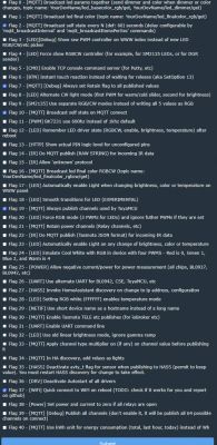

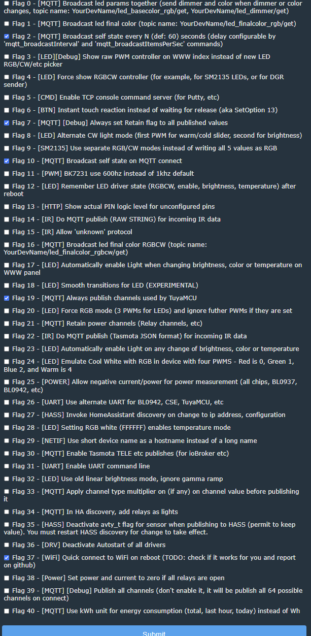

    #180 20643689
    dmarcondescctv
    Posts: 7
    Hi @spin55 and @p.kaczmarek2,
    With your help, I managed to get it working. Thank you!
    Now, I'm working to make it more reliable. My idea was that when someone steps into a room, the PIR would turn on a smart switch via Home Assistant.
    It is working, BUT not all the time and takes several seconds to turn the light on.
    Here are some screenshots.
    Motion sensor with BK7231N and TuyaMCU battery powered devices protocol Motion sensor with BK7231N and TuyaMCU battery powered devices protocol Motion sensor with BK7231N and TuyaMCU battery powered devices protocol Motion sensor with BK7231N and TuyaMCU battery powered devices protocol Motion sensor with BK7231N and TuyaMCU battery powered devices protocol Motion sensor with BK7231N and TuyaMCU battery powered devices protocol Motion sensor with BK7231N and TuyaMCU battery powered devices protocol Motion sensor with BK7231N and TuyaMCU battery powered devices protocol Motion sensor with BK7231N and TuyaMCU battery powered devices protocol
