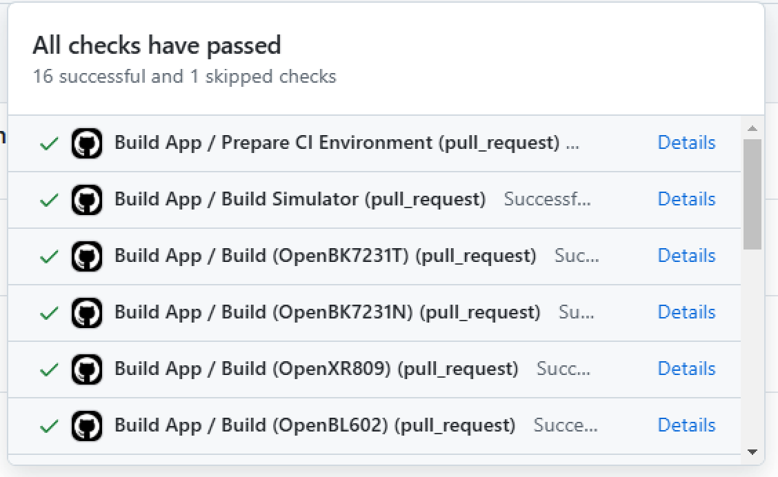

  • List of completed checks in GitHub Actions
    GitHub Actions workflows can be used to automatically build and test firmware on each commit. They may or may not create Github Releases, if not, build files are downloadable only via Github Action details. By default, those binaries require manual download, but here I will show you how to automate it.

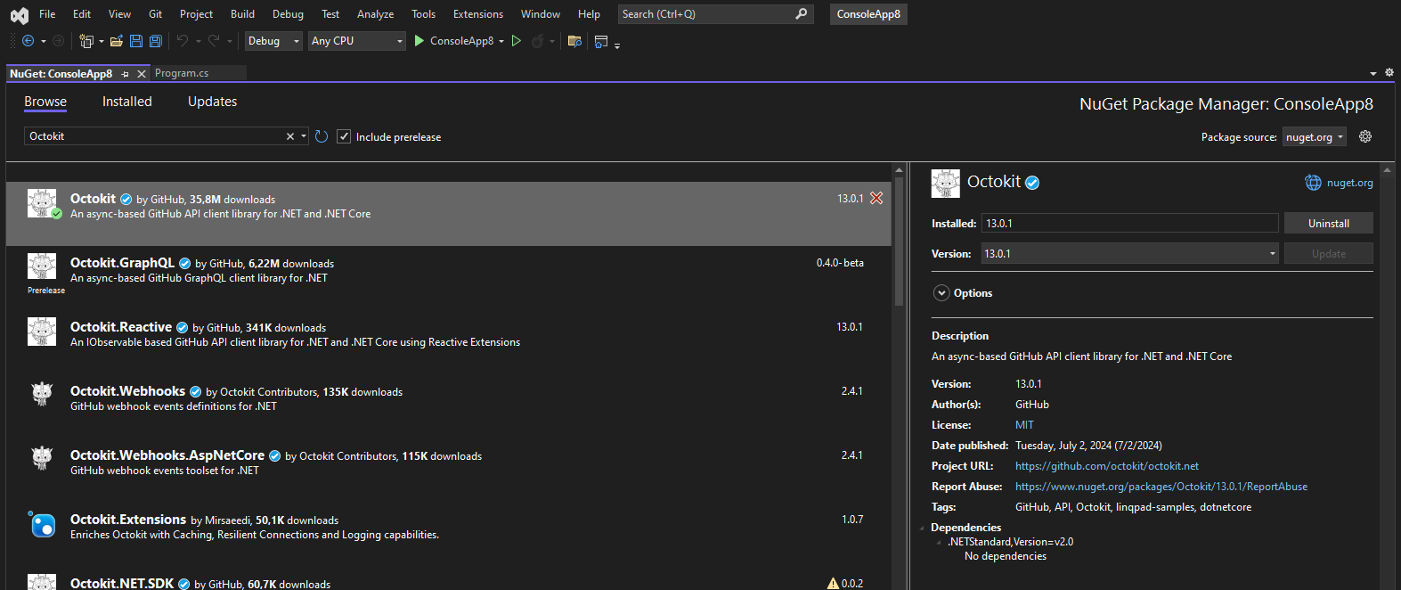

    Octokit library

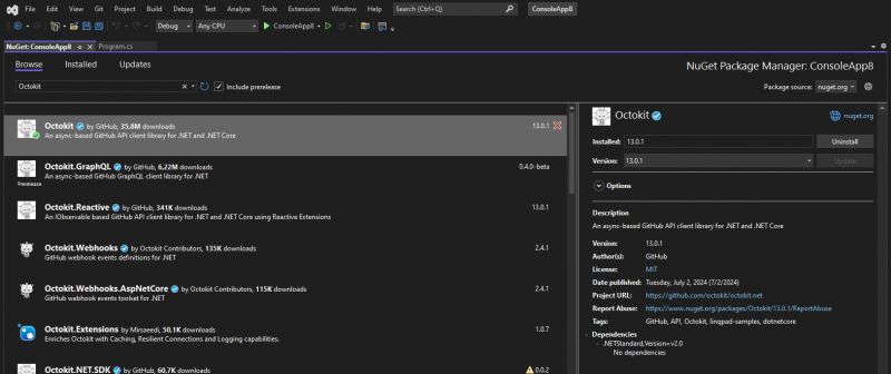

    First you'll need the Octokit library. Octokit provides easy access to Github API and can be downloaded within Visual Studio via "Manage NuGet Packages":
    NuGet Package Manager screen in Visual Studio with the Octokit library installed.
    Add it to your stock Console program and make sure you have correct usings:

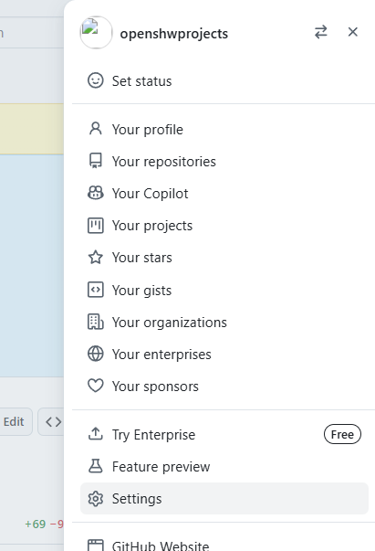

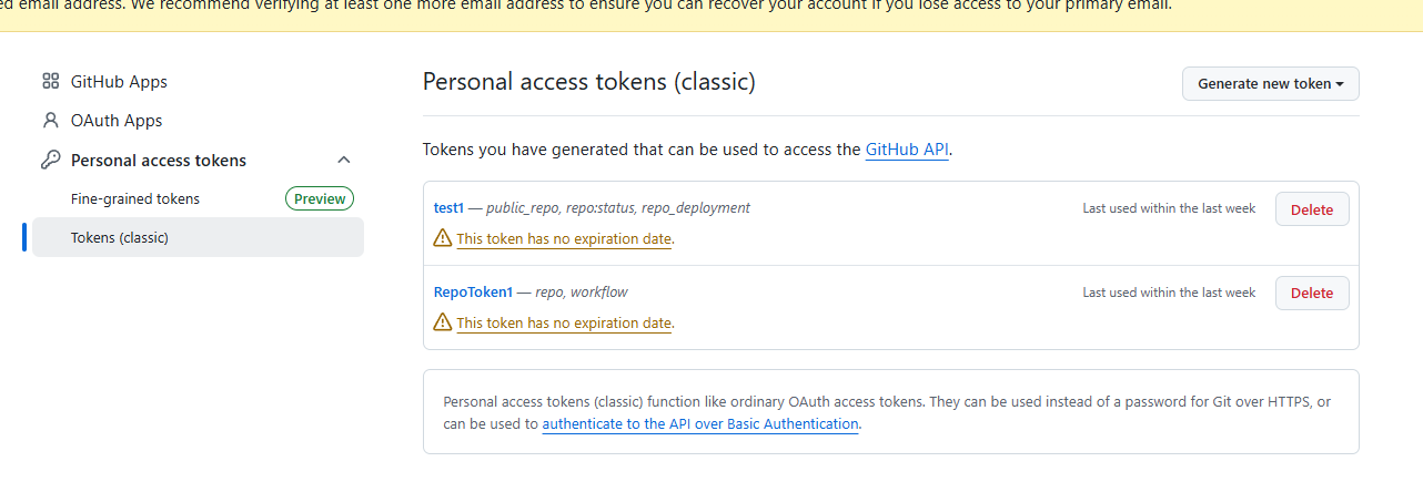

    Github Access Token
    This is not required for listing pull requests, but needed for artifacts. You will also obviously need it for the write access. Login to Github and go to Settings:

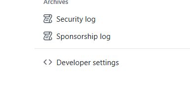

    Screenshot of the user menu on the GitHub page.
    then to Developer settings:
    Screenshot of GitHub settings menu.
    and then to Tokens. I have used "Classic" mode:
    Screenshot of GitHub personal access token settings
    Create a token, make sure to write it down. Choose the token scopes depending on what you are going to use to the token for. Don't give full write access to token if you don't want to use it to write to repository and use separate token for reach purpose you have.

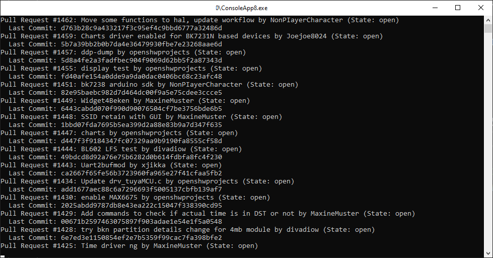

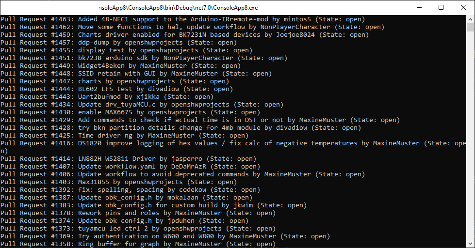

    Enumerating pull requests
    Now it's time to get this list:
    https://github.com/openshwprojects/OpenBK7231T_App/pulls
    This can be done with PullRequest object:
    Code: C#

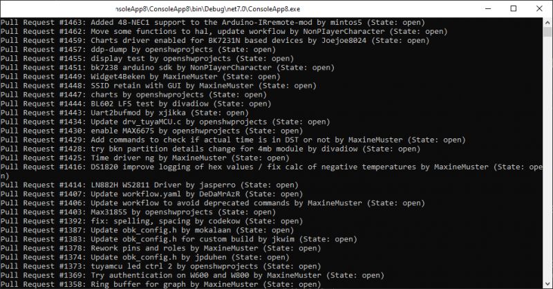

    Result:
    List of pull requests in console
    Enumerating commit
    Once you have Pull Request, you can get the latest commit. All commits can be listed in similiar way:
    Code: C#
    Result:
    Screenshot of a console application showing a list of GitHub pull requests.

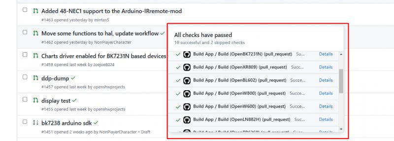

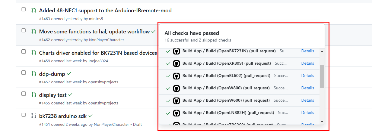

    Returned JSON is very simple:
    It's basically a JSON representation of each build here:
    GitHub pull request list with highlighted test results.

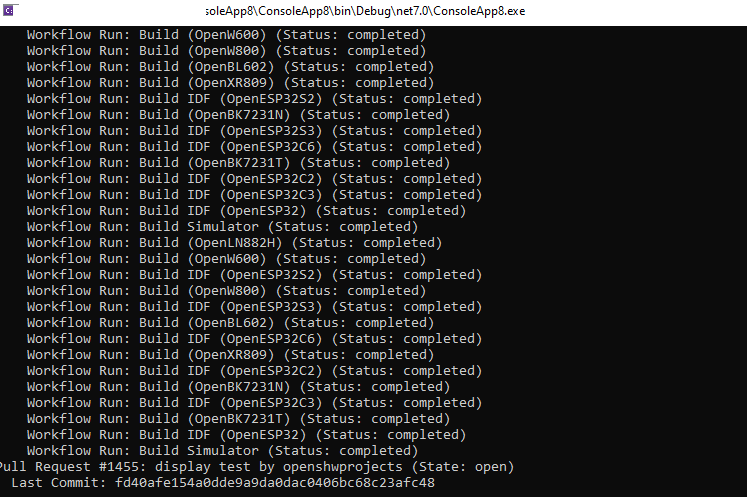

    Iterating the runs
    Once you have a list of workflows, you can iterate it:
    Code: C / C++
    Result:
    Screenshot of build results and statuses in a program console.

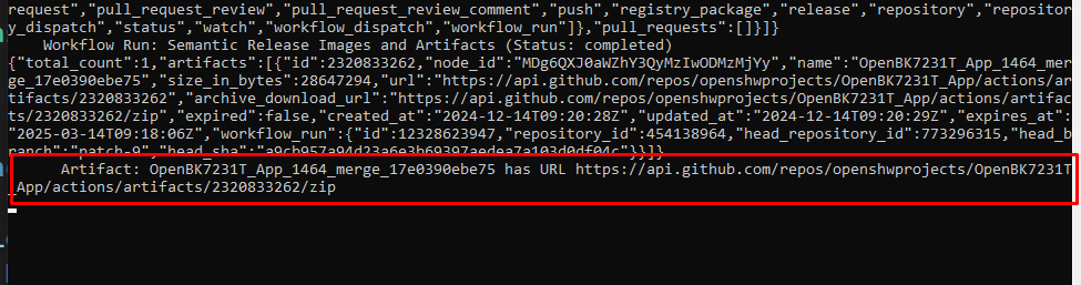

    Fetching artifacts
    Now we need to get links to zip files. We will need to extract a numerical ID for that. The ID can be found in workflow run data:
    Code: C#
    Here is a sample run ID: 12328623947
    You can now construct link like:
    https://api.github.com/repos/openshwprojects/OpenBK7231T_App/actions/runs/12305496423/artifacts
    Visiting this link yields following JSON:
    It's time to parse it. Here is function call:
    Code: C#
    And the implementation:
    Code: C#
    Again, the JSON data is deserialized into classes with JsonSerializer. Used classes:
    Code: C#
    Finally it's time to iterate them:
    Code: C#
    Result:
    Screenshot showing console output with a link to GitHub Actions artifacts.

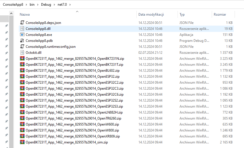

    Finally, after a few moments of downloading, we're getting OBK build files on our drive:
    Files of various types in the ConsoleApp8 application folder.
    Now it's time to futher process them, maybe send them to devices via OTA, but it's a task for another topic.

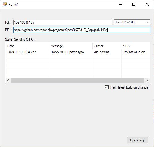

    Screenshot of Form1 application showing interface for updating OpenBK7231T via GitHub
    This tool will be able to automatically keep OBK device updated to the latest build from given PR, thus making testing and development easier.

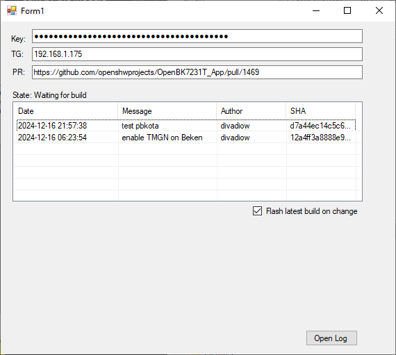

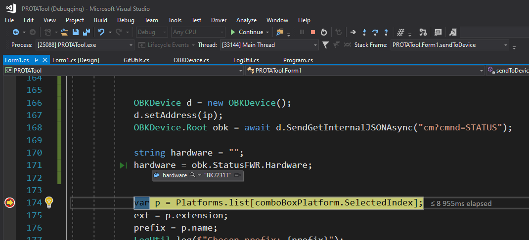

    Added after 1 [hours] 27 [minutes]:

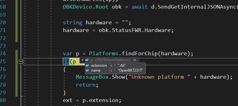

    Update: managed to call STATUS
    Screenshot of Visual Studio with the PROTATool project open and code highlighted.
    Added after 3 [minutes]:
    Screenshot of a program code snippet in an IDE with a highlighted if condition.

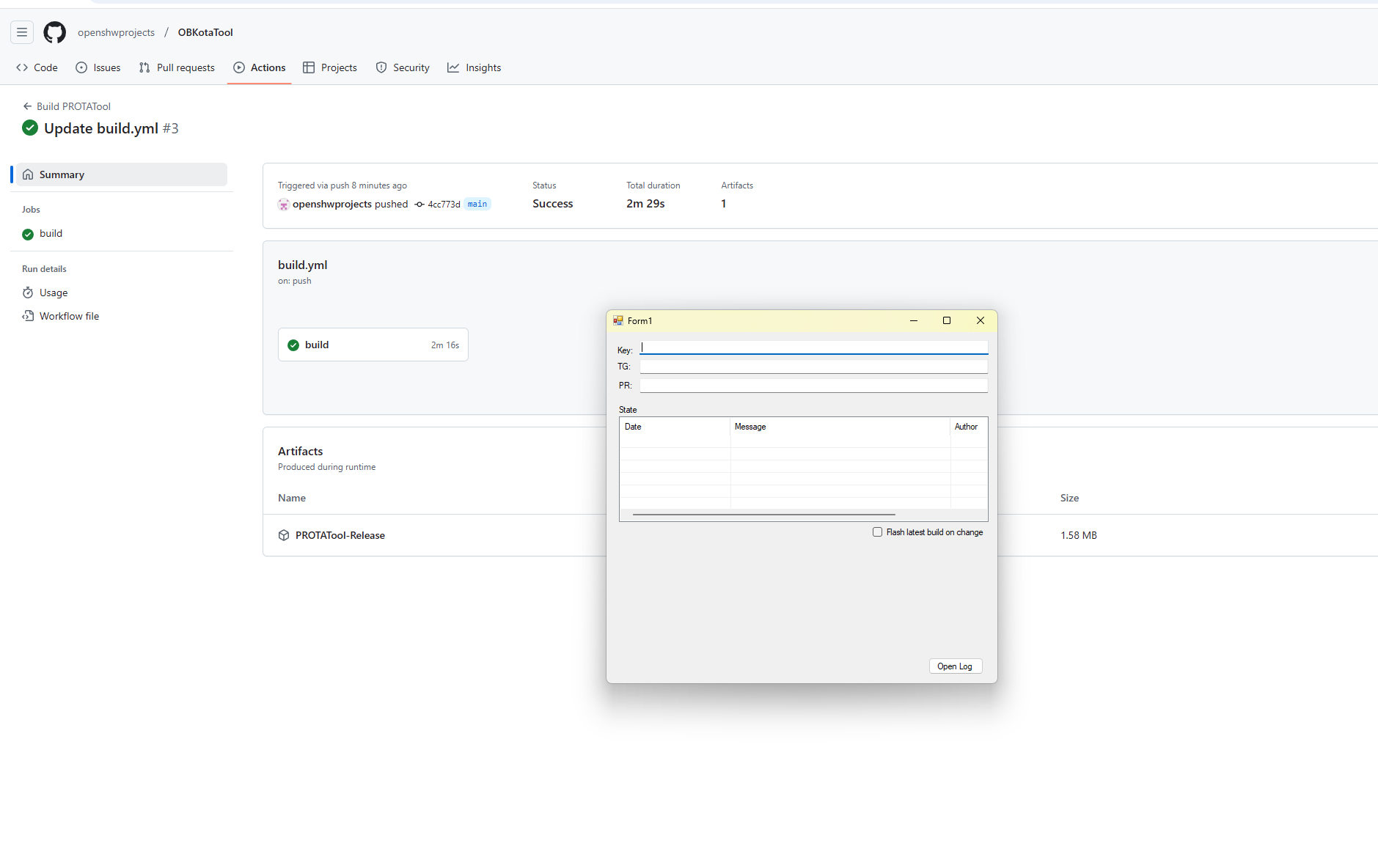

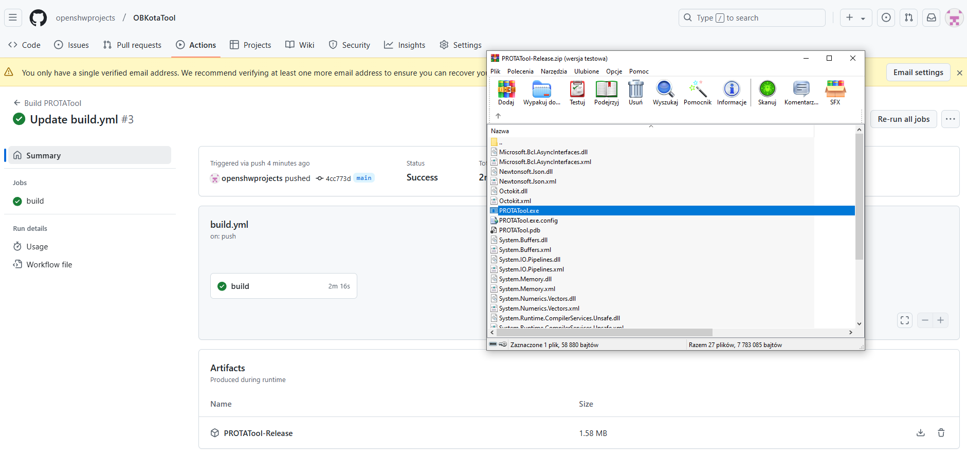

    Added after 5 [hours]:
    PROTA tool now has downloadable builds!
    Screenshot of the build process in GitHub Actions for OBKotaTool.
    Can anyone check if exe is downloadable and runs?
    https://github.com/openshwprojects/OBKotaTool

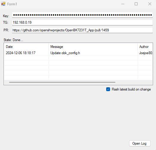

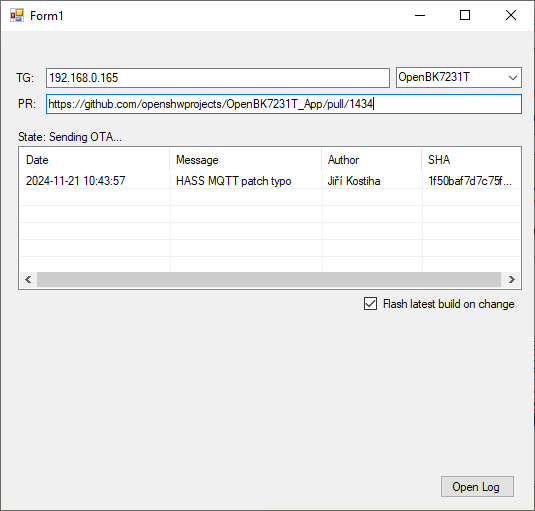

    Now you need a Github API key, a PR link, and device IP.
    btw: Shall I do the same for https://github.com/openshwprojects/BK7231GUIFlashTool ?

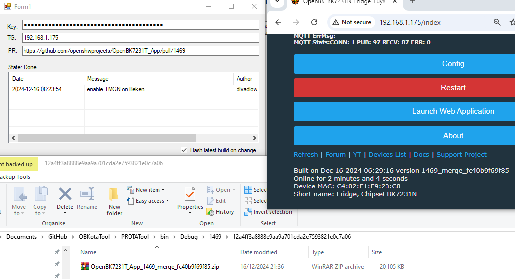

  • Auto-updating devices from GitHub PR changes
    #8 21351410
    Posts: 14795
    Rate: 12952
    I hope you guys realize that now, if you push a change to that pull request, the tool will automatically update your device. It queries Github PR in the background constantly, just to detect the change. That's the whole point of that tool.

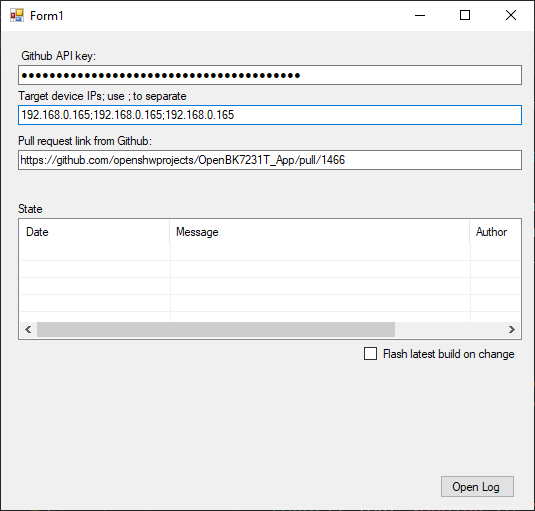

    Now I'm adding support for multiple IPs:
    Screenshot of the OpenBK7231T application tool's GUI with fields for Github API key, IP addresses, and pull request link.
    It should choose the correct binary for each target device platform.

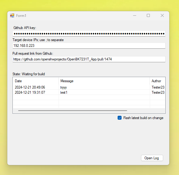

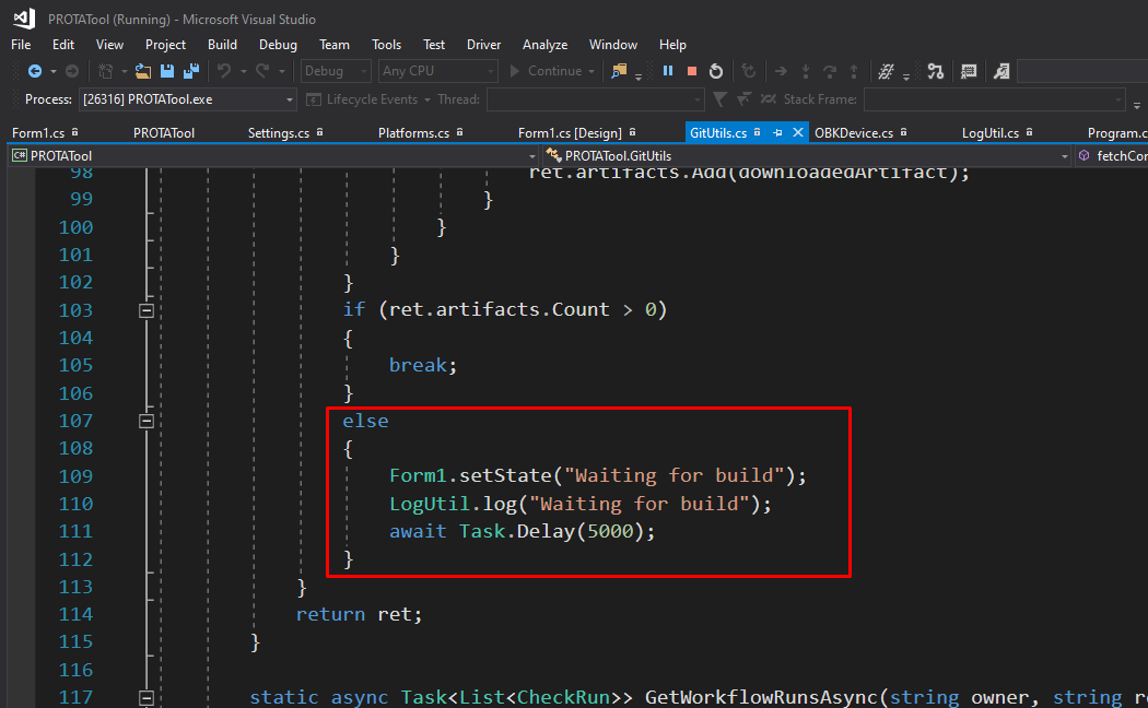

    I think I've handled this issue. If commit is available, but there are no artifacts yet, it shall retry every 5 seconds with a new message in log:
    Screenshot of Visual Studio showing a C# code snippet with an else statement highlighted in a red box.

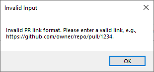

    #19 21374566
    Posts: 5236
    Help: 450
    Rate: 920
    regarding the URL pattern matching
    Window with error message Invalid Input with instructions for the correct PR link format.
    Is there an API/technological reason an URL like this couldn't be used also to get artefacts for bulk flashing?
    https://github.com/MaxineMuster/OpenBK7231T_App/actions/runs/12595088390
    also, the same for GA releases like https://github.com/openshwprojects/OpenBK7231T_App/actions/runs/12584760006
  • #21 21374912
    Posts: 14795
    Rate: 12952
    So you want to also support that kind of links directly?
  • #22 21374917
    Posts: 5236
    Help: 450
    Rate: 920
    I mean, it'd be useful on the odd occasion . Just a nice-to-have.
    but yes, I appreciate it's for PRs :)

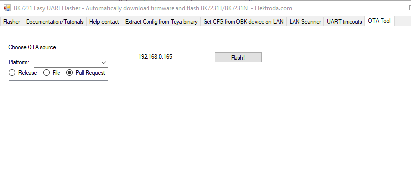

  • #23 21518979
    Posts: 5236
    Help: 450
    Rate: 920
    how does this tab in EF fit in with the PROTA tool?
    Screenshot of BK7231 Easy UART Flasher tool for downloading and flashing firmware.
    I can't seem to get it to do anything

  • The sample commit check-runs response shows 18 check runs for one SHA, which is enough to map a single commit to multiple workflow outcomes. [#21348573]
  • The sample artifacts response shows 15 artifacts for one Actions run, each with an archive_download_url that points to a ZIP download. [#21348573]
  • PROTA was updated to retry every 5 seconds when a commit exists but artifacts are not published yet, reducing false failures during active CI builds. [#21351438]
  • The tool was reported as working with Beken and ESP32 targets, and later gained support for multiple IP addresses in one update flow. [#21350736]
  • A practical test setup mentioned using 3 devices in a chain so repeated PR flashes become easier during hardware bring-up and regression testing. [#21350736]
How do I programmatically list GitHub pull requests for openshwprojects/OpenBK7231T_App in C# using Octokit?
Use GitHubClient from Octokit, set owner = "openshwprojects" and repo = "OpenBK7231T_App", then call client.PullRequest.GetAllForRepository(owner, repo). Iterate the returned list and print pr.Number, pr.Title, pr.User.Login, and pr.State. The example wraps this inside RunAsync().GetAwaiter().GetResult() because Octokit uses async tasks. That gives you the same PR set shown on the repository Pull Requests page, but in C# code. [#21348573]
What is Octokit, and why would you use it instead of calling the GitHub API directly with HttpClient?
"Octokit" is a C# client library that accesses the GitHub API, its key characteristic is that it exposes GitHub objects such as pull requests and commits as typed async methods. Use it when you want fast PR and commit access with less boilerplate. The thread uses Octokit for listing pull requests and commits, but switches to HttpClient for workflows and artifacts because the author had issues with Octokit there. That mixed approach keeps simple tasks simple and still allows raw endpoint access when needed. [#21348573]
How can I get the latest commit SHA from a GitHub pull request before looking up workflow runs and artifacts?
Call client.PullRequest.Commits(owner, repo, pr.Number) and take the last item. The example uses var lastCommit = commits.LastOrDefault(); and then reads lastCommit.Sha. That SHA becomes the input for the next API call to /commits/{sha}/check-runs. If the PR has no commits, LastOrDefault() returns null, so check that before building workflow URLs. [#21348573]

How do I fetch GitHub check-runs or workflow information for a specific commit SHA from the GitHub API?
Send an authenticated GET request to /repos/{owner}/{repo}/commits/{sha}/check-runs with HttpClient. The example adds a Bearer token and a User-Agent header, then deserializes the JSON into CheckRunsResponse. In the sample response, one commit returned total_count: 18, and each check_run included name, status, html_url, and details_url. That data is enough to enumerate workflow activity for the commit. [#21348573]
Why do GitHub artifact requests need an access token even if listing pull requests can work without one?
Artifact access needs a token in this workflow because unauthenticated API use hits limits quickly, while authenticated requests get a higher limit. The thread explicitly says listing pull requests does not require a token, but artifacts do, and the sample code sets Credentials = new Credentials(GitHubToken) or sends a Bearer token with HttpClient. The token is also required if you want write access later, so the safer pattern is to create a scoped token and avoid broad permissions. [#21348573]

How do I download artifact ZIP files from archive_download_url in C# and save them with the artifact name?
Use HttpClient, authenticate, stream the response, and write it to {artifactName}.zip. A simple 3-step flow works: 1. Read each artifact’s archive_download_url. 2. Call GetAsync(url) with the Bearer token and User-Agent. 3. Copy response.Content into a FileStream created with Path.Combine(Directory.GetCurrentDirectory(), $"{artifactName}.zip"). The example prints the saved path after each successful download. [#21348573]
Why would a tool like PROTA find a commit but no artifacts yet, and how should it retry until the build finishes?
A commit can appear before the GitHub Actions build has finished publishing artifacts. The thread describes exactly that edge case and says the tool should not stop there. Instead, it now retries every 5 seconds and adds a new log message until artifacts appear. That design matches real CI timing, where commit metadata is visible first and ZIP outputs arrive later. [#21351438]
How does PROTA detect the correct binary for each target device platform when flashing multiple IPs such as Beken and ESP32 devices?
It detects the chip type from the target device and uses that to choose the matching binary. The author’s TODO says the tool should send a Tasmota STATUS packet instead of relying on a chip-type combobox, and later reports, "managed to call STATUS." After that, support for multiple IPs was added, and the author says it should choose the correct binary for each target platform. The thread also states the tool was tested with Beken and ESP32. [#21351410]
PROTA currently expects a pull request URL, so how could support for direct GitHub Actions run links be added for bulk flashing or GA builds?
Support could be added by accepting /actions/runs/{id} URLs as a second input pattern and skipping the PR-to-commit step. The thread confirms the current tool is designed for PR links like /pull/<PR number>, but one participant asks whether direct Actions run links would be useful for bulk flashing and GA builds. That means the practical extension is URL pattern detection: PR URLs follow the existing path, while run URLs can go straight to artifacts lookup. [#21374917]
