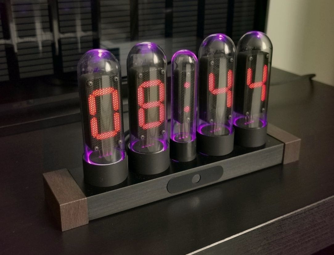

LED glass clock with ESP8266 and LED SK6812 mini-E
efi222 11307 76
  • An ESP8266-based glass clock uses SK6812 mini-E LEDs to mimic the look of vintage tube displays with illuminated “glass bulbs”.
  • Each digit is built from 25 mm test tubes cut to 80 mm and printed housings, with the time synchronized from NTP servers.
  • The small SK6812 mini-E LEDs measure 2.8 × 3 mm, which lets each display use only four connecting wires.
  • Digit height is 30 mm, and the PCB for the digits and colon is 0.6 mm thick, while other boards use 1 mm.
  • FDM parts need sanding, adhesive film, and silicone finishing, and the display color rendering is still poor on film.

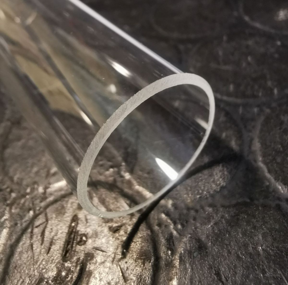

    ArturAVS wrote:
    Instead of a grinder, a 1000 -2000 "water" paper will work better, especially as if you press a little, the glass will break.
    You should be able to sand wet. But if you don't have what you like....
    2000 paper is probably a bit overkill.... Maybe preparation for polishing.
    Here sanding with an angle grinder (not too high speed). Paper 120 (I don't have any other paper at the moment). It looks quite coarse. But the edge is safe and does not cut. All the more so because in this design you can't see it.
    I think 240 paper would be enough to make it look better.
    Transparent, sanded tube lying on a dark background. .

    Very cool watch. I would love to make one myself, as Nixie prices are high.
    As for test tubes, haven't you thought about plastic ones? Definitely easier to process and the temperatures there are not so high that something could happen.

    I have not had plastic tubes in my hand. It is difficult for me to judge. I have had bad experiences with market plexiglass. In spite of all protection during processing and even later during use (wiping with a cloth), micro scratches appear. Perhaps the test tubes are made of better plastic.
    When cutting and machining my first glass test tube, I also had my doubts about whether I could handle it (I had never done it). But now I know that it is really nothing terrible. :)
    Well, and in conclusion, glass will always have that glassy glow. :)
    As the Christmas/New Year frenzy passes, I will try to complete the article with more detailed information on watch construction and glass treatment.

    The price of this watch $100. Asian friends offer similar designs cheaper (but on LCD, I think).

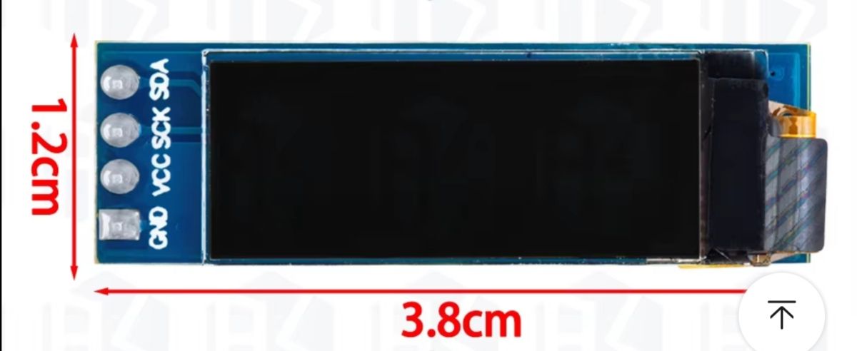

    You could try to stuff 128x32 OLEDs with SSD1306 into the test tubes.... I'm just not sure if the existing libraries allow 90 degree rotated display.
  • #39 21363287
    efi222
    Level 21  
    Posts: 654
    Help: 12
    Rate: 1057
    Board Language: polish
    The popular 128x32 0.91" oled should theoretically fit into a 16 mm diameter colon tube.
    I wonder how the durability of these displays is.
    OLED display 128x32 measuring 1.2 cm x 3.8 cm. .

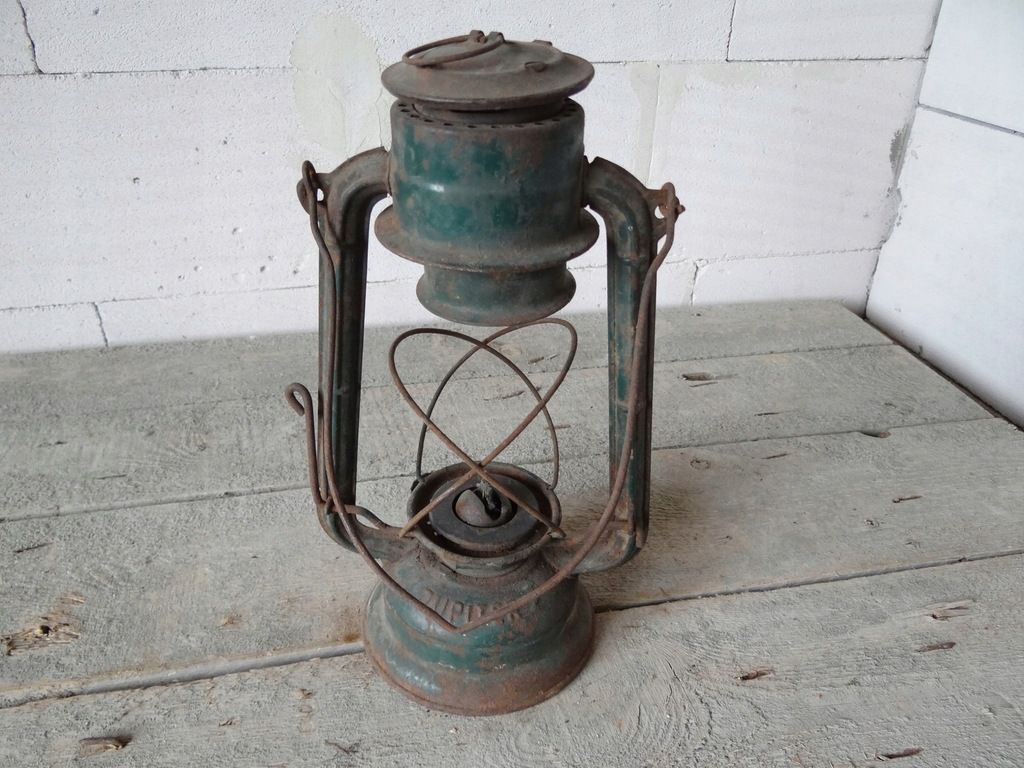

    As for cutting glass tubes, there is also a baaavery old method..... Wrap the cutting area with twine/cotton thread, soak in spirit/denatured alcohol, light the thread, put in cold water. With a little dexterity it breaks evenly. Then just stone/waterpaper and wet sand the sharp edges by hand.... 65 years ago I saw them making undersized (height) glasses for oil lamps/flashlights in the countryside this way.
    Old, rusted kerosene lamp on a wooden table. .

    I have added a more detailed description of the construction in the first post.
    Greetings :) .

    Such a final idea :) .If someone is annoyed by the seams on the printout of the tube plinths, a cap can be made. Print in vase mode.
    May also be useful for other such round solids.

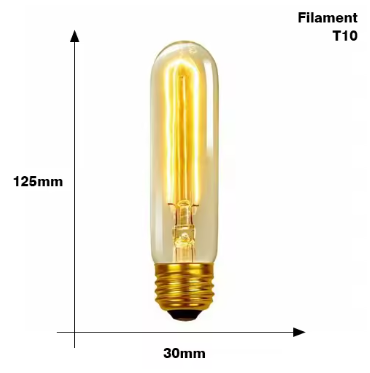

    At the beginning of the article I lamented the lack of tubes with a diameter larger than 25mm. In the new version of the slides I have trimmed from the so-called 'Edison bulb' 30mm diameter tubes. They are a little more difficult to cut as the wall thickness is about 1mm. It takes a bit of skill and a slightly different approach than cutting a tube with a thicker wall.
    I also added extra illumination to the slides (nice ambience in the dark and beyond). The whole structure is now 220 x 120 x 48 mm.
    LED clock with glass bulb-like covers and purple backlighting
    Edison T10 bulb with filament, height 125 mm, diameter 30 mm

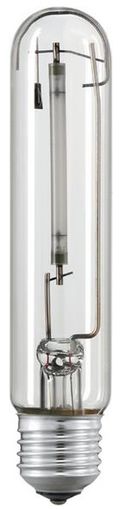

    efi222 wrote:
    I was bemoaning the lack of tubes larger than 25mm in diameter
    Let's move on. Perhaps in the role of "test tubes" , use the bulbs from typical high-powered "soda" tubes with E40 threads?
    High-pressure sodium lamp with E40 screw base and transparent glass envelope

    These bulbs from 30mm bulbs already look nice, but a colleague made me curious. So 'by eye' this bulb from a sodium bulb might be 45mm.

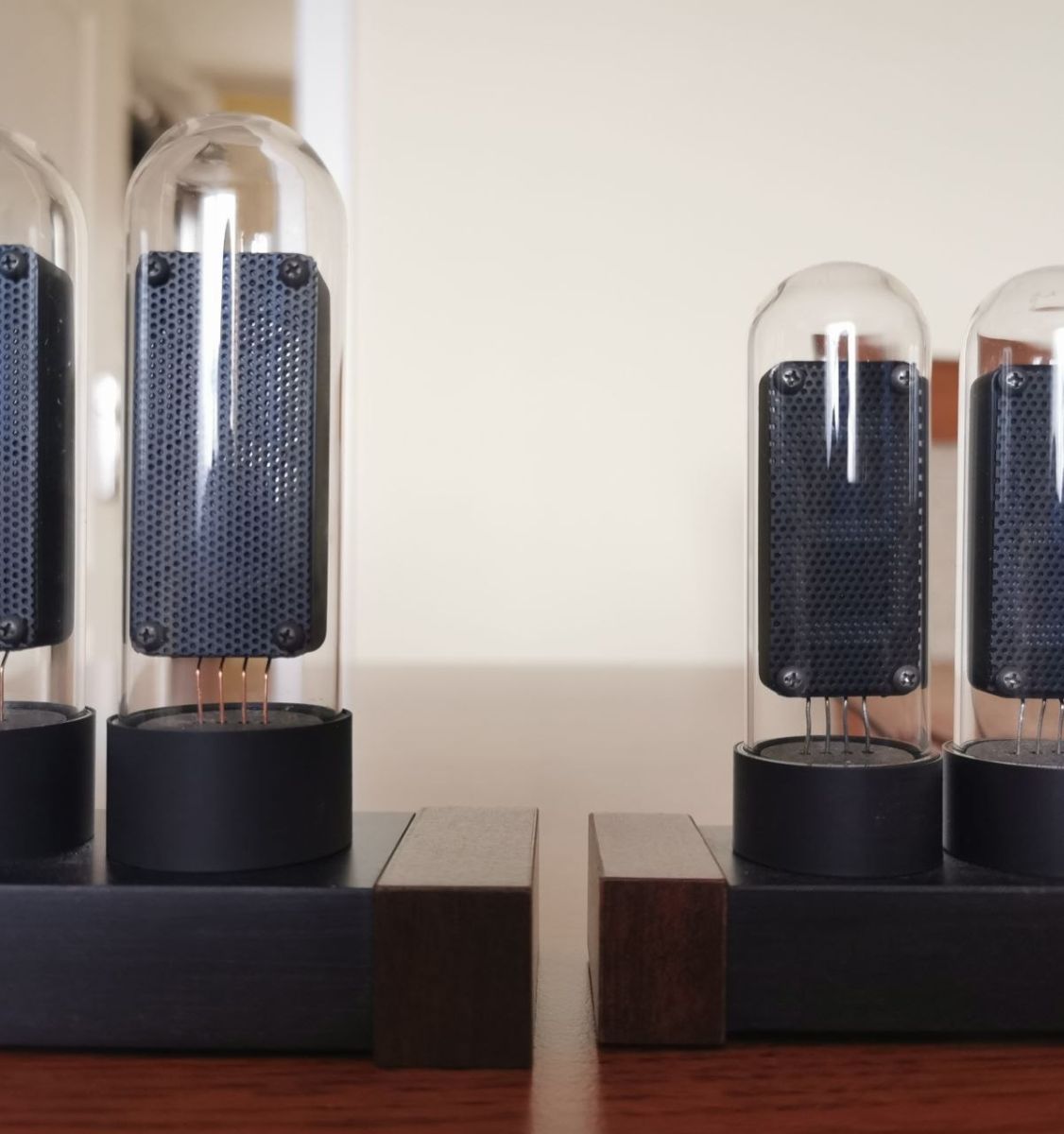

  • #57 21754041
    efi222
    Level 21  
    Posts: 654
    Help: 12
    Rate: 1057
    Apparently only a 5mm difference in diameter, but visually there is quite a difference.

    The larger ones look "more solid". Overall the effect is great.
