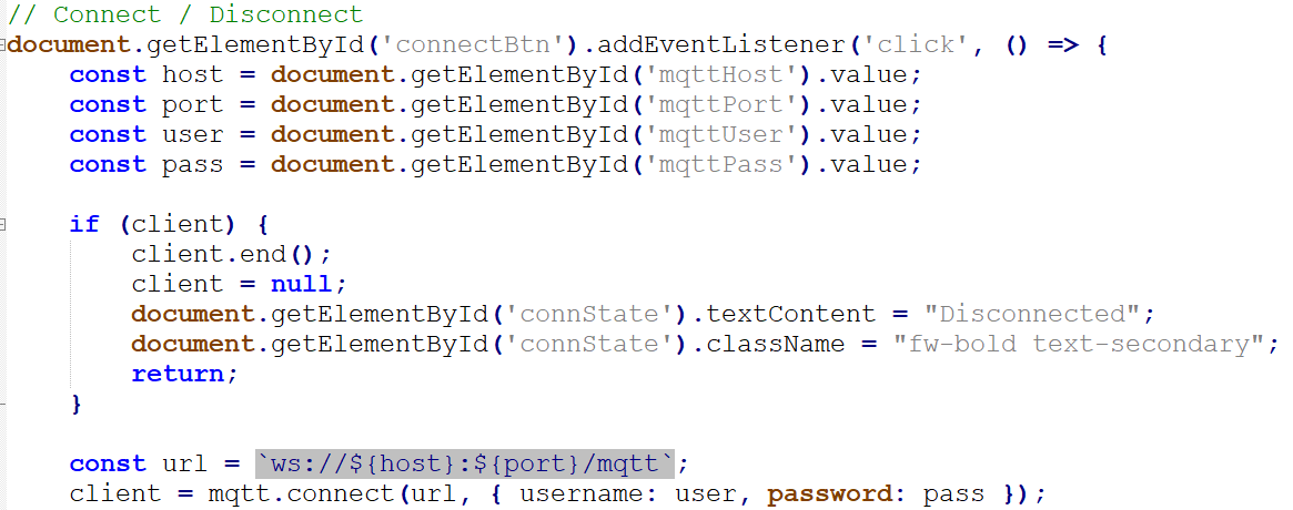

    Now you have to handle the 'Connect' button, i.e. make the connection. The whole thing boils down to retrieving data from the DOM objects at the time of clicking:
    Tutorial mqtt.js, the Javascript MQTT client - how to connect your browser to Home Assistant

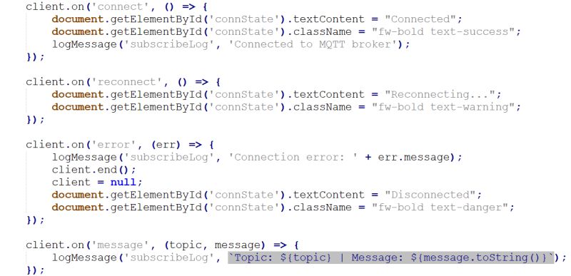

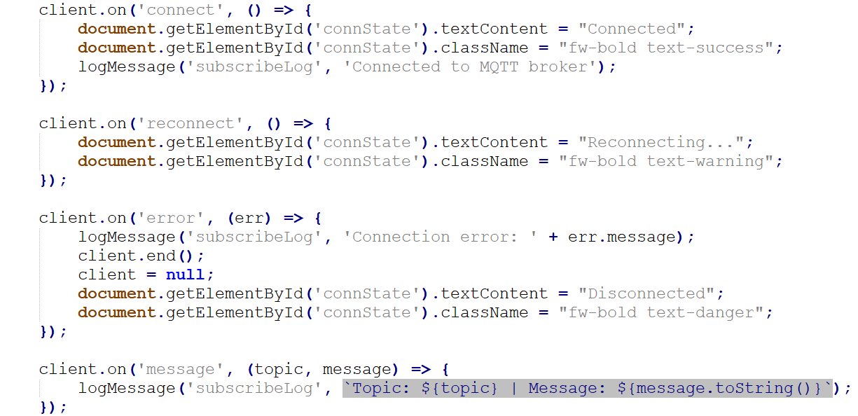

    The link is created with the ws prefix, which is the WebSocket standard. A username and password are given as arguments. Once the connection is initiated (the connect function is non-blocking), callbacks can be set to handle various MQTT events. Here is an example implementation for a demo site:

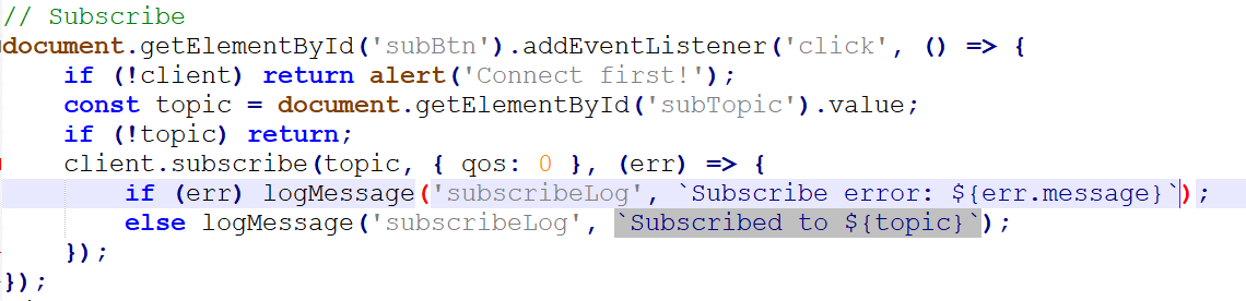

    That leaves two operations that cannot be done via callbacks. First, the subscription for the topic (start listening):

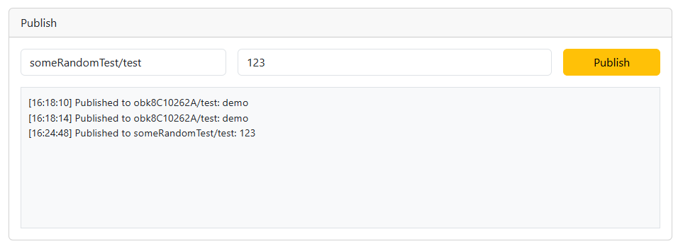

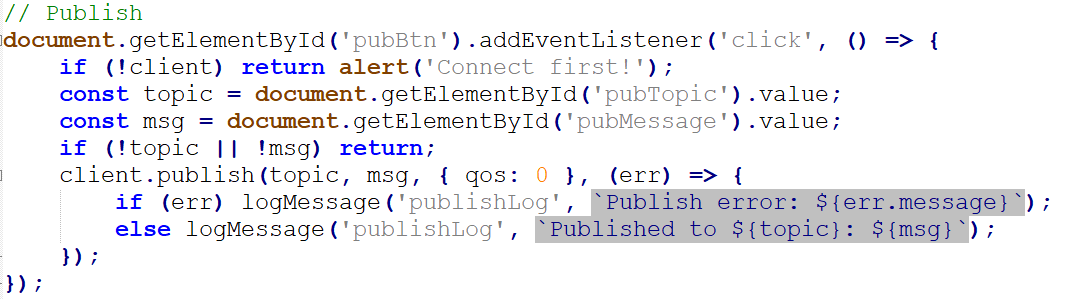

    Then publishing data on the selected topic:

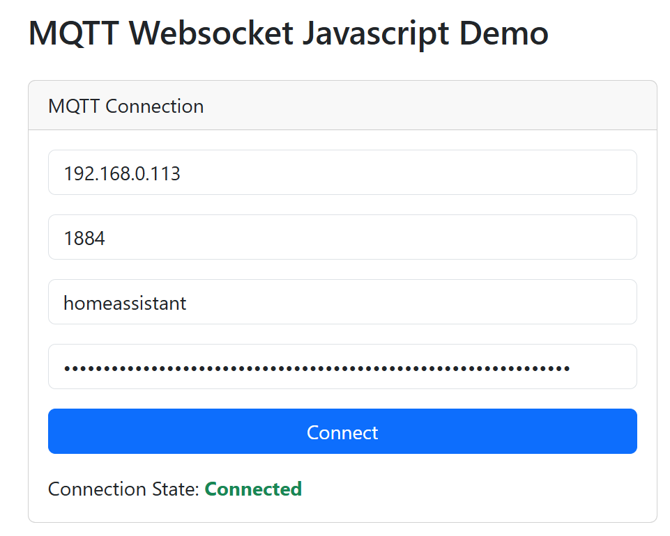

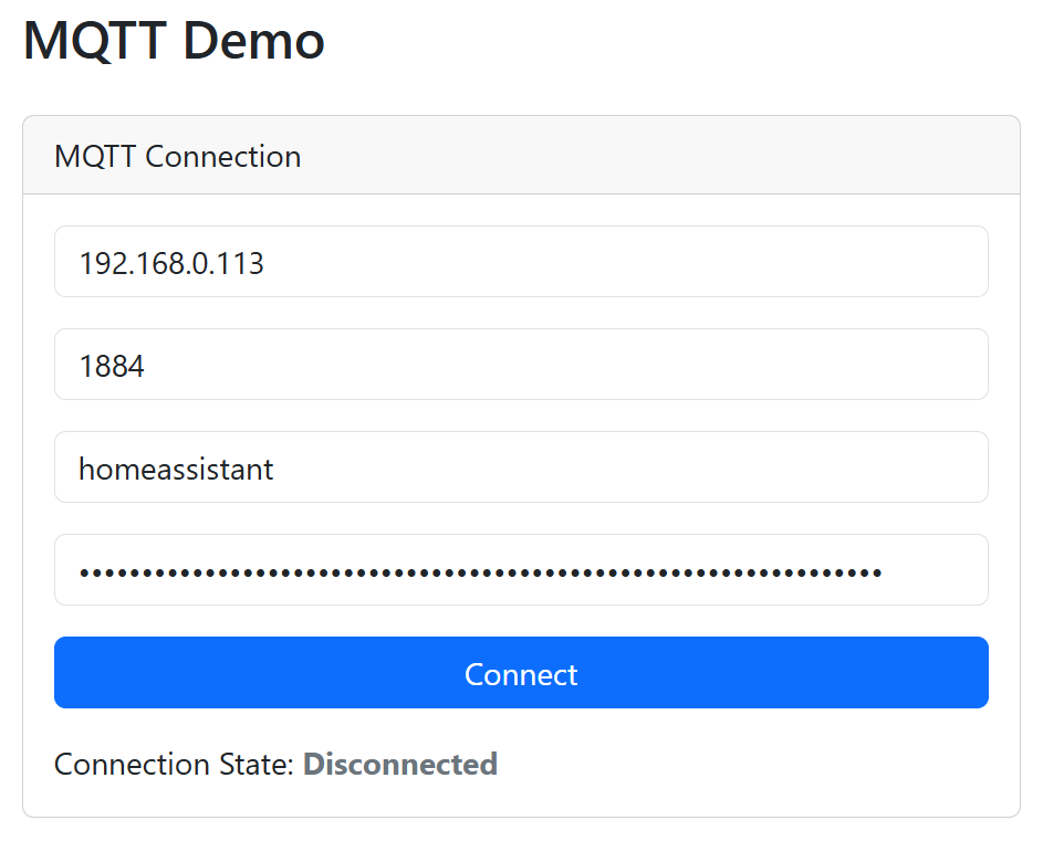

    Firstly the connection - once you have entered the correct details it should all work first time. I didn't have to configure anything in HA, I already had WebSockets support enabled there. I simply specified a port one larger than the one used for MQTT over TCP.

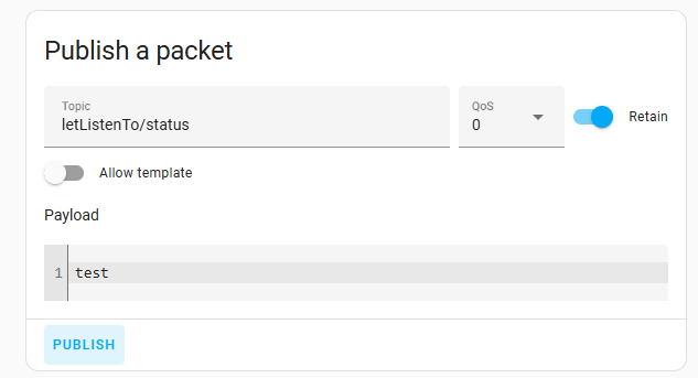

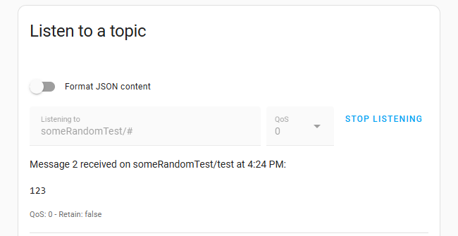

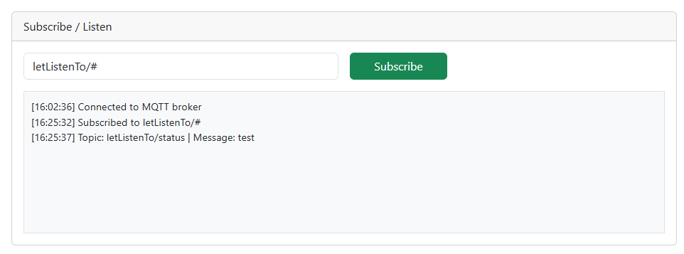

    It is now possible to check that our site can see what Home Assistant publishes:
    MQTT subscription interface with topic input and status logs

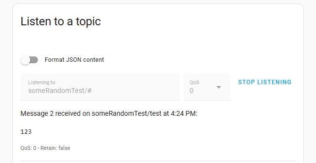

    Then it remains to test the other way - site publishes, HA receives:
    MQTT publish interface with topic and message fields and a yellow Publish button
    MQTT message received in browser from topic someRandomTest/test
