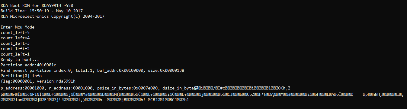

  • RDA5991H boot ROM log and partition details
    #64 21699962
    Posts: 5214
    Help: 448
    Rate: 916
    more bits:
    https://os.mbed.com/docs/mbed-os/v6.16/feature-i2c-doxy/rda5991h__wland_8h_source.html
    https://static-aliyun-doc.oss-cn-hangzhou.ali...91%25E6%258C%2587%25E5%258D%2597_cn_zh-CN.pdf

    RDA 5981AM/Broadlink BL3335-P - Generic/nobrand 15W RGBW B22 Bulb - basic teardown
    no AP. text not legible at 115200/921600 or with io21 floating
  • No config save causing MAC to change on boot
    #70 21700038
    Posts: 5214
    Help: 448
    Rate: 916
    insmod wrote:
    https://github.com/NonPIayerCharacter/OpenBK7231T_App/actions/runs/18000751710
    no saving of config. netif mac changes on every boot - just because of no save of config I guess?
    Spoiler:

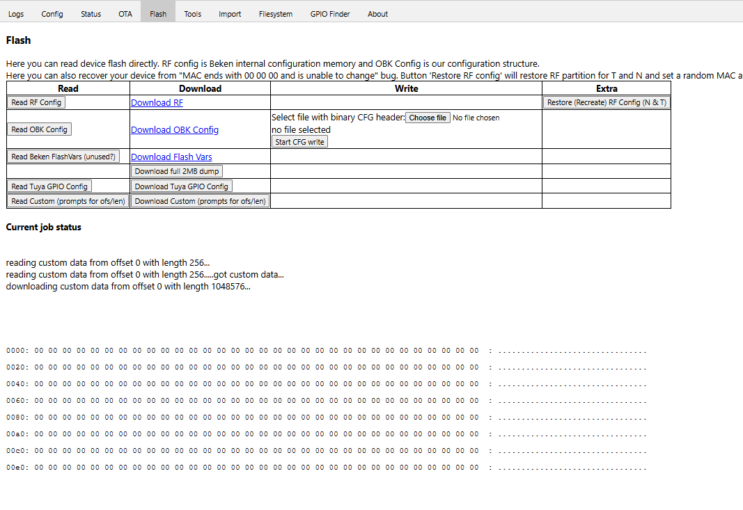

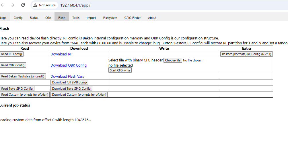

    trying web app read ..
    Added after 4 [minutes]:
    not getting past this:
    not sure of web dies too quickly or if it's failing anyway before gui dies

    Pause log, open this page, reboot and reconnect and then try again

    RDA Boot ROM for RDA5991H r550
    Build Time: 15:50:19 - May 10 2017
    RDA Microelectronics Copyright(C) 2004-2017
    Enter Mcu Mode
    count_left=5
    count_left=4
    count_left=3
    count_left=2
    count_left=1
    Ready to boot...
    Partition addr:4010901c
    Find newest partition index:0, total:1, buf_addr:0x00100000, size:0x00000138
    Partition[0] info
    flag:00000001, version:rda5991h
    p_address:00001000, r_address:00001000, psize_in_bytes:0x0007c000, dsize_in_byte;/-)' ----------------maclib task
    OpenRDA5981, version _gcc6
    Entering initLog()...
    Commands registered!
    initLog() done!
    Debug:CMD:Adding command loglevel
    Debug:CMD:Adding command logfeature
    Debug:CMD:Adding command logtype
    Debug:CMD:Adding command logdelay
    Debug:CFG:CFG_CalcChecksum: header size 4, total size 3584, rem size 3580
    WarnMain_Init_Before_Delay done
    Main_Init_Delay
    Main_Init_Delay done
    Enter Mcu Mode
    count_left=5
    count_left=4
    count_left=3
    count_left=2
    count_left=1
    Ready to boot...
    Partition[0] info
    p_address:00001000, r_address:00001000, psize_in_bytes:0x0007c000, dsize_in_byte /-)' ----------------maclib task

    #76 21700086
    Posts: 5214
    Help: 448
    Rate: 916
    still AP mode only
    Spoiler:
    Enter Mcu Mode
    count_left=5
    count_left=4
    count_left=3
    count_left=2
    count_left=1
    Ready to boot...
    Partition[0] info
    p_address:00001000, r_address:00001000, psize_in_bytes:0x0007c000, dsize_in_byte;/o ' ----------------maclib task
    initLog() done!

    Ready to boot...
    Partition[0] info

  • AP mode persists after reboot, no credentials saved
    #81 21700174
    Posts: 5214
    Help: 448
    Rate: 916
    insmod wrote:
    https://github.com/NonPIayerCharacter/OpenBK7231T_App/actions/runs/18004135965
    still AP after reboot. no cred save :(
    Spoiler:
    Enter Mcu Mode
    count_left=5
    count_left=4
    count_left=3
    count_left=2
    count_left=1
    Ready to boot...
    Partition[0] info
    p_address:00001000, r_address:00001000, psize_in_bytes:0x0007c000, dsize_in_byte Ōj $----------------maclib task
    Enter Mcu Mode
    count_left=5
    count_left=4
    count_left=3
    count_left=2
    count_left=1
    Ready to boot...
    Partition[0] info
    p_address:00001000, r_address:00001000, psize_in_bytes:0x0007c000, dsize_in_bytes H/ F ----------------maclib task
    Enter Mcu Mode
    count_left=5
    count_left=4
    count_left=3
    count_left=2
    count_left=1
    Ready to boot...
    Partition[0] info
    p_address:00001000, r_address:00001000, psize_in_bytes:0x0007c000, dsize_in_bytes + F ----------------maclib task
    Enter Mcu Mode
    count_left=5
    count_left=4
    count_left=3
    count_left=2
    count_left=1
    Ready to boot...
    Partition[0] info
    p_address:00001000, r_address:00001000, psize_in_bytes:0x0007c000, dsize_in_bytes H+ F c   o0 SHNJR…)G ----------------maclib task
    Enter Mcu Mode
    count_left=5
    count_left=4
    count_left=3
    count_left=2
    count_left=1
    Ready to boot...
    Partition[0] info

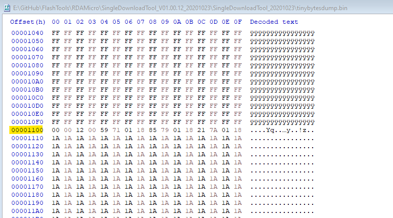

  • #85 21700248
    Posts: 5214
    Help: 448
    Rate: 916
    insmod wrote:
    Erasure not working?
    this is erasure result with a tiny file to be written to x1100

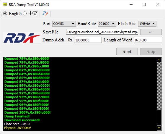

    1mb dump option is a few bytes short of the full 1mb, which is why I've been dumping 2mb. app errors if you set full 1mb or 2mb length
    erasure appears to be effective.
    • tinybytesdump.bin (1020 KB) You must be logged in to download this attachment.
