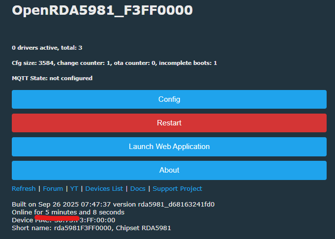

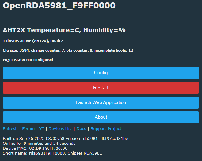

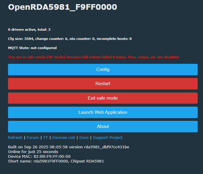

    insmod wrote:
    https://github.com/NonPIayerCharacter/OpenBK7231T_App/actions/runs/18028486754
    same gui dying quickly experience

    Error:MAIN:Thread create HTTP Client - err
    Error:HTTP:[sock=2]: TCP Client thread creation failed!
    Error:HTTP:TCP Server Error
    Info:MAIN:Time 22, idle 0/s, free 20000, MQTT 0(0), bWifi 0, secondsWithNoPing -1, socks 1/8
    Info:MAIN:Time 23, idle 0/s, free 20000, MQTT 0(0), bWifi 0, secondsWithNoPing -1, socks 1/8
    ExtraDebug:HTTP:Socket bound on 0.0.0.0:80
    Info:HTTP:TCP server listening
    Info:MAIN:Time 24, idle 0/s, free 20000, MQTT 0(0), bWifi 0, secondsWithNoPing -1, socks 1/8
    Info:MAIN:Time 25, idle 0/s, free 20000, MQTT 0(0), bWifi 0, secondsWithNoPing -1, socks 1/8
    Info:MAIN:Time 26, idle 0/s, free 20000, MQTT 0(0), bWifi 0, secondsWithNoPing -1, socks 2/8
    Info:MAIN:Time 27, idle 0/s, free 20000, MQTT 0(0), bWifi 0, secondsWithNoPing -1, socks 1/8
    Info:MAIN:Time 28, idle 0/s, free 20000, MQTT 0(0), bWifi 0, secondsWithNoPing -1, socks 1/8

    Error:MAIN:Thread create TCP_server - err
    Error:HTTP:create "TCP_server" thread failed with 1!

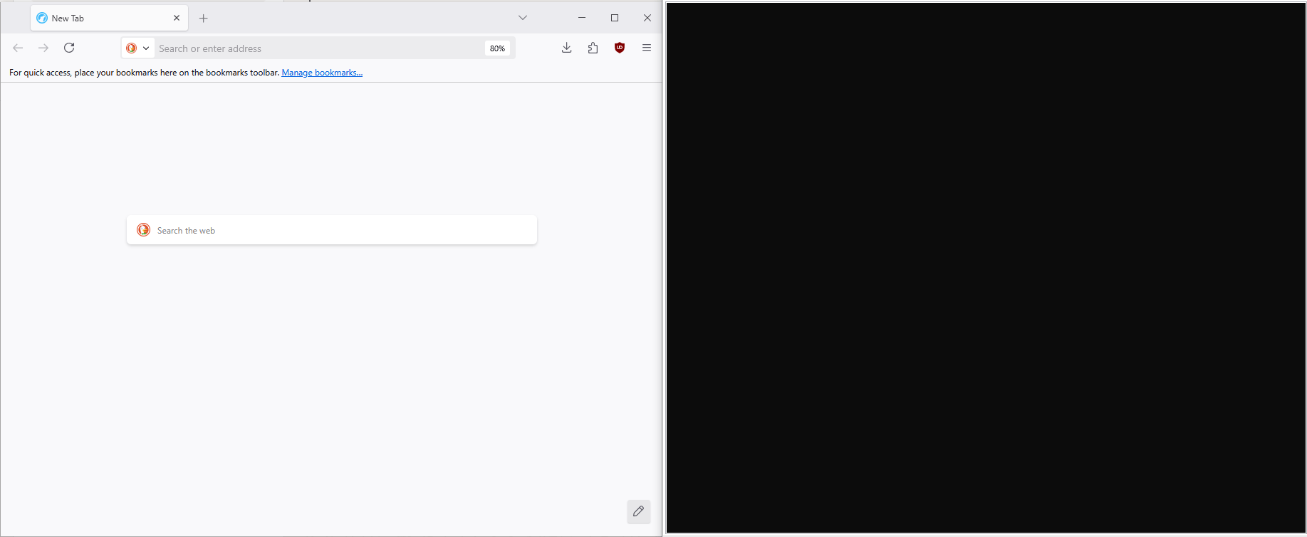

    insmod wrote:
    https://github.com/NonPIayerCharacter/OpenBK7231T_App/actions/runs/18028642266
    here's one anyway
    Browser with new tab open on the left, black screen on the right
