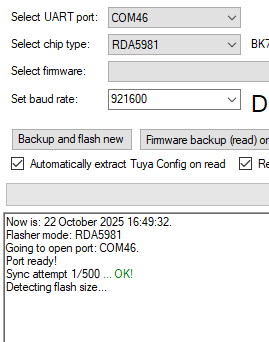

    what's checksum 1 vs checksum 2 and is erase of any use (assuming things I'm seeing are valid)?

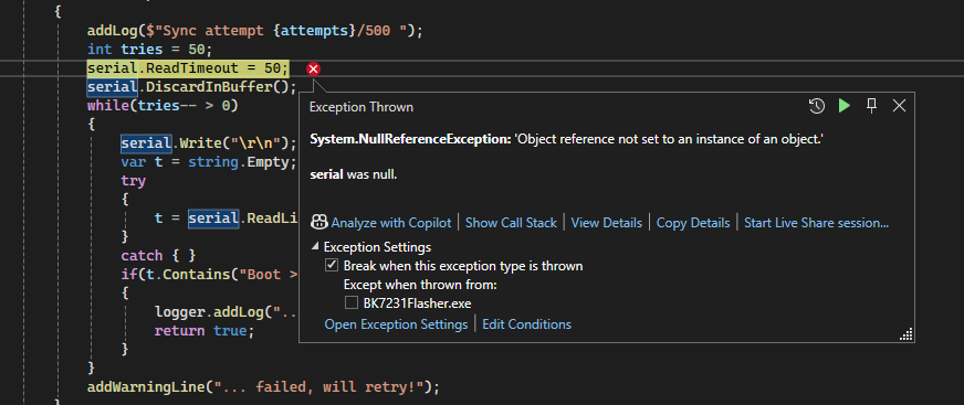

    If erase is not used, then obk config write fails.
    I don't know why it isn't required for fw.
    checksum 1 - crc32, checksum 2 - sha1
    >>21726995
    Good, i'll adjust my code tomorrow.
    I think after this i'll have to try to convert flasher from threads to tasks + cancellation tokens.
    Crashes when stopping current operation are too annoying.

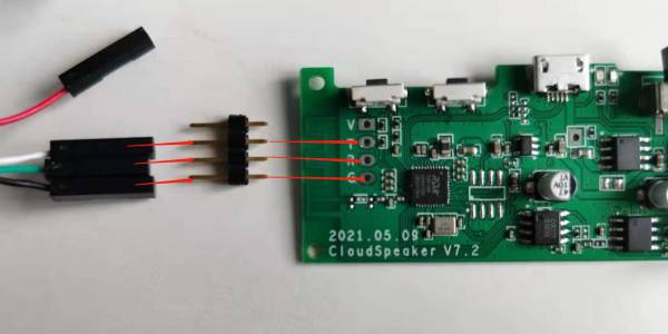

    Cloudspeaker device. USB fw update
    http://info.mqlinks.com:1888/dokuwiki/doku.ph...=search&id=mq-12fusermanual&q=rda5981
    Two QR code stands for payment on a restaurant table.
    CloudSpeaker V7.2 PCB with wires connected via pin header
    Ali bootloader saves 15 kB OTA space

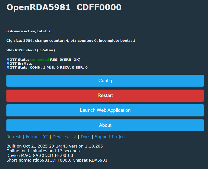

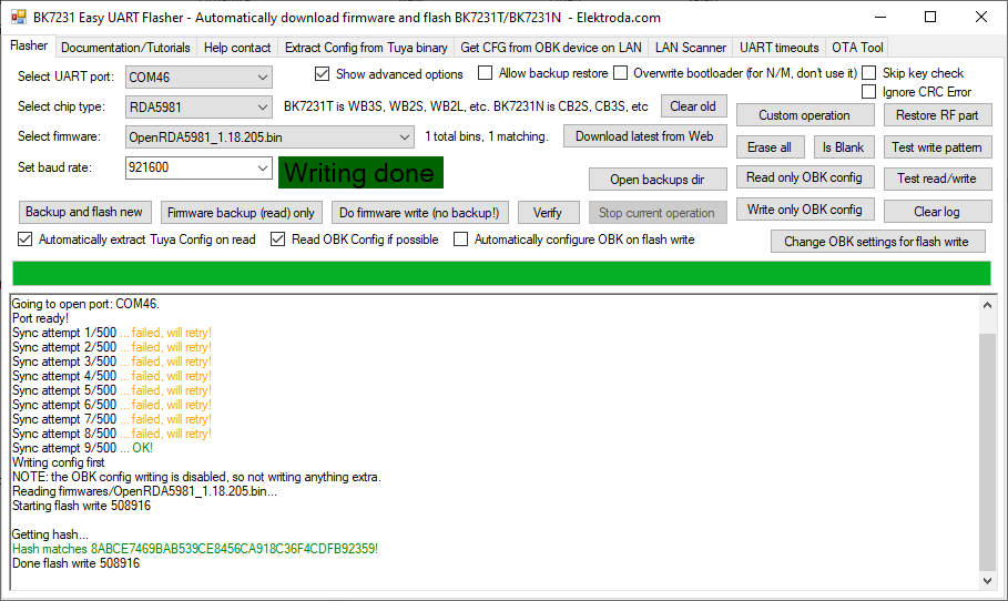

    yummy
    BK7231 Easy UART Flasher interface with firmware write operation completed
    OpenRDA5981 control panel with active WiFi and MQTT connection
    Added after 13 [minutes]:
    insmod wrote:

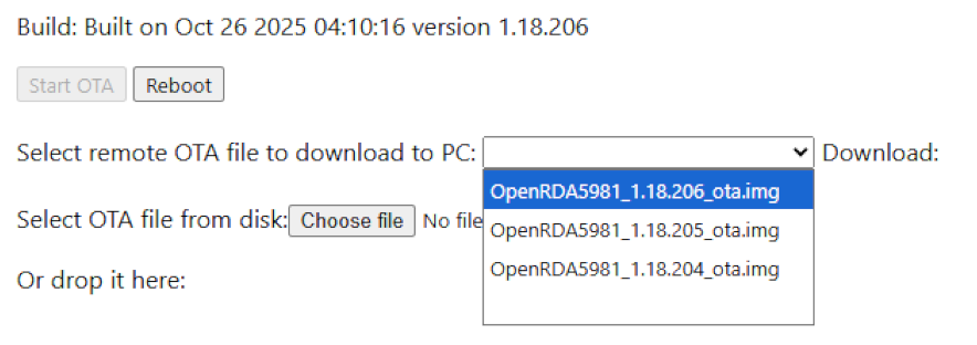

    And since there is no 'release' yet, i've decided to switch bootloader to ali one
    tbh I thought the bl wasn't changeable (without SPI or whatever, like BK-T)
    OTA list stops at OpenRDA5981_1.18.203.img and OTA attempt causes
    requiring re-flash. I see naming has changed a little. and of course file size makes sense now
    https://github.com/openshwprojects/OpenBK7231...ownload/1.18.205/OpenRDA5981_1.18.205_ota.img

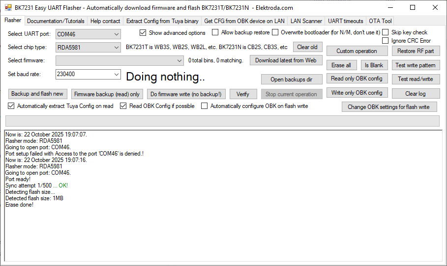

    Updated flasher, now supports only obk config write.
    Also implemented full erase.

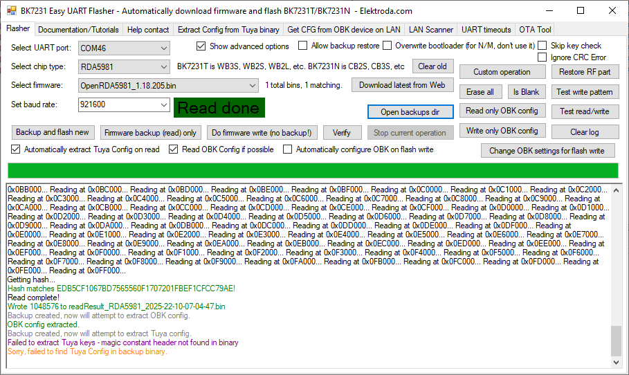

    erase all. no crash but not getting past:
    Flashing tool interface for RDA5981 chip using COM46 port
  • #192 21728395
    insmod
    Posts: 1432
    Help: 168
    Rate: 455
    >>21728390
    Buttons are enabled, meaning it succeeded.
  • #193 21728399
    Posts: 5214
    Help: 448
    Rate: 916
    damn. fallen for that again. thanks
    Added after 7 [minutes]:
    is erase one of those soft-erase kinda functions where only a few bytes are removed so it's seen to be marked as erased? I took backup after erase and I see data from 0x1000 still
  • #194 21728432
    insmod
    Posts: 1432
    Help: 168
    Rate: 455
    >>21728399
    Fixed
  • #195 21728560
    Posts: 5214
    Help: 448
    Rate: 916
    >>21728432
    yes. blank now. appreciate the additional logging
