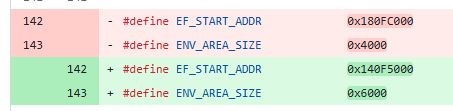

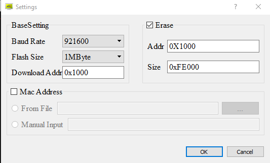

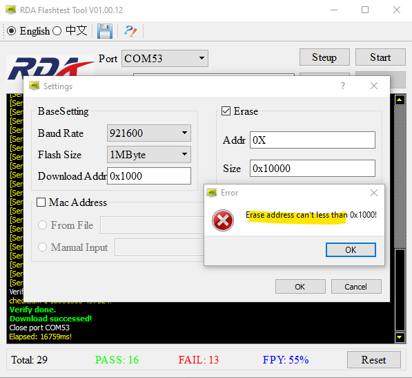

  • Flash erase now triggers a MemManage fault
    #35 21698799
    Posts: 5214
    Help: 448
    Rate: 916
    >>21698791
    erase from 0x1000 now performed every flash too
    Settings window with options for baud rate, flash memory erase address and size

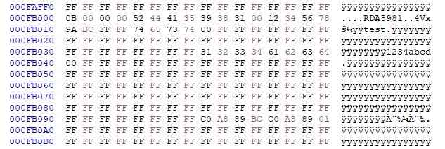

    here's uartwifi.bin dump after 1 boot. no AT commands tried. needs trimming
    • uartwifi_1bootonly.bin (2 MB) You must be logged in to download this attachment.

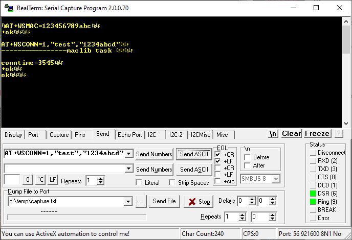

    Added after 2 [hours] 42 [minutes]:
    RDA 5981AM/Broadlink BL3335-P - Generic/nobrand 15W RGBW B22 Bulb - basic teardown
    translated AT readme
    • uartwifi_1bootonly_saveandconnecttowifi.bin (2 MB) You must be logged in to download this attachment.

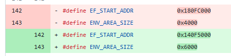

  • Boot log shows EasyFlash init then sys_arch_protect error
    #43 21699872
    Posts: 5214
    Help: 448
    Rate: 916
    insmod wrote:
    Continuing grasping at straws
    ooh
  • Boot log shows EasyFlash sector header corruption

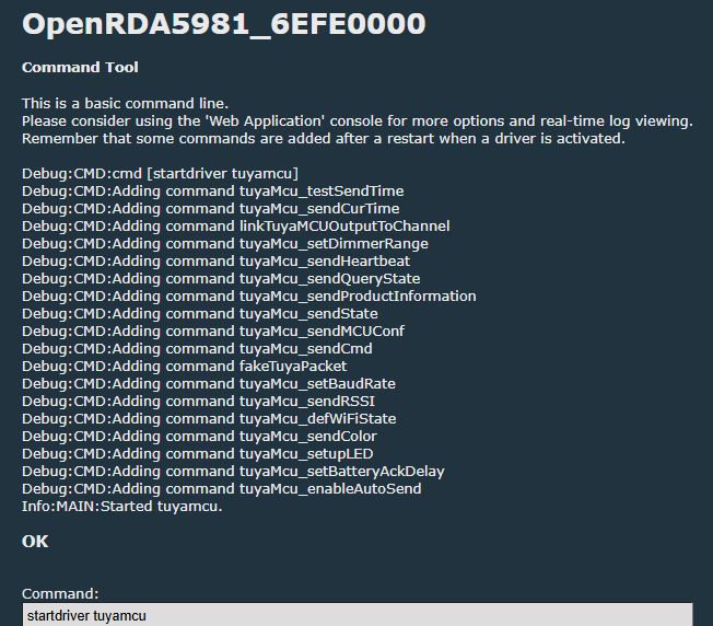

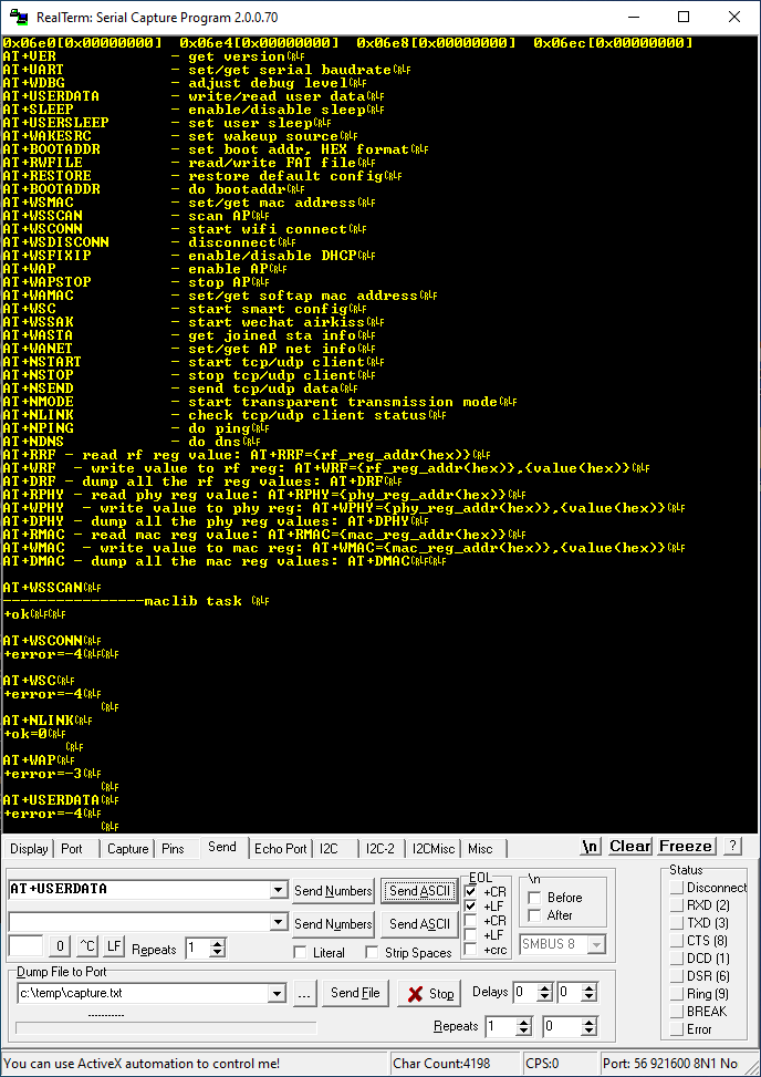

  • RDA5991H boot log and command list revealed
    #49 21699889
    Posts: 5214
    Help: 448
    Rate: 916
    omg

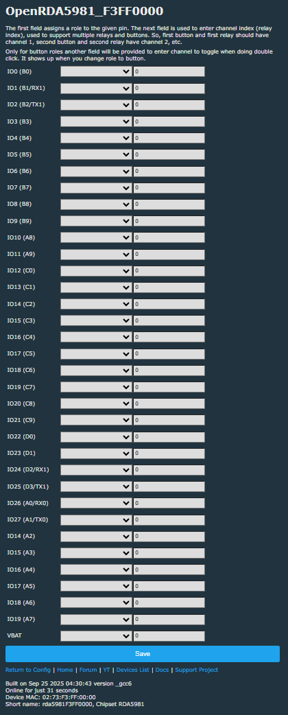

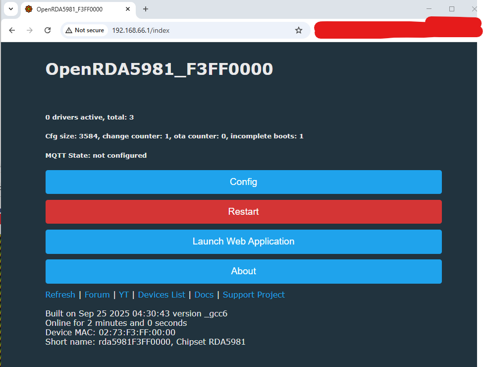

    OpenRDA5981 configuration panel with buttons: Config, Restart, Launch Web Application, About
    Pin configuration interface for OpenRDA5981 device with role and channel assignments
    here is save wifi creds and reboot. stays in AP mode
    gui is available for a few seconds before dying
  • Boot log shows driver starts but GUI crashes early
    #51 21699897
    Posts: 5214
    Help: 448
    Rate: 916
    insmod wrote:
    Did you check if pins/pwm/tuyamcu works?
    negative can't get to gui long enough to do much.
    works= driver starts, pins save and can be toggled without crashing or actual works with LEDs, TMDA simulator etc?
    insmod wrote:
    https://github.com/NonPIayerCharacter/OpenBK7231T_App/actions/runs/17997365111
    despite free mem gui still dies.
    Added after 4 [minutes]:
    Screenshot of OpenRDA5981 tool interface showing tuyamcu debug command list
    uart log stops, uart LED flashing on ESP adaptor. will try uart switch
  • AP mode persists despite saved config
    #53 21699903
    Posts: 5214
    Help: 448
    Rate: 916
    insmod wrote:
    https://github.com/NonPIayerCharacter/OpenBK7231T_App/actions/runs/17997637549
    I see config save is working. Does it connect to wifi?
    I'm afraid no. 2 tries. comes up as AP

    Info:MAIN:Time 1, idle 0/s, free 73611, MQTT 0(0), bWifi 0, secondsWithNoPing -1, socks 2/4
    Info:MAIN:Time 2, idle 0/s, free 73611, MQTT 0(0), bWifi 0, secondsWithNoPing -1, socks 2/4
    Info:MAIN:Time 3, idle 0/s, free 73611, MQTT 0(0), bWifi 0, secondsWithNoPing -1, socks 2/4
    Info:MAIN:Time 4, idle 0/s, free 73611, MQTT 0(0), bWifi 0, secondsWithNoPing -1, socks 2/4
    set_network_ap,enter
    mark ip 1
    ip_table.ip_range[0] = 0x1
    mark ip 1
    Info:MAIN:Time 5, idle 0/s, free 73611, MQTT 0(0), bWifi 0, secondsWithNoPing -1, socks 2/4
    Info:MAIN:Time 6, idle 0/s, free 73499, MQTT 0(0), bWifi 0, secondsWithNoPing -1, socks 2/4
    Info:MAIN:Boot complete time reached (5 seconds)
    Debug:CFG:SaveFlashVars: saved 64 bytes
    Info:MAIN:Time 7, idle 0/s, free 73499, MQTT 0(0), bWifi 0, secondsWithNoPing -1, socks 2/4
    Info:MAIN:Time 8, idle 0/s, free 73499, MQTT 0(0), bWifi 0, secondsWithNoPing -1, socks 2/4
    Info:MAIN:Time 9, idle 0/s, free 73499, MQTT 0(0), bWifi 0, secondsWithNoPing -1, socks 2/4
    Info:MAIN:Time 10, idle 0/s, free 73499, MQTT 0(0), bWifi 0, secondsWithNoPing -1, socks 2/4
    Debug:GEN:+--------------- net device info ------------+
    Debug:GEN:|netif type : AP |
    Debug:GEN:|netif rssi = -128 |
    Debug:GEN:|netif ip = 192.168.4.1 |
    Debug:GEN:|netif mask = 255.255.255.0 |
    Debug:GEN:|netif gateway = 192.168.4.1 |
    Debug:GEN:|netif mac : [2e] |
    Debug:GEN:+--------------------------------------------+
    Info:MAIN:Time 11, idle 0/s, free 73499, MQTT 0(0), bWifi 0, secondsWithNoPing -1, socks 2/4
    Info:MAIN:Time 12, idle 0/s, free 73499, MQTT 0(0), bWifi 0, secondsWithNoPing -1, socks 2/4
    does it save but then get wiped again?

    no change
    definitely shouldn't be 0x18xxxx?
    Change of EF_START_ADDR and ENV_AREA_SIZE values in C source code
  • Boot log from RDA5991H firmware startup
    #59 21699934
    Posts: 5214
    Help: 448
    Rate: 916
    hmm. no change

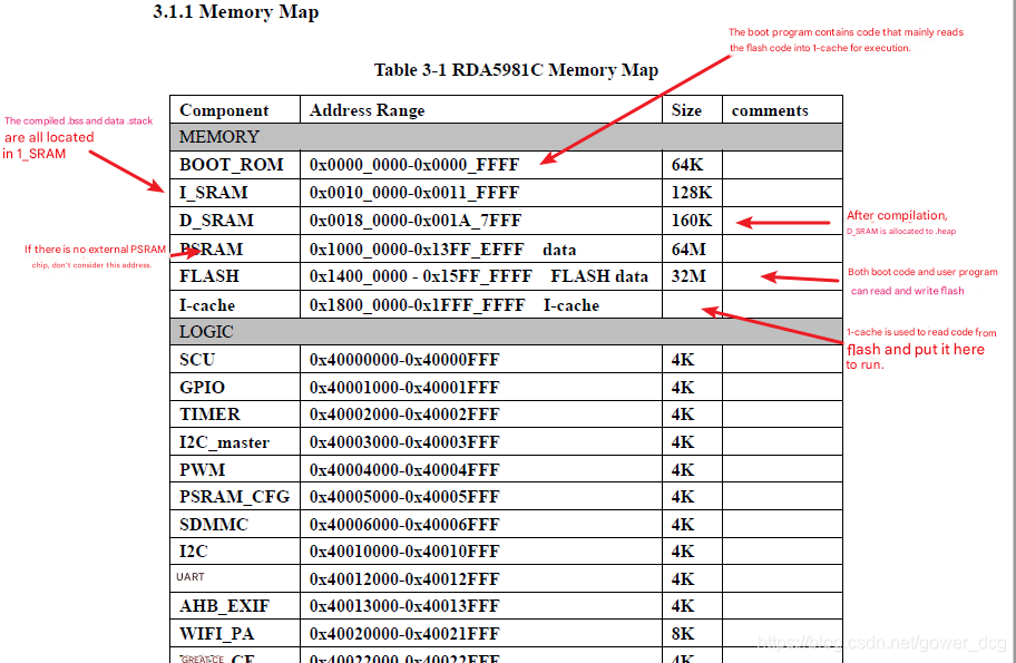

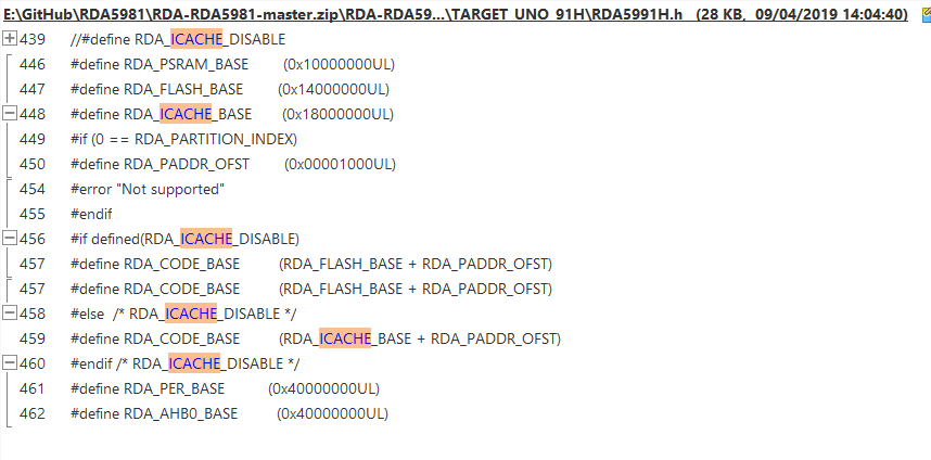

    i'll scour all the docs I've downloaded to see if there's any hint at an answer to that
    Added after 7 [minutes]:
    maybe you've been through this, but is the answer in here?
    C code snippet with memory base address definitions and conditional macro
    • RDA5991H.zip (5.81 KB) You must be logged in to download this attachment.
  • RDA5981A flash uses separate data and XIP aliases
    #60 21699948
    Posts: 5214
    Help: 448
    Rate: 916
    maybe this is wrong, I can't tell. but I gave gpt a load of stuff. it said this.
